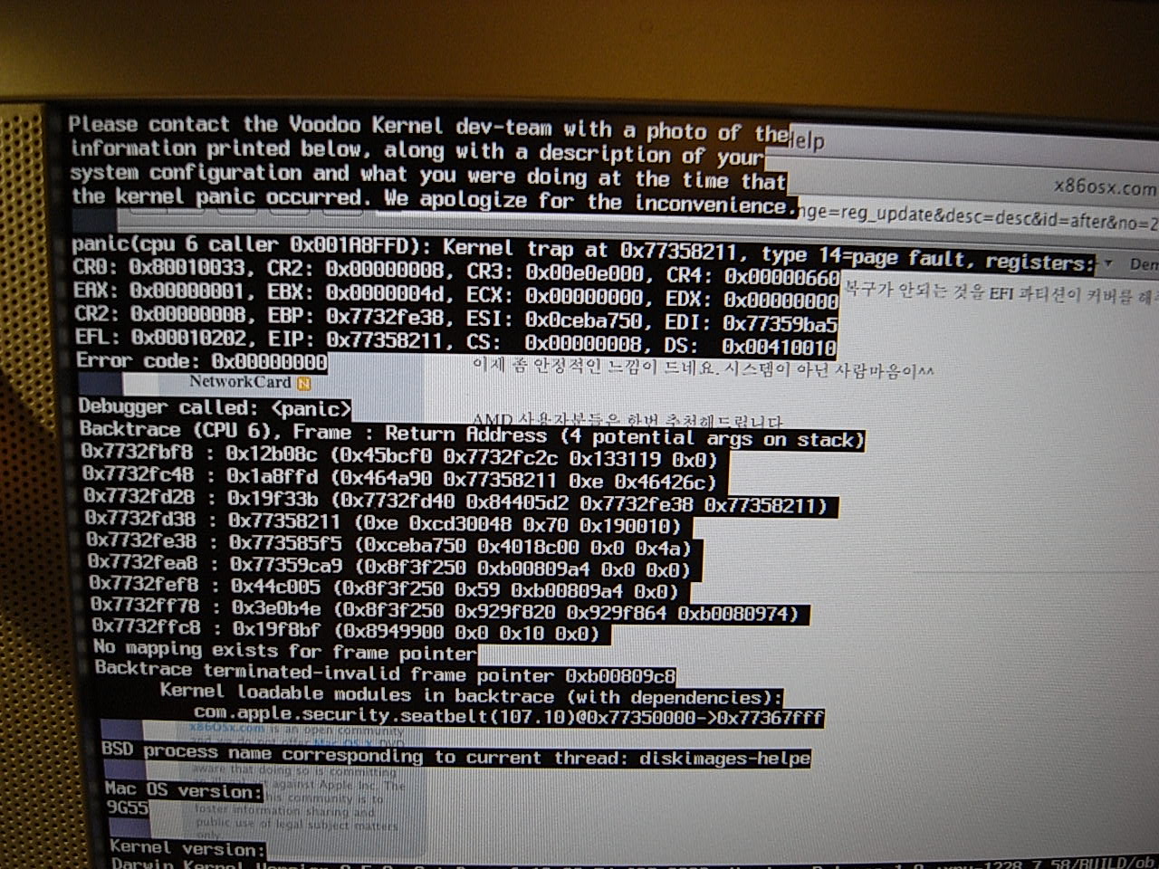

The installer does not work for me. It looks like it goes through but when I do a "uname -a" after reboot it still shows 9.5 voodoo kernel. This is on a 10.5.6 Kalyway install on a X7DAL-E Supermicro board. :)
You must select the currently booted up disk in the Installer otherwise it won't install properly. Sorry this is a bug in PackageMaker which we'll try to work around in a later release.
you should check your /Library/Preferences/SystemConfiguration/com.apple.Boot.plist, maybe it points to mach_kernel.voodoo instead of mach_kernel.
Anyway, you can also type mach_kernel over darwin bootloader to test if the new kernel works for you.
Hey thanks for the tip;that's exactly what it was. Now of course I tested mounting a dmg and got a kp so can someone upload or pm/email me a copy of their seatbelt.kext from 10.5.6?Thanks a lot in advance!
