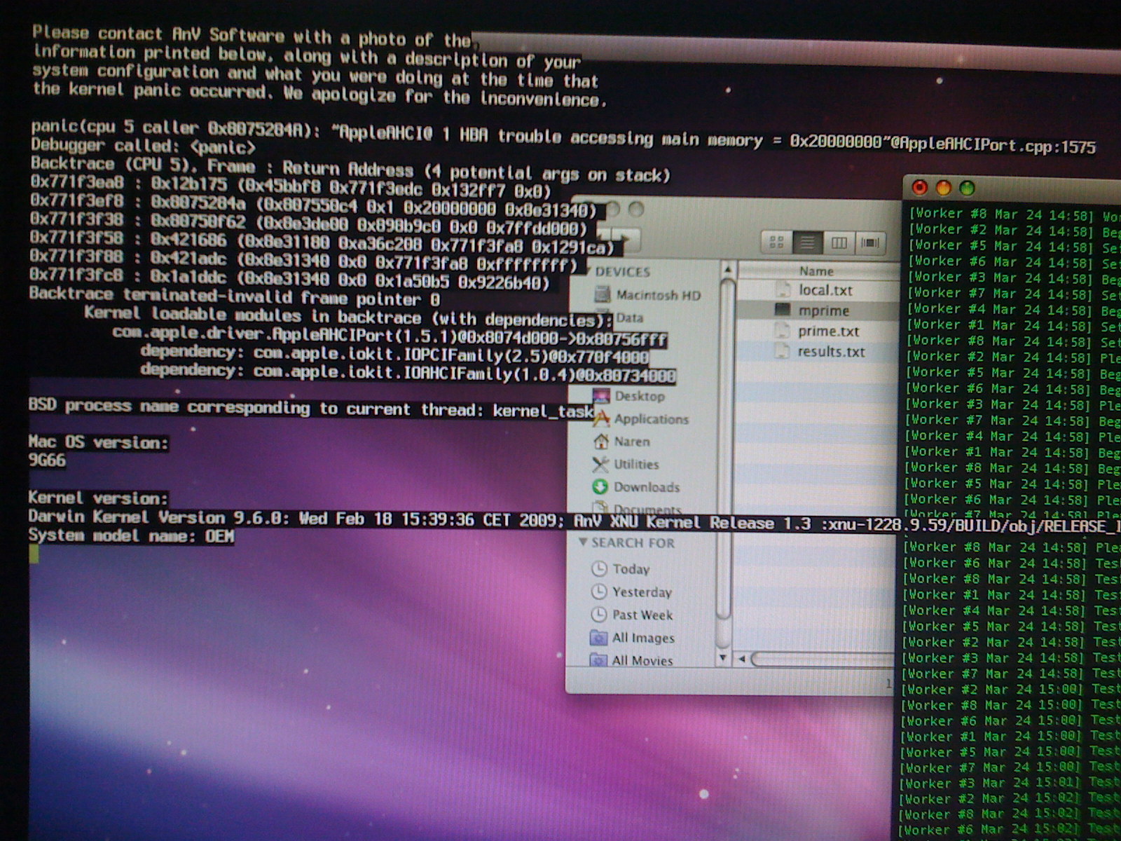

airwalk776 Posted March 24, 2009 Share Posted March 24, 2009 anyone getting kernel panic when running mprime torture test 3 ? Evga x58 MB corcair 6 gig ram Link to comment https://www.insanelymac.com/forum/topic/132960-upcoming-intel-x58-mobos-core-i7-cpus/page/39/#findComment-1114533 Share on other sites More sharing options...

airwalk776 Posted March 25, 2009 Share Posted March 25, 2009 hey Guys I had my system up and running perfectly for a week then I started getting random kernel panics. I had added a picture of the panic to this post. Any advice would be appreciated. BTW when this started happening I reset the bios to factory and running at stock 2.66 and achi on the jmicron controller. thanks Link to comment https://www.insanelymac.com/forum/topic/132960-upcoming-intel-x58-mobos-core-i7-cpus/page/39/#findComment-1115302 Share on other sites More sharing options...

digital_dreamer Posted March 25, 2009 Share Posted March 25, 2009 hey Guys I had my system up and running perfectly for a week then I started getting random kernel panics. I had added a picture of the panic to this post. Any advice would be appreciated. BTW when this started happening I reset the bios to factory and running at stock 2.66 and achi on the jmicron controller. thanks You're running prime95, but that shouldn't be happening at stock speeds. Do you get KP before the temps rise to max? Is your system only unstable under stress? What temperatures are you recording? 1. You mentioned resetting the BIOS. Make sure you always "Load Optimized Defaults" after a reset or reflash. 2. I'd monitor the temps to see if that's staying in check. Get Temperature Monitor mentioned below. 3. If your temperatures are okay, check the RAM. Pull one stick and rerun prime95. Bad RAM will cause "random" KP. Speaking of temperatures, Marcel Bresink has just released Temperature Monitor 4.7, which offers support Intel® Core™ i7 technology and simultaneous multi-threading. I tried it last night and it works great. regards, MAJ Link to comment https://www.insanelymac.com/forum/topic/132960-upcoming-intel-x58-mobos-core-i7-cpus/page/39/#findComment-1115483 Share on other sites More sharing options...
airwalk776 Posted March 25, 2009 Share Posted March 25, 2009 You're running prime95, but that shouldn't be happening at stock speeds. Do you get KP before the temps rise to max? Is your system only unstable under stress? What temperatures are you recording? 1. You mentioned resetting the BIOS. Make sure you always "Load Optimized Defaults" after a reset or reflash. 2. I'd monitor the temps to see if that's staying in check. Get Temperature Monitor mentioned below. 3. If your temperatures are okay, check the RAM. Pull one stick and rerun prime95. Bad RAM will cause "random" KP. Speaking of temperatures, Marcel Bresink has just released Temperature Monitor 4.7, which offers support Intel® Core™ i7 technology and simultaneous multi-threading. I tried it last night and it works great. regards, MAJ the display on the motherboard reads 24-25 at idle. and when running prime goes up no more than 60. the KP happens at any given time even if I am not in mprime running test. I will install the temp monitor and see what it goes up to. regarding your question about "Load optimized defaults" I dont know that there is such an option in the evga board. Link to comment https://www.insanelymac.com/forum/topic/132960-upcoming-intel-x58-mobos-core-i7-cpus/page/39/#findComment-1115501 Share on other sites More sharing options...
radov4n Posted March 25, 2009 Share Posted March 25, 2009 hey Guys I had my system up and running perfectly for a week then I started getting random kernel panics. I had added a picture of the panic to this post. Any advice would be appreciated. BTW when this started happening I reset the bios to factory and running at stock 2.66 and achi on the jmicron controller. thanks Is it possible that you installed something that's causing these KPs? I haven't had a single system related KP (had a few because of OpenGL / Cuda programming). I am running stock with minimal iPC installation (only gfx drivers and lan driver, nothing else installed from disc) and 9.6.0 kernel (updated from page 9). Have all unnecessary stuff disabled in the BIOS (audio, jmicron etc). Is it possible that you have a faulty mem? Did you run memtest? Link to comment https://www.insanelymac.com/forum/topic/132960-upcoming-intel-x58-mobos-core-i7-cpus/page/39/#findComment-1115761 Share on other sites More sharing options...
JaE-V Posted March 26, 2009 Share Posted March 26, 2009 hey Guys I had my system up and running perfectly for a week then I started getting random kernel panics. I had added a picture of the panic to this post. Any advice would be appreciated. BTW when this started happening I reset the bios to factory and running at stock 2.66 and achi on the jmicron controller. thanks I had this same problem with my board. It would happen whenever i'd do anything that involves sending and recieving alot of data. Like whenever i'd try to install leo from an dmg onto another drive i'd get that same panic. It has something to do with the ahci controller and the jmicron drivers. A reinstall fixed my issue. Not sure what i did, it was a few months back. I'd make sure you have the latest intelAHCI driver in your extensions folder. Link to comment https://www.insanelymac.com/forum/topic/132960-upcoming-intel-x58-mobos-core-i7-cpus/page/39/#findComment-1115896 Share on other sites More sharing options...

airwalk776 Posted March 26, 2009 Share Posted March 26, 2009 I had this same problem with my board. It would happen whenever i'd do anything that involves sending and recieving alot of data. Like whenever i'd try to install leo from an dmg onto another drive i'd get that same panic. It has something to do with the ahci controller and the jmicron drivers. A reinstall fixed my issue. Not sure what i did, it was a few months back. I'd make sure you have the latest intelAHCI driver in your extensions folder. Hello I will try to reinstall today. When you say latest intelAHCI drivers you mean the extensions in digital_dreamers x58_Mobo pages? Anything additional you know of that needs to be added ? Thanks UPDATE: I just got a Kernel panic when doing an install to another internal drive. Are your SATA connetions on the red sata ports ? Which SATA port # do you have your drives connected to. If I connect my to anything other then SATA port 8 and 9 (jmicron 363 chipset) my drives dont show the real capacity. Link to comment https://www.insanelymac.com/forum/topic/132960-upcoming-intel-x58-mobos-core-i7-cpus/page/39/#findComment-1116208 Share on other sites More sharing options...

JaE-V Posted March 27, 2009 Share Posted March 27, 2009 Hello I will try to reinstall today. When you say latest intelAHCI drivers you mean the extensions in digital_dreamers x58_Mobo pages? Anything additional you know of that needs to be added ? Thanks UPDATE: I just got a Kernel panic when doing an install to another internal drive. Are your SATA connetions on the red sata ports ? Which SATA port # do you have your drives connected to. If I connect my to anything other then SATA port 8 and 9 (jmicron 363 chipset) my drives dont show the real capacity. Yea, that just confirms that your having an I/O error. Same {censored} i was having. What installation method are you using? In your bios under sata/pata configurations make sure you have the first option on AHCI Mode as well as the last, and second to last options. Everything else you can leave alone. Shouldnt matter which port. On the iATKOS disk, i selected the Intel AHCI driver as well with the jmicron kext after i installed and that fixed my issue. Link to comment https://www.insanelymac.com/forum/topic/132960-upcoming-intel-x58-mobos-core-i7-cpus/page/39/#findComment-1116715 Share on other sites More sharing options...
airwalk776 Posted March 27, 2009 Share Posted March 27, 2009 Yea, that just confirms that your having an I/O error. Same {censored} i was having. What installation method are you using? In your bios under sata/pata configurations make sure you have the first option on AHCI Mode as well as the last, and second to last options. Everything else you can leave alone. Shouldnt matter which port. On the iATKOS disk, i selected the Intel AHCI driver as well with the jmicron kext after i installed and that fixed my issue. Hello JaE-V You are exactly correct. I have corrected the issue in the following manor. Install iDeneb 10.5.6 work perfectly with busratio=20 and all 8 cores show up in cpu activity monitor. I install the 9.5.0 voodoo kernel off the dvd. So this tells me that we dont really need any of the kext that are in Digital_Deamers script for this Mobo. Now I have ideneb updated to 9.6.0 voodoo (saw the dmg issue with 9.5.0) still no kext from digital_dreamers guide. I then mount the retail dvd install dvd run DD's script to do pre-patch and make partition active then run the install retail dvd. Copied the kexts for ACHI(from ideneb install) and SMBios(from DD's kexts package) to the new HD and rebooted with retail install and it booted correctly. no panic for 24 hours now. Remember to add busratio=20 in the plist. Also The Sata controller for the intel chipset works correctly now. I have attached a xbench result from my system. seems good but didnt compare to other results yet. What are you guys getting on your system Almost 48 hours uptime and no Kernel panic, ran mprime torture test #3 few time no issues. I used the following kexts for my setup. Retail install 10.5.6 dvd. i7 920 - Overclocked to 3.8 running at 18-20 degree on idle EVGA X58 SLI Mobo Cooler Master V8 EVGA 9800 GTX+ 512 Mb 6 gig OCZ Platinum 7-7-7-18-59-1T 500 gig Sata Seagate 32 meg buffer 1TB Western Digital Black 32 meg buffer Anetec 300 case - 4 120 mm coolermaster fans Anetec 650 Watt power supply the zip file enclosed in this post has all the kexts you need. the Plist file needs to be edited for your UUID and your GFX string. (if you dont want to use the GFX string remove the lines for "<key>device-properties</key>" and the hex string for it) Good luck Thank for everyone who assisted in getting my system to run and run smooth. xbench.txt EVGA_x58_Kexts.zip Link to comment https://www.insanelymac.com/forum/topic/132960-upcoming-intel-x58-mobos-core-i7-cpus/page/39/#findComment-1116930 Share on other sites More sharing options...
