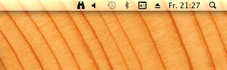

mondial Posted February 25, 2010 Share Posted February 25, 2010 ripples would definitely mean it's working.. the most obvious sign it's working -> translucent bar at the top as opposed to the solid one. This card definitely prefers EFI strings over Graphics Enabler for me. I was able to finally get Graphics Enabler to work, but it wasn't stable and required me to boot, send to sleep, wake up (in addition only worked on the VGA port). Not a very elegant method. The strings work perfect, the only thing is anyone doing I would definitely say dump your card's rom not one you get on the net. None of the ones I found online worked perfect for my card. To Sally rogabean! I think I've a stable 10.6.2 System now (64 bit) . But interresting: When I booted in 32 bit mode, I lost all the new functionality of Gfx. ??? The procedere done one more time in 64 bit mode , now it is working also after several x64 bootings. Any ideas, why it doesn't work in x32 mode?? best regards mondi Link to comment https://www.insanelymac.com/forum/topic/113489-geforce-200-series-support/page/18/#findComment-1417509 Share on other sites More sharing options...

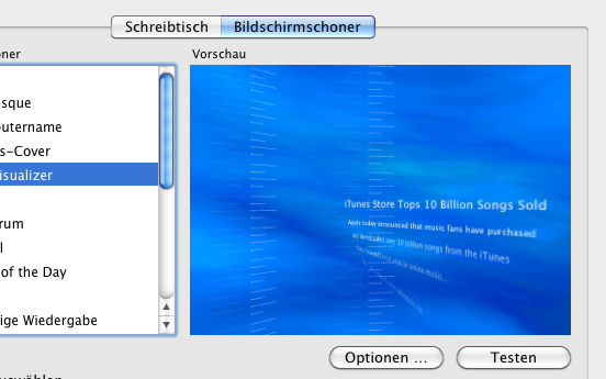

rogabean Posted February 26, 2010 Share Posted February 26, 2010 Hmmm what does your system profiler say for Graphics? Is the RSS screensaver available to you to select? I have found I can not make this work with anything less than 10.6.2 I have also found an issue where I can not make this work if I need to use any other EFI strings. In my case I need to use and Ethernet string as the EthernetBuiltIn=y does not work properly for me for NetFlix DRM purposes (chameleon RC 4).... I'm going to work with this more tonight. But EthernetBuiltin worked fine when coupled with GraphicsEnabler... so I will let you know what I come up with. Link to comment https://www.insanelymac.com/forum/topic/113489-geforce-200-series-support/page/18/#findComment-1418679 Share on other sites More sharing options...
mondial Posted February 26, 2010 Share Posted February 26, 2010 Hmmm what does your system profiler say for Graphics? Is the RSS screensaver available to you to select? I have found I can not make this work with anything less than 10.6.2 I have also found an issue where I can not make this work if I need to use any other EFI strings. In my case I need to use and Ethernet string as the EthernetBuiltIn=y does not work properly for me for NetFlix DRM purposes (chameleon RC 4).... I'm going to work with this more tonight. But EthernetBuiltin worked fine when coupled with GraphicsEnabler... so I will let you know what I come up with. So I thought the dockbar should be tramslucent, but you said the menubar!!! BUT I have a translucent menubar!!! So maybe I have QE and CI working .... RSS Screensaver is also working!!! No info in System Profiler: nVidia GeForce GT210: Chipsatz-Modell: nVidia GeForce GT210 Typ: GPU Bus: PCIe PCIe-Lane-Breite: x16 VRAM (gesamt): 512 MB Hersteller: NVIDIA (0x10de) Geräte-ID: 0x0a65 Versions-ID: 0x00a2 ROM-Version: nVidia GeForce GT210 OpenGL Engine [EFI] Monitore: Monitor 1: Auflösung: 1680 x 1050 @ 60 Hz Pixeltiefe: 32-Bit Farbe (ARGB8888) Hauptmonitor: Ja Synchronisierung: Aus Eingeschaltet: Ja Rotation: Unterstützt Monitoranschluss: Status: Kein Monitor angeschlossen Link to comment https://www.insanelymac.com/forum/topic/113489-geforce-200-series-support/page/18/#findComment-1418718 Share on other sites More sharing options...

rogabean Posted February 26, 2010 Share Posted February 26, 2010 So I thought the dockbar should be tramslucent, but you said the menubar!!! BUT I have a translucent menubar!!! So maybe I have QE and CI working .... RSS Screensaver is also working!!! No info in System Profiler: nVidia GeForce GT210: Chipsatz-Modell: nVidia GeForce GT210 Typ: GPU Bus: PCIe PCIe-Lane-Breite: x16 VRAM (gesamt): 512 MB Hersteller: NVIDIA (0x10de) Geräte-ID: 0x0a65 Versions-ID: 0x00a2 ROM-Version: nVidia GeForce GT210 OpenGL Engine [EFI] Monitore: Monitor 1: Auflösung: 1680 x 1050 @ 60 Hz Pixeltiefe: 32-Bit Farbe (ARGB8888) Hauptmonitor: Ja Synchronisierung: Aus Eingeschaltet: Ja Rotation: Unterstützt Monitoranschluss: Status: Kein Monitor angeschlossen Yes you are working as expected sir! Link to comment https://www.insanelymac.com/forum/topic/113489-geforce-200-series-support/page/18/#findComment-1418799 Share on other sites More sharing options...
