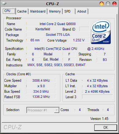

cyberbuddhah Posted July 22, 2008 Share Posted July 22, 2008 One note about Overclocking You can try to lower CPU core voltage to as low as 1.2 and adjust upward. The CPU will run less hot. My idle temp is 30 C and loaded max is 43 C Link to comment https://www.insanelymac.com/forum/topic/112708-guide-software-a-recipe-for-delicious-leopard-soup-now-with-vanilla-flavor/page/8/#findComment-829351 Share on other sites More sharing options...
