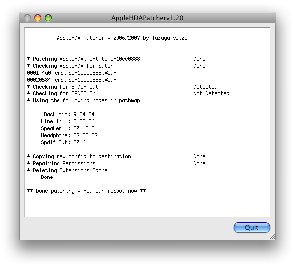

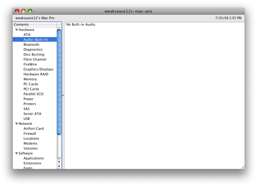

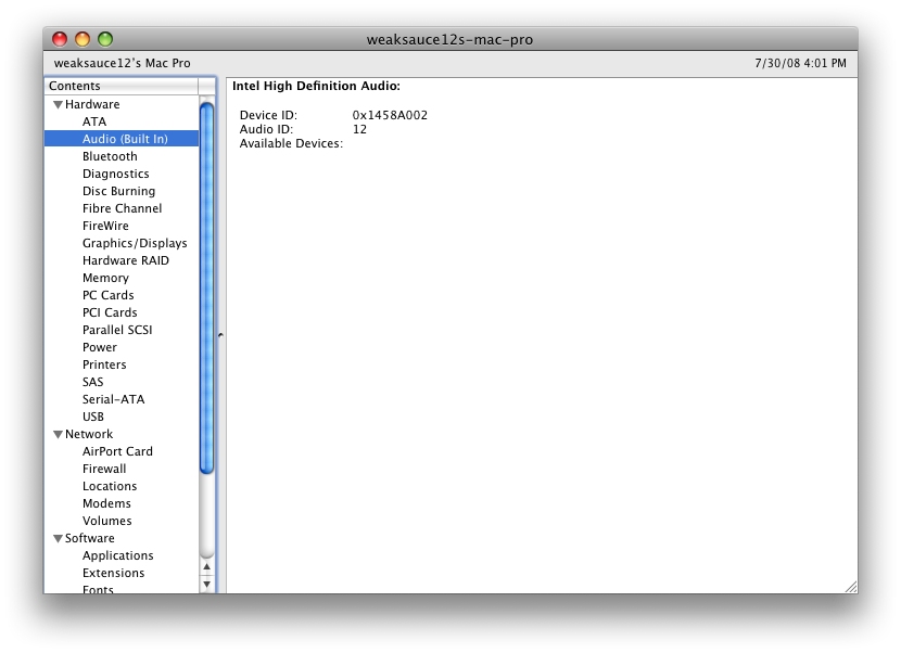

weaksauce12 Posted July 30, 2008 Author Share Posted July 30, 2008 Audio Fix to get System Profiler to display correctly: http://rapidshare.com/files/133658994/AudioFix.zip.html How to install the Audio Fix: 1. From your boot drive, open System>Library>Extensions and delete ALCinject.kext (I'd recommend backing it up first) 2. Using Kext Helper in the download package, install HDAEnabler.kext 3. Reboot Your Audio pane in System Profiler should now look like this: Please test this and let me know if you encounter any problems. You may have to do a Repair Permissions after doing the above steps. Note that this is purely cosmetic. Please back up your files before making any changes. Link to comment https://www.insanelymac.com/forum/topic/112708-guide-software-a-recipe-for-delicious-leopard-soup-now-with-vanilla-flavor/page/12/#findComment-839246 Share on other sites More sharing options...

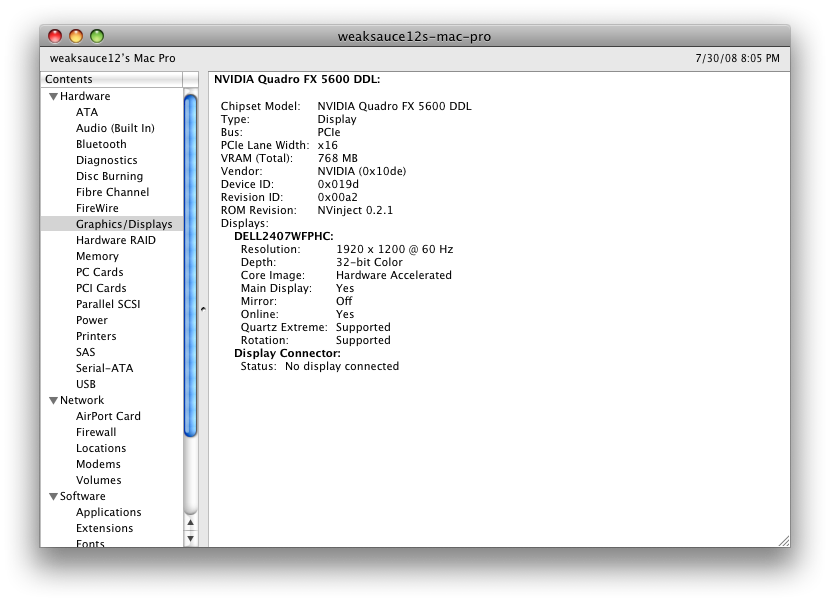

weaksauce12 Posted July 30, 2008 Author Share Posted July 30, 2008 How to mod your NVIDIA Graphics Card model name: (for NVinstaller users) 1. On your boot drive, navigate to System>Library>Extensions 2. Copy NVinject.kext to your desktop (you may want to make an additional copy in another folder for backup) 3. Right-click on NVinject.kext to Show Package Contents, then click on the Contents folder and open Info.plist with TextEdit 4. Scroll down until you find the line "<string>Graphics by NVIDIA</string>" and change to your make and model (for example <string>NVIDIA Quadro FX 5600 DDL</string>) and then save the file 5. Use Kext Helper to install the modified NVinject.kext (do NOT drag and drop the NVinject.kext file into the Extensions folder - use Kext Helper!!) 6. Reboot AFAIK this is for cosmetic purposes only (it changes the System Profiler entry from "Graphics by NVIDIA" to whatever you type in). Your video card will now show the proper name in System Profiler. For example, here is my Quadro FX 5600 card: Link to comment https://www.insanelymac.com/forum/topic/112708-guide-software-a-recipe-for-delicious-leopard-soup-now-with-vanilla-flavor/page/12/#findComment-839447 Share on other sites More sharing options...

sup3r1or Posted July 31, 2008 Share Posted July 31, 2008 Weaksauce My Sound is still not working, I installed the driver it said reboot. After reboot same thing no sound, I tried to play itunes didnt even play the files. I went to sound preferences, checked devices there is nothing all empy output and input. Everything that can be ticked is grey color:( Need help Link to comment https://www.insanelymac.com/forum/topic/112708-guide-software-a-recipe-for-delicious-leopard-soup-now-with-vanilla-flavor/page/12/#findComment-839643 Share on other sites More sharing options...
