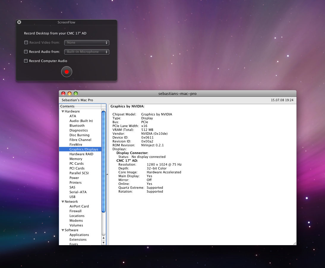

hollie Posted July 15, 2008 Share Posted July 15, 2008 @weaksauce I wanted to make a screen capture, but the option "Record Video from:" is greyed out. Maybe this has something to do with my "stutter" problem? I posted a screenshot, showing ScreenFlow and my System Information for Graphics. Link to comment https://www.insanelymac.com/forum/topic/112708-guide-software-a-recipe-for-delicious-leopard-soup-now-with-vanilla-flavor/page/4/#findComment-820343 Share on other sites More sharing options...

weaksauce12 Posted July 15, 2008 Author Share Posted July 15, 2008 @weaksauce I wanted to make a screen capture, but the option "Record Video from:" is greyed out. Maybe this has something to do with my "stutter" problem? I posted a screenshot, showing ScreenFlow and my System Information for Graphics. Might just be because it's a demo. Works fine for me weaksauce... a quick question about the cd drive. I just realized that my power supply only has 1 SATA power plug which will be taken up by the HDD. Does my cd drive have to be SATA? i know in the first page you write SATA dvd drive but i was just wondering if it was absolutely necessary. I have not tested IDE on my own system yet, so I can't really comment on it. For all I know it works great, but after hearing about the numerous problems of IDE on Hackintosh I decided to just skip the hassle and get all-SATA drives. Why not just get an IDE-to-SATA power adapter? http://www.newegg.com/Product/Product.aspx...N82E16812816015 Link to comment https://www.insanelymac.com/forum/topic/112708-guide-software-a-recipe-for-delicious-leopard-soup-now-with-vanilla-flavor/page/4/#findComment-820652 Share on other sites More sharing options...
