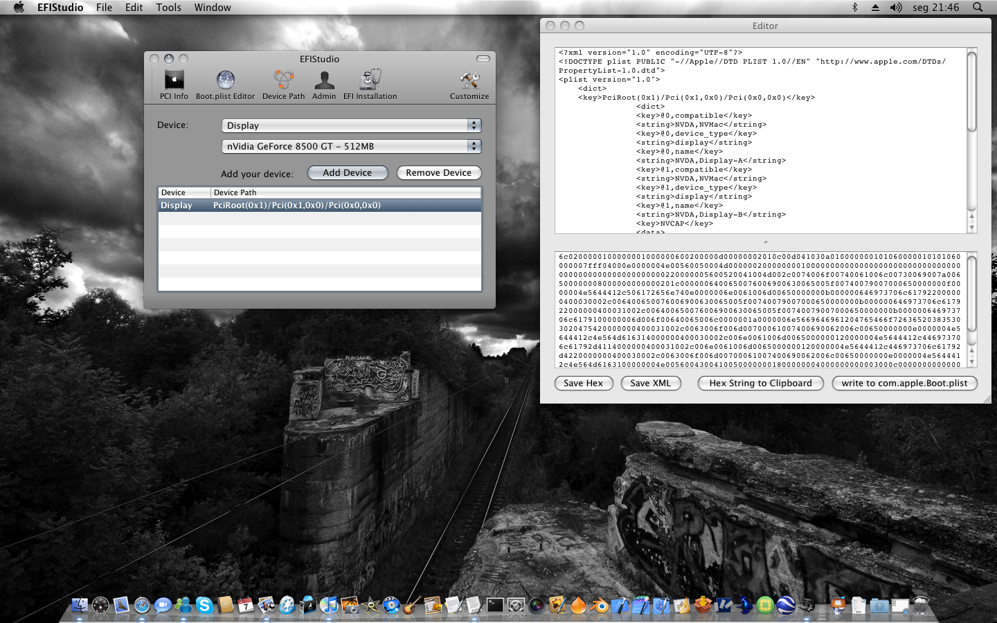

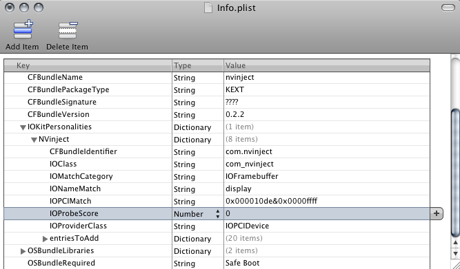

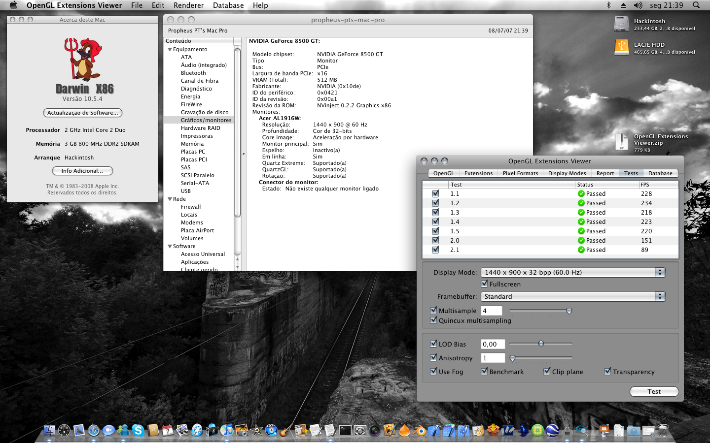

Propheus@PT Posted July 7, 2008 Share Posted July 7, 2008 10.5.3/10.5.4 Nvinject Get Nvinject Work After 10.5.3 Update This Is The Steps you Need to Follow To Make That happens. 1- You Got to Use EFIStudio or GFX-EFI to Create a EFI String To your Hardware. Files: EFI Studio: EFIStudio.zip GFX-EFI: 8800GT_EFI_Pack_v2.zip Tuturial Link : http://forum.insanelymac.com/index.php?showtopic=91755 Foto: After That You´ll need Nvinject.kext and you Will need to change with Property List editor. Files: Nvinject: nvinject_0.2.2.zip Now open With Property List Editor, and change line IOProbeScore from 60000 to 0. Fotos: To Now save. Copy the Modified Nvinject.kext to Desktop And Install it Using the Terminal. Open terminal /Utilities/Terminal Write sudo -s Enter Your Password xxx= your user name now write cp -R /Users/xxx/Desktop/NVinject.kext /System/Library/Extensions press ENTER. Ok Lets Repair The Permissions Still Whith the terminal opens write: sudo chown -R 0:0 /System/Library/Extensions/NVinject.kext sudo chmod -R 755 /System/Library/Extensions/NVinject.kext Now Reboot Your Machine. There some problems With some MSI Graphics Cards i dont know why. 10.5.4 works Fine to. My system: Equipamento: Modelo: Mac Pro Identificador de modelo: MacPro3,1 Nome do processador: Intel Core 2 Duo Velocidade do processador: 2 GHz Número de processadores: 1 Número total de núcleos: 2 Cache L2: 2 MB Memória: 3 GB Velocidade do BUS: 800 MHz Versão da ROM de arranque: MP11.005C.B08 Número de série: CK034KMHK5B Software de sistema: Versão do sistema: Mac OS X 10.5.4 (9E17) Versão do Kernel: Darwin 9.4.0 Volume de arranque: Hackintosh Modo de arranque: Normal Nome do computador: Utilizador: Tempo desde o arranque: 1:33 NVIDIA GeForce 8500 GT: Modelo chipset: NVIDIA GeForce 8500 GT Tipo: Monitor Bus: PCIe Largura de banda PCIe: x16 VRAM (Total): 512 MB Fabricante: NVIDIA (0x10de) ID do periférico: 0x0421 ID da revisão: 0x00a1 Revisão da ROM: NVinject 0.2.2 Graphics x86 Monitores: Acer AL1916W: Resolução: 1440 x 900 @ 60 Hz Profundidade: Cor de 32-bits Core image: Aceleração por hardware Monitor principal: Sim Espelho: Inactivo(a) Em linha: Sim Quartz Extreme: Suportado(a) QuartzGL: Suportado(a) Rotação: Suportado(a) Conector do monitor: Estado: Não existe qualquer monitor ligado Test Your OpenGL: File: OpenGL_Extensions_Viewer.zip Foto: Enable QuartzGL Using OSX86Tool. File: OSX86Tools.zip Foto: Hope i helped. Link to comment https://www.insanelymac.com/forum/topic/107785-kalyway-1053-combo-update-for-sse3-intel-only/page/9/#findComment-810809 Share on other sites More sharing options...
