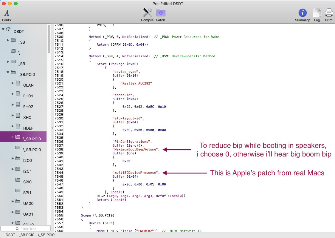

ammoune78 Posted July 10, 2018 Share Posted July 10, 2018 (edited) 13 hours ago, twsps said: Note: SSDT-XOSI is for brightness key fix No, it's not for, contrariwise it's for: Spoiler // Override for host defined _OSI to handle "Darwin"... #ifndef NO_DEFINITIONBLOCK DefinitionBlock("", "SSDT", 2, "hack", "_XOSI", 0) { #endif // All _OSI calls in DSDT are routed to XOSI... // As written, this XOSI simulates "Windows 2015" (which is Windows 10) // Note: According to ACPI spec, _OSI("Windows") must also return true // Also, it should return true for all previous versions of Windows. Method(XOSI, 1) { // simulation targets // source: (google 'Microsoft Windows _OSI') // https://docs.microsoft.com/en-us/windows-hardware/drivers/acpi/winacpi-osi Local0 = Package() { "Windows", // generic Windows query "Windows 2001", // Windows XP "Windows 2001 SP2", // Windows XP SP2 //"Windows 2001.1", // Windows Server 2003 //"Windows 2001.1 SP1", // Windows Server 2003 SP1 "Windows 2006", // Windows Vista "Windows 2006 SP1", // Windows Vista SP1 "Windows 2006.1", // Windows Server 2008 "Windows 2009", // Windows 7/Windows Server 2008 R2 "Windows 2012", // Windows 8/Windows Server 2012 "Windows 2013", // Windows 8.1/Windows Server 2012 R2 "Windows 2015", // Windows 10/Windows Server TP //"Windows 2016", // Windows 10, version 1607 //"Windows 2017", // Windows 10, version 1703 //"Windows 2017.2", // Windows 10, version 1709 //"Windows 2018", // Windows 10, version 1803 } Return (Ones != Match(Local0, MEQ, Arg0, MTR, 0, 0)) } #ifndef NO_DEFINITIONBLOCK } #endif //EOF @RehabMan hotpatch from GitHub source for config plists "_OSI abbreviation and meaning is: Open Systems Interconnection, it's used to facilitate to the computers the communication for different protocols or OSs protocole code. This is why you'll see Windows 2001 and up, in particular cases you'll have for each OS build it's own protocol under some methods and devices, briefly, how this windows build will work under some devices and methods" @RehabMan give the choice for users and in some particular builds, to use OSI Windows 7 and ups with Darwin or XOSI_SSDT to tell to macOS this is the protocol that you have to follow and the one that you have to deal with. This is why i told you, you have to know what thing you did and for what reason. The reason for me i deleted it, simply because you already used DSDT, logically if so, why removing OEM _OSI if we have DSDT in the hand, and by the way why not inserting all the things in DSDT instead of using multiple SSDT. So you have to decide to use DSDT and one CpuSsdt at all or multiple SSDT's for multiple reasons. I personally opt for DSDT and SSDT at all, because I don't like too much things. 4 hours ago, twsps said: For DellSMBiosPatch, I need this to make usb injection work. Here also you only need a patch for USB XHC in order to work, an MBP14,1 ACPI is in our hand for that, so better inspiring from for your Inspiron : Spoiler This part of PNLF is Apple specific and will not help Hacki for backlight. Related or not for your Audio or not! So better to solve other things or not my friend ? Edited July 10, 2018 by ammoune78 Link to comment Share on other sites More sharing options...

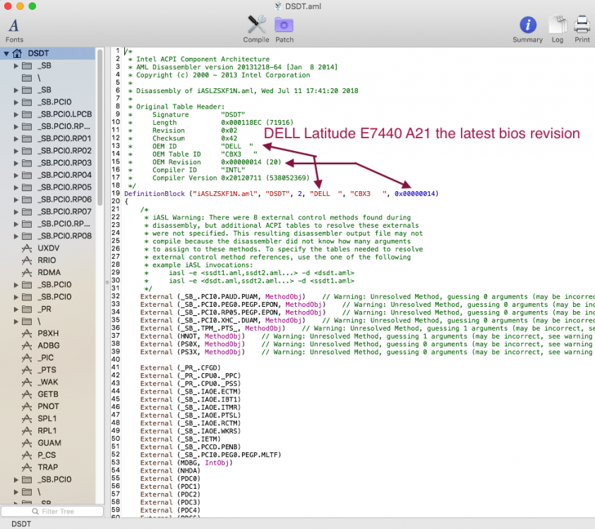

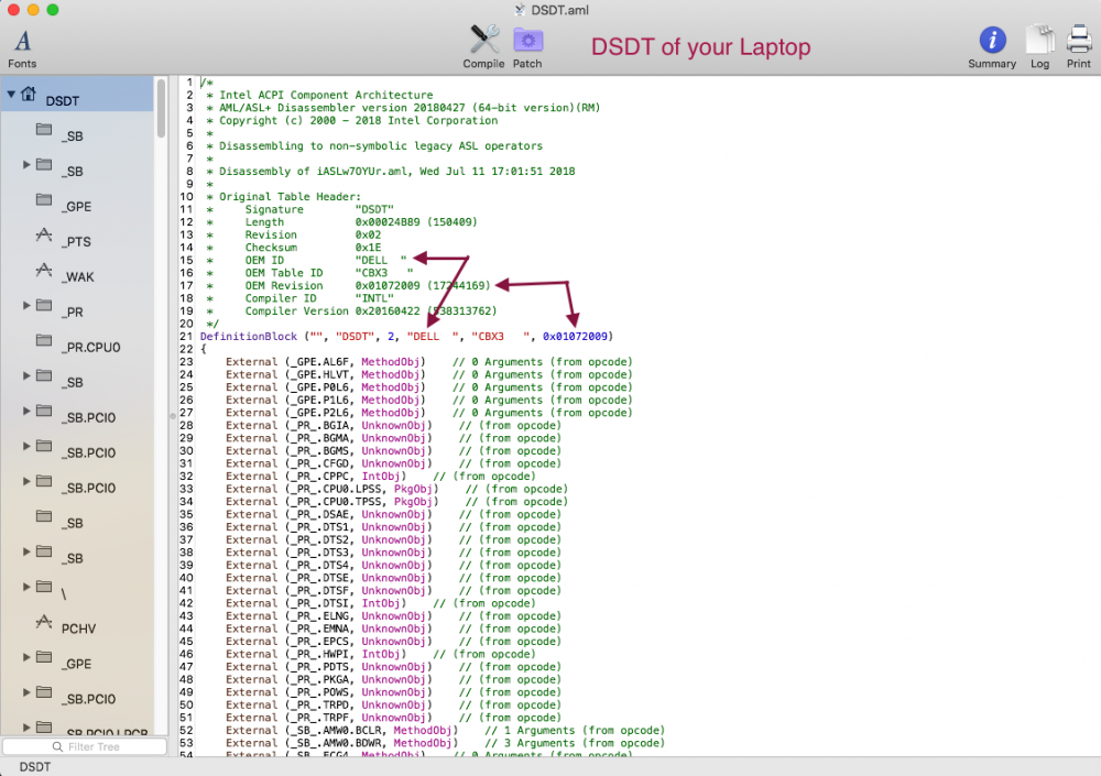

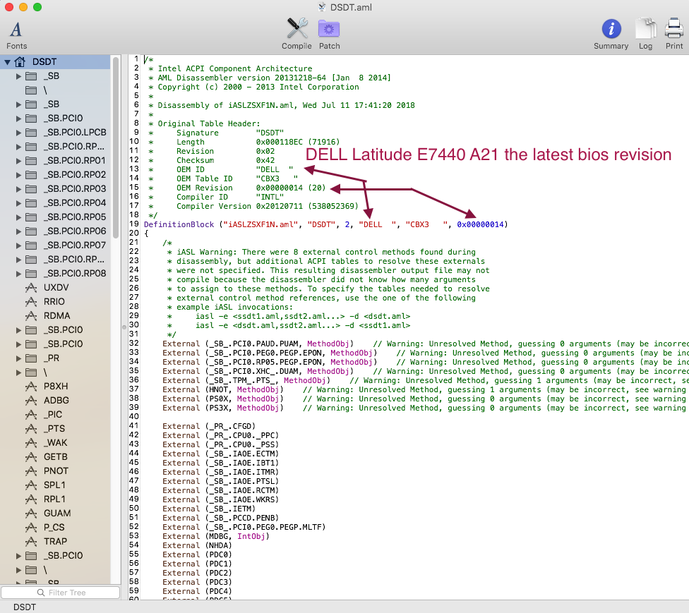

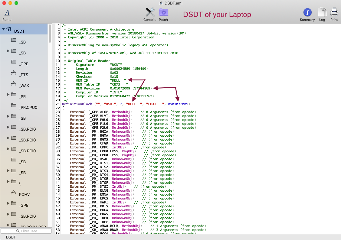

ammoune78 Posted July 11, 2018 Share Posted July 11, 2018 25 minutes ago, twsps said: Then it will not work, I tried before. Just like using inject-id=3 with AppleALC, both has no sound. What do you mean by laptop version issue? Under Windows everything works fine. I mean, is this laptop refurbished or new? The report of that OEM Revision i give to you, proof that it was updated too many times by DELL not others. DELL updated the ACPI tables of your laptop many times, not only one or two or three times! And i told to you to try updating your bios and see if it can solve your problem, i'm sure you didn't do that. As I told to you, in the same way, after updating the bios, and if not worked, rollback to the first one, and see if problem is solved, then if not, do a flash with the second revision, and continue like that, until we hope bios one can fix it. You have nothing to loose, if you really, like you said "I would like to solve the CPU issue first", would you be mind to try it? Link to comment Share on other sites More sharing options...
twsps Posted July 11, 2018 Share Posted July 11, 2018 I mean, is this laptop refurbished or new? The report of that OEM Revision i give to you, proof that it was updated too many times by DELL not others. DELL updated the ACPI tables of your laptop many times, not only one or two or three times! And i told to you to try updating your bios and see if it can solve your problem, i'm sure you didn't do that. As I told to you, in the same way, after updating the bios, and if not worked, rollback to the first one, and see if problem is solved, then if not, do a flash with the second revision, and continue like that, until we hope bios one can fix it. You have nothing to loose, if you really, like you said "I would like to solve the CPU issue first", would you be mind to try it?I would love to try it. This laptop is new. But I don't understand how can you know by "you gave to me" OEM revision report…Sent from my MHA-AL00 using Tapatalk Link to comment Share on other sites More sharing options...

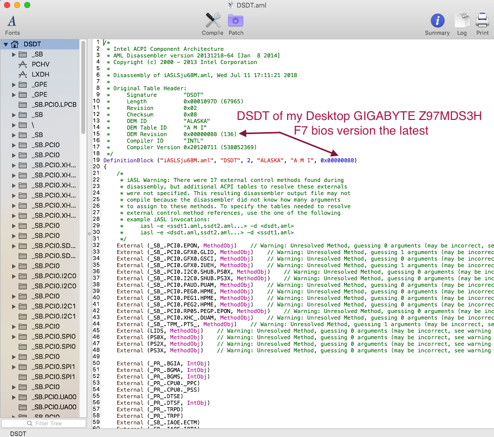

ammoune78 Posted July 11, 2018 Share Posted July 11, 2018 (edited) 59 minutes ago, twsps said: I would love to try it. This laptop is new. But I don't understand how can you know by "you gave to me" OEM revision report… I think you don't read all my posts, anyway: Your DSDT laptop Spoiler DSDT of my Z97M-DS3H_F7 revision of the latest bios Spoiler Now my original Latitude DSDT Spoiler Edited July 11, 2018 by ammoune78 Link to comment Share on other sites More sharing options...

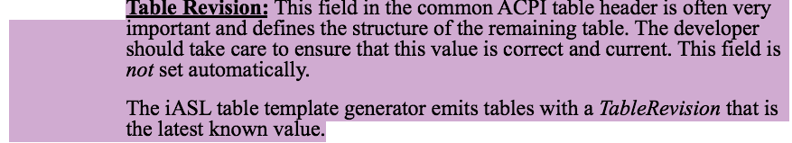

ammoune78 Posted July 11, 2018 Share Posted July 11, 2018 For your own infos about what i mean here for ACPI-OEM Revision: Spoiler Link to comment Share on other sites More sharing options...
