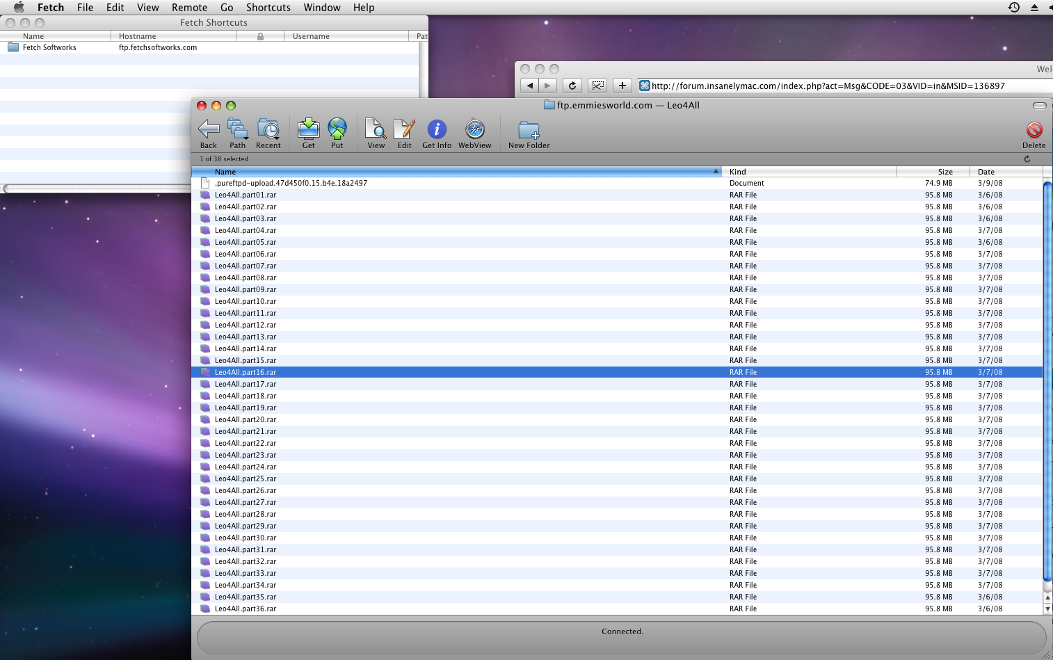

WinLinMac01 Posted March 9, 2008 Share Posted March 9, 2008 eddie11c, so we should apply this 2nd patch over the original DVD ONLY, or should we apply this patch over the 1st patch as well. Can you please clarify, Thank you. Also, which file do we select from the server directory, I see the 37 files, and a document file. Below is a snapshot: Ok guys here is hoping you all made a backup copy of the original ISO as I asked, for whatever reason the small changes I need to make are not working via PPF on top of PPF. So the new patch will include all the fixes but will require the original ISO. If you deleted it ( ) don't worry you can download it again. Donut I need to know some specifics about your hardware. What is the Device ID for your IDE/SATA controller? What specific options do you have in your BIOS? (I know its limited) Link to comment Share on other sites More sharing options...

WinLinMac01 Posted March 9, 2008 Share Posted March 9, 2008 Okay so this means this has been a revision of the original (rev.1) patch? right? That means I don't patch this on the existing patch that you uploaded before, right? This new patch will be for an untouched ISO. the small changes I made would not work with PPF properly. So I am uploading Leo4AllPPFv2, it is now the only PPF patch you can download(the other was removed) you will need the original ISO and this to patch it with. The new MD5 should be d2669f936a29700bdaafcbf61bbf0748. This fixes the bootloader issues, no more B0 errors!(crosses fingers) It is now up, only 103M(zipped) so download at will. Link to comment Share on other sites More sharing options...

eddie11c Posted March 9, 2008 Author Share Posted March 9, 2008 Okay so this means this has been a revision of the original (rev.1) patch? right? That means I don't patch this on the existing patch that you uploaded before, right?Right, this patch is for the original ISO. eddie can you include realtek rtl8187L driver in the dvd? (you can download it here I can do that before I finalize the release, for now I want to work out some more pressing hardware issues first. Ok chip on the FTP you will find a new folder for you. Inside is a packed Extensions folder and Extensions.mkext file. Open the patched ISO with UltraISO. Click to view HFS partition. Click through to /System/Library so the contents of Library is in the right window. Drag Extensions and Extensions.mkext over and choose replace to all. Once its finished click the burn button. It will prompt you that you made changes and ask you to save it, click no and burn it. If you clicked yes prior when trying to burn it you ruined that copy of the ISO removing the Hybrid partition that has the EFI so it wont boot. Link to comment Share on other sites More sharing options...
