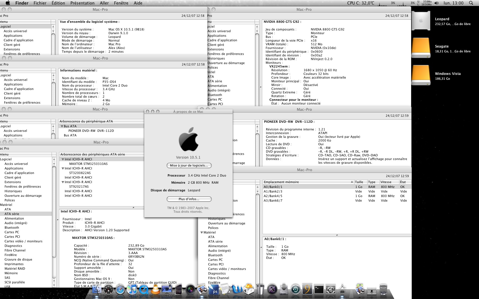

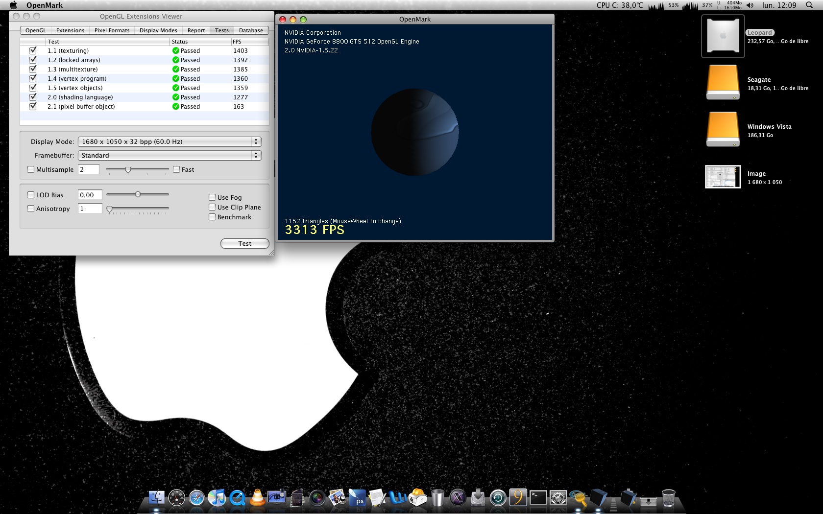

alexcooltranquille Posted December 24, 2007 Share Posted December 24, 2007 No problem with nvinject 0.2.0 (8800 GTS 512Mo) Link to comment https://www.insanelymac.com/forum/topic/77020-nvidia-g92-8800gt-support-in-1052/page/6/#findComment-550250 Share on other sites More sharing options...
