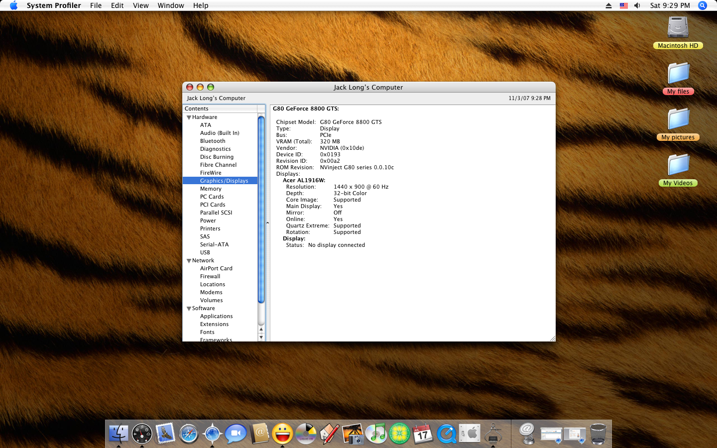

KellyKelly Posted November 4, 2007 Share Posted November 4, 2007 Thank you so much mac.nub!!!!! I waited for 6 month finally there's a 8800GTS 320MB driver!!! Now QI/Ce everything works great! Video games run so smooth and front row works! I can switch to any resolution, it even recognized my monitor model! I can select the color profile I want. BTW. For people who get's a blue screen after mac are loaded is because you plug it in the wrong DVI slot! Plug the one that is close to the motherboard. Also I tested that DVI direct connection do not need to hotplug cable. Only VGA cable needs to. and here's my screenshot. =] Again thanks mac.nub! Link to comment Share on other sites More sharing options...
