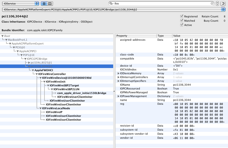

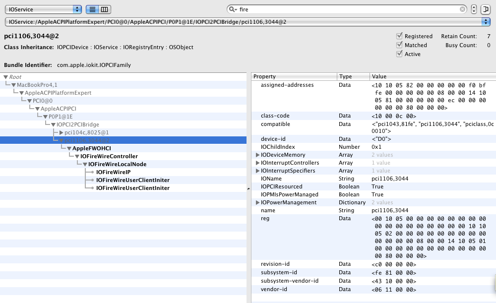

bikinifarm Posted January 5, 2009 Share Posted January 5, 2009 BlackCH; Following your instructions, I now have Firewire working and AppleHPET.kext (1.3) loading at the same time. The steps I followed are: install your Disabler.kext using Kext Helper b7 drag and drop a copy of /System/Library/AppleHPET.kext to /Extra/AppleHPET.kext run the following two commands from Terminal just to be sure (may not be necessary): sudo chown -R root:wheel /Extra/AppleHPET.kext sudo chmod -R 755 /Extra/AppleHPET.kext reboot With that, now everything works with the P5K-VM board with 10.5.6. If anyone has any remaining issues, I can post specific instructions for general installation of 10.5.6 on top of 10.5.5 upgraded kalyway on P5K-VM. Thanks BlackCH!!! Link to comment https://www.insanelymac.com/forum/topic/62111-how-to-asus-p5k-vm-guide/page/11/#findComment-1027834 Share on other sites More sharing options...
prettyhatem Posted January 5, 2009 Share Posted January 5, 2009 BlackCH; Following your instructions, I now have Firewire working and AppleHPET.kext (1.3) loading at the same time. The steps I followed are: install your Disabler.kext using Kext Helper b7 drag and drop a copy of /System/Library/AppleHPET.kext to /Extra/AppleHPET.kext run the following two commands from Terminal just to be sure (may not be necessary): sudo chown -R root:wheel /Extra/AppleHPET.kext sudo chmod -R 755 /Extra/AppleHPET.kext reboot With that, now everything works with the P5K-VM board with 10.5.6. If anyone has any remaining issues, I can post specific instructions for general installation of 10.5.6 on top of 10.5.5 upgraded kalyway on P5K-VM. Thanks BlackCH!!! If you could post those specific instructions I would be in debt to you! Link to comment https://www.insanelymac.com/forum/topic/62111-how-to-asus-p5k-vm-guide/page/11/#findComment-1027848 Share on other sites More sharing options...
BlackCH Posted January 5, 2009 Share Posted January 5, 2009 BlackCH; Following your instructions, I now have Firewire working and AppleHPET.kext (1.3) loading at the same time. The steps I followed are: Have you check if Firewire works properly?; I dont have any devices to check ATM. I also wonder how it looks your HPET in the ioreg.... Can you post it as a txt file? Link to comment https://www.insanelymac.com/forum/topic/62111-how-to-asus-p5k-vm-guide/page/11/#findComment-1027863 Share on other sites More sharing options...
bikinifarm Posted January 5, 2009 Share Posted January 5, 2009 prettyhatem; Below are the basic instructions of what I have done for a successful installation of 10.5.6 on P5K-VM from 10.5.5 updated kalyway installation: BACKUP (you will need it) I used Carbon Copy Cloner (CCC) Install PC-EFI and DSDT patcher per http://insanelymac.blogspot.com/2008/12/pr...pdating-to.html reboot Make and install plug per http://insanelymac.blogspot.com/2008/12/pr...pdating-to.html DO NOT REBOOT Install vanilla Appleintelcpupowermanagement.kext per insanelymac instructions (the file is floating around) reboot straight install 10.5.6 (~300 meg version, not the patch version, not the Combo) install SMBIOSResolver from http://www.superhai.com/darwin.html edit its info.list as needed (fixes About this Mac) relaunch UInstaller and install timemachine patch (fixes timemachine) backup AppleHDA.kext bring AppleHDA.kext from ccc backup mirror (fixes audio) remove Appleintelcpupowermanagement.kext reboot install EHCISleepEnabler from http://www.superhai.com/darwin.html also patching IOUSBFamily per instructions from the readme on same line (fixes sleep) backup IOUSBFamily and install the patched one then fix Firewire per BlackCH's instructions a few postings up... Best of luck... BlackCH; I did check with two separate Firewire drives, and they do mount and open properly. However, I have not done extensive testing. Firewire Bus also now appears under About this Mac/More Info... I am attaching ioreg info... Thanks. ioreg.rtf Link to comment https://www.insanelymac.com/forum/topic/62111-how-to-asus-p5k-vm-guide/page/11/#findComment-1028061 Share on other sites More sharing options...

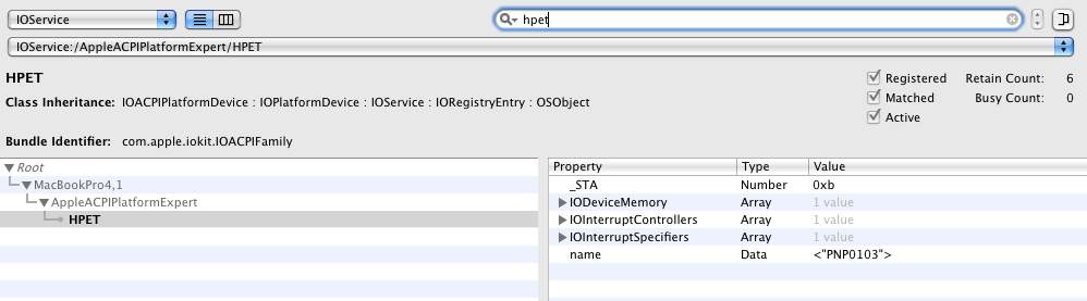

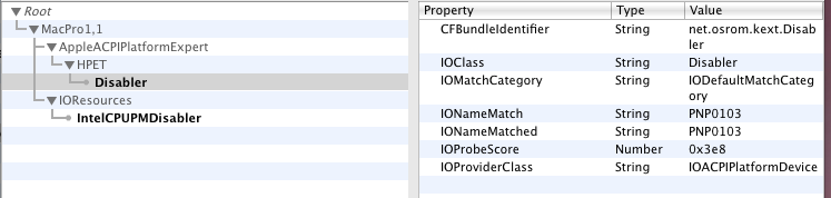

BlackCH Posted January 6, 2009 Share Posted January 6, 2009 Bikinifarm: Is what I thought; the appleHPET.kext isnt really loaded on your system. Otherwise firewire wouldnt work. I would put that kext back on the S/L/Extensions folder and put the disabler on the /Extra/Extensions/ your IOREG would look like this: | +-o HPET <class IOACPIPlatformDevice, registered, matched, active, busy $ | | | { | | | "IOInterruptControllers" = ("io-apic-0") | | | "name" = <"PNP0103"> | | | "IODeviceMemory" = (({"address"=18446744073689628672,"length"=1024}$ | | | "IOInterruptSpecifiers" = (<0800000000000000>) | | | "_STA" = 15 | | | } | | | | | +-o Disabler <class Disabler, !registered, !matched, active, busy 0, r$ | | { | | "IOProbeScore" = 1000 | | "IOProviderClass" = "IOACPIPlatformDevice" | | "CFBundleIdentifier" = "net.osrom.kext.Disabler" | | "IOMatchCategory" = "IODefaultMatchCategory" | | "IONameMatched" = "PNP0103" | | "IOClass" = "Disabler" | | "IONameMatch" = "PNP0103" | | } I think this way is cleaner. However Im not sure whats the concequences of running without HPET.... Link to comment https://www.insanelymac.com/forum/topic/62111-how-to-asus-p5k-vm-guide/page/11/#findComment-1029542 Share on other sites More sharing options...
bikinifarm Posted January 6, 2009 Share Posted January 6, 2009 BlackCH I was sure that AppleHPET was loaded because I had run kextstat -b com.apple.driver.AppleHPET shortly after booting BUT before connecting the firewire drive. And it had come back with a response Index Refs Address Size Wired Name (Version) <Linked Against> 42 0 0x80f56000 0x3000 0x2000 com.apple.driver.AppleHPET (1.3) Following your message, I reissued the command, and to my surprise, the AppleHPET.kext was no longer loaded. A small test reconfirms that, with the set-up I had, once a firewire drive is connected, the AppleHPET.kext drops out. And stays out even if the firewire drive is disconnected. For further testing, I followed your latest advise, and repositioned the two kext's. Upon booting, AppleHPET is loaded Index Refs Address Size Wired Name (Version) <Linked Against> 40 0 0x80d25000 0x3000 0x2000 com.apple.driver.AppleHPET (1.3) However, similarly, once firewire is connected (and disconnected), AppleHPET is gone. So, still no Firewire and AppleHPET.kext at the same time. Bummer. Many thanks, though, for your help... Let me know if any other suggestions... EDIT: Once the firewire drive is disconnected, I was able to reload the kext by: kextload /System/Library/Extensions/AppleHPET.kext Link to comment https://www.insanelymac.com/forum/topic/62111-how-to-asus-p5k-vm-guide/page/11/#findComment-1029762 Share on other sites More sharing options...
BlackCH Posted January 7, 2009 Share Posted January 7, 2009 In my setup (Disabler.kext loading from /Extra/Extensions.mkext file and AppleHPET.kext on /S/L/E folder) the disabler kext is hooked to the HPET ioreg device: AppleHPET is not loaded (even without firewire devices connected) and Firewire seems to work fine (Shown in SystemProfiler, related kexts loaded and hooked to the ioreg device). If you load the Disabler.kext from Extra/Extensions/ folder instead, change the IOProbeScore value to 1000 in the plist inside the kext. That might help to get the disabler loaded properly and stop the hpet.kext to load. AFAICU we cannot have Firewire and HPET at the same time for now; Link to comment https://www.insanelymac.com/forum/topic/62111-how-to-asus-p5k-vm-guide/page/11/#findComment-1030397 Share on other sites More sharing options...
