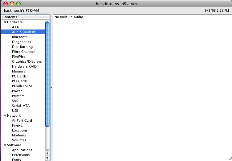

MaaseyRacer Posted September 3, 2008 Share Posted September 3, 2008 I just got my set up working and my graphics card set up. Overall the install and setup was easy. The X1900GT graphics card that I had lying around was the biggest pain in the install, and the only difficulty there was searching around for answers about it. I finally found it in the 10.5.1 section of the HCL. It basically needs to be seen as an X1900XT. Now that QE is working the only other issue I seem to be having is that i seem to get small audio glitches mainly when sounds first start, or emptying the trash, copying files, etc.? Is there a way to correct this. Other than the audio glitch everything seems to run great. System Set up as follows Processor: E8500 3.16GHz (shows at 3.17 in about this mac) Motherboard: P5K-VM Hard Drive: 640GB Seagate Video Card: X1900GT Wireless N Card: D-Link DWA-542 DVD Writer: Pioneer 216 (SATA) Link to comment https://www.insanelymac.com/forum/topic/62111-how-to-asus-p5k-vm-guide/page/9/#findComment-878073 Share on other sites More sharing options...
leo333 Posted September 3, 2008 Share Posted September 3, 2008 I pretty much got everything to work using the BlackHC Installer but there is one thing: Sleep! Please someone, give me a hint on how I can get sleep working! I really want this feature. i will try a few more kernels and see what i can do... Link to comment https://www.insanelymac.com/forum/topic/62111-how-to-asus-p5k-vm-guide/page/9/#findComment-878278 Share on other sites More sharing options...
MaaseyRacer Posted September 5, 2008 Share Posted September 5, 2008 BlackCH your installer (http://www.mediafire.com/?y2tm0ljnene) got everything going for me. HDA was last on my list. I have two more bugs that are driving me nuts: I have an audio pop or static sound when my instant messenger (Adium), or I empty the trash, or receive mail through apple mail, system alerts, etc. I was hoping HDA support would fix it. But it did not. I went to the midi controller in the Utilities folder and switched over to 48000KHz, but that did not do anything for me. Secondly VLC is bugging out on me. When I try and play a movie, any movie for that matter, the player skips every other second, it looks like trying to watch a skipping dvd. Any help would be greatly appreciated. Link to comment https://www.insanelymac.com/forum/topic/62111-how-to-asus-p5k-vm-guide/page/9/#findComment-880094 Share on other sites More sharing options...

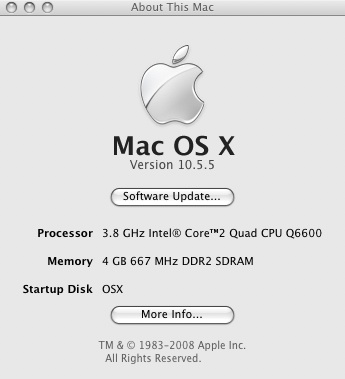

mihnlg Posted September 23, 2008 Share Posted September 23, 2008 Hey Guys Long time Mac user - first time OSX86'er Here is how my first ever OSX86 just went. System: P5k-VM (latest bios from ASUS) Intel Q6600 @ 2.4 4GB RAM (Generic) 1 X Seagate 1TB (SATA1) & 1X LG Sata Burner(SATA2) Nvidia 8600GT 512mb SATA in bios set to IDE/Enhanced Mode (first tried sata mode & bluescreen flash - reboot in first 2 seconds - went to IDE:-) Distro - JaS OSx86 10.5.4 Client Server Intel SSE2 SSE3 Booted DVD - Disk Util - GUID - 2 partition - 120g Partition (Boot) - Remaining(Data) Packages Selected. Intel sse2/sse3 9.2.0 Sleep Intel ICHX NVKush AppleACPIPowersource AppleIntelPIIXATA Intel ICH & PIIX Controller Intel ICH8 & ICH9 Controller (not sure if i needed all three of those - but there you go) SMBIOS - 667 Ran install - all went smooth. Reboot & Removed DVD & Booted with -v -f options. Booted in perfect. Repair Permissions & Reboot (just for test) booted in at light speed (I'm used to a mac Mini so I may be exaggerating ) with out having to touch anything. Disable sleep from power management About this mac showing 2.4GHz Unknown processor (does that really matter or is it just cosmetic) 4GB 667mhz DDR2 System profiler showed hdd & dvd on ATA Bus (no bus 3&4 Listed - dont care - not using them anyway) Graphics - Geforce 8600GT (CI/QE/rotation) but only 256mb ram - resolution change works fine through dvi/adapter. USB Mouse & KB Firewire (listed OK but untested) DVD drive mounts disks as expected so loaded P5k-VM Driver/enabler package from this thread (thanks!!) Installed HDA Enabler & Audio1 Repair Permissions & Reboot - YAY, SOUND Working. Ran Yukon Driver 88E8056 from same P5K-VM installer package - Repair permissions - shutdown (worked) Startup - NO NETWORK :-( So all in all pretty smooth & Easy so far for my first try. I have 2 unresolved issues 1 : I'm pretty sure my network issues are because I didnt choose an install package for the card during install (yes/no?) if so - what should I have chosen & Can I install it from the DVD Now? (what is the package name & can I just install or use Pacifist) 2: more concerning - I have a USB Drive mounting problem - as in - they dont!! I plug in my external 2.5"HDD the HDD spins up the light comes on & System profiler shows a usb-ide device on the USB port but no Drive mounts or appears in disk utility. Also - USB Pendrives are the same Any help would be greatly Appreciated - I would like to get the basic system working & stable (already pretty stable) & Implement some form of backup/restore system before I start getting fancy & installing updats. TIA - Matt BTW - Sleep didn't work before I disabled it (sorry no answers there) Maybe the sleep answer lies in the power settings in Bios, RepoMonkey what are your bios ACPI settings at? Link to comment https://www.insanelymac.com/forum/topic/62111-how-to-asus-p5k-vm-guide/page/9/#findComment-902694 Share on other sites More sharing options...
