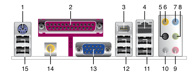

midnightdavid Posted May 18, 2009 Share Posted May 18, 2009 Thanks BlackCH. I will remove dsmos. I kinda suspected I had one too many. The VoodooUSBEHCI is not working with 10.5.7, so it is not there. but I was using it successfully with 10.5.6. 10.5.5, did not need anything other than OpenHaltRestart. For audio, I am attaching pix to show the audio channels. I have no audio issues. Your audio looks great. Mine is just like Popophobia's (one post up). Could you maybe put your audio kexts in a zip file - the ones you marked in orange a few posts back? I'd love to get the audio working better - particularly the front headphone jack which was fine in my 10.5.6 setup but not working now. Thanks, David Link to comment https://www.insanelymac.com/forum/topic/62111-how-to-asus-p5k-vm-guide/page/16/#findComment-1158727 Share on other sites More sharing options...
BlackCH Posted May 18, 2009 Share Posted May 18, 2009 Thanks BlackCH. I will remove dsmos. I kinda suspected I had one too many. The VoodooUSBEHCI is not working with 10.5.7, so it is not there. but I was using it successfully with 10.5.6. 10.5.5, did not need anything other than OpenHaltRestart. For audio, I am attaching pix to show the audio channels. I have no audio issues. I've tried your audio kexts; even though they look good (different names for each device) theres one channel which does not output on my system: 'Headphones' back-panel output doesnt work. I have all three outputs working with the old patched HDA kext (From the P5K-VM package I uploaded before). Are you certain all outputs are working on your system? At this point i'm not sure if i should move ahead with BlackCH's XxX install (from scratch) or try a munky's method retail install. For basic retail setup (I've tried this with a IDE DVD drive; Im not certain it will work with a SATA DVD drive!): Get a 10.5.4 (or later) retail disk (not the one from your macbook!) Get the bootloader image (link from post #362) Get the 10.5.7 P5K-VM package (post #360) or the one from bikinifarm (post #361) Get Chameleon2 installer from its website Get Kexthelper Restore the bootloader image to a memory stick (needs windows, follow included instructions) Insert your retai disk, plug the memory stick Press F8 at boot and select the memory stick from the BIOS boot menu You will see 'MRBStart' and then 'Press any key for setup'. Press any key It will take you to a menu; select 'Boot manager' and there select the OSX install disc It should boot the OSX disc (it takes a few minutes to get to the GUI, you should hear the DVD drive is reading) Format your harddisk as GUID with diskutility. Install the thing. Once is done it will restart. Again press F8 and boot from the memory stick, do the same as before but this time select the partition you installed OSX in, from the 'Boot Manager' menu It should boot to GUI, and you will have to go through the Setup Assistant thing. Do all that. When you finally get to the desktop; run the Chameleon2 installer, select 'Customize' and install ONLY the 'Chameleon Standard' and 'Themes'. After that is done you will find the /Extra folder on the root of the HD. Follow the instructions enclosed on my P5K-VM pack to copy the files/drivers you need to the right places (You can also use the files provided by bikinifarm here). Reboot and this time try booting from your OSX hard disk. You should see chameleon 2 bootloader menu and from there you will be able to select your osx partition. Everything should be working exept for sleep (which can be fixed as bikinifarm explained before). You can apply the 10.5.7 update safely. it will work just fine Link to comment https://www.insanelymac.com/forum/topic/62111-how-to-asus-p5k-vm-guide/page/16/#findComment-1158751 Share on other sites More sharing options...

bikinifarm Posted May 18, 2009 Share Posted May 18, 2009 I've tried your audio kexts; even though they look good (different names for each device) theres one channel which does not output on my system: 'Headphones' back-panel output doesnt work. I have all three outputs working with the old patched HDA kext (From the P5K-VM package I uploaded before).Are you certain all outputs are working on your system? BlackCH - Yeah, they do, all tested. Internal Speakers - green, in the back (#8) Headphones - green in the front of my case connected as HD Audio to the motherboard internal connector Line out - black in the back (#5) Digital out - RCA connector in the back (#14) Internal Microphone - pink in the back - internal microphone (#9) Line-in - Blue line in the back (#7) Link to comment https://www.insanelymac.com/forum/topic/62111-how-to-asus-p5k-vm-guide/page/16/#findComment-1159051 Share on other sites More sharing options...
BlackCH Posted May 18, 2009 Share Posted May 18, 2009 Headphones - green in the front of my case connected as HD Audio to the motherboard internal connector Thanx for the replay. It seems with those kexts the headphones port works on the front panel only, which I dont have... Link to comment https://www.insanelymac.com/forum/topic/62111-how-to-asus-p5k-vm-guide/page/16/#findComment-1159133 Share on other sites More sharing options...
popophobia Posted May 18, 2009 Share Posted May 18, 2009 @bikinifarm: I suppose you use the ALC883 with address 0 for this board (posted in stickpin topic)? There is still lots of error log. I'm using the driver with address 0 and everything works fine, except for the excessive error log. Link to comment https://www.insanelymac.com/forum/topic/62111-how-to-asus-p5k-vm-guide/page/16/#findComment-1159179 Share on other sites More sharing options...
bikinifarm Posted May 18, 2009 Share Posted May 18, 2009 @bikinifarm: I suppose you use the ALC883 with address 0 for this board (posted in stickpin topic)? There is still lots of error log. I'm using the driver with address 0 and everything works fine, except for the excessive error log. I see zero errors in the console. I do believe that I have the address 0, but don't frankly remember. If you check out post #145 and beyond in stickpins postings with link below, the excessive console messages are causes by SMBIOS cracks, and are remedied by AnV's AppleSMBios.kext. stickpin audio In my case, I have removed both SMBIOSResolver and AnV AppleSMBios.kext. I am now solely relying on Cameleon 2.0 RC1 with the smbios.plist that I had posted in post #361. No console messages. No issues. Link to comment https://www.insanelymac.com/forum/topic/62111-how-to-asus-p5k-vm-guide/page/16/#findComment-1159290 Share on other sites More sharing options...
