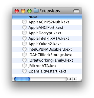

The /Extra folder has the following kexts (available from post #361):
AppleDecrypt.kext
AppleYukon2.kext
Disabler.kext (includes disable for hpet for Firewire to work, but removed the disable for AppleUpstreamUserClientDriver for QT mouse lag fix, as this issue went away with 10.5.7)
dsmos.kext
IOATAFamily.kext for 4 drives
IONetworkingFamily.kext for Yukon
For audio, I use orange marked items from stickpin / tmongkol
+ legacy stuff
+ jmicron with 64 bit support
+ OpenHaltRestart.kext
Everything works with no exceptions that I can see...
AppleDecrypt.kext
AppleYukon2.kext
dsmos.kext
+ legacy stuff

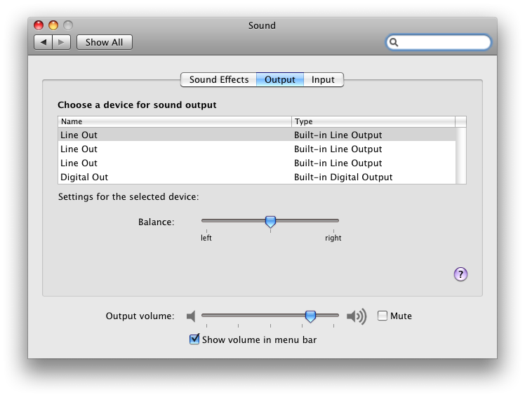

Do you also use the VoodooUSBEHCI.kext? How many audio channels do you get with stickpin kexts?
I notice you have both dsmos and AppleDecrypt; you need just one of those. AppleDecrypt works better I think.
Form 10.5.4 on you dont really need the IOATAFamily.kext to get the 4 SATA ports to work anymore; they work just with the legacy kexts.

@BlackCH: Did you modify the audio kext (ALC883 in XxX install, specifically for P5K-VM board) yourself or you got it somewhere? I want to change the output name to something more unique. Is THe KiNG tutorial the one I should read? Here are my outputs. They all have the same names..
