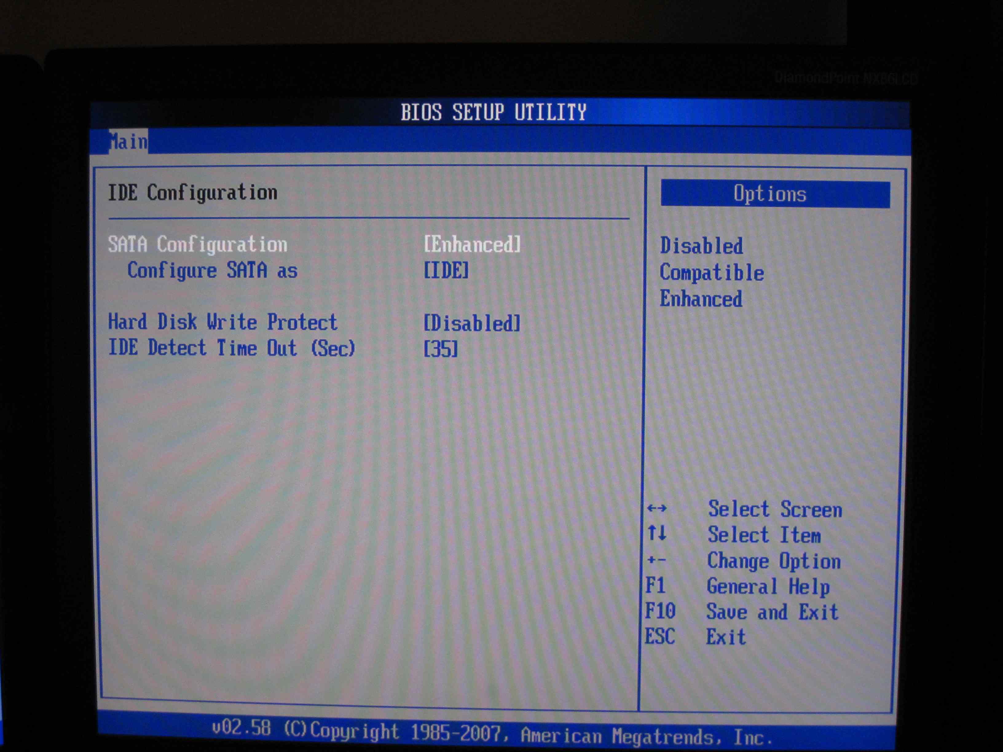

midnightdavid Posted January 20, 2008 Share Posted January 20, 2008 This set of instructions is for an install of Mac OS X 10.5.1 on an ASUS P5K-VM motherboard using a single partition drive for OS X I choose which OS to boot (OS X or XP) by pressing "F8" during the POST and simply selecting the boot drive there Necessary items: 1) iATKOS v1.0i DVD (OS X 10.5.1) 2) Gparted Live CD find it here - http://gparted-livecd.tuxfamily.org/ 3) Kext Helper b7 find it here - http://www.cheetha.net/Kext_Helper/Software.html 4) Installer for the audio find it here - ALC883.pkg.zip 5) kexts to get all 4 SATA ports working (mostly from the Kalyway Leo 10.5.1 DVD I think) find it here - P5K_VM_SATA_kexts.zip I begin by booting the iATKOS DVD with no special boot options needed. That is, I press F8 during POST and select my CDROM drive as the boot device. Once it starts up: Click "Continue"; click "Agree" *=*=* Partition the Disk *=*=* Now at the "Select a Destination" screen I 1) choose "Disk Utility" from the "Utilities" menu 2) select the drive I'm going to use 3) click the "Partition" tab 4) select "Volume Scheme" pop-up and choose "1 Partition" 5) click "Options..." underneath the "Untitled 1" partition 6) select "Master Boot Record" and click "OK" 7) give the volume a name (no spaces or special characters is probably best) Note: I am using "Leopard-28GB" 8) select "Mac OS Extended (Journaled)" as the Format 9) click "Apply" 10) click "Partition" It should partition your drive successfully 11) quit "Disk Utility" *=*=* Determine BSD Name of your new volume *=*=* 12) choose "System Profiler" from the "Utilities" menu 13) select the Serial-ATA or ATA item from the "Contents" column 14) select the drive you just used to create your OS X partition 15) write down (You will need this in a minute) the "BSD Name" of your volume note: mine (on the ATA Device Tree) is "disk1s1" 16) quit "System Profiler" *=*=* Install the bootloader *=*=* 17) choose "Darwin_Boot" from the Utilities" menu 18) click on the terminal window, read the text about BSD names and 19) continue by typing Y My drive's BSD name was disk1s1 so -> my harddisk number is 2 and my partition number is 1 YOURS MAY BE DIFFERENT 20) I type 2 as answer to "Enter target HDD number" 21) I type 1 as answer to "Enter Partition number" The Darwin_Boot application looks at that drive/partition and tells you what it finds. mine responded: /dev/disk1s1 on /Volumes/Leopard-28GB (hfs, local, journaled) 22) I type Y as answer to "Do you want to install boot efi?" 23) I type Y as answer to "Are you sure?" It takes a few seconds to finish but the text should end with "[Process completed]" 24) quit "Terminal" *=*=* Install iATKOS *=*=* 25) select the destination disk (the one we just created) Note: mine is Leopard-28GB 26) click "Continue" 27) select "Customize" at "Install Summary" 28) click the triangle and open up the "Additional Patches" item 29) select "EFI Emulation" in "Additional Patches" I have not selected any of the other customizations. I am not using the on board video but you may need one or more of these video packages As my last step I will install my needed video kexts My customization recap: I have selected iATKOS v1.0i Main System EFI Emulation Stock Kernel Stock AppleACPIPlatform.kext 30) select "Done" 31) click "Install" 32) may as well the the installer "Check the Installation DVD" (at least once) note: I skip this now I have done this so many times... The install takes 10 minutes or so NOTE: when the installation finishes and the system restarts keep in mind that WE ARE NOT DONE and THE OS X DISK WILL NOT BOOT (yet) As the system reaches the POST screen I press F8 so I can again boot from the CDROM drive Before continuing with the boot eject the iATKOS DVD and insert the Gparted Live CD So we are now starting up from the Gparted CD to Edit the OS X Partition *=*=* Set the boot flag on the OS X drive *=*=* 33) Choose the default setting "GParted-liveCD 0.3.4-11 (auto-configuration) by pressing "Enter" 34) "Load keymap (Enter for default)" - I press "Enter" 35) "Load keymap (language)" - I press "Enter" for US English the boot completes; GParted starts up and scans for drives 36) using the mouse I select the "GParted" menu and hilight "Devices" 37) I select my OS X disk (which I can identify by it size - 28.62 GiB) note: my other drives are 150GB and up, so this was easy 38) click on the drive (the line of text describing the drive) 39) select the "Partition" menu and select "Manage Flags" 40) click on "boot" in the "Manage Flags" window 41) click "Close" 42) select the "GParted" menu and select "Quit" 43) Shutdown the computer (just hold the power key down) *=*=* Here we go - OS X 10.5.1 *=*=* 44) Start up computer - press "F8" to select your OS X drive and... note: you can remove the GParted CD 45) boot it up! My keyboard is not identified by OS X so I have to press "z" and "/" during the first boot Go through all the setup stuff and we arrive at the desktop... *=*=* First things first - Get the Network up *=*=* 46) I followed these instructions from Delish (nice shoes - ruby slippers? "There's no place like home") in post #1... note that AppleYukon is now AppleYukon2 - - - - - - Modify entries in: IONetworkingFamily.kext/Contents/PlugIns/AppleYukon.kext/Contents/Info.plist Change: <key>Yukon-88E8053</key> to <key>Yukon-88E8056</key> <string>0x436211AB</string> to <string>0x436411AB</string> <string>Yukon Gigabit Adapter 88E8053</string> to <string>Yukon Gigabit Adapter 88E8056</string> - - - - - - This means: open your hard disk and go to System/Library/Extensions find the file "IONetworkingFamily.kext" right-click (or ctrl-left click) and select "Show Package Contents" find the "AppleYukon2.kext" file inside the "Contents/Plugins" folders right-click (or ctrl-left click) and select "Show Package Contents" find the "Info.plist" file inside the "Contents" folder open the "Info.plist" file with TextEdit make the TextEdit window wide enough so none of the lines of text wrap scroll down 3/4 toward end of file and find the line "<key>Yukon-88E8053</key>" change the "3" to a "6" so the line looks like "<key>Yukon-88E8056</key>" about 10 lines farther down is the line "<string>0x436211AB</string>" change the "2" to a "4" so the line looks like "<string>0x436411AB</string>" six lines down is the line "<string>Yukon Gigabit Adapter 88E8053 Singleport Copper SA</string>" change the "3" to a "6" so the line looks like "<string>Yukon Gigabit Adapter 88E8056 Singleport Copper SA</string>" Save the file to the desktop by Choosing "Save As" and "Info.plist" as the filename (Select "Use .plist" if a dialog comes up) Quit TextEdit Drag & Drop the "Info.plist" file from the desktop to the "Content" folder the original came from - That would be -> System/Library/Extensions/IONetworkingFamily.kext/Contents/PlugIns/AppleYukon2.kext/Contents note: this window is probably still open in the finder click "Authenticate" click "Replace" type your password and click OK Run "Disk Utility" - it is in Applications/Utilities Select your drive and "Repair Permissions" Restart the computer - don't forget to press "F8" and select the correct boot drive *=*=* This is a good time to download the files at the top *=*=* 47) Kext Helper b7 - http://www.cheetha.net/Kext_Helper/Software.html 48) installer for audio - ALC883.pkg.zip 49) kexts needed to get all 4 SATA ports working - P5K_VM_SATA_kexts.zip *=*=* Now the Audio kext *=*=* 50) Run the "ALC883" Installer Package 51) The sound should work now - go check by selecing your favorite "Alert Sound" in the "Sound" System Preference *=*=* Time to get the other SATA ports working *=*=* 52) run Kext Helper (it should be in the "Downloads" folder. Check the right side of the dock 53) drag & drop "AppleAHCIPort.kext", "AppleLPC.kext", "IOACHIFamily.kext", "IOATAFamily.kext" and "AppleVIAATA.kext" into the Kext Helper window 54) enter you administrator password and click "EASY INSTALL" 55) click "OK" (and "OK" when it is done) and reboot - remember to select your startup drive with "F8" And I think that'll do it! I will post how I got my ATI Radeon HD2600 Pro 512mb working shortly. Good luck! -David David, I am sitting here chewing my fingernails to the bone, I want to try this so bad.One question I have is this.Will I be able to install this and get it working witha regular IDE DVD drive?I do not have a SATA optical drive so please let me know if there is a way to do this without having to go buy a SATA opticalI don't know - my DVD drive is SATA. But, the install I just did was onto an ancient IDE drive... same controller, right? So my guess is yes. Link to comment https://www.insanelymac.com/forum/topic/62111-how-to-asus-p5k-vm-guide/page/6/#findComment-586837 Share on other sites More sharing options...

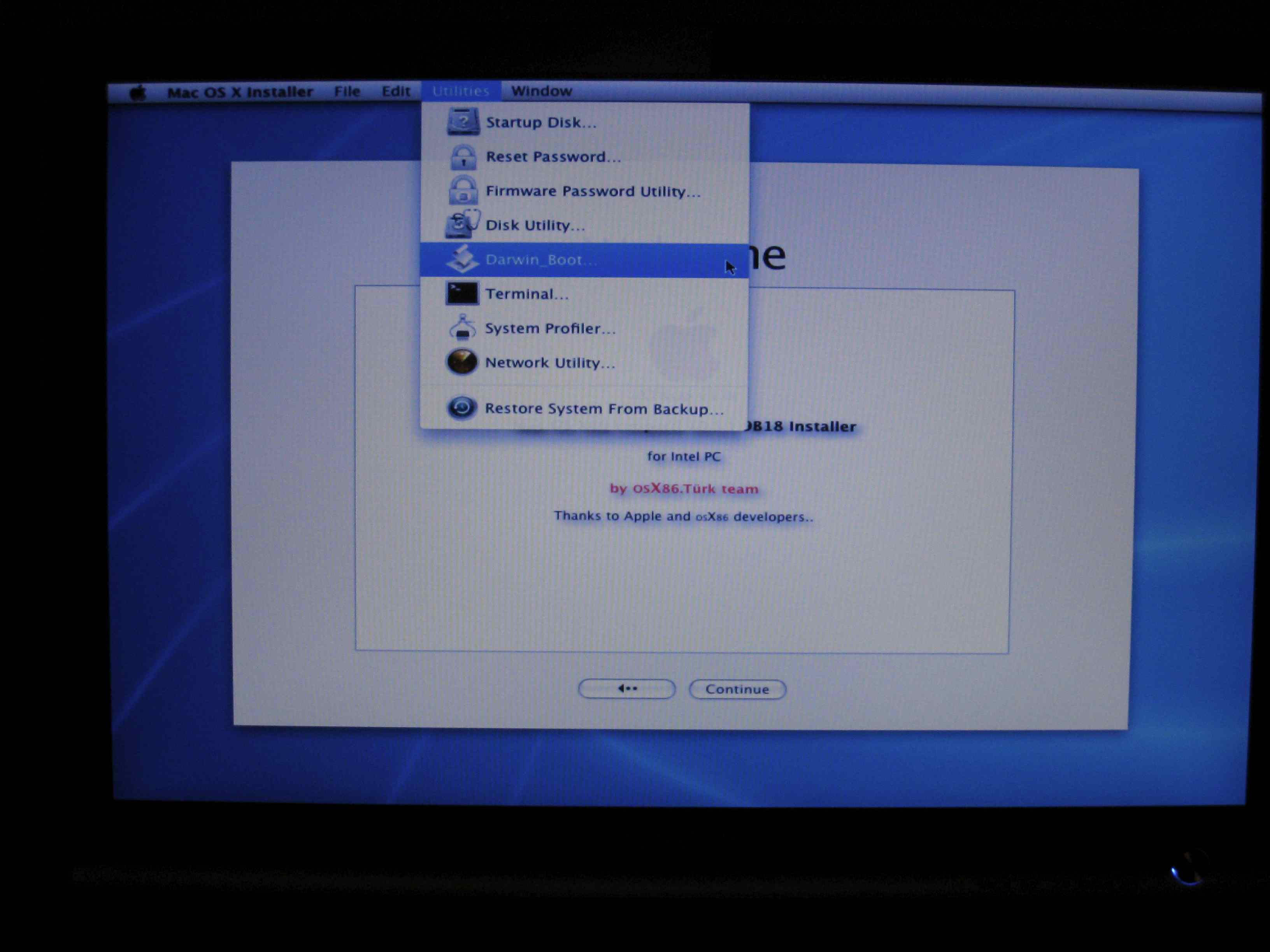

Team Scream Posted January 20, 2008 Share Posted January 20, 2008 Flag on the play for me! *=*=* Install the bootloader *=*=* 17) choose "Darwin_Boot" from the Utilities" menu 18) click on the terminal window, read the text about BSD names and 19) continue by typing Y " Where do I do this, after I quit system profiler, there is no "choose Darwin_Boot" in the utilities menu? (step 17) You lost me here David, since I cannot see this option, what do I do? Link to comment https://www.insanelymac.com/forum/topic/62111-how-to-asus-p5k-vm-guide/page/6/#findComment-587090 Share on other sites More sharing options...
midnightdavid Posted January 20, 2008 Share Posted January 20, 2008 Flag on the play for me! *=*=* Install the bootloader *=*=* 17) choose "Darwin_Boot" from the Utilities" menu 18) click on the terminal window, read the text about BSD names and 19) continue by typing Y " Where do I do this, after I quit system profiler, there is no "choose Darwin_Boot" in the utilities menu? (step 17) You lost me here David, since I cannot see this option, what do I do? "Darwin_Boot..." is a shell script(?) that runs in Terminal. It is right under "Disk Utility..." and two items above "System Profiler" in the "Utilities" item in the main menu bar (this is where you selected the System Profiler application, right?) After you quit "System Profiler" you should come back to the installer screen exactly where you were before choosing something from the "Utilities" menu - David Link to comment https://www.insanelymac.com/forum/topic/62111-how-to-asus-p5k-vm-guide/page/6/#findComment-587133 Share on other sites More sharing options...
Team Scream Posted January 21, 2008 Share Posted January 21, 2008 I see on your posted image that it should be there but in my setup it is not there, I do not have "Darwin_Boot" as an option even grayed out. Link to comment https://www.insanelymac.com/forum/topic/62111-how-to-asus-p5k-vm-guide/page/6/#findComment-587208 Share on other sites More sharing options...
midnightdavid Posted January 21, 2008 Share Posted January 21, 2008 I see on your posted image that it should be there but in my setup it is not there, I do not have "Darwin_Boot" as an option even grayed out. Hmmm. I don't know what to say. The DVD I was working with came from a 2.44GB iso file named "iATKOS_v1.0i.iso" The file "iATKOS_v1.0i.iso" is exactly 2,621,407,232 bytes long. I burned it to a DVD using Toast on another mac (Dual G4 MDD 1.42Ghz, not that it matters). You must have a different iATKOS DVD. Perhaps you can find the same one I used? I'm not sure - it has been at least a week and I don't remember - but it might have been called something like "iATKOS v1.0i OSx86 Leopard 10.5.1 + EFI+ Boot Loader" or perhaps just "iATKOS v1.0i" Note that when zipped the .iso file will be smaller than 2.44 GB. I dunno... maybe around ** 2.09 GB **? - David Link to comment https://www.insanelymac.com/forum/topic/62111-how-to-asus-p5k-vm-guide/page/6/#findComment-587261 Share on other sites More sharing options...

aspirina750 Posted January 21, 2008 Share Posted January 21, 2008 Probably you´re using the iAtkos 1.0r2, with this one you don´t need to do the darwin part anymore Link to comment https://www.insanelymac.com/forum/topic/62111-how-to-asus-p5k-vm-guide/page/6/#findComment-587698 Share on other sites More sharing options...
Team Scream Posted January 21, 2008 Share Posted January 21, 2008 Probably you´re using the iAtkos 1.0r2, with this one you don´t need to do the darwin part anymore Yes you are right I was using the r2 version but even after I got it all the way installed, it would still hang on the reboot and I could never get any further. It has been up and running over night now with the kalyway and everything seems fine. Link to comment https://www.insanelymac.com/forum/topic/62111-how-to-asus-p5k-vm-guide/page/6/#findComment-587909 Share on other sites More sharing options...
aspirina750 Posted January 21, 2008 Share Posted January 21, 2008 Yes you are right I was using the r2 version but even after I got it all the way installed, it would still hang on the reboot and I could never get any further.It has been up and running over night now with the kalyway and everything seems fine. The only problem I had with iAtkos was the HFS error after the first reboot, solved that, installed the kext and everything works well. Right now my only concern is the CPU temperature, I just installed an Artic Cooler Freezer 7 pro cooler but Temperature Monitor gives me the same readings as with the Stock Intel cooler. Weird, I´ll try deleting the temp kext, but I really hate this, I was getting ready to star OCíng this baby. Link to comment https://www.insanelymac.com/forum/topic/62111-how-to-asus-p5k-vm-guide/page/6/#findComment-588310 Share on other sites More sharing options...
NextMac Posted January 21, 2008 Share Posted January 21, 2008 @ midnightdavid hi my problem are the 4-ATA Port´s - i get only 2 can you post your Kext Folder ? I tested your P5K_VM_SATA_kexts.zip but its dosn´t work What are your Bios settings AHCI or IDE Thanks for the Info Link to comment https://www.insanelymac.com/forum/topic/62111-how-to-asus-p5k-vm-guide/page/6/#findComment-588429 Share on other sites More sharing options...
midnightdavid Posted January 23, 2008 Share Posted January 23, 2008 @ midnightdavid hi my problem are the 4-ATA Port´s - i get only 2 can you post your Kext Folder ? I tested your P5K_VM_SATA_kexts.zip but its dosn´t work What are your Bios settings AHCI or IDE Thanks for the Info There are a zillion kexts in the Extensions folder - is this what you mean? I'll post a list of them (names + dates) when I have a chance. (This is a busy work week for me). I suspect, if the kexts I posted before don't work for you, some other kext I have must be needed. I used that diffmerge program to compare my kexts (that didn't get all 4 SATA working) with the Kalyway DVD (which showed all SATA drives as available for the install, which demonstrated that they had the right assortment of kexts). I have no way of knowing which others might be needed if they were the same on both the iATKOS & Kalyway DVDs I have. But I bet your install DVD is different. BIOS & IDE info: Basically everything is default - I think the only change I made in the BIOS was manually setting the FSB freq. up to 367 mhz. - David Link to comment https://www.insanelymac.com/forum/topic/62111-how-to-asus-p5k-vm-guide/page/6/#findComment-589895 Share on other sites More sharing options...
NextMac Posted January 23, 2008 Share Posted January 23, 2008 @ midnightdavid Thanks for your quick Post . My Bios it´s the same. so I still waiting and try it again. Wish you a nice Day .... The Day went by .... I´ve got it ! All 4 S-ATA ports now are working. I don´t know what if done !? Tanks for your help Link to comment https://www.insanelymac.com/forum/topic/62111-how-to-asus-p5k-vm-guide/page/6/#findComment-590392 Share on other sites More sharing options...
