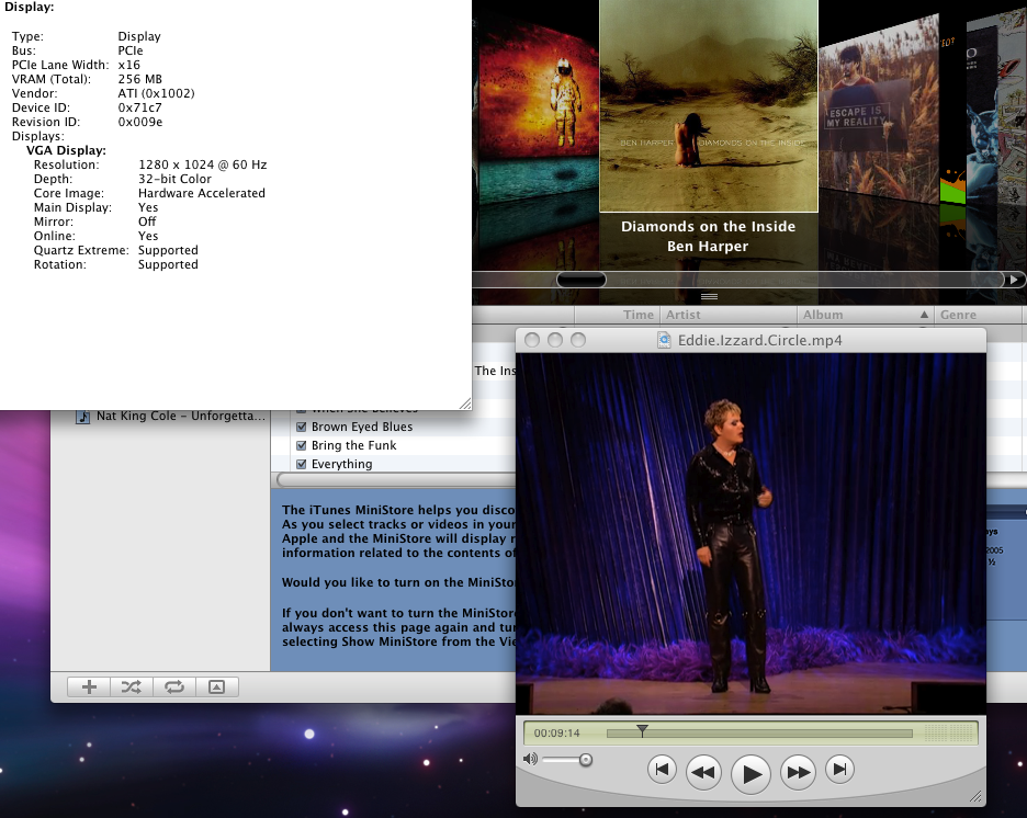

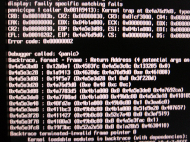

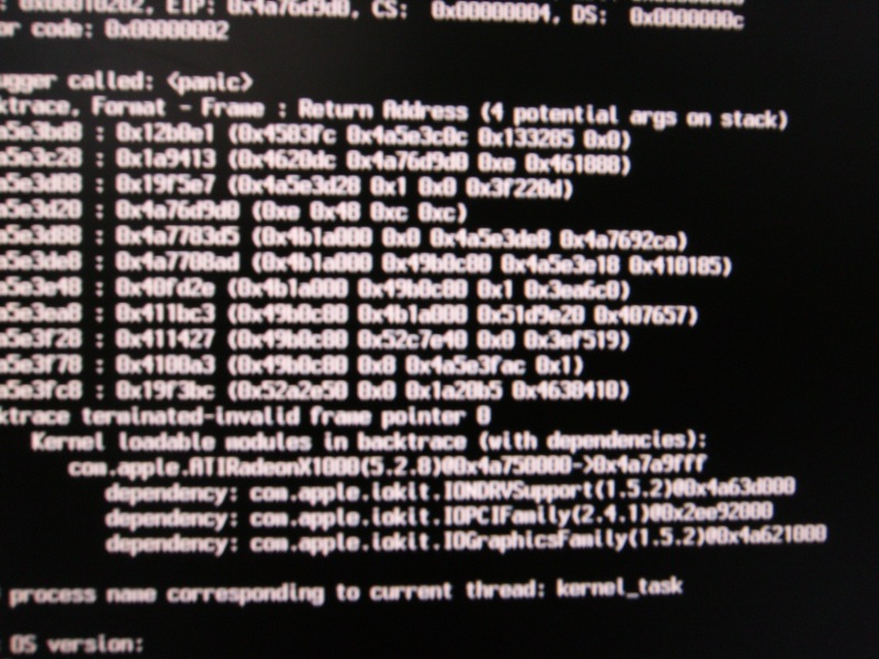

incitatus Posted July 2, 2008 Share Posted July 2, 2008 Well... Here's my latest if anyone can help. Everything is running nominally EXCEPT the blasted video card.I jotted down some info from Ubuntu Hardware Info, which is very informative in case it helps as well. Below are pics of the kernel panic I received after doing the following:My system already has 10.5.4 update installed and patched via Zephy's AMD Update Util. I installed modbin's 10.5.3 pkg by extracting the 3 files (ATIRadeonX1000.kext, ATINDRV.kext & IONDRVSupport.kext) I modified ATIRadeonX1000.kext by adding 0x71C71002 to IOPCIMATCH section. I installed the three kexts using Kext Helper b7, which automatically repairs permissions, etc. I cleared the kextcaches, then rebooted. Boots fine until 'display: family specific matching fails' Ubuntu's Hardware Info: Radeon X1650 Series (two output nodes) RV535, PID=71c7, SubsysID=e020, SubsysVID=174b, VID=1002 RV535, PID=71e7, SubsysID=e021, SubsysVID=174b, VID=1002 Not really sure if that could help or not. Everything else system wise is in my sig. Any thoughts anyone? Thanks! Link to comment Share on other sites More sharing options...
chico_stang Posted July 2, 2008 Share Posted July 2, 2008 Incitatus, you have the same video card as me. I don't know why you are having problems. If you've done everything correctly, and still doesn't work, I suggest (if you want) to make a clean install of 10.5.2. After that, don't install anything. Then, update to 10.5.3 using ASU 0.5. Now, download Modbin's 10.5.3 installer, and install it, but don't reboot. Then open ATIRadeonX1000.kext and add your Device ID (and remember, replace only the first "0x71C61002" with yours, in this case "0x71C71002". After that, save the file, and run Extensions Repair. Now reboot. If you did everything correctly, it should work. By the way, if you are using DVI, try using VGA. Link to comment Share on other sites More sharing options...

incitatus Posted July 2, 2008 Share Posted July 2, 2008 Wow! That shut me up. It worked! hurray! After many installs later. Thank god I didn't even have to reinstall this last time. I had already installed 10.5.4 via Zephy's ASU. I just removed the kexts this time bc apparently when installing modbin's patch, it was not overwriting the previous kexts. I always added the devID, but it was not patched!! Now it's patched and I have full resolutions, video, front row, and itunes coverflow. PS. I used the DVI output with a VGA splitter. Thank you chico_stang, modbin & kozlowski!!!! Now when&IF someone corrects DVI or multiple monitors, PLEASE let us all know... Thanks aGain! PS. I did not install the ATIinject, but it works now fully! Link to comment Share on other sites More sharing options...
