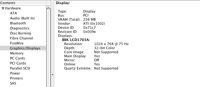

I have a 0x71c7 x1650
pcie and 256megs
None of the methods available allowed it to work.
Downloaded a x1600 pro bios 0x71c2 and flashed it with that
Installed natit and put the device id in atiradeonx1000.kext and it came right up with qe/ci.
Have fun
Make sure to use atiflash in dos.. Tried atiwinflash and it didnt enable qe/ci. I dont know why, but I could try to change my device id with atiwinflash and it would stay c7. So just use the dos flasher.

i have 71c7 pcie 256mb using atiinject.kext and hexediting the binary;and now qe/ci,rotation,resolution change,dvi(i use this) no mouse tearing all work execpt mirror(what is this for??)dual display not tested
