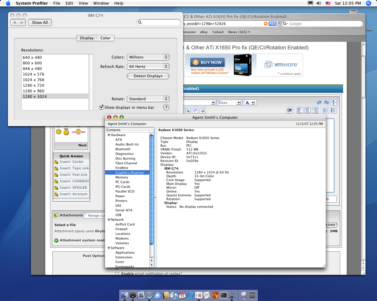

coccolino_dbro Posted November 3, 2007 Share Posted November 3, 2007 I have QE/CI and all resolutions available on HIS Ati Radeon X1650PRO with 512MB (id 0x71c1). The system version is 10.4.8 (Jas), and I used the file attached in this post, http://forum.insanelymac.com/index.php?sho...2826&st=49# (made a little package with it), and Natitx1600. Link to comment Share on other sites More sharing options...

TaurusDJ Posted November 29, 2007 Share Posted November 29, 2007 Hello to everyone! I've finally made to work my Sapphire X1650PRO PCI-E 256Mb GDDR3 (ID: 0x71C1) on Tiger 10.4.10 The Kozlowski method didn't work for my card before the upload of the new fix for 0x71C1; now all is working properly (QE/CI/Rotation). I've manually copied all the kext files from the MODBIN package for kernel 8.10.1 to /System/Library/Extensions/ then I've overwritten in the same dir all the kexts included in the new fix for 0x71C1. Finally, after the usual operations (chown, chmod, ecc.), I've rebooted and... EVERYTHING IS OK! NO MORE KERNEL PANIC AND NO NEED FOR NATIT KEXTS... Thank you for this post!!! Link to comment Share on other sites More sharing options...
