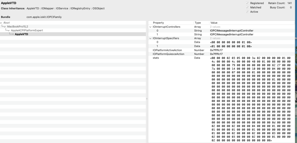

schrup21 Posted October 9, 2025 Share Posted October 9, 2025 6 hours ago, KGP-iMacPro said: @ichelash, I already posted here in this thread twice the short version of how I managed to get both working on my system. Here the link to the happy end of the long version. Good to know, that IntelLucy works with VTD enabled in Tahoe - IntelMausiEthernet does not. Link to comment https://www.insanelymac.com/forum/topic/361710-broadcom-fullmac-wi-fi-support-on-macos-sonoma-sequoia-and-tahoe-without-root-patches/page/7/#findComment-2841995 Share on other sites More sharing options...
Mieze Posted October 9, 2025 Share Posted October 9, 2025 (edited) @schrup21 In principle, all my drivers (IntelMausiEthernet, IntelLucy, LucyRTL8125Ethernet, RTL8111Ethernet and AtherosE2200) work with AppleVTD under Tahoe but you need a mainboard that works properly with AppleVTD under Tahoe too. Unfortunately, Apple has changed something with regard to AppleVTD so that some boards, which used to work fine with AppleVTD in the past, now refuse to work with it and vice versa. Also keep in mind that rolling back IOSkywalkFamiliy.kext may break AppleVTD support as @KGP-iMacPro recently discovered (see here). Mieze 😺 Edited October 9, 2025 by Mieze 4 1 Link to comment https://www.insanelymac.com/forum/topic/361710-broadcom-fullmac-wi-fi-support-on-macos-sonoma-sequoia-and-tahoe-without-root-patches/page/7/#findComment-2842020 Share on other sites More sharing options...

schrup21 Posted October 10, 2025 Share Posted October 10, 2025 17 hours ago, Mieze said: @schrup21 In principle, all my drivers (IntelMausiEthernet, IntelLucy, LucyRTL8125Ethernet, RTL8111Ethernet and AtherosE2200) work with AppleVTD under Tahoe but you need a mainboard that works properly with AppleVTD under Tahoe too. Unfortunately, Apple has changed something with regard to AppleVTD so that some boards, which used to work fine with AppleVTD in the past, now refuse to work with it and vice versa. Also keep in mind that rolling back IOSkywalkFamiliy.kext may break AppleVTD support as @KGP-iMacPro recently discovered (see here). Mieze 😺 I'm aware that Apple's changes in Tahoe are the cause - everything works fine until Sequoia. However, AppleVTD seems to be working for me (AppleVTD can be found in IOService, BCMC is working without issues). Since I'm using BCMC WiFi, a rollback of IOSkywalkFamily.kext is not performed (my root volume is indeed sealed/untouched). For me it looks like IntelMausiEthernet is indeed working (kextstat shows the KEXT is loaded) but the LAN interface keeps crashing if you connect the LAN cable. Apparently the negotiation is not successful. kextstat: Spoiler IOService Spoiler I can live with the restriction, my device is a laptop - I only need the LAN IF occasionally and then I switch my config. 😊 Link to comment https://www.insanelymac.com/forum/topic/361710-broadcom-fullmac-wi-fi-support-on-macos-sonoma-sequoia-and-tahoe-without-root-patches/page/7/#findComment-2842039 Share on other sites More sharing options...
Mieze Posted October 10, 2025 Share Posted October 10, 2025 1 hour ago, schrup21 said: For me it looks like IntelMausiEthernet is indeed working (kextstat shows the KEXT is loaded) but the LAN interface keeps crashing if you connect the LAN cable. Apparently the negotiation is not successful. kextstat: You are on a wrong track. With AppleVTD enabled, DMA buffers must be properly mapped by the IOMMU to allow DMA access by the NIC. If this doesn't work, the read/write access from/to the buffer will be blocked by the IOMMU at the hardware level and there will be no data transmission. That's what happens after the cable is plugged in. Now, the driver steps in, realises that there is no progress in data transmission, although there are buffers, a.k.a. packets, waiting to be transmitted and assumes a tx deadlock. In order to recover from this situation, it performs a chip reset and the cycle starts again. Mieze 😺 2 1 Link to comment https://www.insanelymac.com/forum/topic/361710-broadcom-fullmac-wi-fi-support-on-macos-sonoma-sequoia-and-tahoe-without-root-patches/page/7/#findComment-2842042 Share on other sites More sharing options...

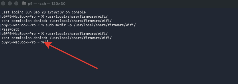

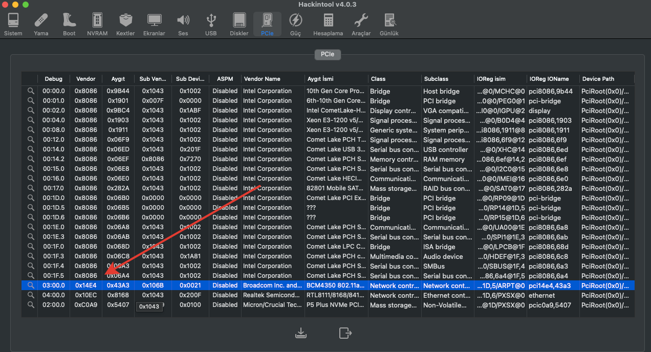

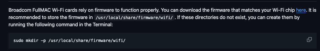

XanthraX Posted October 10, 2025 Share Posted October 10, 2025 On 9/28/2025 at 7:23 PM, HyperX7 said: What is the probability of this card working? I want to try according to the return I will receive from you. Thank You! How can I copy the firmware files to the /usr/local/share/firmware/wifi/ location. Terminal said permission denied. Open Finder. Press Cmd+Shift+G. In the dialog, type /usr/local/share. It will open the folder. Check if you have the folder firmware inside. If not, make one with Cmd+Shift+N and name it firmware. Open it and create another folder and rename it wifi. Open it and copy the firmware bin there. if asks for password type it. Link to comment https://www.insanelymac.com/forum/topic/361710-broadcom-fullmac-wi-fi-support-on-macos-sonoma-sequoia-and-tahoe-without-root-patches/page/7/#findComment-2842045 Share on other sites More sharing options...
pkdesign Posted October 10, 2025 Share Posted October 10, 2025 I think you mean /usr/share Link to comment https://www.insanelymac.com/forum/topic/361710-broadcom-fullmac-wi-fi-support-on-macos-sonoma-sequoia-and-tahoe-without-root-patches/page/7/#findComment-2842063 Share on other sites More sharing options...
Henties Posted October 10, 2025 Share Posted October 10, 2025 @pkdesign Me thinks not. The OP recommends to use /usr/local/share/firmware/wifi/ as the repository/placehoder for the NEW firmaware which the AppleBCMWLANCompanion.kext needs/loads to make all this new WiFi magic come to life. Greetings Henties Link to comment https://www.insanelymac.com/forum/topic/361710-broadcom-fullmac-wi-fi-support-on-macos-sonoma-sequoia-and-tahoe-without-root-patches/page/7/#findComment-2842070 Share on other sites More sharing options...

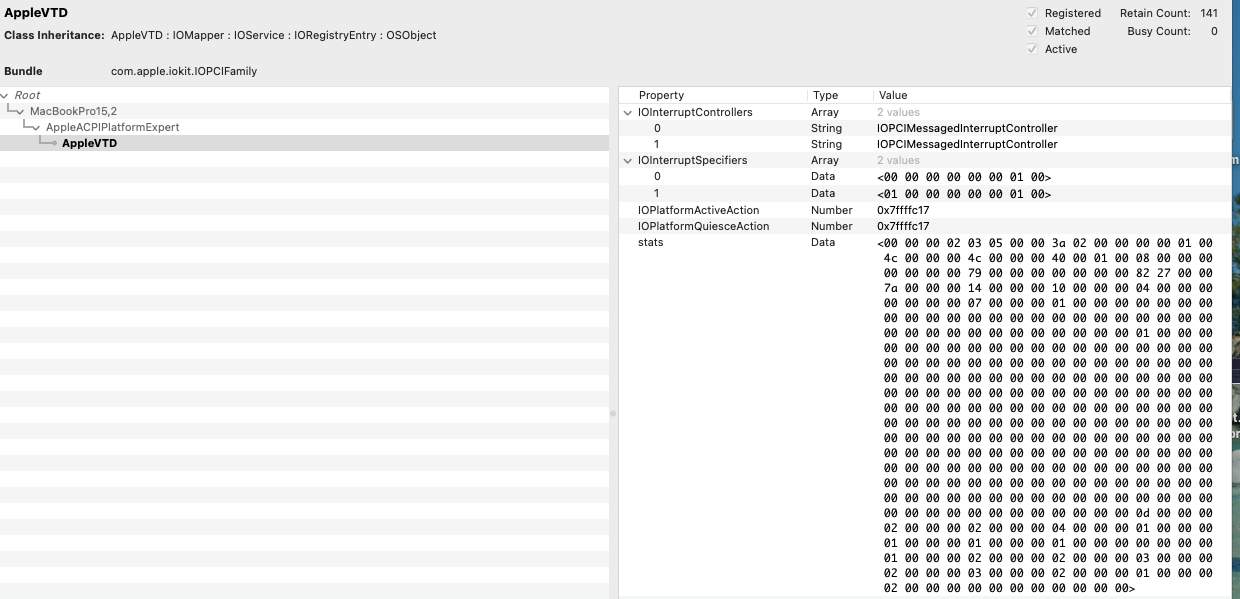

schrup21 Posted October 11, 2025 Share Posted October 11, 2025 22 hours ago, Mieze said: DMA buffers must be properly mapped by the IOMMU to allow DMA access by the NIC Thank you very much for explaining! So could it be, that Tahoe "expects" some reserved memory regions that aren't there? In other words, we are using our machine's DMAR.aml (maybe patched) - but a real MAC has it's own DMAR, containing reservations that are different of ours. Or is the DMA buffers mapping not connected to DMAR at all? Link to comment https://www.insanelymac.com/forum/topic/361710-broadcom-fullmac-wi-fi-support-on-macos-sonoma-sequoia-and-tahoe-without-root-patches/page/7/#findComment-2842083 Share on other sites More sharing options...
deeveedee Posted October 11, 2025 Share Posted October 11, 2025 @schrup21 I did look at the DMAR table from a real MacMini8,1 when I was looking at this for my hack. Maybe something in this thread will give you ideas. 2 Link to comment https://www.insanelymac.com/forum/topic/361710-broadcom-fullmac-wi-fi-support-on-macos-sonoma-sequoia-and-tahoe-without-root-patches/page/7/#findComment-2842097 Share on other sites More sharing options...
FirstCustomac Posted October 11, 2025 Share Posted October 11, 2025 As far as I can remember, AppleVTD was also broken with some systems with macOS Ventura 13.3 back then, but @Casey_S.J. came up with the patch to fix it. Perhaps, we need something like this patch for macOS Tahoe? Link to comment https://www.insanelymac.com/forum/topic/361710-broadcom-fullmac-wi-fi-support-on-macos-sonoma-sequoia-and-tahoe-without-root-patches/page/7/#findComment-2842106 Share on other sites More sharing options...
deeveedee Posted October 11, 2025 Share Posted October 11, 2025 @FirstCustomac Could be. His patch is now kernel quirk DisableIoMapperMapping. 1 Link to comment https://www.insanelymac.com/forum/topic/361710-broadcom-fullmac-wi-fi-support-on-macos-sonoma-sequoia-and-tahoe-without-root-patches/page/7/#findComment-2842107 Share on other sites More sharing options...
