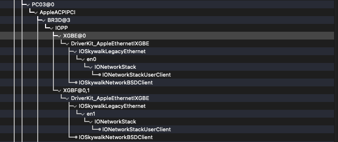

meg2014 Posted October 5, 2025 Share Posted October 5, 2025 (edited) Success on Sequoia! (I'll try Tahoe later). i have a FullMac adapter (BCM43602) and it works with this configuration. Nice! There were no real problems, just took my time to make sure my config was setup correctly, one reboot later, WIFI... The only issue is that I have a 10G Ethernet interface and so the wireless interface will probably not get much use......but it's still nice to have. And, I also have this drive encrypted and did the WiFi install after I encrypted it. For FileVault, I do have to load apfs_aligned every time I boot, but that doesn't bother me and login is simple and smooth. The encryption did not interfere at all with this WiFi config. Thanks! Edited October 5, 2025 by meg2014 1 Link to comment https://www.insanelymac.com/forum/topic/361710-broadcom-fullmac-wi-fi-support-on-macos-sonoma-sequoia-and-tahoe-without-root-patches/page/5/#findComment-2841761 Share on other sites More sharing options...

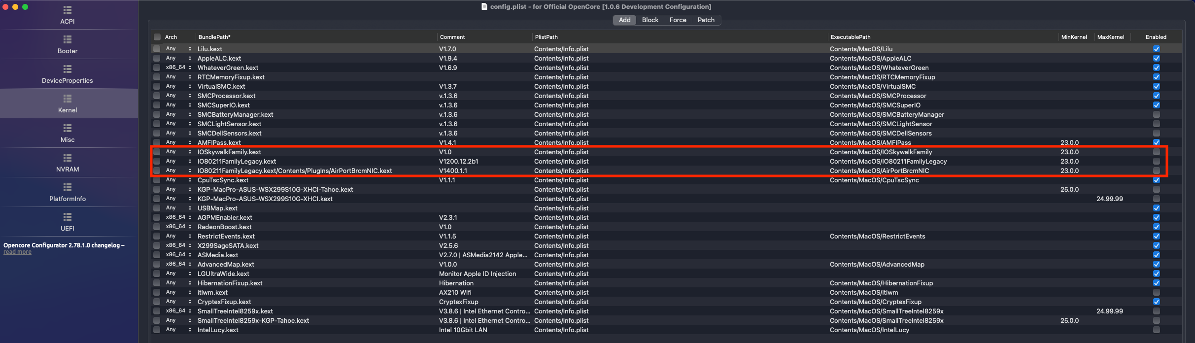

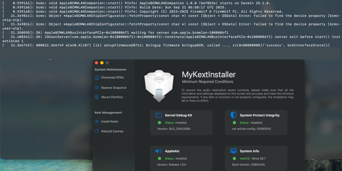

cloudy Posted October 5, 2025 Share Posted October 5, 2025 (edited) @schrup21, After applying MyKextinstaller, my computer starts booting, then immediately reboots and freezes. I've tried several times, but the same thing happens. I can't even boot into Tahoe. As I said in the previous post, it seems that BCMC and MyKextinstaller cannot be applied together. [edit] I am on Tahoe 26.1 Edited October 5, 2025 by cloudy Link to comment https://www.insanelymac.com/forum/topic/361710-broadcom-fullmac-wi-fi-support-on-macos-sonoma-sequoia-and-tahoe-without-root-patches/page/5/#findComment-2841762 Share on other sites More sharing options...

kgp Posted October 5, 2025 Share Posted October 5, 2025 (edited) I am also now fully set for this project and have either DEXT DriverKit or Intellucy working with VT-D and IOMMU and DisableIOMapper=false. The sweet bitter irony was that just the com.apple.iokit.IOSkywalkFamily manoeuvre for the OCLP-WIFI patch was the culprit for all related X550-AT2 problems. If I disable and disable everything works as expected. No other changes have been necessary in my EFI-Folder to make DEXT DriverKit and IntelLucy work with DisableIOMapper=false. Thus, it seems that this project just popped up at the right moment. I already received a BCM943602CS and a BCM943602CDP and I am just waiting for the respective PCIe adapters. Happy to join this exciting project soon... Edited October 6, 2025 by KGP-iMacPro Link to comment https://www.insanelymac.com/forum/topic/361710-broadcom-fullmac-wi-fi-support-on-macos-sonoma-sequoia-and-tahoe-without-root-patches/page/5/#findComment-2841781 Share on other sites More sharing options...

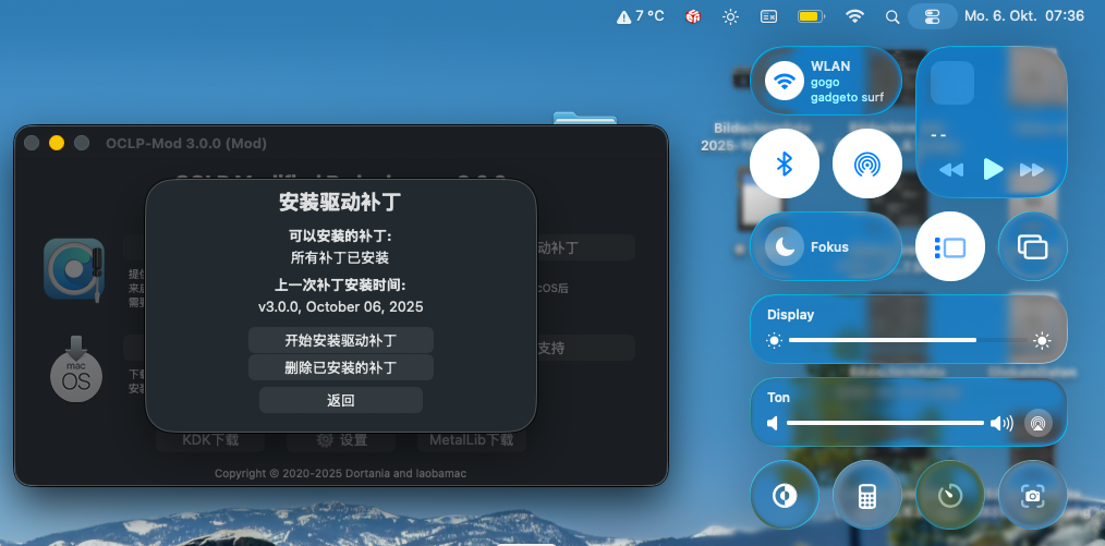

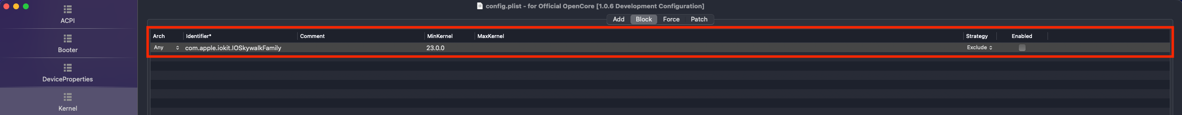

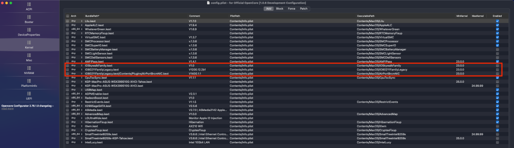

schrup21 Posted October 6, 2025 Share Posted October 6, 2025 10 hours ago, cloudy said: it seems that BCMC and MyKextinstaller cannot be applied together. I don't know what's causing your problem, but your conclusion is wrong - BCMC together with AppleHDA via MyKextInstaller: Spoiler BCMC together with OCLP-Mod Audio Patch: Spoiler Audio and WiFi are working fine with both 😉 1 Link to comment https://www.insanelymac.com/forum/topic/361710-broadcom-fullmac-wi-fi-support-on-macos-sonoma-sequoia-and-tahoe-without-root-patches/page/5/#findComment-2841796 Share on other sites More sharing options...

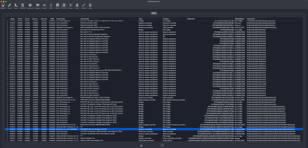

sanigo Posted October 6, 2025 Share Posted October 6, 2025 The 43602 got workable now. But the AppleVTD kill my usb, don't know why. Now only one usb2 port remain work. I have tried to use usbmapper to remapp, but the port could not be detected. Link to comment https://www.insanelymac.com/forum/topic/361710-broadcom-fullmac-wi-fi-support-on-macos-sonoma-sequoia-and-tahoe-without-root-patches/page/5/#findComment-2841809 Share on other sites More sharing options...

schrup21 Posted October 6, 2025 Share Posted October 6, 2025 (edited) @sanigo What do you mean with "usbmapper" - USB Toolbox? I don't see how the mapping could affect this (and not without AppleVTD). Dropping DMAR could eventually create such an issue - @Mieze explained in the IntelMausiEthernet topic that the manufacture (of the mobo) had a reason to add reserved memory regions to DMAR. @cloudy I guess that MyKextInstaller doesn't show the latest installed version. It is atm still showing 25A5338b while OCLP-Mod Installed 25B5042k (I switched to OCLP-Mod because for AppleHDA it doesn't make any difference if you use OCLP-Mod or MyKextInstaller - both are patching your root fs) Switched back to MyKextInstaller. This time I deleted all KDKs and installed the latest (updated to 26.1 Beta 2) - now it's showing the correct version 26.1_25B5057f . Edited October 6, 2025 by schrup21 Link to comment https://www.insanelymac.com/forum/topic/361710-broadcom-fullmac-wi-fi-support-on-macos-sonoma-sequoia-and-tahoe-without-root-patches/page/5/#findComment-2841836 Share on other sites More sharing options...

Anto65 Posted October 6, 2025 Share Posted October 6, 2025 31 minutes ago, schrup21 said: ... At third, you should check with DebugEnhancer.kext enabled : sudo dmesg | grep bcmc Where ? There is no trace of this kext. 🤔 Link to comment https://www.insanelymac.com/forum/topic/361710-broadcom-fullmac-wi-fi-support-on-macos-sonoma-sequoia-and-tahoe-without-root-patches/page/5/#findComment-2841863 Share on other sites More sharing options...
