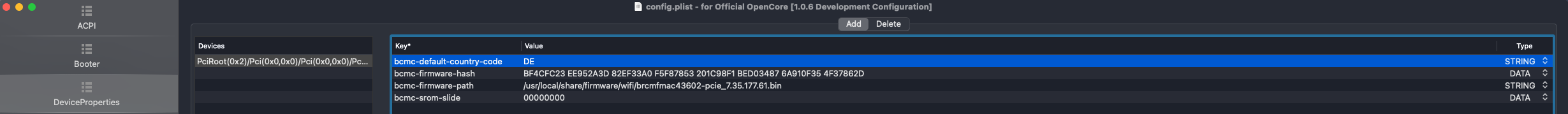

kgp Posted October 26, 2025 Share Posted October 26, 2025 (edited) 14 minutes ago, eSaF said: Thanks man, I managed to sort that part out. I am now trying to sort out the wrong Country Code being displayed. The Card was bought from AliExpress so goodness knows whether it is hard coded or not to NL. I am toying with the idea of purchasing one for a UK iMac but loathed to spend anymore money considering my plan to purchase a Mac mini. Nothing on your card is hardwired! Just use "bcmc-default-country-code" - "GB" - "string" in the device properties ! It also perfectly works with DE on my system! Carefully revise my device properties displayed below. Edited October 26, 2025 by KGP-iMacPro Link to comment https://www.insanelymac.com/forum/topic/361710-broadcom-fullmac-wi-fi-support-on-macos-sonoma-sequoia-and-tahoe-without-root-patches/page/11/#findComment-2842813 Share on other sites More sharing options...

schrup21 Posted October 30, 2025 Share Posted October 30, 2025 On 10/26/2025 at 9:53 PM, KGP-iMacPro said: Nothing on your card is hardwired! Just use "bcmc-default-country-code" - "GB" - "string" in the device properties ! As I already said, it is indeed possible, that the manufacturer (or someone else) sets e.g the CountryCode via OTP. I own a DELL DW1830 which doesn't work with DE (WiFi extremely slow) with US everything is fine (#a also leads to US although DE is my region) - I'm talking about native Wifi in Ventura, not BCMC. See: https://www.infineon.com/assets/row/public/documents/30/42/infineon-an214935-otp-programming-and-nvram-development-process-for-sdio-embedded-wlan-devices-applicationnotes-en.pdf?fileId=8ac78c8c7cdc391c017d0d2be759639d The initial state of all OTP bits in an unprogrammed device is 0. Individual bits can be programmed to 1, but once programmed, they can never be reprogrammed back to 0. The entire OTP array can be programmed in a single write cycle using wl commands provided with the SDIO driver. Alternatively, multiple write cycles can be used to selectively program specific fields, but only bits that are still in the 0 state can be programmed to the 1 state during each programming cycle. Link to comment https://www.insanelymac.com/forum/topic/361710-broadcom-fullmac-wi-fi-support-on-macos-sonoma-sequoia-and-tahoe-without-root-patches/page/11/#findComment-2842963 Share on other sites More sharing options...

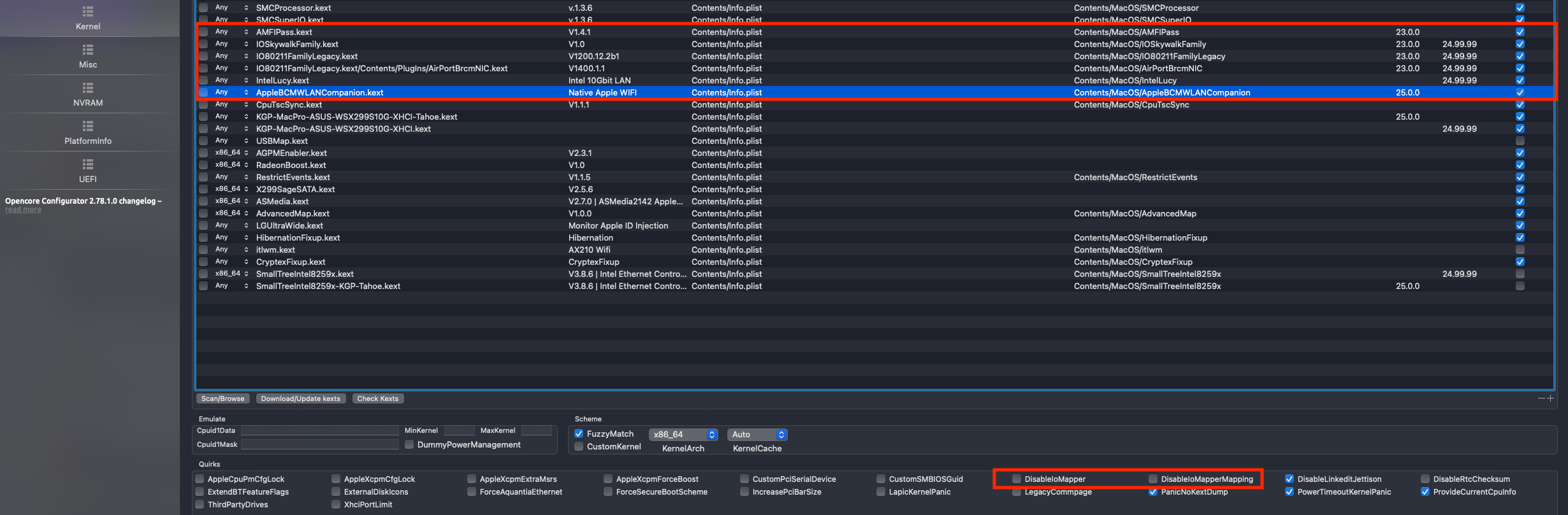

BALDY_MAN Posted October 31, 2025 Share Posted October 31, 2025 19 hours ago, KGP-iMacPro said: I did not find anything suspicious in your EFI, that would prevent your system from boot. However, I would disable LucyRTL8125Ethernet.kext, as it might not work with AppleVTD enabled. If you disable LucyRTL8125Ethernet.kext, Apple's Dext driver will automatically take over with AppleVTD enabled. Though, there is something important for BCMC missing in your EFI-configuration: Uncheck DisableIOMapper to enable AppleVTD !!!!! Otherwise BCMC won't work at all! If you still want to use OLCP under Sequoia and Sonoma or add AppleHDA under Tahoe, have a look to my above EFI-Folder. Cheers, KGP I have tried a load of things cut down on kext s (DisableIOMapper=True. still shuts down and reboots Link to comment https://www.insanelymac.com/forum/topic/361710-broadcom-fullmac-wi-fi-support-on-macos-sonoma-sequoia-and-tahoe-without-root-patches/page/11/#findComment-2842990 Share on other sites More sharing options...
kgp Posted October 31, 2025 Share Posted October 31, 2025 (edited) 55 minutes ago, BALDY_MAN said: I have tried a load of things cut down on kext s (DisableIOMapper=True. still shuts down and reboots What do you mean by "still shuts down and reboots"? Could you be a bit more explicit? Does your system successfully boot with this EFI with the BCMC kext disabled? For BCMC, you have to uncheck DisableIOMapper anyway, i.e. DisableIOMapper=False! I also updated OC to 1.0.6 Dev and added max kernel flag 24.99.99 to LucyRTL8125Ethernet.kext to provide ethernet with AppleVTD enabled by means of the DEXT driver. WIFI EFI TEST.zip Edited October 31, 2025 by KGP-iMacPro Link to comment https://www.insanelymac.com/forum/topic/361710-broadcom-fullmac-wi-fi-support-on-macos-sonoma-sequoia-and-tahoe-without-root-patches/page/11/#findComment-2842991 Share on other sites More sharing options...

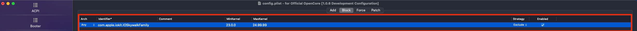

kgp Posted October 31, 2025 Share Posted October 31, 2025 (edited) 41 minutes ago, eSaF said: There is one setting that is puzzling to me. When I enter the Max value of 24.99.99 in the config.plist for the Lucy.kext, a Panic occurs. Remove the value and the machine boots into all 3 Mac versions from one EFI. WIFI is available in all 3, only Tahoe lacks Lan. Attached is the config.plist with the best favourable results. Cheers. config.plist.zip 6.42 kB · 1 download That's really weird.. Everything works perfectly such on my system. I would expect that with max kernel 24.99.99 at the Lucy kext, your system would boot without problems at least under Sequoia and Sonoma and you would have Lucy Ethernet available... I guess, you observe also a panic under Tahoe with the Lucy kext just disabled before boot? If yes, there might be problems with the DEXT Driver on your system. If not, you should get a result like this: BTW.. your csr-active-config is still 67080000 ! Maybe this causes the issue with the DEXT Driver? For testing purposes, try to use 03080000 and boot into Tahoe with the Lucy kext disabled in the config.plist. Edited October 31, 2025 by KGP-iMacPro Link to comment https://www.insanelymac.com/forum/topic/361710-broadcom-fullmac-wi-fi-support-on-macos-sonoma-sequoia-and-tahoe-without-root-patches/page/11/#findComment-2843005 Share on other sites More sharing options...

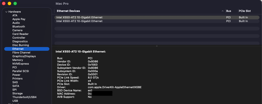

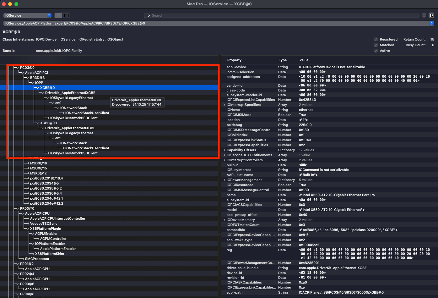

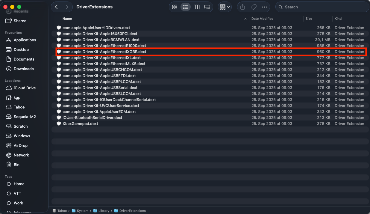

kgp Posted October 31, 2025 Share Posted October 31, 2025 (edited) 17 minutes ago, eSaF said: I will try your suggestion, meanwhile can you post a pic of exactly what the your DEXT Driver look like. I tried to find it but mine does not fit the description you posted previously. I don't really understand what you mean by "a pic of exactly what the your DEXT Driver look like". How the DEXT Driver is implemented by macOS I posted already in the previous post. Below, a screenshot, where the DEXT Drivers are located on our macOS Systems: /System/Library/DriverExtensions/; In red the one for my X550-AT2 NICs. If there is a DEXT Driver for your NIC, it should be injected automatically as soon you disable the Lucy kext and you have AppleVTD enabled. 👍 Edited October 31, 2025 by KGP-iMacPro Link to comment https://www.insanelymac.com/forum/topic/361710-broadcom-fullmac-wi-fi-support-on-macos-sonoma-sequoia-and-tahoe-without-root-patches/page/11/#findComment-2843008 Share on other sites More sharing options...
Mieze Posted October 31, 2025 Share Posted October 31, 2025 (edited) @eSaF Tahoe comes with a native Skywalk driver for Realtek RTL8125 NICs, aka AppleEthernetRL.kext, but this driver doesn't work with chips which can be found on mainboards. On one of my machine (Z790 from signature), AppleEthernetRL.kext, gracefully exits after failing to acquire the NIC's MSI interrupt and on the other machine (MSI Z490 from signature) it causes a KP. As LucyRTL8125 takes precedence over AppleEthernetRL.kext, it prevents the KP. Mieze 😺 Edited October 31, 2025 by Mieze 2 1 Link to comment https://www.insanelymac.com/forum/topic/361710-broadcom-fullmac-wi-fi-support-on-macos-sonoma-sequoia-and-tahoe-without-root-patches/page/11/#findComment-2843009 Share on other sites More sharing options...
kgp Posted October 31, 2025 Share Posted October 31, 2025 (edited) 1 hour ago, eSaF said: Yes @Mieze is absolutely correct, the IORegistryExplorer results is certainly different on this Z490. The curious thing is with the change of SIP value and the Lucy.kext Max data entry, when I reboot and clean the NvRAM, the machine panics booting into Tahoe. If I then reboot without cleaning the NvRAM, the boot up continues all the way to the Desktop. I have attached the results from IORegistry after booting into Tahoe. I will now boot into Sequoia or Sonoma and observe results. I have been on this from dawn, taken 2 steps forward and a Gazillion backward. Hide contents As @Mieze says, unfortunately Apple's native AppleEthernetRL.kext does not properly work with your Realtek RTL8125 onboard NIC, thus I am afraid that for now you are left without Ethernet when using BCMC with AppleVTD under Tahoe, until there is a fix for LucyRTL8125.kext by Mieze. You can remove the max kernel flag, as it is not of any help on your system. However, LucyRTL8125.kext properly works under Sequoia and Sonoma. In your given situation, I would rather choose to use LucyRTL8125.kext with DisableIOMapper=true (without AppleVTD) under Tahoe and forget about BCMC until there is a fix for the LucyRTL8125.kext that works with AppleVTD enabled also under Tahoe. Nevertheless consider all your efforts and contributions in this direction so far as very important for the community and all other users of BCMC and Realtek RTL8125 onboard NICs. 👍 And don't forget, you are all set with respect to BCMC, as soon there is a LucyRTL8125.kext update for Tahoe. 💯 By then, AppleBCMWLANCompanion.kext should also be more stable and likely implement all AWDL features. Thanks for climbing mountains to figure out all this together.. 😉 Edited October 31, 2025 by KGP-iMacPro 1 Link to comment https://www.insanelymac.com/forum/topic/361710-broadcom-fullmac-wi-fi-support-on-macos-sonoma-sequoia-and-tahoe-without-root-patches/page/11/#findComment-2843016 Share on other sites More sharing options...

kgp Posted November 1, 2025 Share Posted November 1, 2025 (edited) 7 hours ago, BALDY_MAN said: @KGP-iMacPro Thanks for your help still no joy just crashes and restarts. here,s a screen shop of the file path @BALDY_MAN, I don't know if you followed the recent intents and discussion concerning the LucyRTL8125Ethernet.kext above. It does not work under Tahoe with AppleVTD enabled. From inspecting your EFI, I suppose, that you also employ Realtek RTL8125 onboard NICs. Thus, also the max kernel 24.99.99 flag, I recently introduced in your config.plist, won't work on your system, as Apple's native Skywalk driver, i.e. AppleEthernetRL.kext, won't take over and just result in a KP under Tahoe. Please remove again the max kernel 24.99.99 flag at LucyRTL8125Ethernet.kext in your config.plist. Unfortunately, you will be left without ethernet for now when using BCMC with AppleVTD (DisableIOMapper=False) under Tahoe. Now if you still want to continue testing BCMC, please ensure that your system properly boots and works without BCMC at first place. If your KPs are really BCMC related, you can upload respective kernel panic logs for @Austere.J to be analysed and handled. To find the panic logs, go to "System Information" -> "logs" -> "Panic (system crashes) log" or see "/Library/Logs/DiagnosticReports/Kernel-2025-xx-xx-xxxxxx.panic". Hope this helps somehow.. 👍 Edited November 1, 2025 by KGP-iMacPro Link to comment https://www.insanelymac.com/forum/topic/361710-broadcom-fullmac-wi-fi-support-on-macos-sonoma-sequoia-and-tahoe-without-root-patches/page/11/#findComment-2843030 Share on other sites More sharing options...

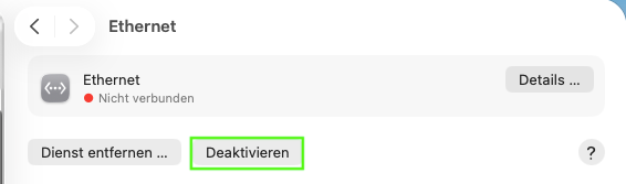

schrup21 Posted November 1, 2025 Share Posted November 1, 2025 (edited) edit: just saw the Lucy issue was already clarified - somehow I ididn't see all the posts... What is if you disable Lucy? But another question: why at all? Is it not enough to turn off the LAN? Spoiler Edited November 1, 2025 by schrup21 Link to comment https://www.insanelymac.com/forum/topic/361710-broadcom-fullmac-wi-fi-support-on-macos-sonoma-sequoia-and-tahoe-without-root-patches/page/11/#findComment-2843033 Share on other sites More sharing options...
kgp Posted November 1, 2025 Share Posted November 1, 2025 (edited) 1 hour ago, schrup21 said: edit: just saw the Lucy issue was already clarified - somehow I ididn't see all the posts... What is if you disable Lucy? But another question: why at all? Is it not enough to turn off the LAN? Reveal hidden contents This all is not about Laptops like in your case. Nearly nobody with a PC prefers WIFI over LAN. In any case, one with Realtek RTL8125 onboard NICs can just leave LucyRTL8125Ethernet.kext enabled and just stays without ethernet under Tahoe when using BCMC with AppleVTD enabled for now. The KP is produced by Apple's native Skywalk driver, i.e. AppleEthernetRL.kext, in case of Realtek RTL8125 onboard NICs, which should take over once LucyRTL8125Ethernet.kext is disabled. With DisableIOMapper=true (without AppleVTD) LucyRTL8125Ethernet.kext still works flawless under Tahoe, but like this it is impossible to use BCMC. No issues at all under Sequoia and Sonoma. Just carefully read the latest postings 😉 Edited November 1, 2025 by KGP-iMacPro 1 Link to comment https://www.insanelymac.com/forum/topic/361710-broadcom-fullmac-wi-fi-support-on-macos-sonoma-sequoia-and-tahoe-without-root-patches/page/11/#findComment-2843038 Share on other sites More sharing options...
