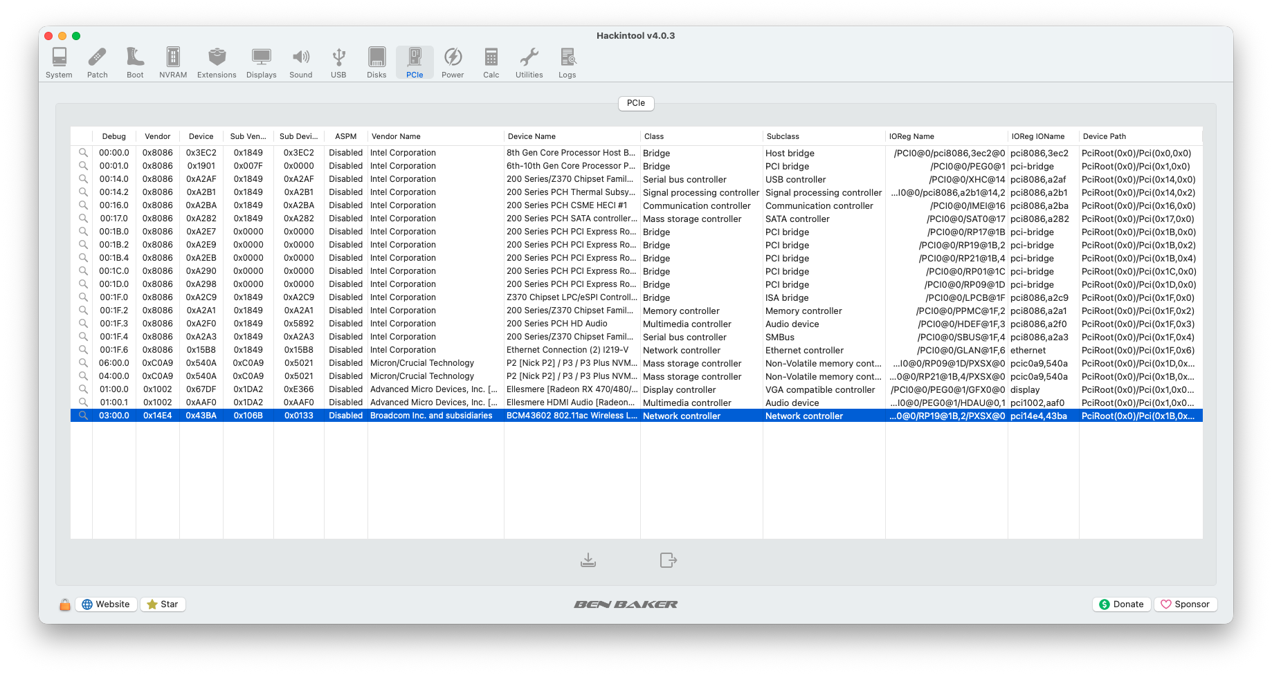

pico joe Posted September 29, 2025 Share Posted September 29, 2025 Hi @Austere.J, first thank for your hardwork but I'm trying here still cannot work, wifi still off and cannot ON, anyclue ? Spoiler 1 Link to comment https://www.insanelymac.com/forum/topic/361710-broadcom-fullmac-wi-fi-support-on-macos-sonoma-sequoia-and-tahoe-without-root-patches/page/2/#findComment-2841449 Share on other sites More sharing options...
Austere.J Posted September 29, 2025 Author Share Posted September 29, 2025 2 minutes ago, pico joe said: Hi @Austere.J, first thank for your hardwork but I'm trying here still cannot work, wifi still off and cannot ON, anyclue ? Hide contents Thanks for your interest in this project. Unfortunately, your Wi-Fi card is BCM4360 (0x43A0) and is not supported at the moment. Link to comment https://www.insanelymac.com/forum/topic/361710-broadcom-fullmac-wi-fi-support-on-macos-sonoma-sequoia-and-tahoe-without-root-patches/page/2/#findComment-2841450 Share on other sites More sharing options...
pico joe Posted September 29, 2025 Share Posted September 29, 2025 Owwh I see, didn't notice this before BCM43602 (0x14E4, 0x43BA) wait till the moment supported , thanks Link to comment https://www.insanelymac.com/forum/topic/361710-broadcom-fullmac-wi-fi-support-on-macos-sonoma-sequoia-and-tahoe-without-root-patches/page/2/#findComment-2841451 Share on other sites More sharing options...

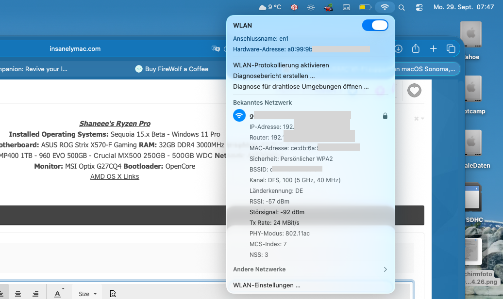

schrup21 Posted September 29, 2025 Share Posted September 29, 2025 Wow that's huge!!! I got a BMC943602CS and my native WiFi is working under Tahoe!!! I even forgot to deactivate OCLP-Mod Root Patch and booted with csr-active-config 03080000 - but it stil works!!! Big thanks!!! 4 1 Link to comment https://www.insanelymac.com/forum/topic/361710-broadcom-fullmac-wi-fi-support-on-macos-sonoma-sequoia-and-tahoe-without-root-patches/page/2/#findComment-2841452 Share on other sites More sharing options...

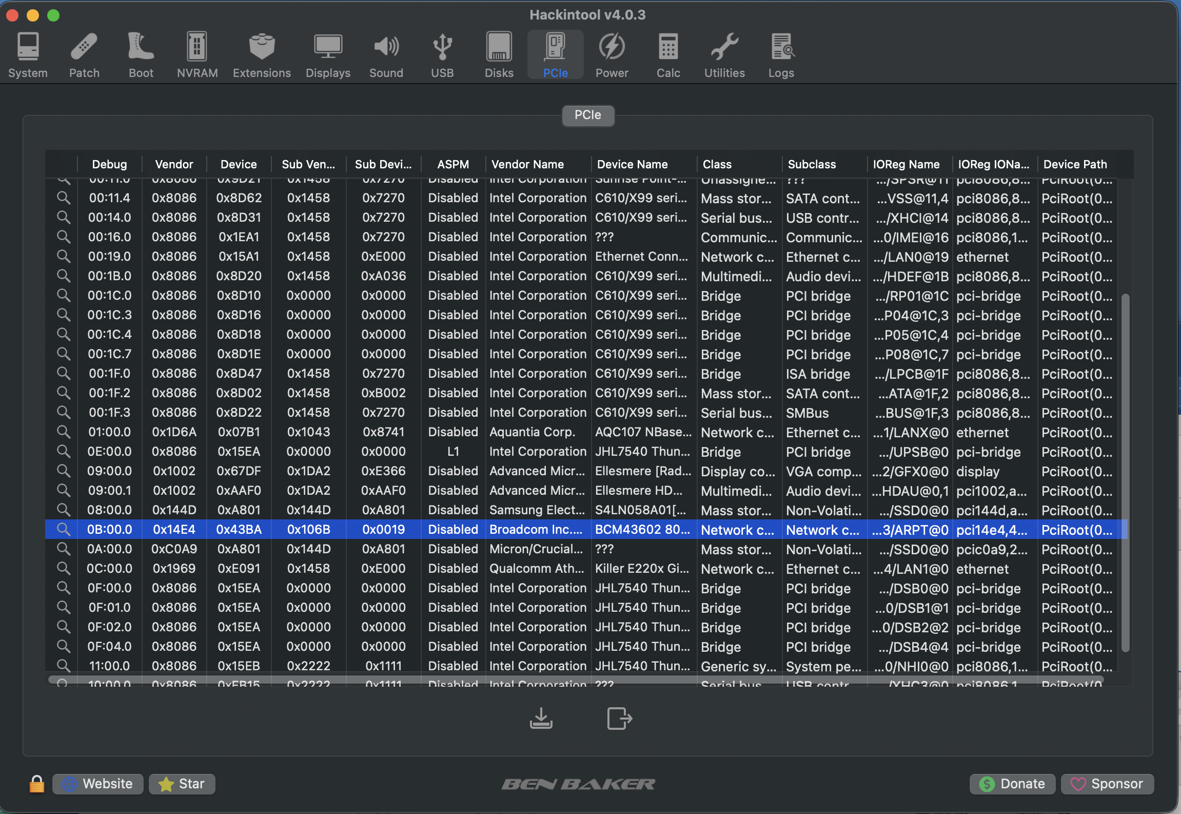

nmano Posted September 29, 2025 Share Posted September 29, 2025 (edited) I try still not work. Hi @Austere.J Thanks for your hard work. I Inject 0x43b1 to 0x43BA still not work please advise. Edited September 29, 2025 by nmano Link to comment https://www.insanelymac.com/forum/topic/361710-broadcom-fullmac-wi-fi-support-on-macos-sonoma-sequoia-and-tahoe-without-root-patches/page/2/#findComment-2841454 Share on other sites More sharing options...

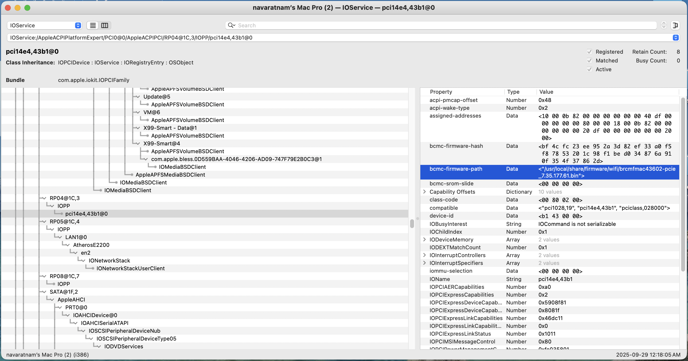

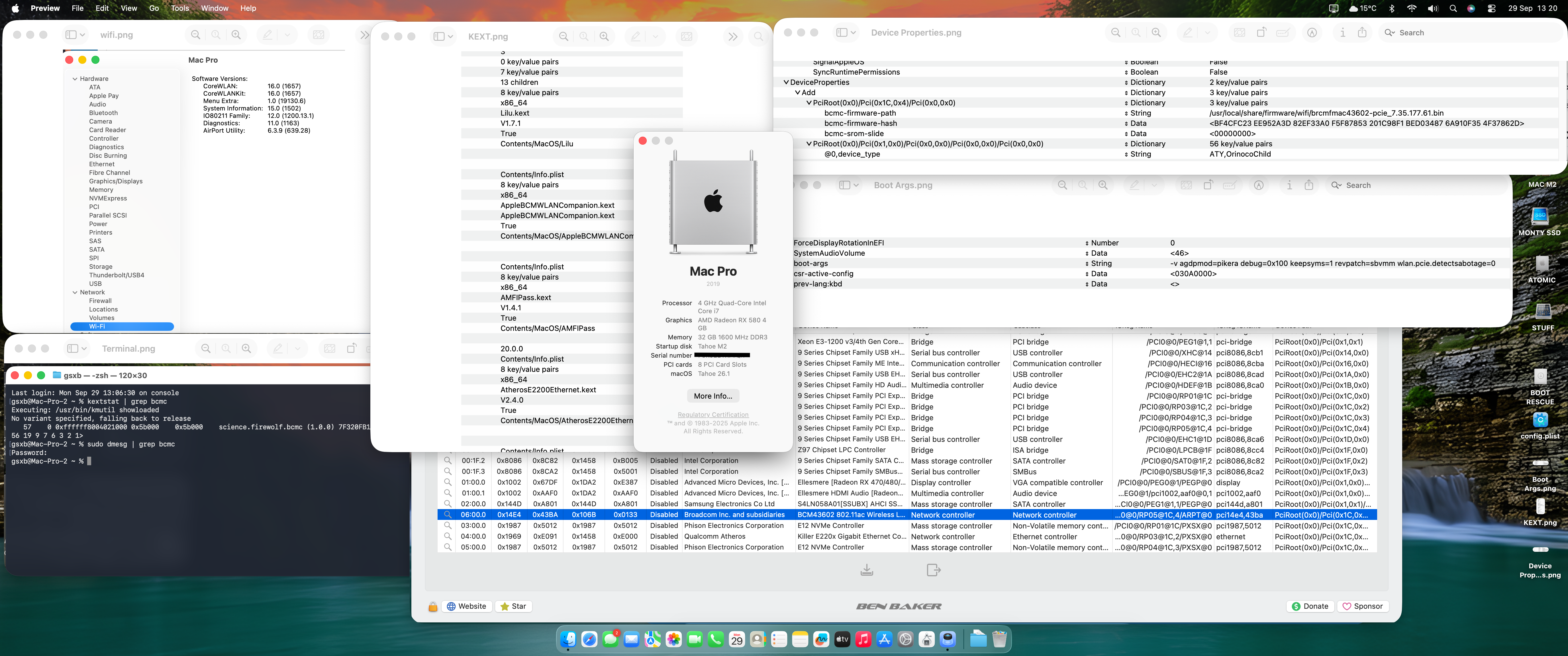

gsxb Posted September 29, 2025 Share Posted September 29, 2025 (edited) 2 hours ago, Austere.J said: Would you mind identifying the device ID of your Wi-Fi chip? If it's 0x43A0, it is not supported by BCMC. Hi there the card is BCM43602 (0x14E4, 0x43BA) macOS Tahoe 26,1 I’ll post some screen shot later with suggested terminal commands and results Edited September 29, 2025 by gsxb 1 Link to comment https://www.insanelymac.com/forum/topic/361710-broadcom-fullmac-wi-fi-support-on-macos-sonoma-sequoia-and-tahoe-without-root-patches/page/2/#findComment-2841455 Share on other sites More sharing options...

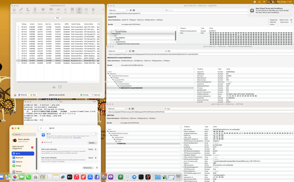

gsxb Posted September 29, 2025 Share Posted September 29, 2025 an updated screen shot to see what's possibly wrong 1 Link to comment https://www.insanelymac.com/forum/topic/361710-broadcom-fullmac-wi-fi-support-on-macos-sonoma-sequoia-and-tahoe-without-root-patches/page/2/#findComment-2841460 Share on other sites More sharing options...

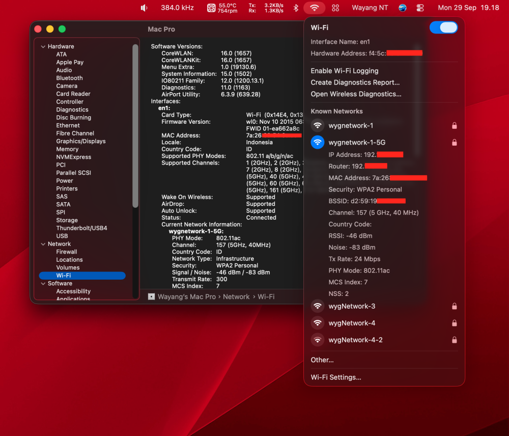

Wayang-NT Posted September 29, 2025 Share Posted September 29, 2025 big thanks ... BCM943602CS with PCIe in macOS Tahoe 26.1 Beta ... 7 Link to comment https://www.insanelymac.com/forum/topic/361710-broadcom-fullmac-wi-fi-support-on-macos-sonoma-sequoia-and-tahoe-without-root-patches/page/2/#findComment-2841461 Share on other sites More sharing options...

Perdu Posted September 29, 2025 Share Posted September 29, 2025 3 hours ago, Wayang-NT said: big thanks ... BCM943602CS with PCIe in macOS Tahoe 26.1 Beta ... Hi, congratulations! Would you be so kind as to share your EFI or card configuration? I have the same card but I haven't been able to figure it out... thanks. Spoiler 2 Link to comment https://www.insanelymac.com/forum/topic/361710-broadcom-fullmac-wi-fi-support-on-macos-sonoma-sequoia-and-tahoe-without-root-patches/page/2/#findComment-2841470 Share on other sites More sharing options...
schrup21 Posted September 29, 2025 Share Posted September 29, 2025 @Austere.J you probably already checked the BCM firmwares available in the Linux Kernel Repository? https://git.kernel.org/pub/scm/linux/kernel/git/iwlwifi/linux-firmware.git/ Link to comment https://www.insanelymac.com/forum/topic/361710-broadcom-fullmac-wi-fi-support-on-macos-sonoma-sequoia-and-tahoe-without-root-patches/page/2/#findComment-2841472 Share on other sites More sharing options...
Wayang-NT Posted September 30, 2025 Share Posted September 30, 2025 here's my EFI focused only in wifi configuration ... I use 03080000 for csr-active-config ... config-BCM.plist.zip 2 1 Link to comment https://www.insanelymac.com/forum/topic/361710-broadcom-fullmac-wi-fi-support-on-macos-sonoma-sequoia-and-tahoe-without-root-patches/page/2/#findComment-2841494 Share on other sites More sharing options...

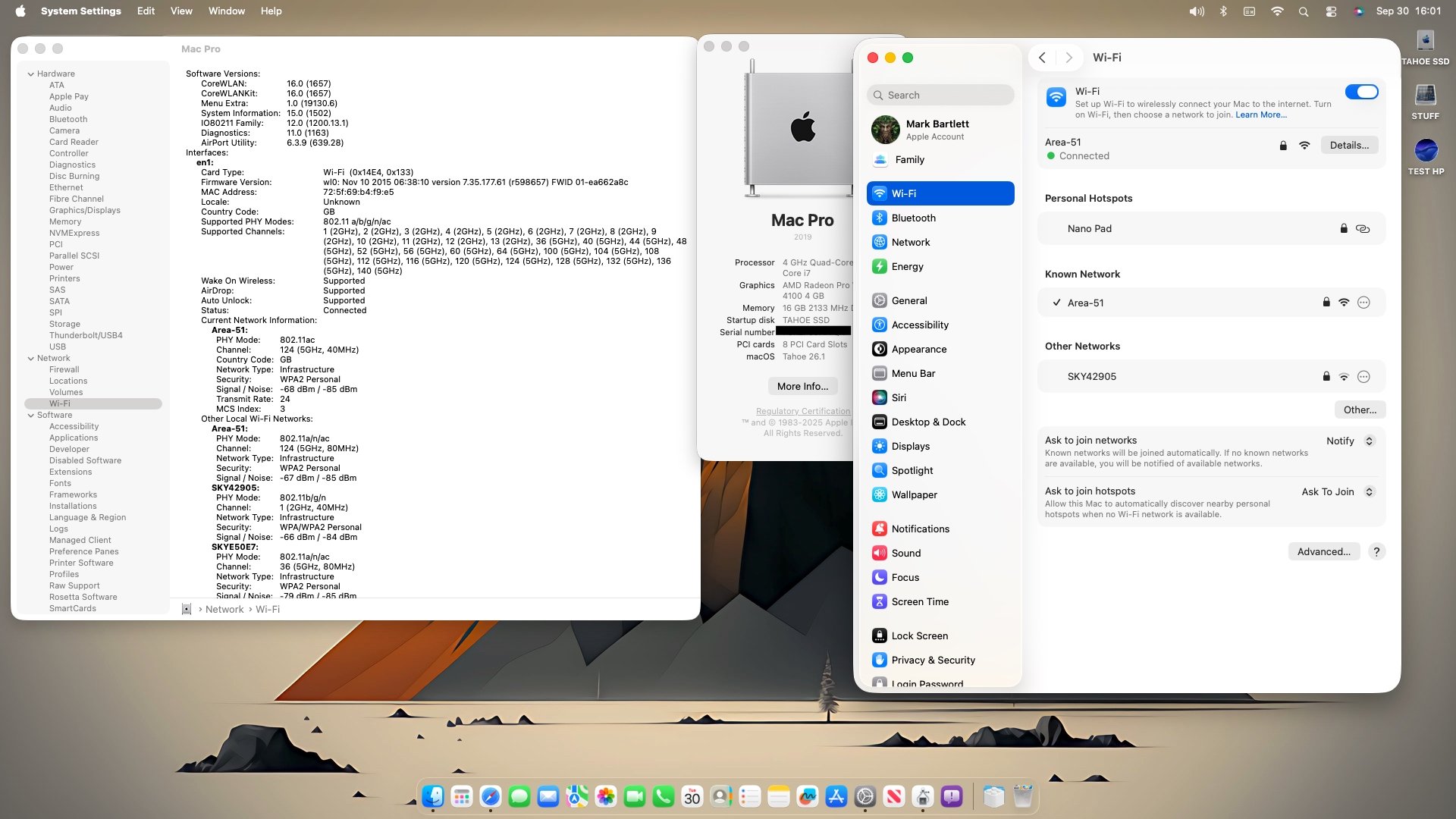

gsxb Posted September 30, 2025 Share Posted September 30, 2025 (edited) After two days of editing my opencore config and numerous reboots we have a winner Austere.J you da man HP 280 G2 SFF ( Ewaste ) Edited September 30, 2025 by gsxb 4 Link to comment https://www.insanelymac.com/forum/topic/361710-broadcom-fullmac-wi-fi-support-on-macos-sonoma-sequoia-and-tahoe-without-root-patches/page/2/#findComment-2841539 Share on other sites More sharing options...
