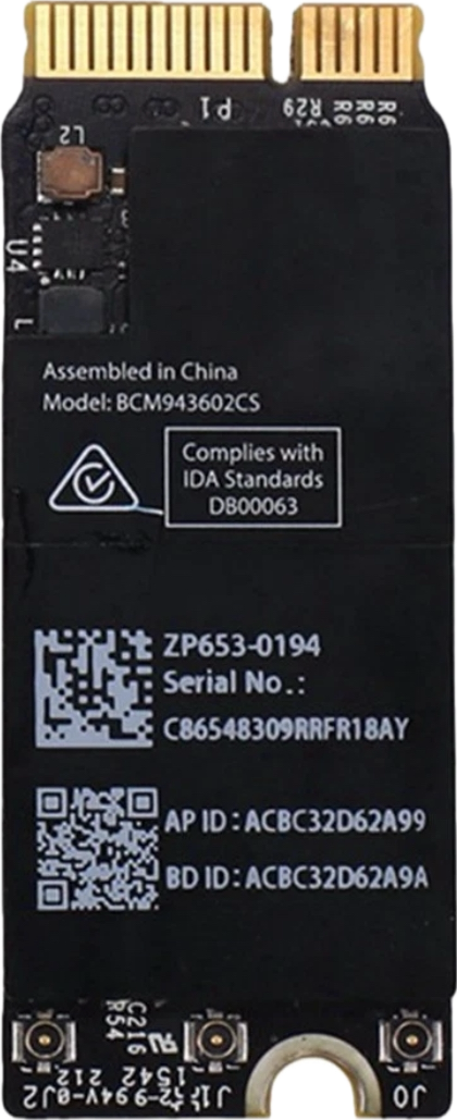

CloverLeaf Posted September 30, 2025 Share Posted September 30, 2025 @pkdesign I believe this one is the correct model: https://www.ebay.com/itm/357658526402?_trksid=p4481478.c101506.m1851 1 1 Link to comment https://www.insanelymac.com/forum/topic/361710-broadcom-fullmac-wi-fi-support-on-macos-sonoma-sequoia-and-tahoe-without-root-patches/page/3/#findComment-2841548 Share on other sites More sharing options...

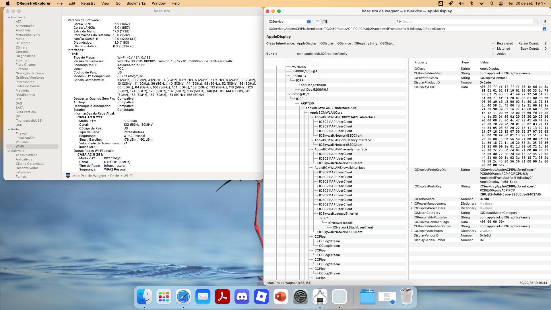

Wagalms Posted September 30, 2025 Share Posted September 30, 2025 Good news! I`m Hackintosher user since 2011. I`m using OS Sequoia 15.2. All working like an Airdrop, Handoff and many other functions. Credits: @Austere.J for shared your knowledge into tutorial; Great job! Thanks in advanced! 4 Link to comment https://www.insanelymac.com/forum/topic/361710-broadcom-fullmac-wi-fi-support-on-macos-sonoma-sequoia-and-tahoe-without-root-patches/page/3/#findComment-2841556 Share on other sites More sharing options...
CloverLeaf Posted September 30, 2025 Share Posted September 30, 2025 @wagneralex Great! Please share more detailed information about your current system. 1 Link to comment https://www.insanelymac.com/forum/topic/361710-broadcom-fullmac-wi-fi-support-on-macos-sonoma-sequoia-and-tahoe-without-root-patches/page/3/#findComment-2841557 Share on other sites More sharing options...
jlrycm Posted September 30, 2025 Share Posted September 30, 2025 35 minutes ago, wagneralex said: Good news! I`m Hackintosher user since 2011. I`m using OS Sequoia 15.2. All working like an Airdrop, Handoff and many other functions. Credits: @Austere.J for shared your knowledge into tutorial; Great job! Thanks in advanced! @wagneralex which one of the following cards do you have? BCM943602BAED, BCM943602CDP, BCM943602CS, DW1830 3 Link to comment https://www.insanelymac.com/forum/topic/361710-broadcom-fullmac-wi-fi-support-on-macos-sonoma-sequoia-and-tahoe-without-root-patches/page/3/#findComment-2841560 Share on other sites More sharing options...

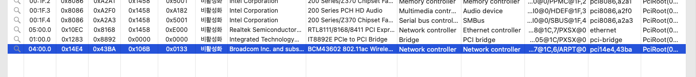

Wagalms Posted October 1, 2025 Share Posted October 1, 2025 Hi @CloverLeaf and @jlrycm! Using device model Broadcom BCM943602CS 3x3 MU MIMO (2015) with native devide-id 0x14E4 and 0x43BA, bluetooth 4.1, and OC config: car-atcive-config 00000000, NVRAm boot-arg wlan.pcie.detectsabotage=0, no amfi. But one item is crucial: DMAR.aml table with AppleVTD enabled on your IOREG 2 2 Link to comment https://www.insanelymac.com/forum/topic/361710-broadcom-fullmac-wi-fi-support-on-macos-sonoma-sequoia-and-tahoe-without-root-patches/page/3/#findComment-2841582 Share on other sites More sharing options...

schrup21 Posted October 1, 2025 Share Posted October 1, 2025 20 hours ago, pkdesign said: How do we identify Full and Soft cards? The eBay link you posted is a BCM94360CS - that’s the wrong model. What you want is a BCM943602CS - the model is written on the module 😉 1 Link to comment https://www.insanelymac.com/forum/topic/361710-broadcom-fullmac-wi-fi-support-on-macos-sonoma-sequoia-and-tahoe-without-root-patches/page/3/#findComment-2841586 Share on other sites More sharing options...
