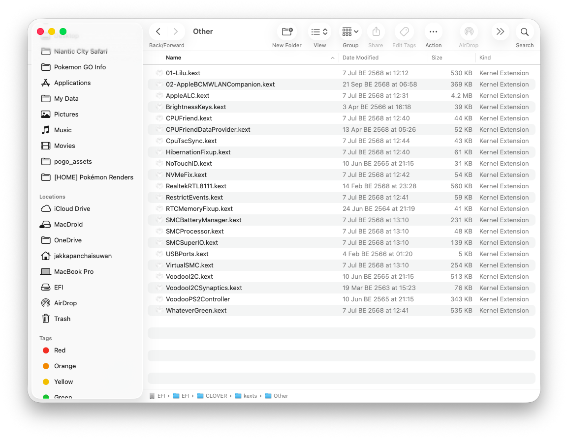

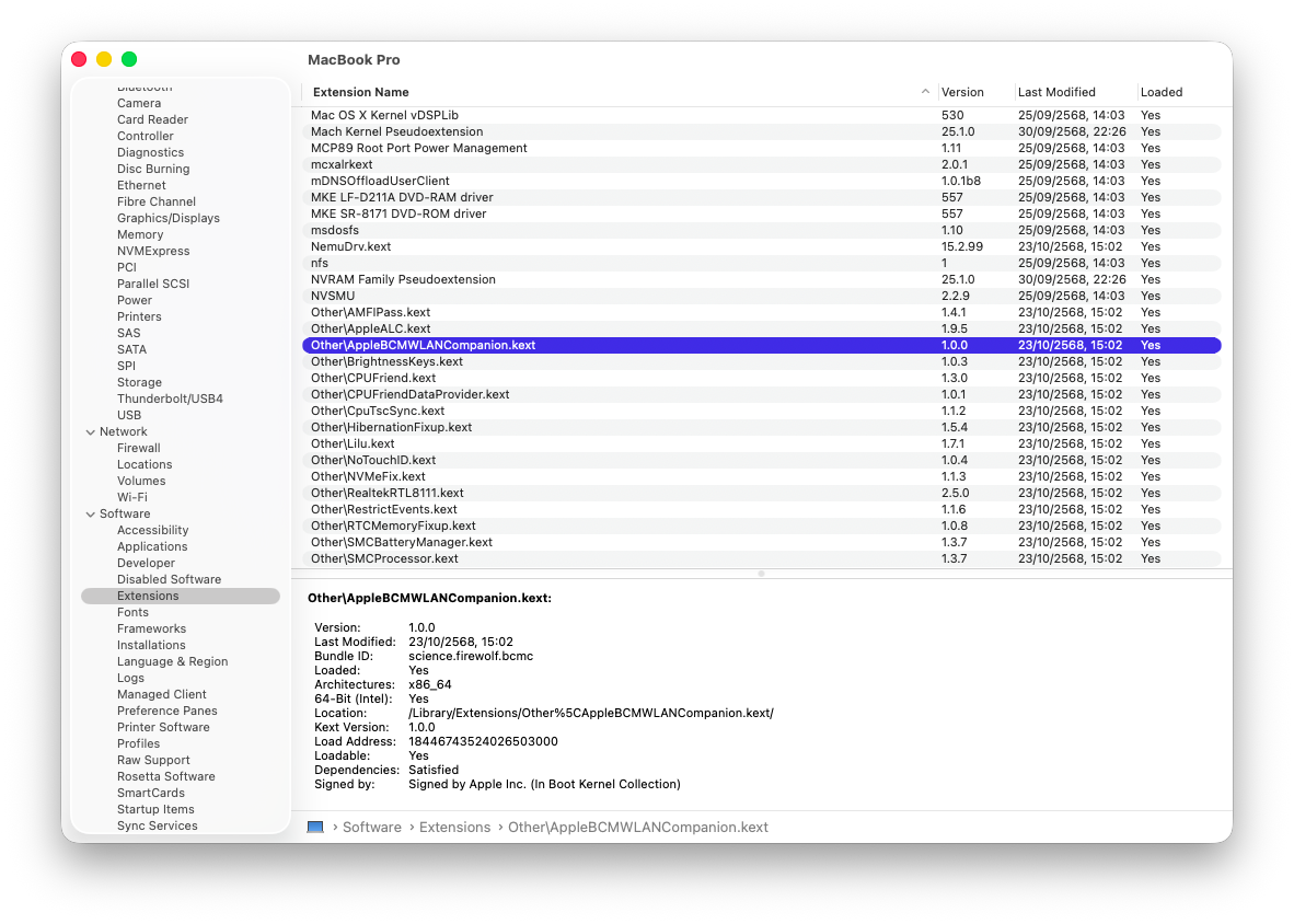

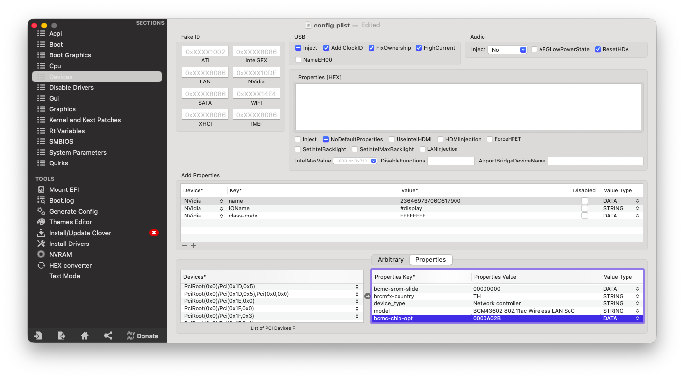

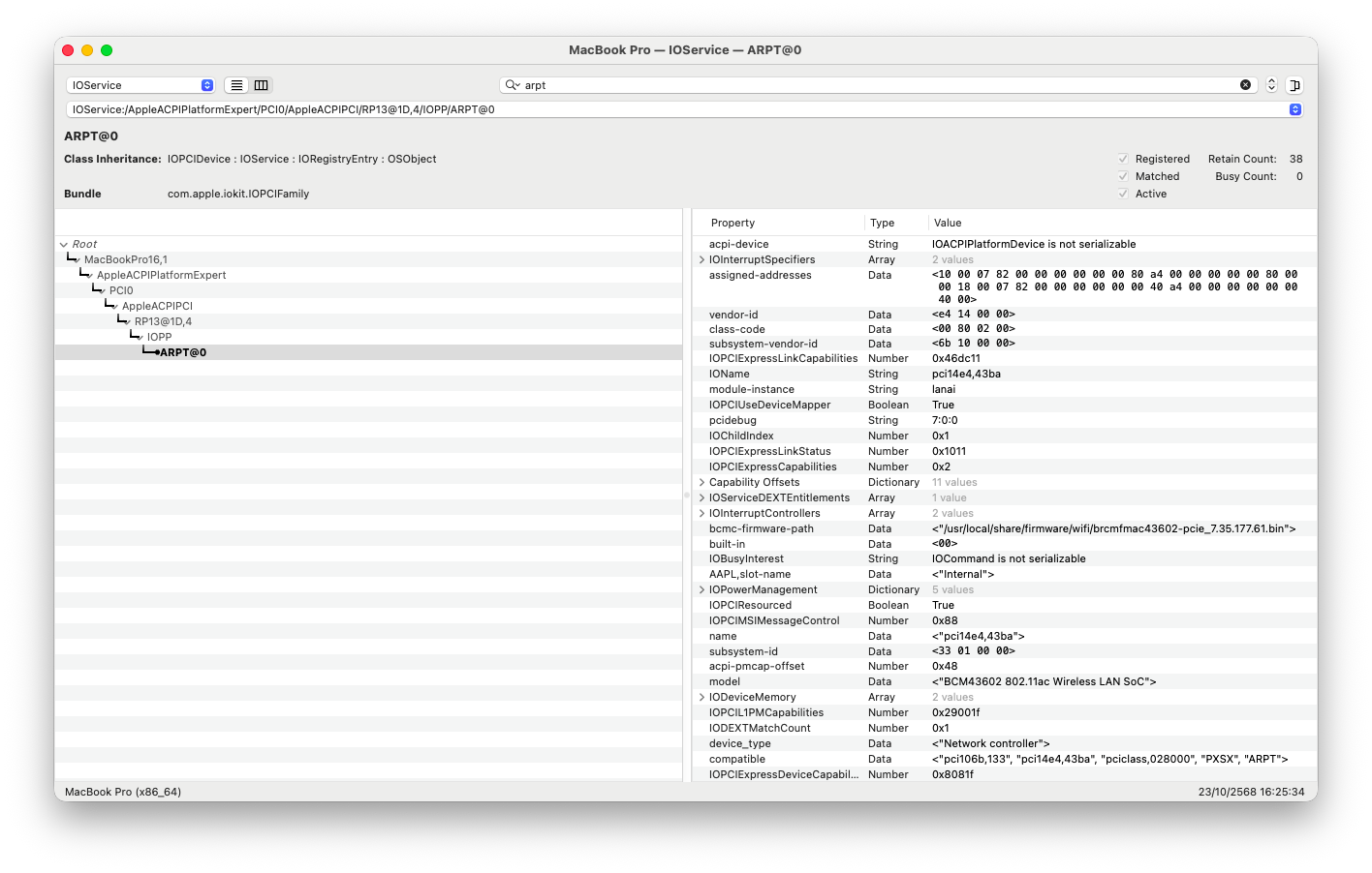

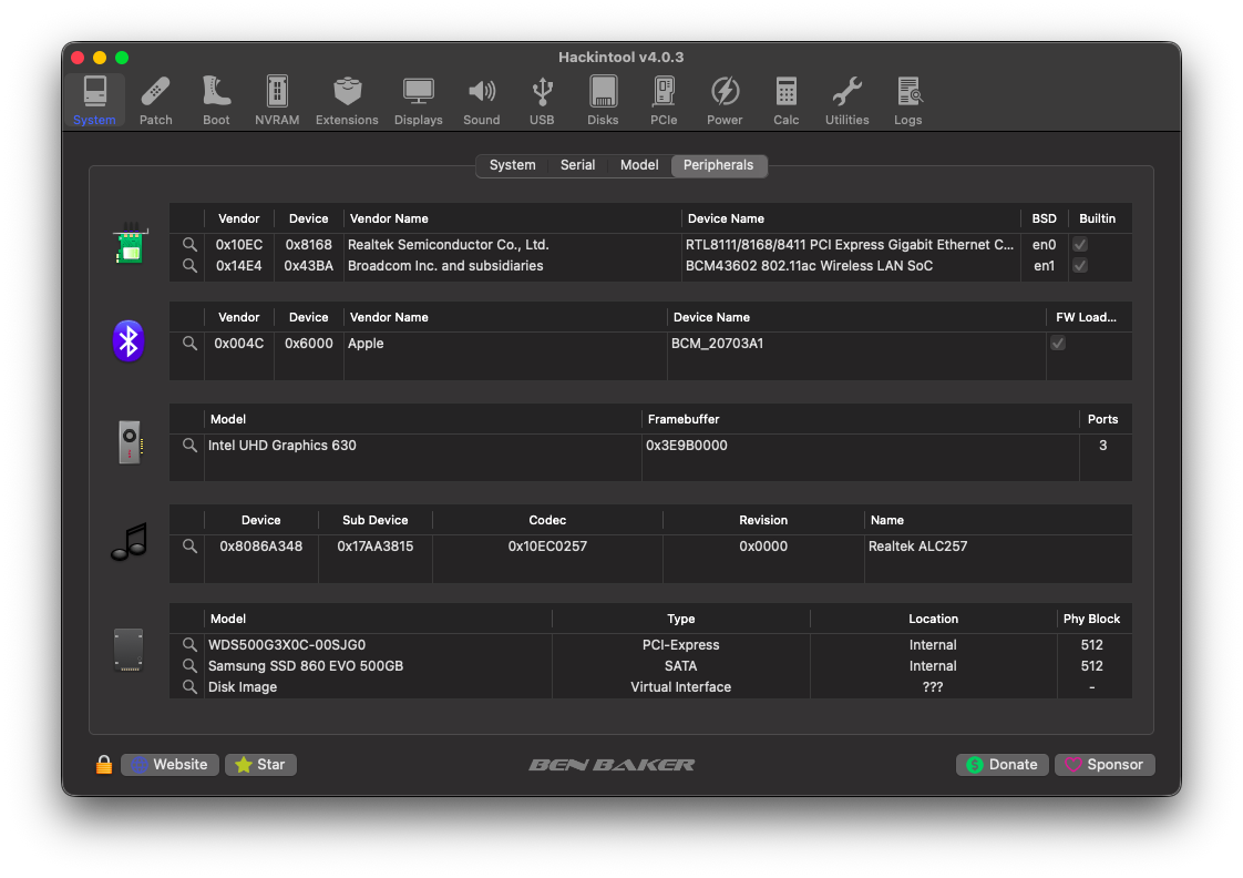

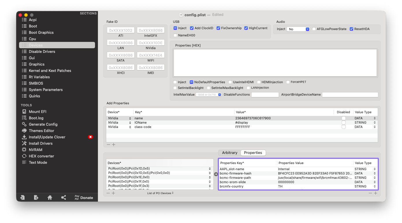

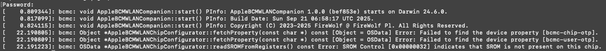

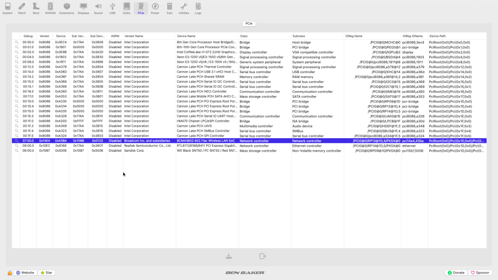

kgp Posted October 22, 2025 Share Posted October 22, 2025 1 hour ago, cfmwan said: Just don't inject the slot information of the wireless network card. No matter, if I inject or don't inject additional PCIe device information for Broadcom WIFI via SSDT. As soon AppleBCMWLANCompanion.kext is enabled, all PCI information under System Information is gone on my system. Link to comment https://www.insanelymac.com/forum/topic/361710-broadcom-fullmac-wi-fi-support-on-macos-sonoma-sequoia-and-tahoe-without-root-patches/page/10/#findComment-2842663 Share on other sites More sharing options...

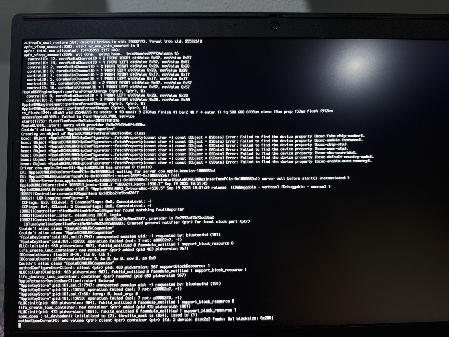

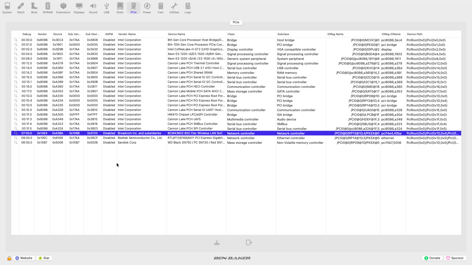

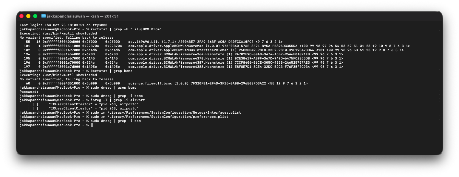

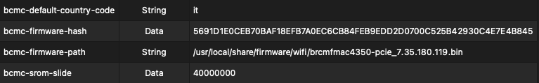

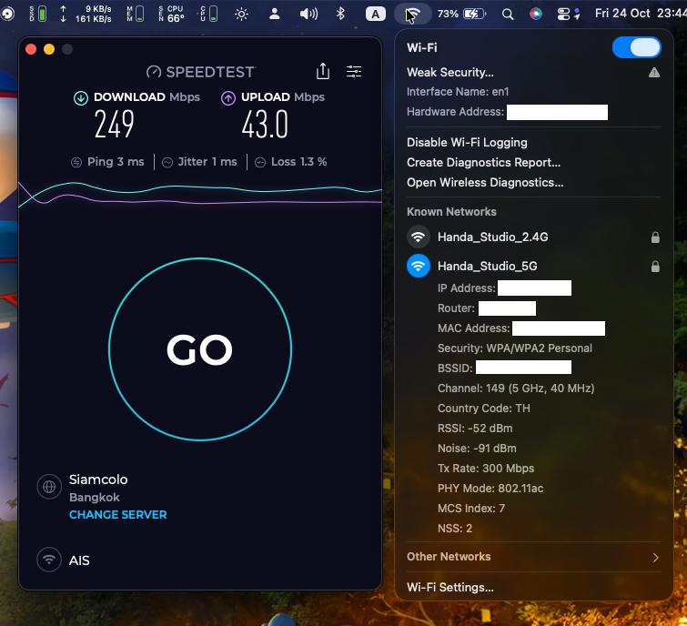

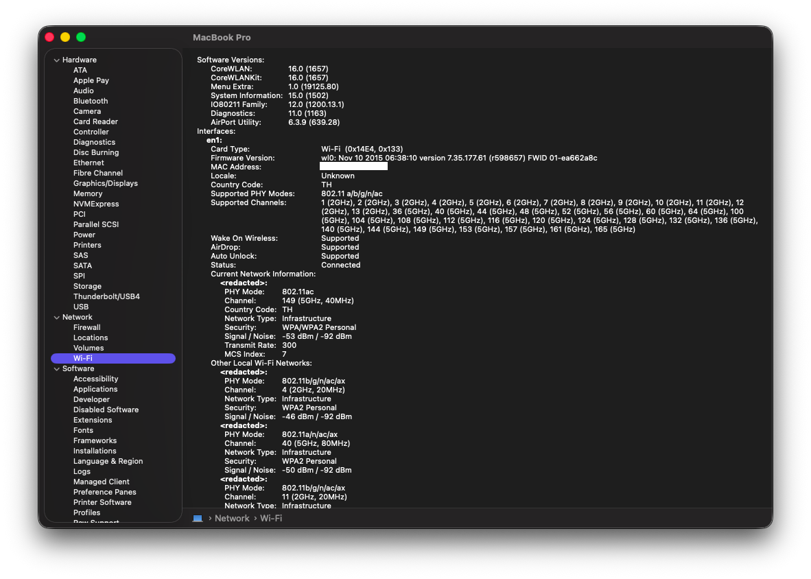

HandaTakuya Posted October 24, 2025 Share Posted October 24, 2025 Hello, I came across this project, and it looks really interesting. I used to have a BCM94360CS2 Wi-Fi card, but since it’s not compatible, I replaced it with a BCM943602CS specifically for this project. I followed the guide carefully, but it didn’t work for me. When I booted with the -v flag, I got the message: Couldn't alloc class "AppleBCMWLANCompanion" I’m not sure if I made a mistake in my configuration or missed something. P.S. I’m a Clover user — is there any guide or example configuration for the Clover bootloader? Link to comment https://www.insanelymac.com/forum/topic/361710-broadcom-fullmac-wi-fi-support-on-macos-sonoma-sequoia-and-tahoe-without-root-patches/page/10/#findComment-2842723 Share on other sites More sharing options...

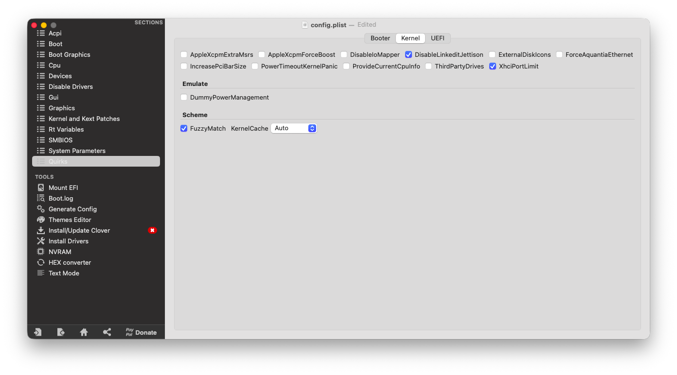

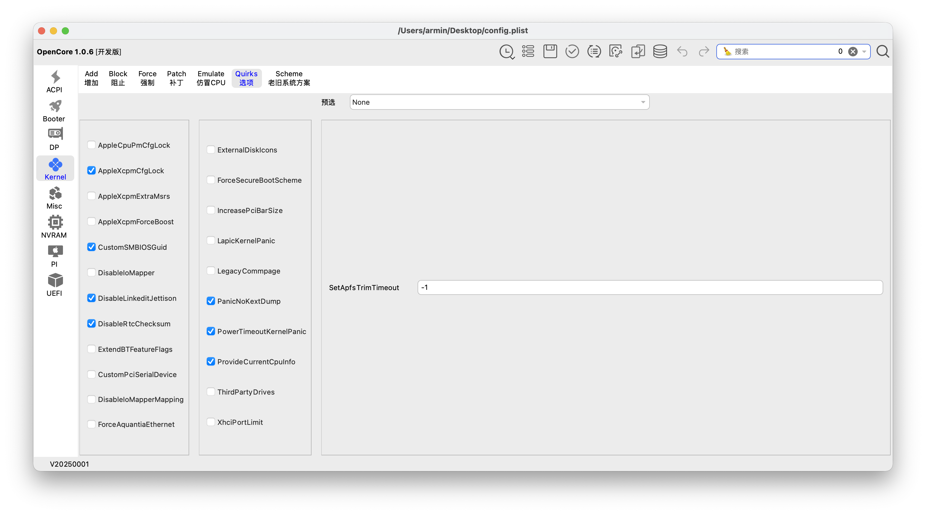

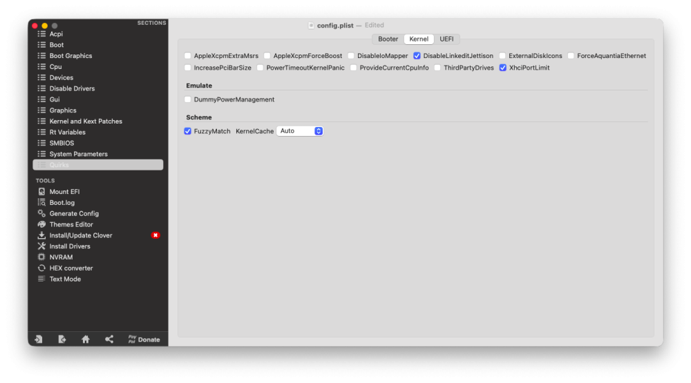

cfmwan Posted October 24, 2025 Share Posted October 24, 2025 (edited) To install this driver, you must turn on VD-T to load it. There is no Clover configuration, only OC configuration. See here for details.And closeDisableIoMapper,This is a required option. config.plist Edited October 24, 2025 by cfmwan Link to comment https://www.insanelymac.com/forum/topic/361710-broadcom-fullmac-wi-fi-support-on-macos-sonoma-sequoia-and-tahoe-without-root-patches/page/10/#findComment-2842724 Share on other sites More sharing options...
HandaTakuya Posted October 24, 2025 Share Posted October 24, 2025 12 hours ago, cfmwan said: To install this driver, you must turn on VD-T to load it. There is no Clover configuration, only OC configuration. See here for details.And closeDisableIoMapper,This is a required option. config.plist 61.65 kB · 5 downloads Oh, thank you so much! DisableIoMapper is also available in Clover Configurator — I turned it off, and my Wi-Fi started working again!! However, there’s a side effect when disabling DisableIoMapper: my Ethernet stopped working, and the PCI section doesn’t load in the System Report anymore. Link to comment https://www.insanelymac.com/forum/topic/361710-broadcom-fullmac-wi-fi-support-on-macos-sonoma-sequoia-and-tahoe-without-root-patches/page/10/#findComment-2842737 Share on other sites More sharing options...

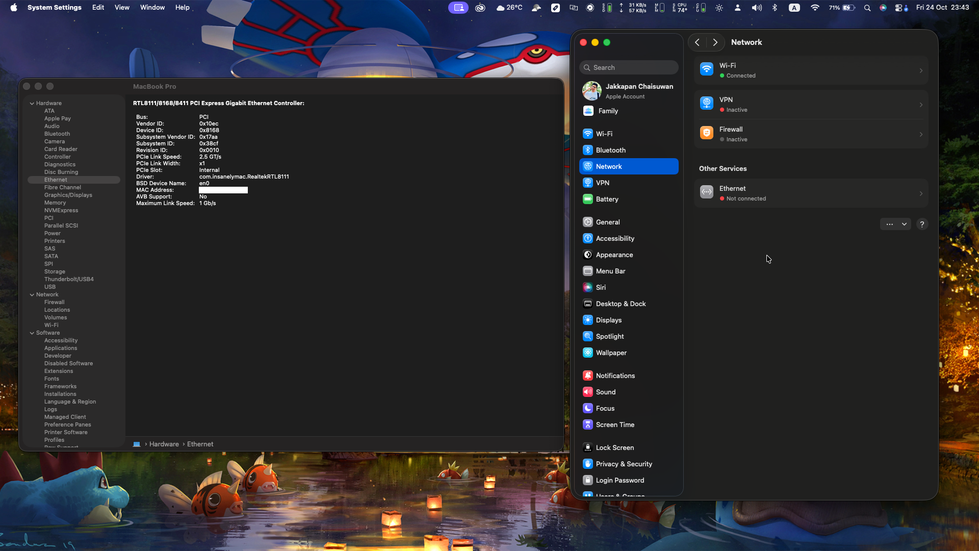

Mieze Posted October 24, 2025 Share Posted October 24, 2025 @HandaTakuya My RTL8111 ethernet driver is incompatible with AppleVTD under Tahoe and there is no easy solution in sight. You'll have to decide which one you want to use. Frankly, I don't understand why anybody is considering to use BCBM for a production system at the moment. There might be KPs and sleep is also broken, which makes it unsuitable for productive work. BCMC is a remarkable piece of work, but at the moment, it's nothing more than a prove of concept. Mieze 😺 2 Link to comment https://www.insanelymac.com/forum/topic/361710-broadcom-fullmac-wi-fi-support-on-macos-sonoma-sequoia-and-tahoe-without-root-patches/page/10/#findComment-2842739 Share on other sites More sharing options...
HandaTakuya Posted October 24, 2025 Share Posted October 24, 2025 (edited) 19 minutes ago, Mieze said: @HandaTakuya My RTL8111 ethernet driver is incompatible with AppleVTD under Tahoe and there is no easy solution in sight. You'll have to decide which one you want to use. Frankly, I don't understand why anybody is considering to use BCBM for a production system at the moment. There might be KPs and sleep is also broken, which makes it unsuitable for productive work. BCMC is a remarkable piece of work, but at the moment, it's nothing more than a prove of concept. Mieze 😺 Thank you so much for replying about the RTL8111 Ethernet issue. For me, since I’ve installed macOS Tahoe on my laptop, I haven’t been able to use Wi-Fi when I’m outside. As OCLP for Tahoe hasn’t been released yet, this workaround seems like an interesting alternative while waiting for OCLP support. Even though it’s still not possible to use Wi-Fi and Ethernet simultaneously, at least I now have Wi-Fi working when I’m away from home. Thanks again! Edited October 24, 2025 by HandaTakuya 1 Link to comment https://www.insanelymac.com/forum/topic/361710-broadcom-fullmac-wi-fi-support-on-macos-sonoma-sequoia-and-tahoe-without-root-patches/page/10/#findComment-2842740 Share on other sites More sharing options...

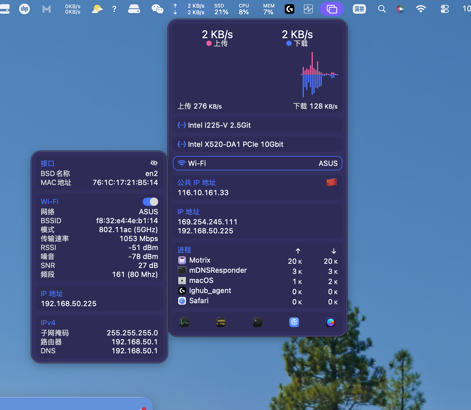

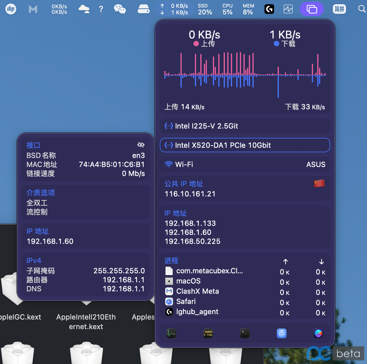

cfmwan Posted October 25, 2025 Share Posted October 25, 2025 (edited) 2 hours ago, jlrycm said: @Austere.J will try without patching DMAR. My ROG STRIX Z690-E GAMING Wi-Fi must be loaded with AppleIntelI210Ethernet when VT-D is turned on. In addition, Intel X520-DA1 cannot use IntelLucy driver when VT-D is turned on. It can only load the SonnetEthernet-10GE driver, but this driver cannot show the interface speed.If the above two network cards turn off VT-D, AppleIGC and IntelLucy can be used.In addition, I found a very interesting thing. When two wired network cards cannot be used, the speed displayed by BCM43602 is 450MB instead of 24MB.Its display speed has been changing all the time. Edited October 25, 2025 by cfmwan Link to comment https://www.insanelymac.com/forum/topic/361710-broadcom-fullmac-wi-fi-support-on-macos-sonoma-sequoia-and-tahoe-without-root-patches/page/10/#findComment-2842754 Share on other sites More sharing options...
