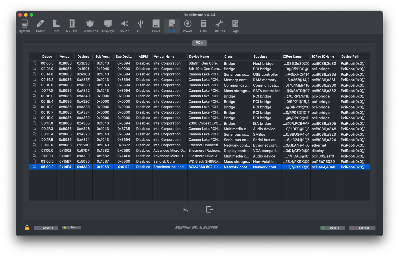

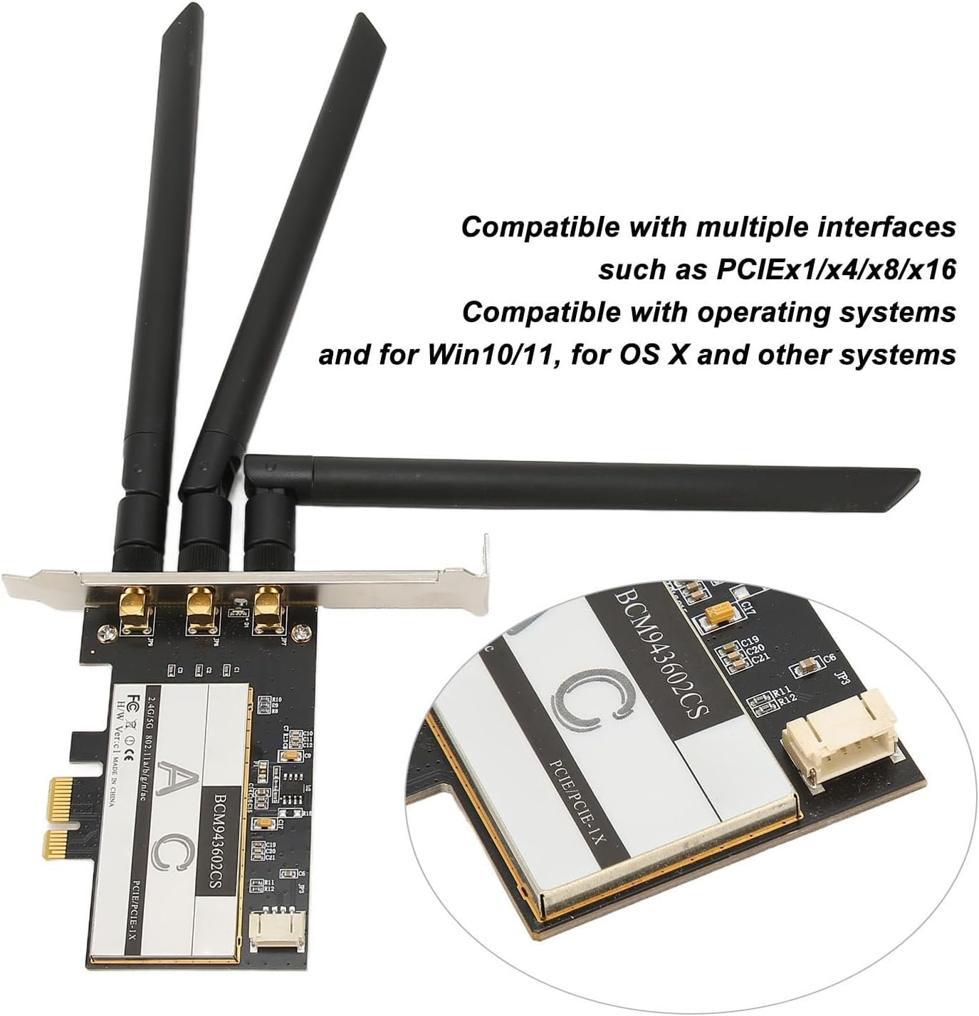

Jessy Lou Posted November 11, 2025 Share Posted November 11, 2025 I'je just bought the BCM943602CS as I read this card is supported, to replace my TP-Link Archer T9E based on a BCM4360 (with USB dongle to get BT 4 with BCM20702). The issue I have: Hackintool in its latest version running on Sequoia is providing me with the following values: Vendor ID: 0x14EA Device ID: 0x430 My Sequoia config.plist is using these kext: Lilu.kext VirtualSMC.kext WhateverGreen.kext AppleALC.kext USBPort.kext SMCProcessor.kext IntelMausi.kext RestrictEvents.kext IOSkywalkFamily.kext IO80211FamilyLegacy.kext and IO80211FamilyLegacy.kext/Contents/PlugIns/AirPortBrcmNIC.kext AMFIPass.kext AirportBrcmFixup.kext AirportBrcmFixup.kext/Contents/PlugIns/AirPortBrcmNIC_Injector.kext BrcmFirmwareData.kext BrcmPatchRAM3.kext BlueToolFixup.kext I don't have that much knowledge as you guys, therefore I would appreciate any help and advices. I have to tell that everything is working like a charm under Sequoia based on that configuration. Before going to work with what is necessary to get WiFi on Tahoe, I wanted to be sure about the real device I have installed. Link to comment https://www.insanelymac.com/forum/topic/361710-broadcom-fullmac-wi-fi-support-on-macos-sonoma-sequoia-and-tahoe-without-root-patches/page/12/#findComment-2843523 Share on other sites More sharing options...
kgp Posted November 11, 2025 Share Posted November 11, 2025 (edited) 3 hours ago, Jessy Lou said: I'je just bought the BCM943602CS as I read this card is supported, to replace my TP-Link Archer T9E based on a BCM4360 (with USB dongle to get BT 4 with BCM20702). The issue I have: Hackintool in its latest version running on Sequoia is providing me with the following values: Vendor ID: 0x14EA Device ID: 0x430 My Sequoia config.plist is using these kext: Lilu.kext VirtualSMC.kext WhateverGreen.kext AppleALC.kext USBPort.kext SMCProcessor.kext IntelMausi.kext RestrictEvents.kext IOSkywalkFamily.kext IO80211FamilyLegacy.kext and IO80211FamilyLegacy.kext/Contents/PlugIns/AirPortBrcmNIC.kext AMFIPass.kext AirportBrcmFixup.kext AirportBrcmFixup.kext/Contents/PlugIns/AirPortBrcmNIC_Injector.kext BrcmFirmwareData.kext BrcmPatchRAM3.kext BlueToolFixup.kext I don't have that much knowledge as you guys, therefore I would appreciate any help and advices. I have to tell that everything is working like a charm under Sequoia based on that configuration. Before going to work with what is necessary to get WiFi on Tahoe, I wanted to be sure about the real device I have installed. I would suggest to remove: AirportBrcmFixup.kext, AirportBrcmFixup.kext/Contents/PlugIns/AirPortBrcmNIC_Injector.kext, BrcmFirmwareData.kext, BrcmPatchRAM3.kext and BlueToolFixup.kext from your config.plist and EFI-Folder. None if these kexts is required by BCM943602CS! Subsequently, you can post a screenshot of Hackintool's PCIe Section that is related with BCM943602CS. BTW.. do you use any additional device properties or SSDT for Bluetooth/WIFI? In case you would need further help, please upload your EFI or config.plist. To start with, you could also have a look to my EFI-Folder as baseline: Edited November 11, 2025 by KGP-iMacPro Link to comment https://www.insanelymac.com/forum/topic/361710-broadcom-fullmac-wi-fi-support-on-macos-sonoma-sequoia-and-tahoe-without-root-patches/page/12/#findComment-2843527 Share on other sites More sharing options...

Jessy Lou Posted November 11, 2025 Share Posted November 11, 2025 @eSaF: I started reading a couple of times the documentation provided by the author. I got stuck, therefore the doubt about the device came up. This is why I want to ensure the card I ordered is really the right one, despite I'm very happy about the benefits compared to the TP-Link on Sequoia. @KGP-iMacPro: it's now done! I removed all the unnecessary kext from the config.plist. I also had a look at your universal EFI. As requested here is the screen shot from Hackintool on which I still see the same Device ID: I didn't reset NVRAM, maybe I should have done it. I'm also attaching my config.plist so that you can see (if I'm not mistaken, that I have no device properties or SSDT for Bluetooth/WIFI. config-JessyLou.plist Since I switched from Clover to OpenCore years ago I've learned a lot, but I still miss too many things. Your help is therefore very appreciated. Link to comment https://www.insanelymac.com/forum/topic/361710-broadcom-fullmac-wi-fi-support-on-macos-sonoma-sequoia-and-tahoe-without-root-patches/page/12/#findComment-2843561 Share on other sites More sharing options...
Jessy Lou Posted November 11, 2025 Share Posted November 11, 2025 Just did twice NVRAM reset (just in case): same outcome with Hackintool. Link to comment https://www.insanelymac.com/forum/topic/361710-broadcom-fullmac-wi-fi-support-on-macos-sonoma-sequoia-and-tahoe-without-root-patches/page/12/#findComment-2843562 Share on other sites More sharing options...
kgp Posted November 11, 2025 Share Posted November 11, 2025 (edited) 2 hours ago, Jessy Lou said: @eSaF: I started reading a couple of times the documentation provided by the author. I got stuck, therefore the doubt about the device came up. This is why I want to ensure the card I ordered is really the right one, despite I'm very happy about the benefits compared to the TP-Link on Sequoia. @KGP-iMacPro: it's now done! I removed all the unnecessary kext from the config.plist. I also had a look at your universal EFI. As requested here is the screen shot from Hackintool on which I still see the same Device ID: I didn't reset NVRAM, maybe I should have done it. I'm also attaching my config.plist so that you can see (if I'm not mistaken, that I have no device properties or SSDT for Bluetooth/WIFI. config-JessyLou.plist Since I switched from Clover to OpenCore years ago I've learned a lot, but I still miss too many things. Your help is therefore very appreciated. Your device ID seems 0x43A0 instead of 0x43BA. Check if your card is really a BCM943602CS. As soon I am at home, I will revise your config.plist. Give me 2 hours from now. Talk to you soon. Edited November 11, 2025 by KGP-iMacPro Link to comment https://www.insanelymac.com/forum/topic/361710-broadcom-fullmac-wi-fi-support-on-macos-sonoma-sequoia-and-tahoe-without-root-patches/page/12/#findComment-2843564 Share on other sites More sharing options...
kgp Posted November 11, 2025 Share Posted November 11, 2025 (edited) @Jessy Lou, you did not prepare anything BCMC related in your config.plist! 🧐 To go ahead, at least I need to know your country and the device path from Hackintool (not visible in your screenshot)! BTW.. Hackintool says BCM4360!!!!!! Please check and verify if you did not buy a BCM4360CS instead of a BCM43602CS!!! Update: Well.. attached the modified config.plist, which is now universal for all recent macOS version including Sonoma, Sequoia and Tahoe. Remaining discrepancies: Your USBMap.kext has MinKernel 24.0.0. Thus it would just work with Sequoia and Tahoe. No idea what this MinKernel is for, I would remove it! No idea also what is USBPorts4iMac202.kext, which is also enabled! What you have to do, once you really have a BCM43602CS or even better BCM43602CDP, which could fit into your adapter: 1.) Copy (sudo cp with root permission) brcmfmac43602-pcie_7.35.177.61.bin to /usr/local/share/firmware/wifi/ 2.) Under Device Properties change PciRoot(0x2)/Pci(0x0,0x0)/Pci(0x0,0x0)/Pci(0x8,0x0)/Pci(0x0,0x0) to your Device Path provided by Hackintool for your BCM43602CS (copy and paste) and change bcmc-default-country-code from DE to your country code. 3.) Download and copy AppleBCMWLANCompanion.kext to /EFI/OC/Kexts/ and enable AppleBCMWLANCompanion.kext in your config.plist under Kernel/Add. Everything else has been already implemented by myself such, that you should have OCLP working under Sonoma/Sequoia and BCMC under Tahoe, by using the same EFI-Folder. Good luck, KGP 👍 P.S: Also check reason for: a.) Lilu.kext MinKernel 10.0.0 b.) VirtualSMC.kext MinKernel 10.0.0 c.) WhateverGreen.kext MinKernel 12.0.0 d.) AppleALC.kext MinKernel 12.0.0 e.) IntelMausi.kext MinKernel 13.0.0 I would remove all these minKernel settings. Finally you could also do me a favour: Can you check and confirm that IntelMausi.kext really works under Tahoe with DisableIOMapper= false, i.e. AppleVTD enabled? 😉 config-JessyLou-modified-KGP.plist Edited November 12, 2025 by KGP-iMacPro Link to comment https://www.insanelymac.com/forum/topic/361710-broadcom-fullmac-wi-fi-support-on-macos-sonoma-sequoia-and-tahoe-without-root-patches/page/12/#findComment-2843568 Share on other sites More sharing options...
BALDY_MAN Posted November 11, 2025 Share Posted November 11, 2025 Jessy Lou. as a vender id 0x14e4. Device id 0x43a0 = BMC4360. Which IS NOT SUPPORTED. Should be. vender id 0X14e4 Device id 0x43ba =BMC43602 1 Link to comment https://www.insanelymac.com/forum/topic/361710-broadcom-fullmac-wi-fi-support-on-macos-sonoma-sequoia-and-tahoe-without-root-patches/page/12/#findComment-2843571 Share on other sites More sharing options...
Mac Hosehead Posted November 11, 2025 Share Posted November 11, 2025 1 hour ago, KGP-iMacPro said: What you have to do, once you really have a BCM43602CS or even better BCM43602CDP, which could fit into your adapter Actually, the BCM43602CDP has different size antenna connections so it will not work in the same card adapter. Some things about the photo: If the shield really says BCM43602CS then a different card has been put in the adapter. I assume it can be swapped with the right card. Another thing is that the photo shows no wires hooked up to the antenna connections on the card. I don't know how that is supposed to work. Kinda screwy all around. 1 Link to comment https://www.insanelymac.com/forum/topic/361710-broadcom-fullmac-wi-fi-support-on-macos-sonoma-sequoia-and-tahoe-without-root-patches/page/12/#findComment-2843574 Share on other sites More sharing options...
