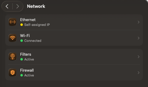

This morning my WiFi BCM943602CS card arrived and I decided to give it a try.
Very easy setup, really.
What's working: Handoff, Continuity, AirPlay. Basically everything that but AirDrop. Things that requires Apple silicon chip will never work on hackintosh anyway.
iPhone can see my Mac and vice versa but the file doesn't go through.
I also checked if sync is working, it does, I took pictures with iPhone and they synced fine.

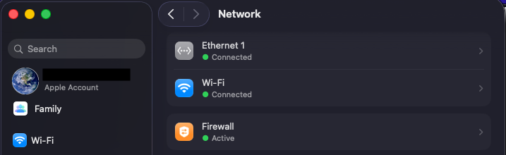

The issue I have is when I disable/uncheck DisableIOMapper I lose Ethernet connection. When I enable it, I have Ethernet but no WiFi.
I'm not sure that I can have both working at the same time. Is there a way?

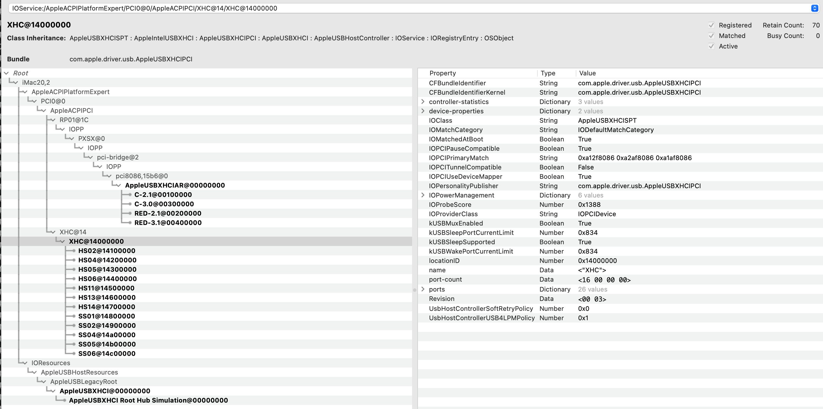

I am using UsbMap.kext to perform usb port mapping. It works greatly upon I enabled Vt-D. Now bcmc card works, but all ports of XHC controller were killed, the ports are in ioreg ,but not functional.But another usb controller(AppleUXBXHCIAR) which is usb 3.1, still works.
The usbmap USBMapDummy.kext could not detect any ports of XHC@14.The ports seem to be all dead.
I have attached my EFI. Any help would be appreciated. It is a Z170mx board + I7-6700K.

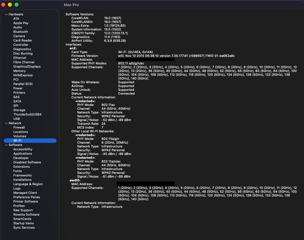

I have applied this new method to get WiFi working successfully on 2 of my hacks, with both working like a dream.
The only issue I am having is sleep, manual sleep and also automatic timer controlled sleep.
Once the machines have entered sleep I lose all input functionality, mouse as well as wired keyboard, it appears to me that power to all
the configured USB ports is lost.
The hacks do not even enter sleep fully as the fans keep spinning. To regain input control over the hacks I have to hard reboot where after everything works flawlessly again until the next sleep cycle.
The problem manifests itself on the following systems:
1. Gigabyte GA-7490-Vision G (Bios F 21) with an Intel Core i9-10850K CPU
2. Gigabyte GA-Z790 D DDR4 (Bios F 11) with an Intel Core  i7-127000KF CPU
Would appreciate some advice to solve this problem.

I got WI-FI working, but Ethernet is gone...not working. If i set disableiomapper to true in config..Wi-Fi disappear and Ethernet is working...if set to false..wifi working, Ethernet dead.
Edited by ichelash

@sanigo as I said, I doubt your USB issue could be caused by the mapping - but I'm using the USB Toolbox method, maybe you would give it a try.
https://github.com/USBToolBox/kext
I think It could be possible that with the patched DMAR.aml, a configuration is missing, and therefore the controller isn't working properly. You could test whether the issue get's fixed and AppleVTD runs stably without the patched DMAR.aml (and of course without dropping DMAR)
Btw. AppleVTD works for me without the patched DMAR.aml

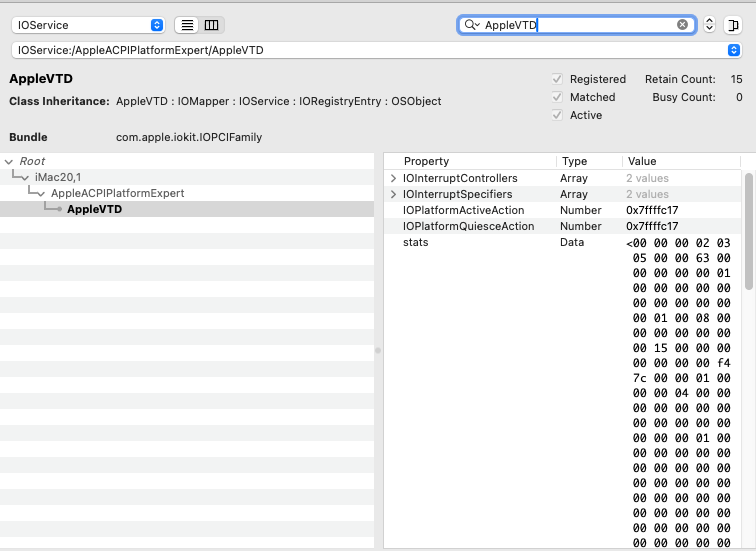

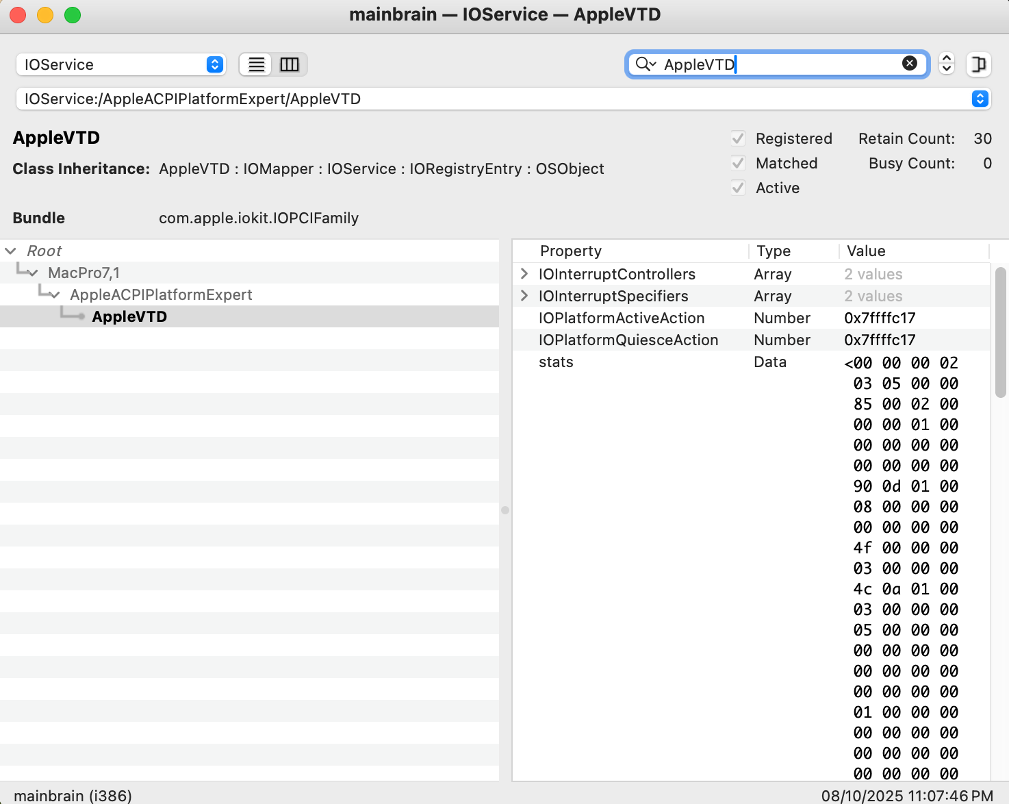

@ichelash When you set DisableIoMapper to true/YES in the Kernel --> Quirks section of your Config.plist file you are actually disabling
AppleVTD without which the NEW WiFi firmware cannot be loaded and hence activation of WiFi fails.
Setting DisableIoMapper to false/NO in your Config.plist file will enable AppleVTD, provided VTD is  also enabled in Bios, being the condition that is required for the NEW WiFi firmware to properly load from its /usr/local/share/firmware/wifi/ repository, and thus enabling WiFi functionality, as required.
The fact that you lose Ethernet Lan connectivity when the NEW WiFi is activated is attributable to the fact that the type of Ethernet Lan driver in your system will NOT work with VTD enabled.
In my particular case my specific Ethernet Lan drivers don't bother whether VTD is enabled or not, they work whether VTD is on or off.
@Mieze has covered this topic already a number of times.
Would be interesting to learn whether your sleep functionality is actually working as it should when you are networking with the NEW WiFI activation method.
For the NEW WiFi to work IORegistry should have an AppleVTD entry as per the screenshot attached.
Greetings Henties
Greetings Henties
