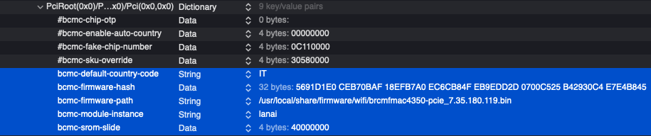

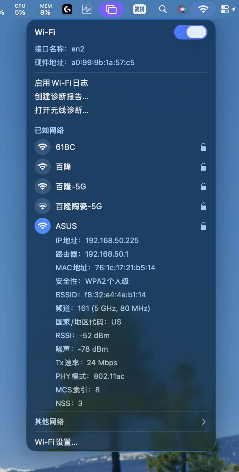

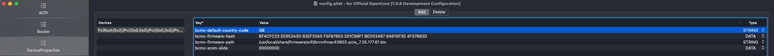

schrup21 Posted October 17, 2025 Share Posted October 17, 2025 you can place the key bcmc-default-country-code in the DeviceProperty, type String, Value EU (kidding) - GB there is also a bcmc-enable-auto-country which I believe sets the country code of your operating system https://github.com/0xFireWolf/AppleBCMWLANCompanion/blob/main/Documentation/DeviceProperties.md Link to comment https://www.insanelymac.com/forum/topic/361710-broadcom-fullmac-wi-fi-support-on-macos-sonoma-sequoia-and-tahoe-without-root-patches/page/9/#findComment-2842375 Share on other sites More sharing options...

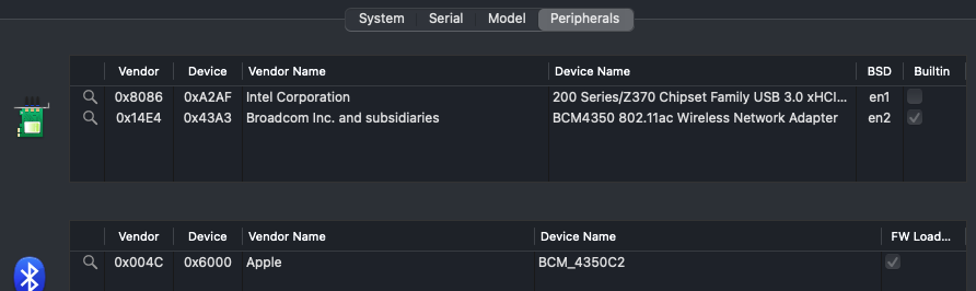

kgp Posted October 17, 2025 Share Posted October 17, 2025 (edited) 12 minutes ago, eSaF said: As you can see from the attached pics, I believe the entries I made are correct, yet the Country Code is incorrect. I will continue to search for a solution. Cheers. Your country code is GB, man 🙃! https://en.wikipedia.org/wiki/ISO_3166-1_alpha-2#Current_codes key: bcmc-default-country-code Value: GB Type: STRING Edited October 17, 2025 by KGP-iMacPro Link to comment https://www.insanelymac.com/forum/topic/361710-broadcom-fullmac-wi-fi-support-on-macos-sonoma-sequoia-and-tahoe-without-root-patches/page/9/#findComment-2842378 Share on other sites More sharing options...

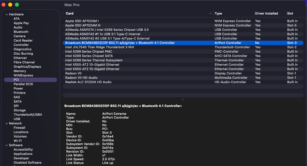

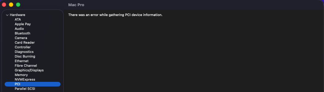

kgp Posted October 18, 2025 Share Posted October 18, 2025 (edited) 17 minutes ago, eSaF said: Easy there Bro!!! From the time Apple changed how connection is handled in Sonoma, then changed yet again in Sequoia and now Tahoe, each time the task to get our once working hacked Broadcom Cards got more and more difficult. Initially it took the OCLP Devs almost a year to find a viable working solution for Sonoma with an appeal asking all to be patient as the task is not easy and then again same thing with Sequoia. Placing @Austere.J in a projected box and possibly labelling it egocentric is in my opinion counterproductive to the project. I can only assume he alone is working on this whereas the OCLP Devs has a whole team and as was recently announced, one prominent member left and joined Apple so that in it self is a set back. Bro I am not in anyway bad mouthing you, I can feel and relate with your frustration but we have to be patient. I have faith a solution will be found sooner or later. I still have the Apple Card installed and whenever I hit a snag, I tend to put the blame on it and muse about putting the Fenvi back in place. At the moment my loss is Sleep, AirDrop and Wireless Handoff to iPhone camera, which I had with the Fenvi Card after OCLP patching Sequoia and Sonoma in my multi-booting setup all running off a single EFI Folder. In essence for me the benefits of this Card at the moment is way below the Fenvi but I am willing to wait it out and see how the project progresses. Yes I will swear and mutter under my breath every time I hit a snag but berating developers for assumed delays won't help me. As the last macOS journey on our Intel and AMD machines, you'd think as a parting gift Tim and Crew would make the experience easy, as it turned out, not so much but what you gonna do??!! Cheers. Bro, just to clarify — my remark about the thread becoming a bit less focused and at times somewhat self-centered was, of course, not directed at @Austere.J. I was rather referring to the last discussion from last night above, which, in my opinion, felt somewhat counterproductive and a bit impolite - as also reflected by my not-so-amused emojis at the time. And honestly, it was not the first time I felt such.. Edited October 18, 2025 by KGP-iMacPro Link to comment https://www.insanelymac.com/forum/topic/361710-broadcom-fullmac-wi-fi-support-on-macos-sonoma-sequoia-and-tahoe-without-root-patches/page/9/#findComment-2842426 Share on other sites More sharing options...

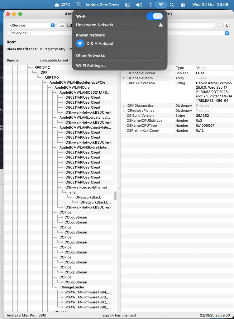

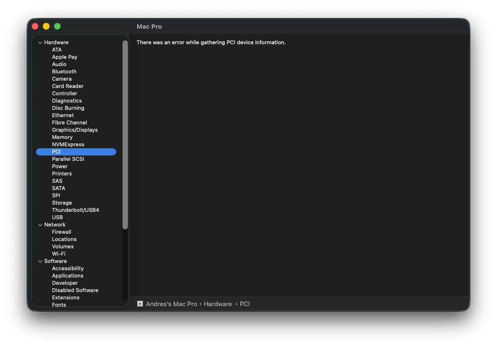

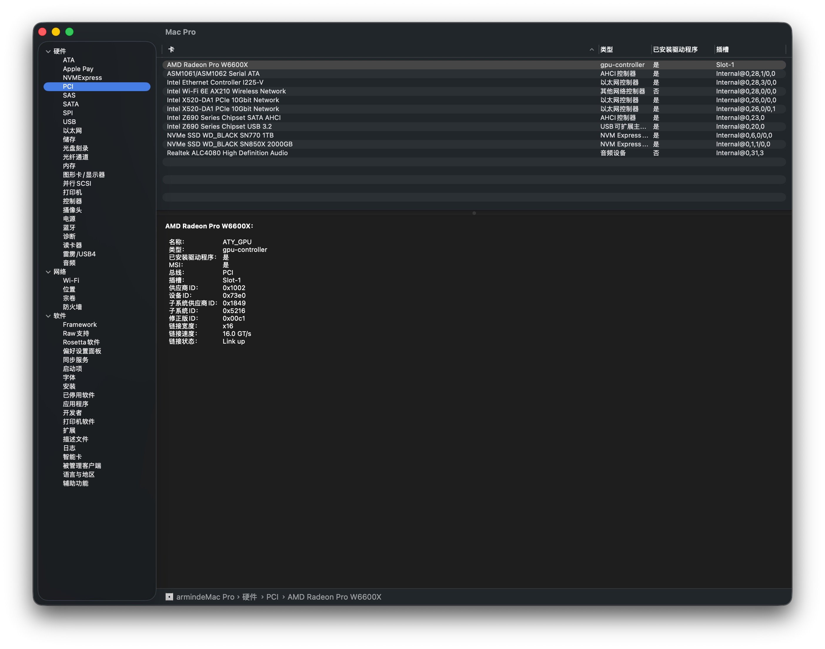

Andres ZeroCross Posted October 22, 2025 Share Posted October 22, 2025 On 10/17/2025 at 11:46 PM, KGP-iMacPro said: The issue with "System Information" -> "PCI" on my system is really weird and I don't find any other culprit than AppleBCMWLANCompanion.kext. With AppleBCMWLANCompanion.kext disabled: With AppleBCMWLANCompanion.kext enabled: although under IOReg everything is properly implemented No idea, how to remove this issue... Same here Link to comment https://www.insanelymac.com/forum/topic/361710-broadcom-fullmac-wi-fi-support-on-macos-sonoma-sequoia-and-tahoe-without-root-patches/page/9/#findComment-2842654 Share on other sites More sharing options...
cfmwan Posted October 22, 2025 Share Posted October 22, 2025 (edited) Yse! Now I feel one step closer to perfection. Edited October 22, 2025 by cfmwan 1 Link to comment https://www.insanelymac.com/forum/topic/361710-broadcom-fullmac-wi-fi-support-on-macos-sonoma-sequoia-and-tahoe-without-root-patches/page/9/#findComment-2842657 Share on other sites More sharing options...
cfmwan Posted October 22, 2025 Share Posted October 22, 2025 1 hour ago, Andres ZeroCross said: Same here Just don't inject the slot information of the wireless network card. Link to comment https://www.insanelymac.com/forum/topic/361710-broadcom-fullmac-wi-fi-support-on-macos-sonoma-sequoia-and-tahoe-without-root-patches/page/9/#findComment-2842661 Share on other sites More sharing options...
