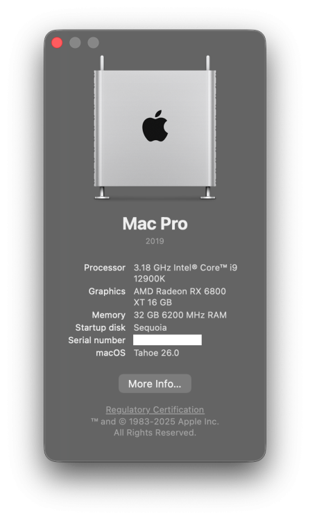

Cyberdevs Posted June 10, 2025 Share Posted June 10, 2025 After spending a whole day trying to do a clean install and failing to do so, I've decided to upgrade my spare macOS Sequoia to Tahoe and it went without any issue up to the welcome screen, then I realized I don't have USB connctivity. Good thing is that I've had screen sharing enabled so I can control Tahoe from another system until I sort out the USBs issue. Oh Boy! Is it just me or the UI is really ugly? 6 Link to comment https://www.insanelymac.com/forum/topic/361162-pre-release-macos-tahoe/page/7/#findComment-2833073 Share on other sites More sharing options...

Cyberdevs Posted June 10, 2025 Share Posted June 10, 2025 3 minutes ago, surenmunoo said: Is this with the 6800XT card? Yes Z690 Aorus Master, 12900K, 6800XT 5 Link to comment https://www.insanelymac.com/forum/topic/361162-pre-release-macos-tahoe/page/7/#findComment-2833076 Share on other sites More sharing options...
surenmunoo Posted June 10, 2025 Share Posted June 10, 2025 1 minute ago, Cyberdevs said: Yes Z690 Aorus Master, 12900K, 6800XT Thanks, any special changes that had to be done to get past the black screen? 1 Link to comment https://www.insanelymac.com/forum/topic/361162-pre-release-macos-tahoe/page/7/#findComment-2833077 Share on other sites More sharing options...
Cyberdevs Posted June 10, 2025 Share Posted June 10, 2025 7 minutes ago, surenmunoo said: Thanks, any special changes that had to be done to get past the black screen? There was no such thing as black screen while updating from Sequoia to Tahoe, the black screen was a part of a wide system freeze and I suspect the USB and the whole kexts/acpi tables not being injected correctly is the root cause, it's a hunch though, but I'm pretty sure with the next updates to OC and the Kexts this issue will be resolved. I'm not using WEG, I'm using DeviceProperties to activate my GPU P.S. If any of you guys wanna try upgrading from Sequoia i strongly suggest to enable Screen Sharing before hand so if you lose USBs you can control your system remotely otherwise the whole process will be a waste of time. 6 Link to comment https://www.insanelymac.com/forum/topic/361162-pre-release-macos-tahoe/page/7/#findComment-2833078 Share on other sites More sharing options...

Cyberdevs Posted June 10, 2025 Share Posted June 10, 2025 9 minutes ago, kidooe said: Another PC boots with usb ports working MoBo: Gigabyte Z390 UD CPU: Intel core i5 9600K gpu: intel uhd 630 + Nvidia GTX 1080Ti (disabled in macos) Oh yeah! I disabled USB kexts and just SSDT_UIAC.aml and now I have USB ports and BT from my Fenvi T919! YaY! 8 Link to comment https://www.insanelymac.com/forum/topic/361162-pre-release-macos-tahoe/page/7/#findComment-2833083 Share on other sites More sharing options...

Cyberdevs Posted June 10, 2025 Share Posted June 10, 2025 @eSaF @Irish_Man @surenmunoo and anyone else whom had issues with the installer not working: Urika! I've found the culprit for all the headaches and stalling. I disabled all the USB related kexts and only used SSDT-UIAC.aml as @kidooe suggested in and I'm doing a clean install of macOS Taco! USB ports work just fine I'm using MacPro7,1 SMBIOS with the updated OC and the kexts from @lorys89 post without any beta boot args. Thanks guys! 6 2 Link to comment https://www.insanelymac.com/forum/topic/361162-pre-release-macos-tahoe/page/7/#findComment-2833088 Share on other sites More sharing options...

Cyberdevs Posted June 10, 2025 Share Posted June 10, 2025 Clean installation is done! and It was as smooth as butter. Now I can sleep like a baby! 6 4 Link to comment https://www.insanelymac.com/forum/topic/361162-pre-release-macos-tahoe/page/7/#findComment-2833093 Share on other sites More sharing options...
