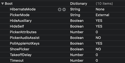

1 hour ago, telepati said:
Just set External that's it. Of course, don't forget to add resources. I just test it.
76165483-6d82c080-6168-11ea-9cca-b45289c15257.JPG.b9e017040a697198c9abc4f64c5eb97e.JPG
...and where are the resources (OC/Resources/Image and OC/Resources/Font) ?
The build tool I used last night did not provide these.
So where did you get them from ?

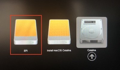

@telepati What am I going to do with the log? I told you you can dump it to check the boot path of that entry to find out its origin.
Quote
01:542 00:003 OCB: Entry 0 is EFI at dp PciRoot(0x0)/Pci(0x14,0x0)/USB(0x18,0x0)/HD(1,GPT,E00D6EB7-BA48-49FD-84C3-BFBECABB6DF8,0x28,0x64000)/\EFI\BOOT\BOOTX64.EFI
  • Thanks 1
Sorry, sometimes I have difficulty understanding because of my English lack. Thanks, I got it better now.
