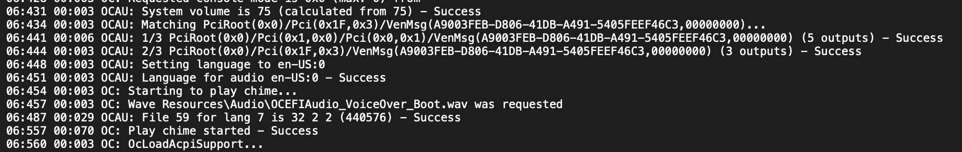

Pavo Posted February 29, 2020 Share Posted February 29, 2020 (edited) Realtek ALC1220 on AMD MSI mobo, somewhat works. It only plays the boot chime sound 1/3 of the length though. OCAU: Matching PciRoot(0x0)/Pci(0x8,0x1)/Pci(0x0,0x4)/VenMsg(A9003FEB-D806-41DB-A491-5405FEEF46C3,00000000) OCAU: 1/2 PciRoot(0x0)/Pci(0x3,0x1)/Pci(0x0,0x0)/Pci(0x0,0x0)/Pci(0x0,0x1)/VenMsg(A9003FEB-D806-41DB-A491-5405FEEF46C3,00000000) (6 outputs) - Success OCAU: 2/2 PciRoot(0x0)/Pci(0x8,0x1)/Pci(0x0,0x4)/VenMsg(A9003FEB-D806-41DB-A491-5405FEEF46C3,00000000) (5 outputs) - Success Edited February 29, 2020 by Pavo Link to comment https://www.insanelymac.com/forum/topic/350754-opencore-general-discussion/page/132/#findComment-2710434 Share on other sites More sharing options...

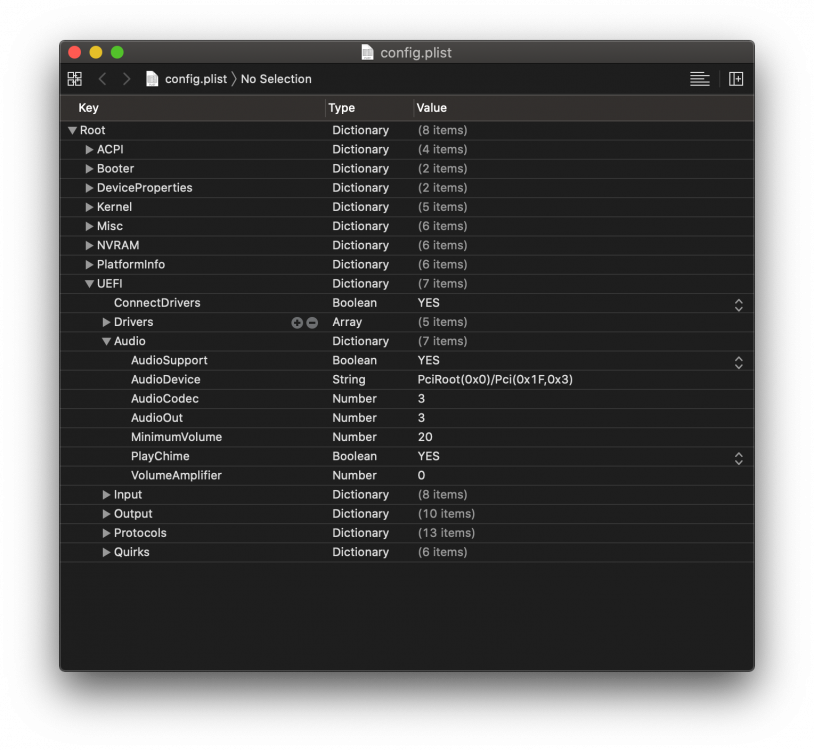

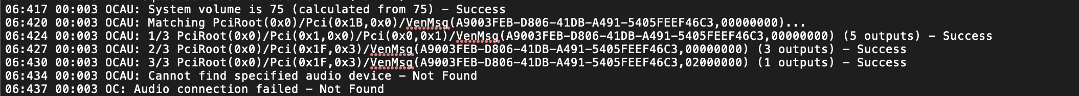

telepati Posted February 29, 2020 Share Posted February 29, 2020 Guys finally I got this and saying Audio connection failed. I set up this way but still saying Audio Connection Failed; Link to comment https://www.insanelymac.com/forum/topic/350754-opencore-general-discussion/page/132/#findComment-2710436 Share on other sites More sharing options...
Pavo Posted February 29, 2020 Share Posted February 29, 2020 Just now, telepati said: Guys finally I got this and saying Audio connection failed. I set up this way but still saying Audio Connection Failed; Your AudioCodec and AudioOut is wrong, AudioCodec should be 0 and AudioOut looks like it is 0 or 2. 1 1 Link to comment https://www.insanelymac.com/forum/topic/350754-opencore-general-discussion/page/132/#findComment-2710438 Share on other sites More sharing options...

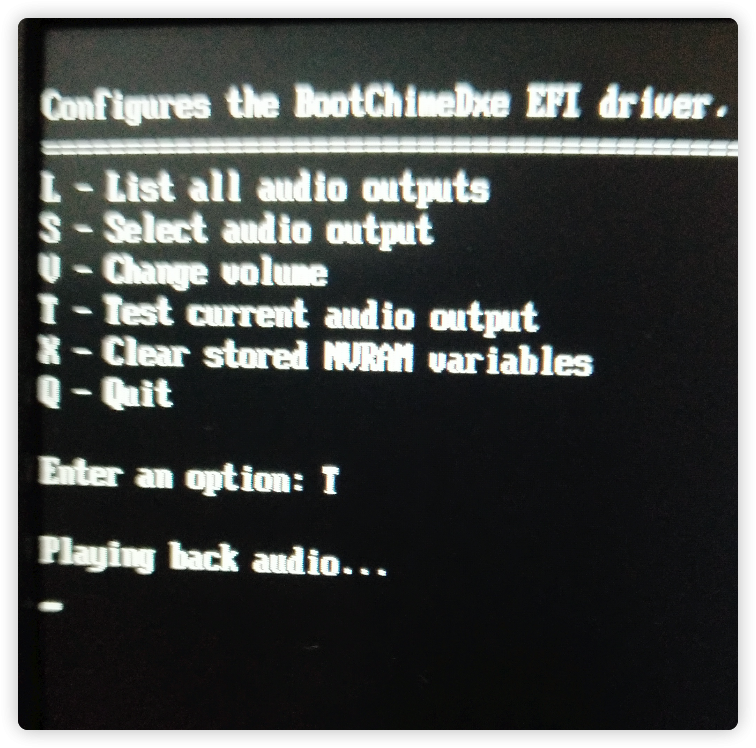

btwise Posted February 29, 2020 Share Posted February 29, 2020 2 hours ago, vit9696 said: either your audio card is unsupported, or your AudioOut is not correct, try to bruteforce all the values from 0 to N-1 outputs. In the same environment, using bootchimecfg of goldfish, test playing the built-in ChimeData is completely normal, but it cannot be played under OC! Link to comment https://www.insanelymac.com/forum/topic/350754-opencore-general-discussion/page/132/#findComment-2710439 Share on other sites More sharing options...
telepati Posted February 29, 2020 Share Posted February 29, 2020 9 minutes ago, Pavo said: Your AudioCodec and AudioOut is wrong, AudioCodec should be 0 and AudioOut looks like it is 0 or 2. I used 0/0 and looks like working on debug.log. But I can't hear the sound on boot that's weird. Link to comment https://www.insanelymac.com/forum/topic/350754-opencore-general-discussion/page/132/#findComment-2710442 Share on other sites More sharing options...

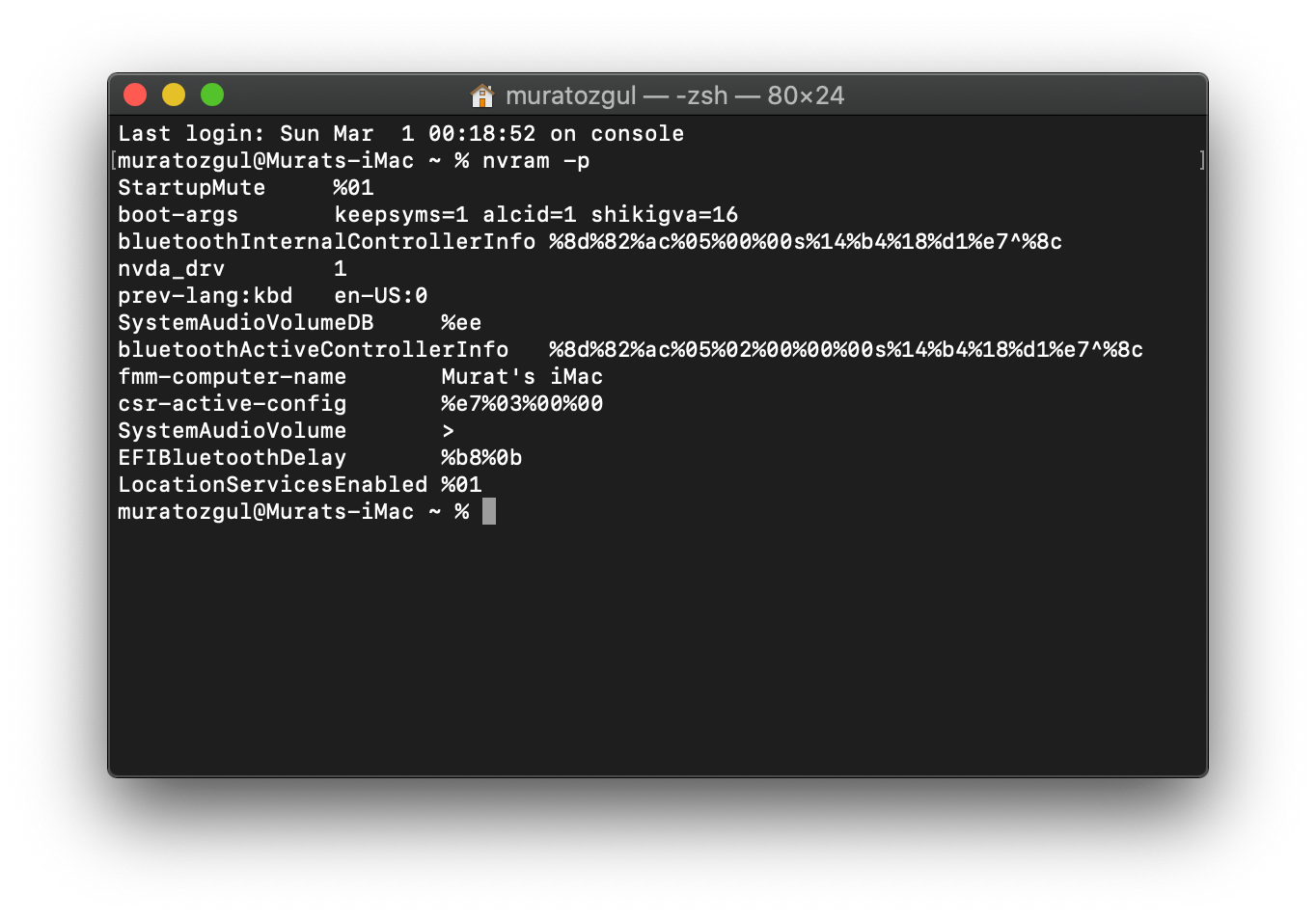

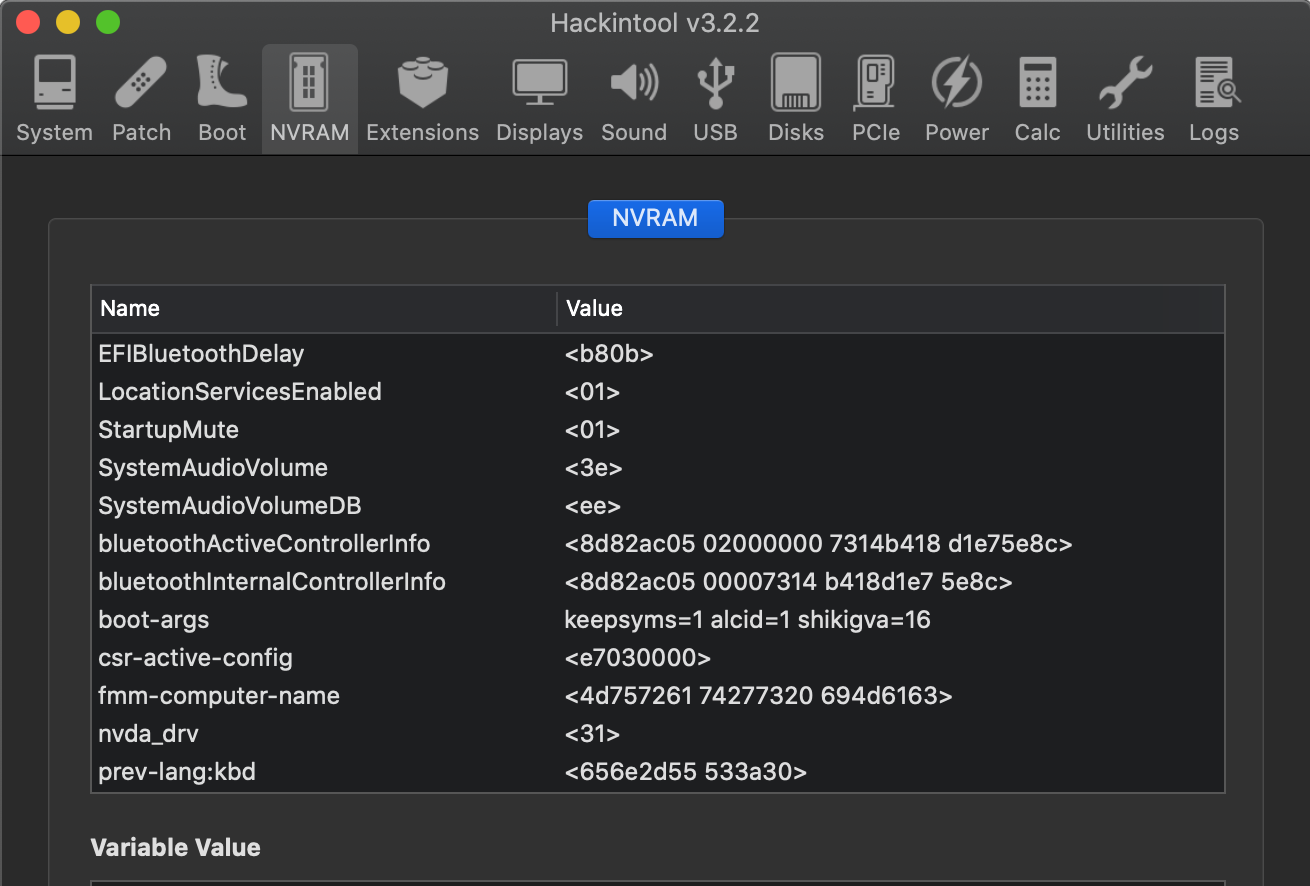

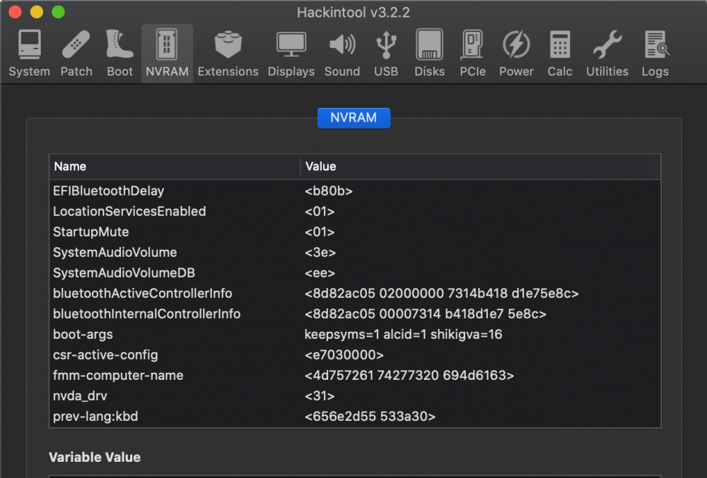

telepati Posted February 29, 2020 Share Posted February 29, 2020 (edited) Why StartupMute shows 01 in NVRAM? Is that mean Startup Chime disabled by deafult in NVRAM? Edited February 29, 2020 by telepati Link to comment https://www.insanelymac.com/forum/topic/350754-opencore-general-discussion/page/132/#findComment-2710472 Share on other sites More sharing options...
Andres ZeroCross Posted February 29, 2020 Share Posted February 29, 2020 1 hour ago, telepati said: Why StartupMute shows 01 in NVRAM? Is that mean Startup Chime disabled by deafult in NVRAM? Where (how) did you see this information??? Link to comment https://www.insanelymac.com/forum/topic/350754-opencore-general-discussion/page/132/#findComment-2710491 Share on other sites More sharing options...

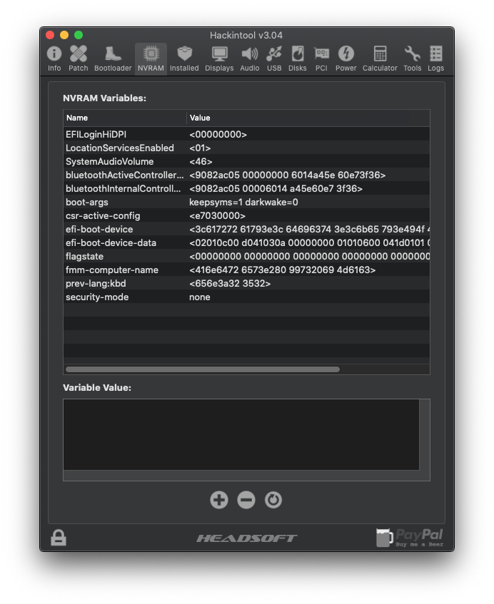

telepati Posted February 29, 2020 Share Posted February 29, 2020 (edited) 1 hour ago, Andres ZeroCross said: Where (how) did you see this information??? nvram -p command and hackintool shows this. As far as I know "sudo nvram StartupMute=%00" activate Startup Chime on newer mac "sudo nvram StartupMute=%01" re-activating it. Edited February 29, 2020 by telepati Link to comment https://www.insanelymac.com/forum/topic/350754-opencore-general-discussion/page/132/#findComment-2710504 Share on other sites More sharing options...
Andres ZeroCross Posted February 29, 2020 Share Posted February 29, 2020 47 minutes ago, telepati said: nvram -p command and hackintool shows this. As far as I know "sudo nvram StartupMute=%00" activate Startup Chime on newer mac "sudo nvram StartupMute=%01" re-activating it. I don't have that in my NVRAM,did you manually inject it from terminal???? Link to comment https://www.insanelymac.com/forum/topic/350754-opencore-general-discussion/page/132/#findComment-2710510 Share on other sites More sharing options...

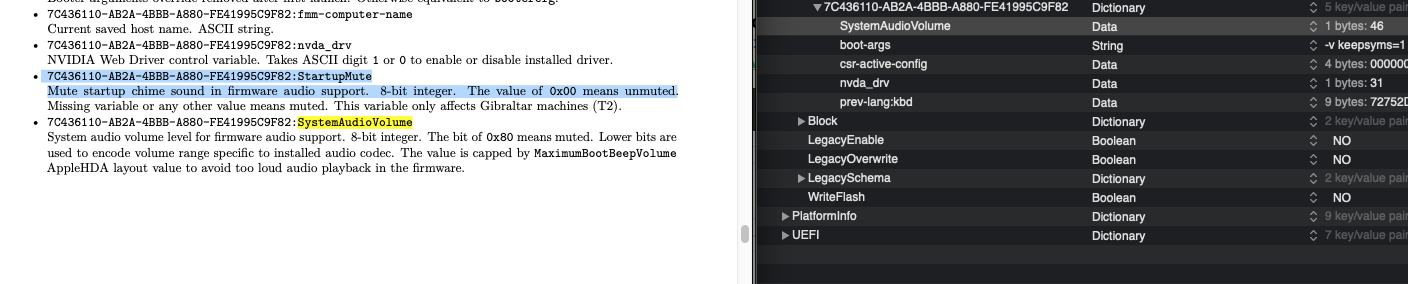

Andres ZeroCross Posted February 29, 2020 Share Posted February 29, 2020 54 minutes ago, telepati said: nvram -p command and hackintool shows this. As far as I know "sudo nvram StartupMute=%00" activate Startup Chime on newer mac "sudo nvram StartupMute=%01" re-activating it. Check your NVRAM Properties in config.plist. I don't add it. Or maybe just add "StartupMute = 0" However i didn't use this properties for my NVRAM because i didn't see it in SampleFull.plist Link to comment https://www.insanelymac.com/forum/topic/350754-opencore-general-discussion/page/132/#findComment-2710511 Share on other sites More sharing options...

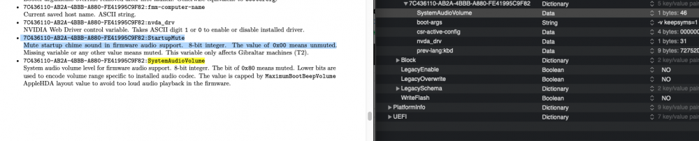

telepati Posted March 1, 2020 Share Posted March 1, 2020 1 hour ago, Andres ZeroCross said: Check your NVRAM Properties in config.plist. I don't add it. Or maybe just add "StartupMute = 0" However i didn't use this properties for my NVRAM because i didn't see it in SampleFull.plist How is your StartupMute showing with nvram -p command? is it shows <00> or <01>? Link to comment https://www.insanelymac.com/forum/topic/350754-opencore-general-discussion/page/132/#findComment-2710535 Share on other sites More sharing options...
Andrey1970 Posted March 1, 2020 Share Posted March 1, 2020 Read Сonfiguration about MinimumVolume. Link to comment https://www.insanelymac.com/forum/topic/350754-opencore-general-discussion/page/132/#findComment-2710537 Share on other sites More sharing options...
Andres ZeroCross Posted March 1, 2020 Share Posted March 1, 2020 9 hours ago, telepati said: How is your StartupMute showing with nvram -p command? is it shows <00> or <01>? I didn't have "StartupMute" properties in my NVRAM when i run "nvram -P" 1 Link to comment https://www.insanelymac.com/forum/topic/350754-opencore-general-discussion/page/132/#findComment-2710561 Share on other sites More sharing options...
