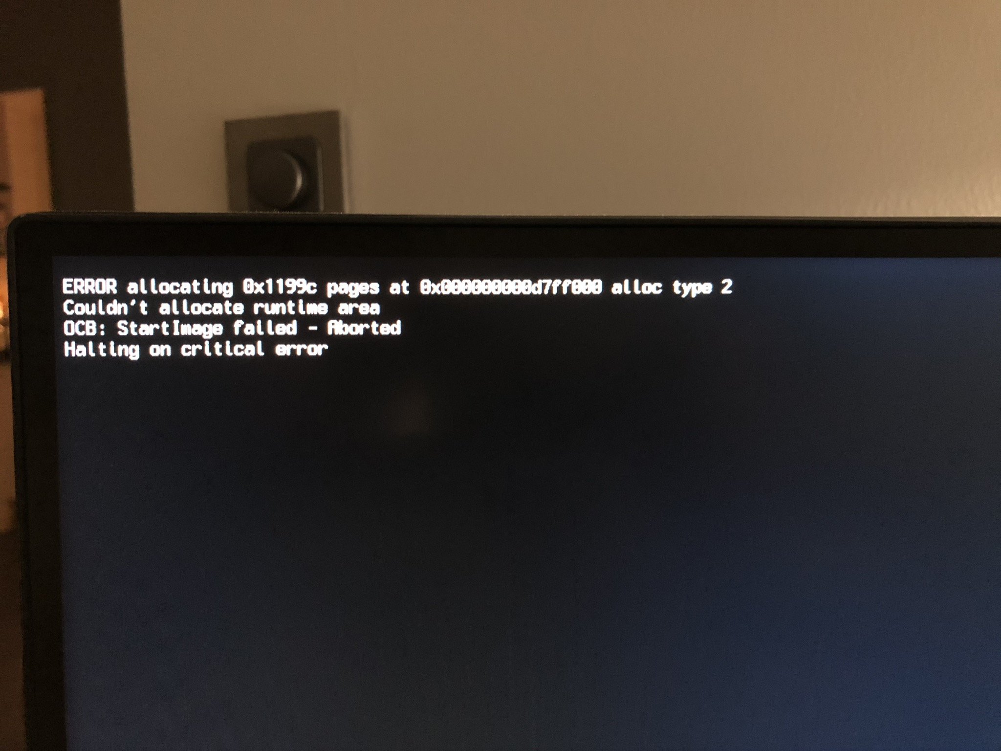

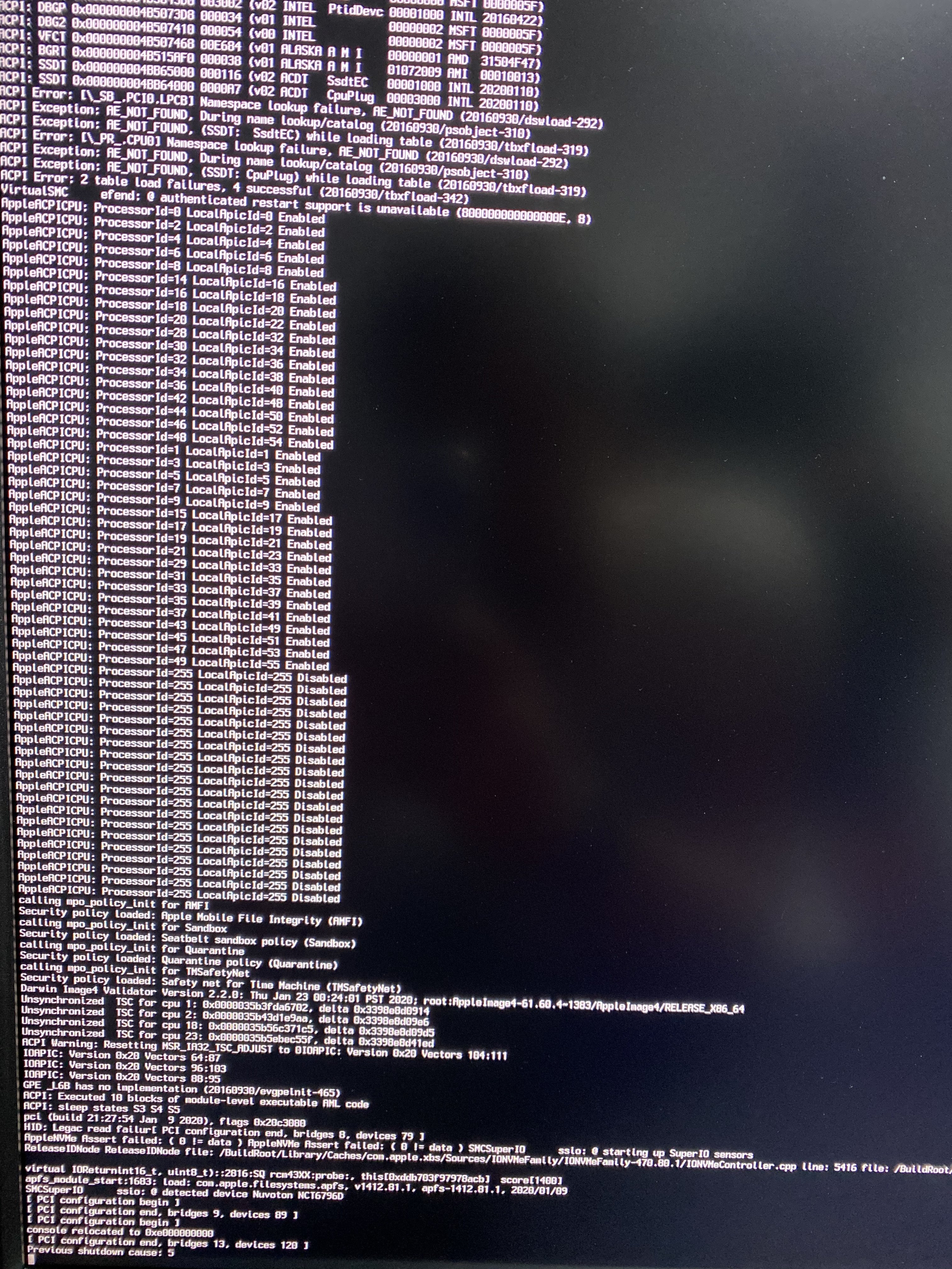

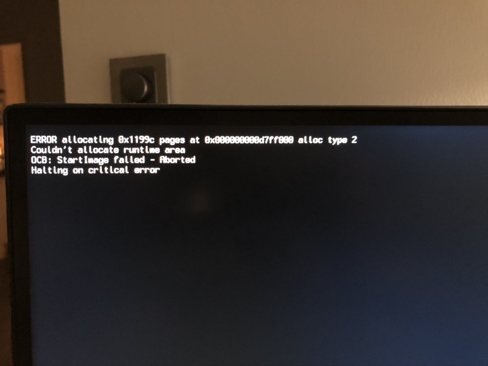

Yeh.. stupid error! I solved both, now the boot starts but freezes like in attached pics, I even removed all the SSDTs a part form PLUG and EC-USBX (adjusting config.plist accordingly). stuck again...
2D811111-9D51-49F1-AFF7-CA1ECF9CFB5C.heic
6D74A5C5-7CAD-43F9-93C6-4780F6914F47.heic
The second picture looks like SSDT-EC-USBX.aml error. The suggestion follows the Skylake X guide do not add your all SSDT's first just use the minimal setting on the guide.
https://khronokernel-2.gitbook.io/opencore-vanilla-desktop-guide/intel-hedt-config.plist/skylake-x
YEah... sure. The reality is that I borrowed those 2 SSDTs (PLUG and USBX) from another user,  to be honest he gave me all those SSDTs in my EFI
I don't know if they are good, I just know they work on 0.5.5 and something is not working on the new 0.5.6 folder I created. I suspect is a matter of ACPI patches related to SSDTs, because in my original and working 0.5.5 folder there are a lot of them, but in the brand new 0.5.6 folder I didn't added patches cause I don't know hot to handle them. It's a total mess...

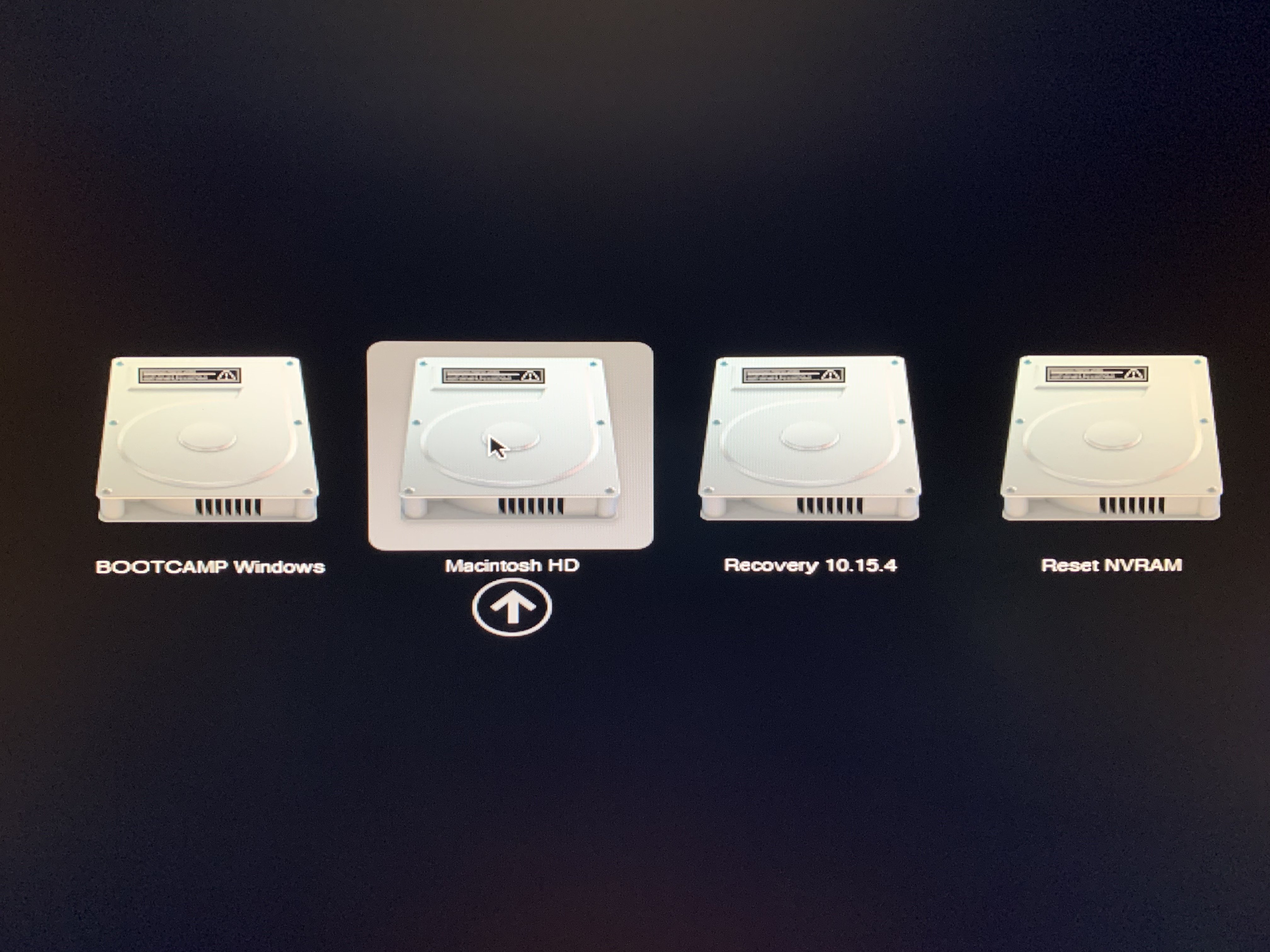

But I have a question for you about boot disk order. If I set HideAuxilary YES, Scan Policy 0 it shows my main boot drive 1. Catalina. This is correct.
But when I click to Space bar its change the boot order like this;
1. Time Machine
2. Catalina
3. Recovery
4. Clean NVRAM

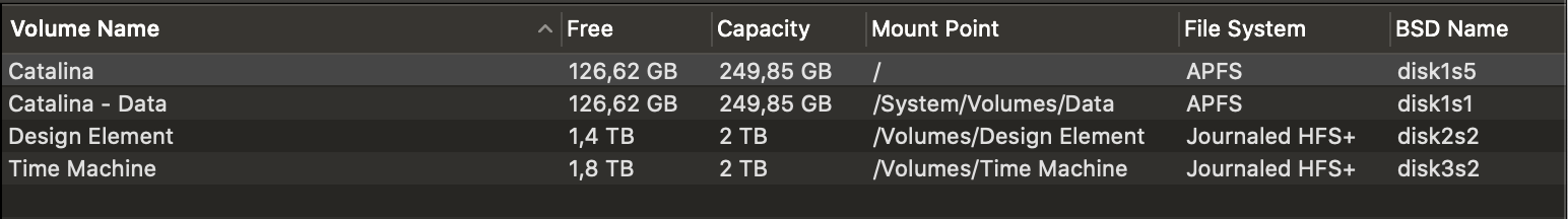

Here is the question; Why doesn't OpenCore put the boot disk in the first place after clicking the Space bar? (This is really important for users who don't use the Timeout option like me, cause on any broke, OpenCore always choosing the first drive as a boot.)
I thought, maybe this is happening because of my disk BSD order but I checked it. My Data drive is on the disk1s1.
1104527736_ScreenShot2020-03-07at15_14_13.thumb.png.d9f4c2b5a768240d5a3590012d32c736.png
Disk order is determined by UEFI firmware, I do not think there is a good reason to invent a wheel and try to do some kind of sorting under weird rules. If we start reordering boot entries, people who use multiple operating systems will have to wonder which entry is going to be where every time they load the picker. Having a stable order on the other side allows them to reliably use number keys to choose the OS.
Thank you for the explanation I didn't know that. I thought this is totally related to OpenCore. Thanks again. :thumbsup_anim:
