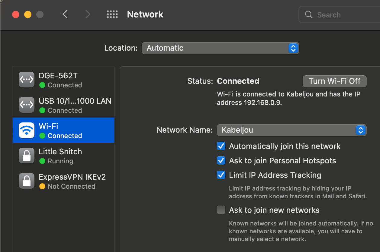

Irish_Man Posted April 11, 2022 Author Share Posted April 11, 2022 (edited) After i set DisableIOMapper to NO, i lost Wifi. Basically, i can use Ethernrt or Wifi, not both. If i want to use Wifi i had to set it to YES. But then, i cant use Ethernet. Anyone else experienced this problem? By lost, I mean i cant turn Wifi ON. It’s there, recognized in Sysprefs but cant turn it on. Edited April 11, 2022 by Irish_Man Link to comment https://www.insanelymac.com/forum/topic/348493-discussion-intel-i225-v-on-macos-monterey/page/13/#findComment-2779854 Share on other sites More sharing options...

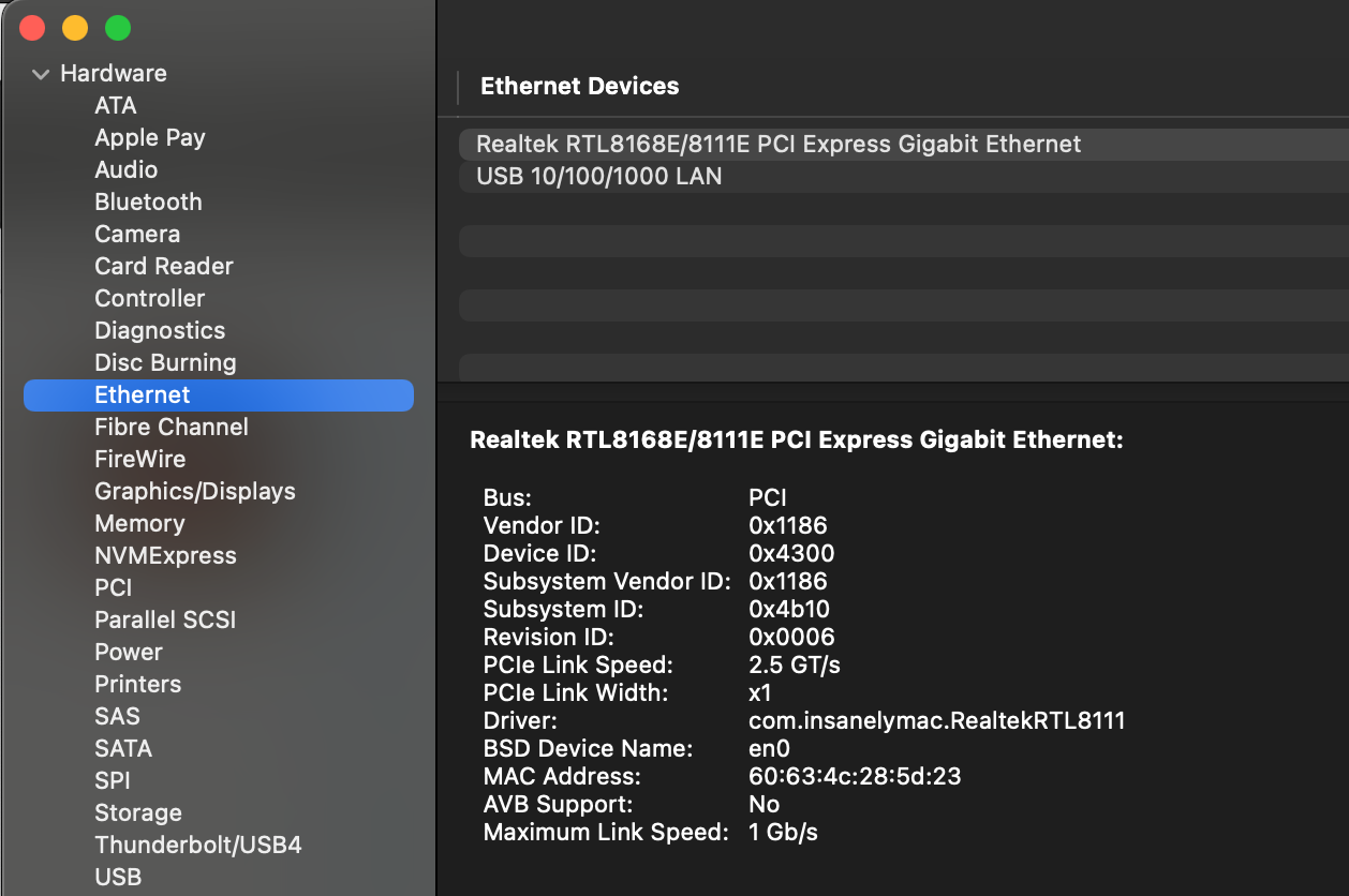

Henties Posted April 11, 2022 Share Posted April 11, 2022 @Irish_Man Same here, WiFi cannot be enabled with the patch for the I225-V, being one of the other reasons why I have reverted back to my aftermarket DGE-560T PCIe NIC, in the process obviously having to sacrifice one single lane PCIe slot, considering my workflow in my particular environment that sacrifice is actually a small price to pay, This card works in all respects, including "Wake for network access" as well as "Enable Power Nap". With this NIC my 2 GA-Z490 Version G hacks are as close as one can get to the behaviour of a real Intel based hack. In addition I use a USB gigabit NIC as a second network port, I use this one to divert DANTE traffic away from the port occupied by the DGE-560T. The USB NIC is supported natively by macOS Big Sur and or Monterey. Greetings Henties Link to comment https://www.insanelymac.com/forum/topic/348493-discussion-intel-i225-v-on-macos-monterey/page/13/#findComment-2779888 Share on other sites More sharing options...

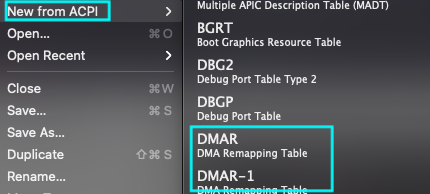

Guest 5T33Z0 Posted April 11, 2022 Share Posted April 11, 2022 (edited) @Irish_Man@Henties I don' thave a WiFI module for my Z490 Vision G. But instead of just dropping the DMAR table, I replace it by a modified one where the Reserved Memory Regions are removed. This way, my 3rd Party Network Card works. Maybe it also works for wifi as well. So, basically: Drop the Original DMAR Table via ACPI/Delete Add the Modified one via ACPI/Add See what happens DMAR-MOD.aml Edited April 11, 2022 by 5T33Z0 Link to comment https://www.insanelymac.com/forum/topic/348493-discussion-intel-i225-v-on-macos-monterey/page/13/#findComment-2779890 Share on other sites More sharing options...

Guest 5T33Z0 Posted April 19, 2022 Share Posted April 19, 2022 @miliuco Can you please test in Clover if it's working for you? Everybody is saying "well this has been working for ages" but no one actually checks if it still works. And in my experience it currently doesn't. Dropping DMAR in OpenCore takes a bit more effort (but at least it works): https://github.com/5T33Z0/OC-Little-Translated/tree/main/00_About_ACPI/ACPI_Dropping_Tables Link to comment https://www.insanelymac.com/forum/topic/348493-discussion-intel-i225-v-on-macos-monterey/page/13/#findComment-2780630 Share on other sites More sharing options...

Guest 5T33Z0 Posted April 19, 2022 Share Posted April 19, 2022 Okay, I still don't know why the DMAR table isn't just dropped by Clover, but someone on Reddit had a solution. Basically, you have to enable "AutoMerge". Then the patched DMAR in ACPI/patched will be merged with the one in the system and then it has the correct length and content. That's really different compared to how OpenCore handles it. Link to comment https://www.insanelymac.com/forum/topic/348493-discussion-intel-i225-v-on-macos-monterey/page/13/#findComment-2780639 Share on other sites More sharing options...
