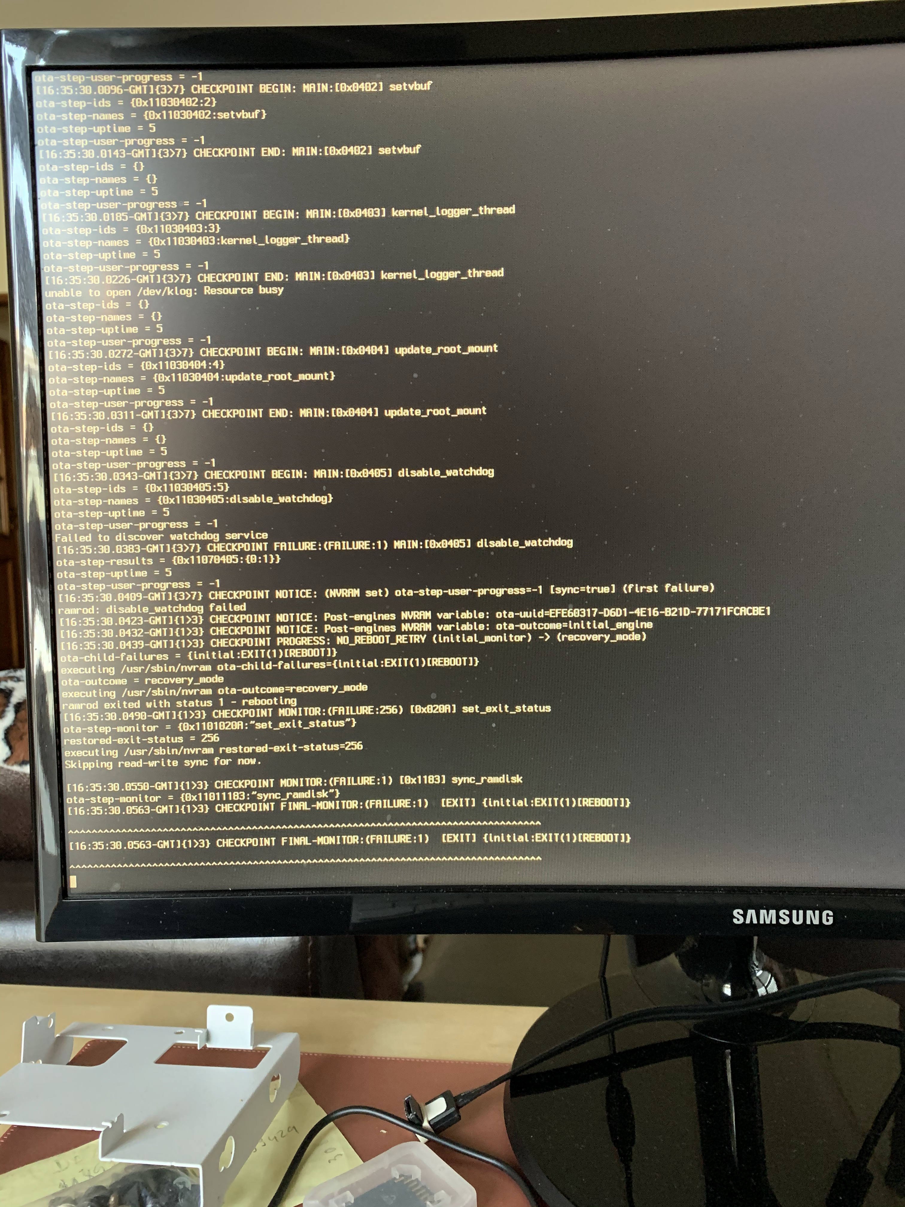

i still haven't found a solution to that SIGABRT. Can't seem to understand what is causing it

SOLUTION TO SIGABRT:
Before I get there, here's a little backstory. I was a clover user until big sur and really wanted to try OC, big sur came and so did the opportunity. Tried to be over smart and make a OC folder directly and paste it into EFI without resetting or deleting any past variables. It did work successfully into Big Sur BUT those variables would come to bite me when I chose to install from an external media.
So the solution is to keep whatever your virtualsmc and whatever kexts you already have, reboot into the pendrive and in OC menu, tap on RESET NVRAM. Tiny reboot by the system and you will see nothing into your boot menu, just opencore. Hit that and then when you come in OC menu, hit on install MacOS Beta. And doodah you are in the installer! :D
