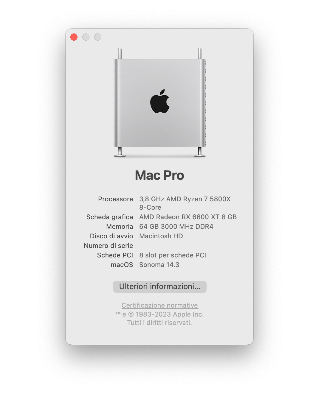

D3v1L Posted January 10, 2024 Share Posted January 10, 2024 Guys, today my new AMD hack is on, i'm write here with it... Only minus issue (cpu name etc..btw not a big problem)... Btw, for everyone on Z390 Aorus Pro, a little present. Here, my last Z390 Aorus Pro EFI with this efi, my hack is great and ALL working (when I say, all, i mean ALL)... 0.9.7 OC + latest DEV kext updated today... This efi is BCM4360 PATCH READY (all needed block and kext, are activated by default) separate CONFIG file for separate smbios and dGPU (in a separate config directory) config for: MacPro7,1 with NAVI card Please update with your USBmap (USBmap already in folder and ACTIVATED) Set AGPMInjector for your specify dGPU (AGPMInjector for RX6600XT already on kext folder but deactivated). Set correct CPUFriendDataProvider for your CPU (CPUFriendDataProvider for i5-9600k already in the folder but deactivated) MacPro7,1 with POLARIS card Please update with your USBmap (USBmap already in folder and ACTIVATED) iMac19,1 with NAVI card and iGPU in quicksync mode Please update with your USBmap (USBmap already in folder and ACTIVATED) Set AGPMInjector for your specify dGPU (AGPMInjector for RX6600XT already on kext folder but deactivated) iMac19,1 with POLARIS card and iGPU in quicksync mode Please update with your USBmap (USBmap already in folder and ACTIVATED) iMac19,1 with iGPU only, not released. Pay attention, rename the config file according to you selected smbios and dGPU, to "config.plist" .. eg. config-iMac19.1-navi.plist -> config.plist and copy inside OC directory. Pay attention 2, after install, update your serial number smuuid mlb and rom... In every config file, there's a dummy serial etc, just for install. Pay attention 3, due to exceeding MB, i'll need to separate "resources" folder from EFI/OC and upload in second post... download the 2 zip (efi + resources) and put "Resource" directory in theyr place before start with this efi..thanks. If you wanna use your personal Resources folder with your Theme, symply put it in the right place in EFI (EFI/OC), and update config.plist with new theme path ! 🙂 EFI Aorus PRO Z390.zip POST 2 with resources dir This resources, is updated with Sonoma icon Resources.zip BTW, THIS EFI, HAVE DRIVERS INSTALLED FOR: HFS ; APFS ; NTFS ; EXT4 ; LINUX DEFAULT ENABLED SO, IS USB/INSTALLER READY. 4 Link to comment https://www.insanelymac.com/forum/topic/339980-audiogods-aorus-z390-pro-patched-dsdt-mini-guide-and-discussion/page/216/#findComment-2815369 Share on other sites More sharing options...
D3v1L Posted January 10, 2024 Share Posted January 10, 2024 And voila! CPU name is now ok ahahah LoL btw, is much more stable than my poor ex 9600k ahahah 1 Link to comment https://www.insanelymac.com/forum/topic/339980-audiogods-aorus-z390-pro-patched-dsdt-mini-guide-and-discussion/page/216/#findComment-2815375 Share on other sites More sharing options...
