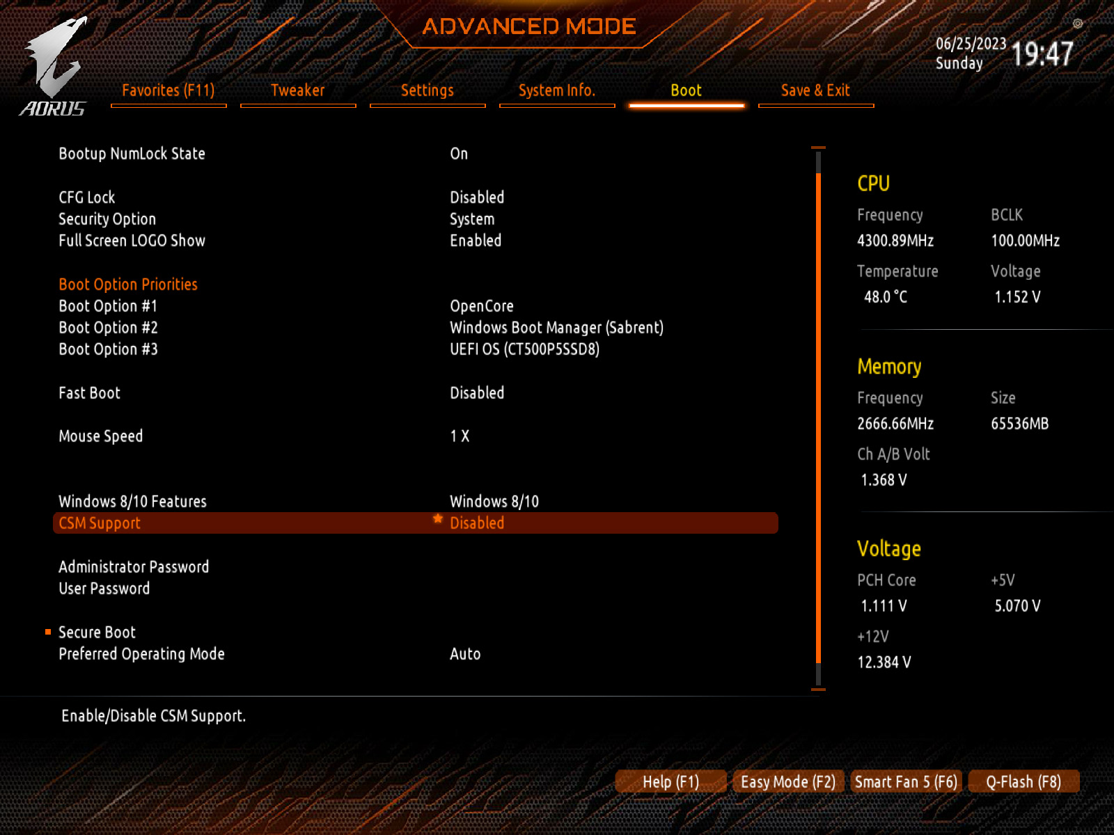

pkdesign Posted August 24, 2022 Share Posted August 24, 2022 I think I am missing something. I did the above steps (I think!) but I can not boot from the internal drive, only from my USB thumbdrive. You say "clean nvram," I am using the ResetNVRAM command on the USB drive. Is that right? Also you mention "name the drive OpenCore." Not sure how to do that. If i do not boot from my USB thumbdrive, none of my drives show up here: Link to comment Share on other sites More sharing options...
eSaF Posted August 24, 2022 Share Posted August 24, 2022 (edited) 1 hour ago, pkdesign said: If i do not boot from my USB thumbdrive, none of my drives show up here: Ok - I see no Drives in your pic, Try this: 1. Replace the BOOTx64.efi Folder to the EFI Folder containing the file. 2. Boot from your main Drive into the BIOS and in 'Boot Options Priorities' Opencore should be there also. 3. Choose Opencore as the Boot Drive, and remove any other apart from the Windows Drive save the settings and reboot. 4. At the Desktop mount your EFI Partition and remove the BOOTx64.efi and reboot the machine. 5. Without cleaning the Nvram let the machine continue to the Desktop. This is the method I did on mine. PS - See attached pics of my BIOS and EFI Folder Edited August 24, 2022 by eSaF Added Info: Link to comment Share on other sites More sharing options...

pkdesign Posted August 25, 2022 Share Posted August 25, 2022 22 hours ago, eSaF said: Ok - I see no Drives in your pic, Try this: Okay, that seemed to work. Hopefully it holds. If not, I know how to fix it again, thanks! 1 Link to comment Share on other sites More sharing options...
eSaF Posted August 25, 2022 Share Posted August 25, 2022 45 minutes ago, pkdesign said: Okay, that seemed to work. Hopefully it holds. If not, I know how to fix it again, thanks! No worries there, it will hold even when you clean Nvram but as you rightly said, it is easily fixed if it breaks. Just remember you do need the BOOTx64.efi Folder in the installer USB Drive always. 1 Link to comment Share on other sites More sharing options...
