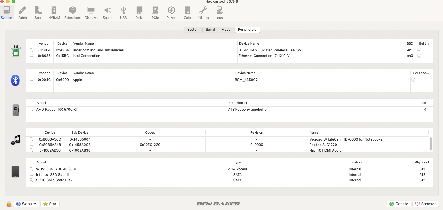

AslashA Posted August 18, 2022 Share Posted August 18, 2022 7 hours ago, eSaF said: Apart from my iPhone, the wife's iPhone, her AirPods and her Apple Watch, that's it. If that's is what you're referring to, if it is not please explain. No. I mean wiifi/bluetooth cards for the computer. For example bcm94360cs2, etc. Link to comment Share on other sites More sharing options...
eSaF Posted August 18, 2022 Share Posted August 18, 2022 4 hours ago, AslashA said: No. I mean wiifi/bluetooth cards for the computer. For example bcm94360cs2, etc. Ah ok I see, my WiFi/B-Tooth card is a Fenvi T-919 Combo card that works very well in all OS X versions. 1 Link to comment Share on other sites More sharing options...
