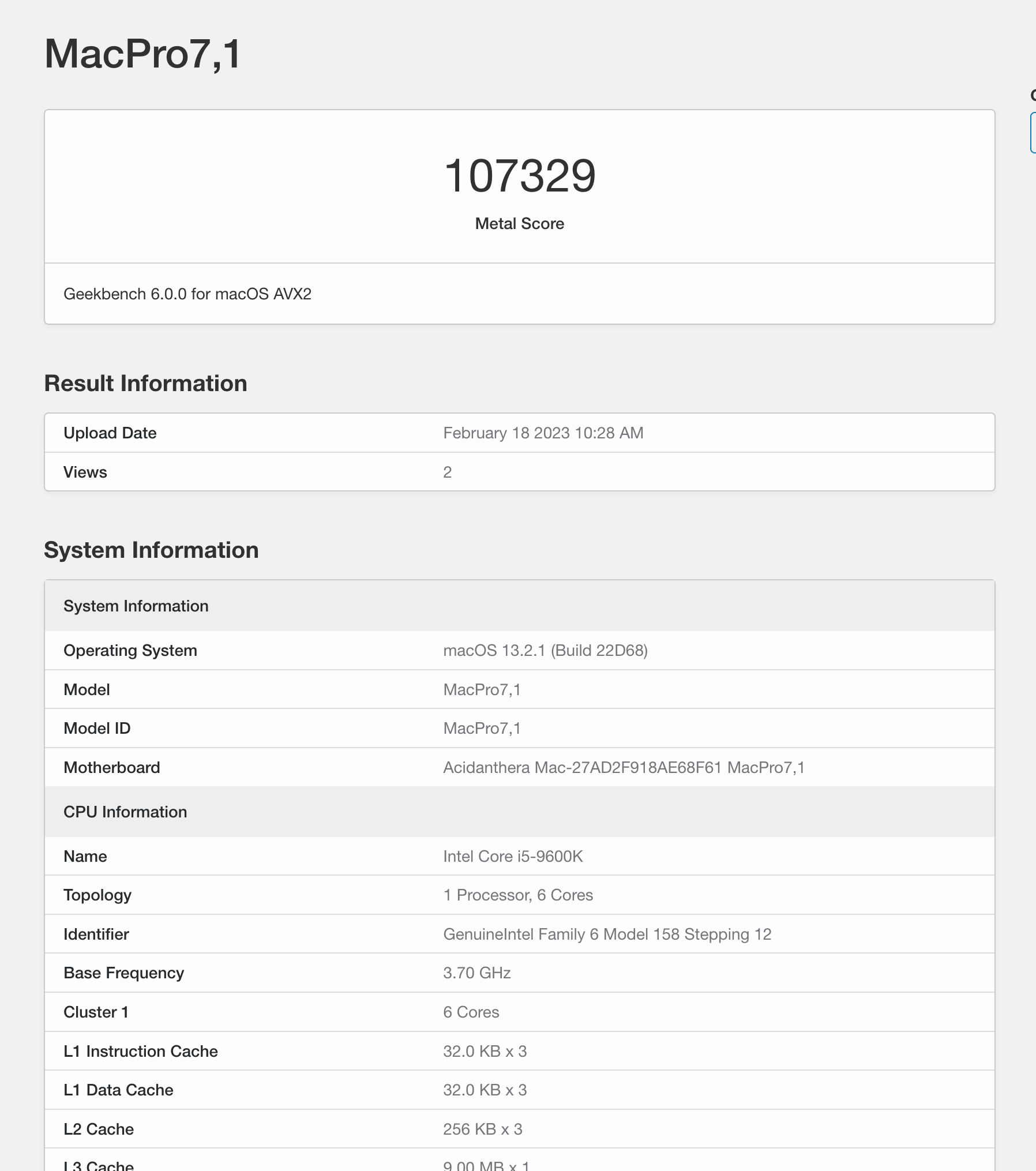

D3v1L Posted February 18, 2023 Share Posted February 18, 2023 8 minutes ago, panosru said: To my understanding, the PCIEX8 bandwidth is sufficient to cover the computation power that the GPU can provide. and this is the point. 👍 1 Link to comment https://www.insanelymac.com/forum/topic/339980-audiogods-aorus-z390-pro-patched-dsdt-mini-guide-and-discussion/page/210/#findComment-2801546 Share on other sites More sharing options...
panosru Posted February 18, 2023 Share Posted February 18, 2023 Btw, as correctly pointed by @D3v1L in our DMs, the bottleneck is not the CPU but the Motherboard. Also, for those interested, check this video, I think it explains a lot and in a detailed manner. Once I'll do one last physical test by removing the second GPU, I'll post the results. 1 Link to comment https://www.insanelymac.com/forum/topic/339980-audiogods-aorus-z390-pro-patched-dsdt-mini-guide-and-discussion/page/210/#findComment-2801549 Share on other sites More sharing options...

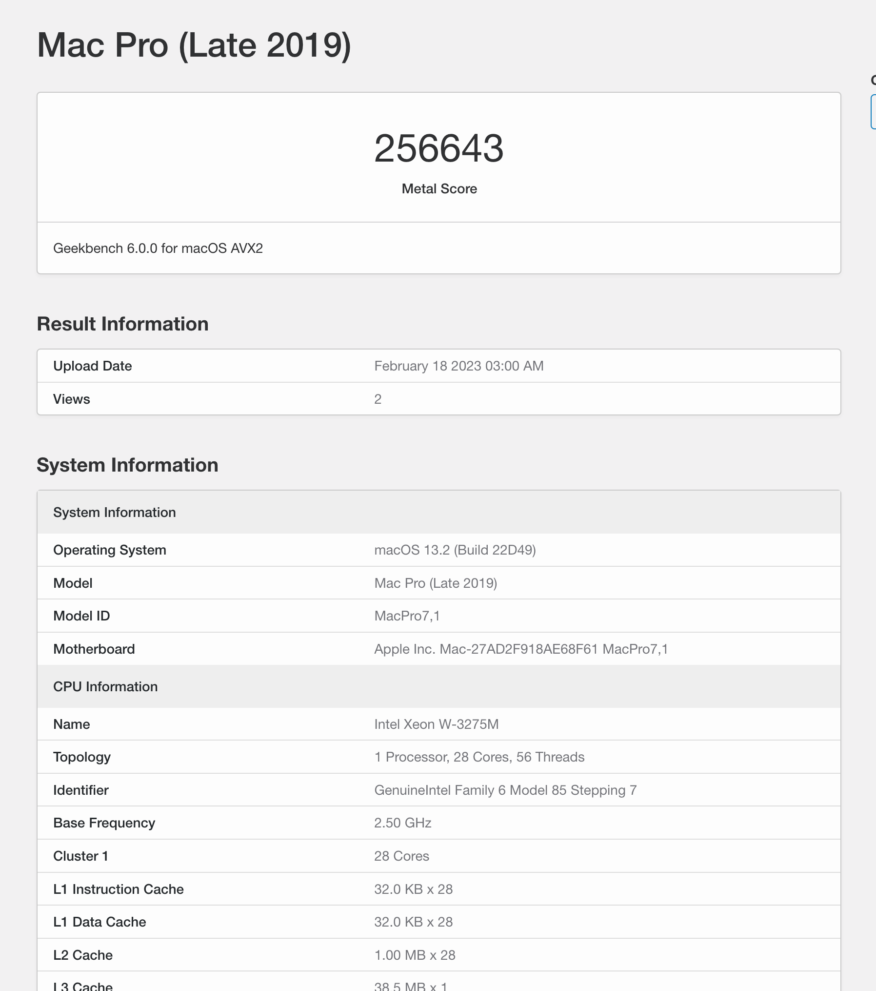

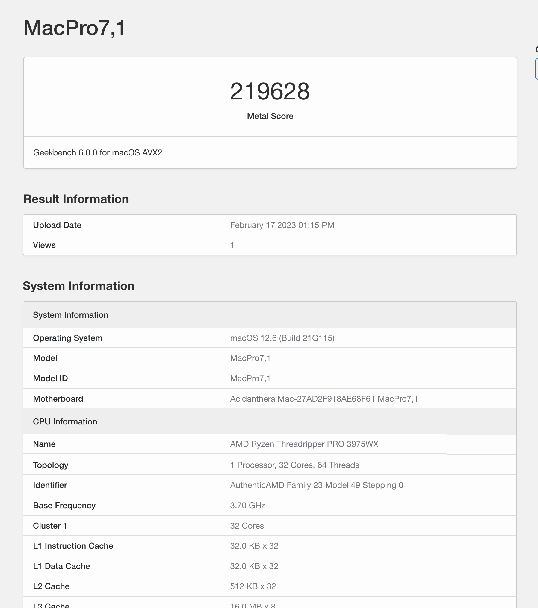

D3v1L Posted February 18, 2023 Share Posted February 18, 2023 Btw, i like Geek 6.0 ahahah but...well some differences... AMD RX6600XT XFX AMD RX6900XT Sapphire Nitro+ AMD W6800X DUO And now, is time to sell MP 😉 1 Link to comment https://www.insanelymac.com/forum/topic/339980-audiogods-aorus-z390-pro-patched-dsdt-mini-guide-and-discussion/page/210/#findComment-2801555 Share on other sites More sharing options...
panosru Posted February 18, 2023 Share Posted February 18, 2023 I just run the tests, so, the verdict is that it is indeed due-to different dual GPUs... I tried H.265 export with Main profile (not Main10) and it was 1.5m time (same as @D3v1L test). I tried it by having RX6600XT in PCIEX16 and then in PCIEX8, the time was the export time was the same, so x8 PCIe provide enough bandwidth for that GPU. When I have both cards in, then for H.265 I'm getting double the export time unfortunately. But, that only happens for H.265, H.264 renders fine. 1 Link to comment https://www.insanelymac.com/forum/topic/339980-audiogods-aorus-z390-pro-patched-dsdt-mini-guide-and-discussion/page/210/#findComment-2801563 Share on other sites More sharing options...
panosru Posted February 19, 2023 Share Posted February 19, 2023 (edited) To add one last piece of information on the topic, I tried using two GPUs on Windows, and the export time was consistently 1 minute and 15 seconds (~13% faster than on macOS). Adrenaline was installed, but I kept it with default settings. On macOS, the export time for H.265 on the same project is about 3 minutes, so I can rule out any possibility of hardware limitation. I still believe that it is worth getting a second GPU if you need many displays, but if you're happy with up to 4 displays, then just go with one powerful GPU. If I find a way to overcome this issue in macOS, I'll keep you all informed. For the time being, I have no clue where to look, though. This issue happens with H.265 only. For H.264, when I select RX6600XT in FCPX or DaVinci Resolve, I get half the export time compared to selecting RX580. But for H.265, it's like the selection is ignored. UPDATE: Based on info I found online (not from personal testing), I can neither confirm nor deny if the info is valid. FCPX will utilize BOTH GPUs only if they are the same model. If they mismatch, then only one of the two will be used. DaVinci Resolve and Adobe Premiere are able to use mismatched GPUs, but only if the OS supports it. Mismatched GPUs are not supported by macOS and Windows with DirectX up to v11. Since DirectX v12, you can use mismatched GPUs. When I have some time, I want to study this thread and see if I could get some performance boost by applying the suggested methods. If someone is familiar with this topic and has run some tests, feedback would be very helpful! Lastly, at some point, I might get a second RX 6600XT and conclude the testing. Frankly speaking, I don't need it, but what the heck, those tests provide good information for the Hackintosh community. Edited February 19, 2023 by panosru 1 Link to comment https://www.insanelymac.com/forum/topic/339980-audiogods-aorus-z390-pro-patched-dsdt-mini-guide-and-discussion/page/210/#findComment-2801594 Share on other sites More sharing options...

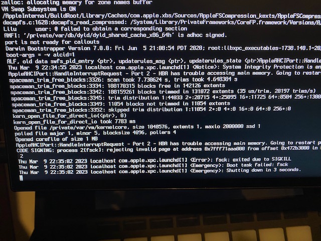

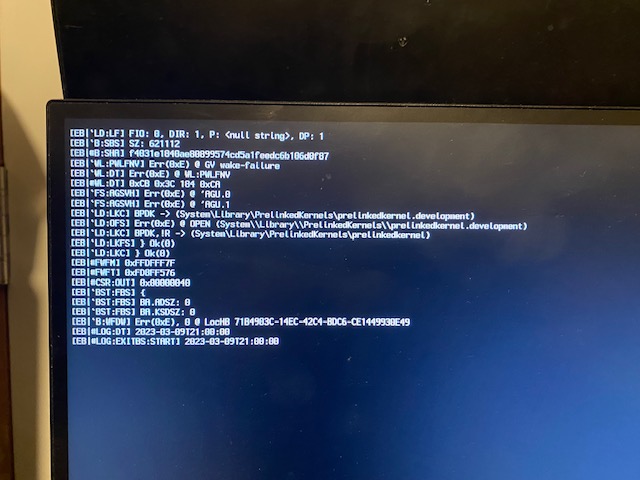

Olion Posted March 7, 2023 Share Posted March 7, 2023 (edited) Hello everyone, mac os Monterey 12.4 is installed now, works well. I downloaded OCAxollaryTools, ran the plist file for errors before update and trying to install Ventura 13.2.1 - doesn't work. After reboot, I see macOS Installer section at the start screen, which starts loading and then quickly restarts computer. How to upgrade system and where is error? Please help me) EFI Folder: EFI.zip UPD: Solved!) After few tryings update completed. Not actual now. Edited March 7, 2023 by Olion 1 Link to comment https://www.insanelymac.com/forum/topic/339980-audiogods-aorus-z390-pro-patched-dsdt-mini-guide-and-discussion/page/210/#findComment-2802114 Share on other sites More sharing options...
