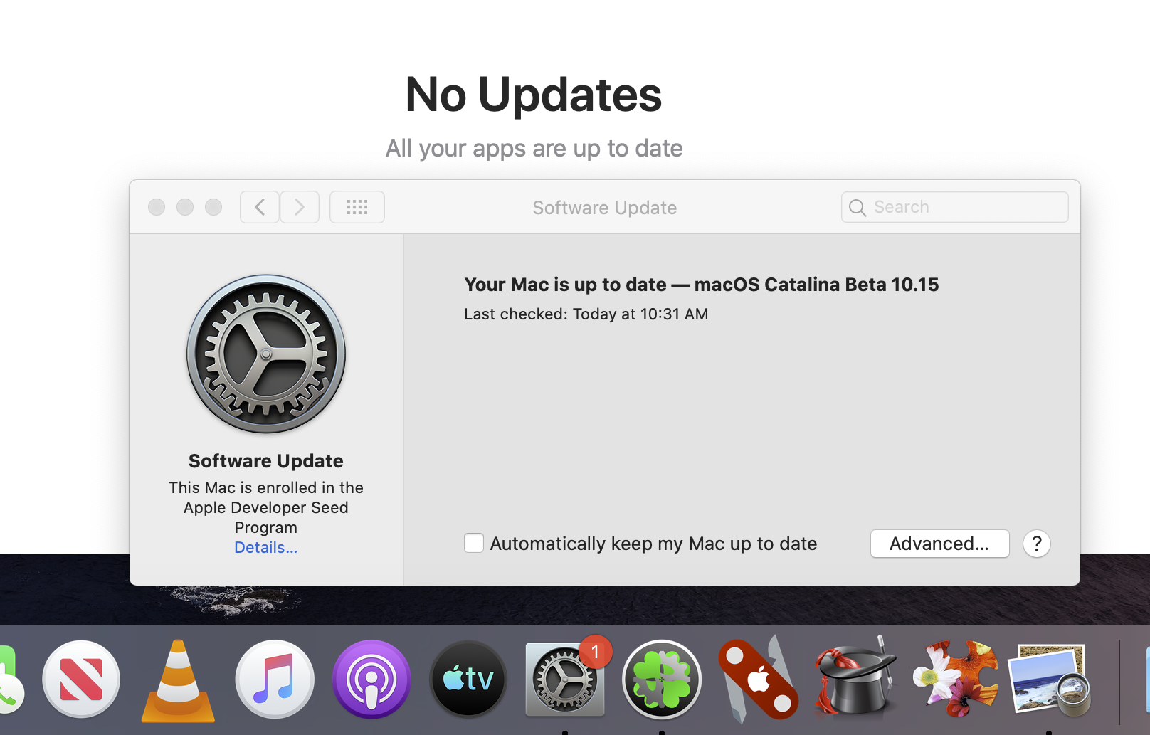

MjMac Posted June 27, 2019 Share Posted June 27, 2019 2 hours ago, mnfesq said: My System Preferences Dock icon has a notification badge. Usually, that means I have an update. But I don't. How can I tell what the badge is referring to? There are no badges on any of my System Preferences Icons when I open System Preferences. Is this a glitch? Is it unique to Catalina or does it happen in other versions of macOS as well? P.S. - killall Dock doesn't help. EDIT: This got rid of it: defaults write com.apple.systempreferences AttentionPrefBundleIDs 0 killall Dock defaults write com.apple.systempreferences AttentionPrefBundleIDs 1 killall Dock Thanks. Link to comment https://www.insanelymac.com/forum/topic/339035-pre-release-macos-catalina/page/33/#findComment-2679447 Share on other sites More sharing options...

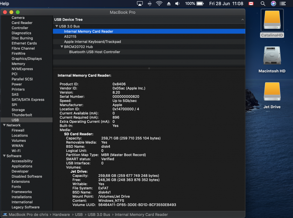

chris1111 Posted June 28, 2019 Share Posted June 28, 2019 (edited) For all those who have a problem of icon on the SD card reader and of course my real MacBook Pro retina this problem is not present, it puts me the same icon as the external drive I have a Jet Drive SD card Here the icon of SD Card from my Hackintosh Edited June 28, 2019 by chris1111 4 Link to comment https://www.insanelymac.com/forum/topic/339035-pre-release-macos-catalina/page/33/#findComment-2679529 Share on other sites More sharing options...

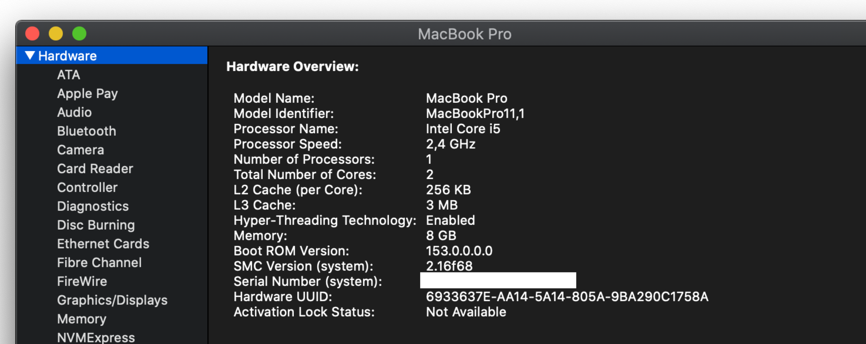

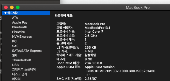

Sherlocks Posted June 29, 2019 Share Posted June 29, 2019 For all those who have a problem of icon on the SD card reader and of course my real MacBook Pro retina this problem is not present, it puts me the same icon as the external drive I have a Jet Drive SD card Here the icon of SD Card from my Hackintoshhi chrishow about system profiler?can you see "apple rom info" like clover smbios?i wonder this true in realmac나의 SM-N960N 의 Tapatalk에서 보냄 Link to comment https://www.insanelymac.com/forum/topic/339035-pre-release-macos-catalina/page/33/#findComment-2679591 Share on other sites More sharing options...

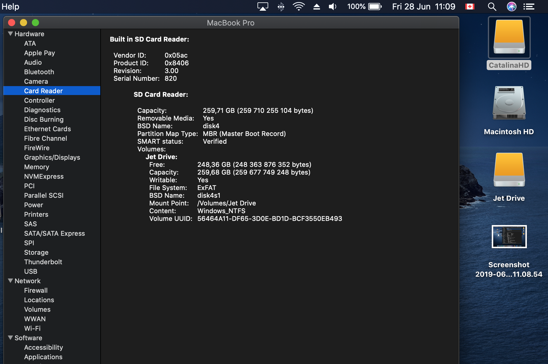

chris1111 Posted June 29, 2019 Share Posted June 29, 2019 1 hour ago, Sherlocks said: hi chris how about system profiler? can you see "apple rom info" like clover smbios? i wonder this true in realmac 나의 SM-N960N 의 Tapatalk에서 보냄 I don't know what you need exactly system profiler of the Hackintosh SD Card reader ? If this is what you need, the SD Card is not show in System profiler but its work and I am able to mount and unmount For the apple rom infos I don't know what you need ? 1 Link to comment https://www.insanelymac.com/forum/topic/339035-pre-release-macos-catalina/page/33/#findComment-2679593 Share on other sites More sharing options...

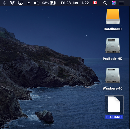

Guest ricoc90 Posted June 29, 2019 Share Posted June 29, 2019 On 6/28/2019 at 5:18 PM, chris1111 said: Here the icon of SD Card from my Hackintosh I have the same issue on my ProBook but the issue has been there in High Sierra and Mojave too Link to comment https://www.insanelymac.com/forum/topic/339035-pre-release-macos-catalina/page/33/#findComment-2679644 Share on other sites More sharing options...
Sherlocks Posted June 29, 2019 Share Posted June 29, 2019 13 hours ago, chris1111 said: I don't know what you need exactly system profiler of the Hackintosh SD Card reader ? If this is what you need, the SD Card is not show in System profiler but its work and I am able to mount and unmount For the apple rom infos I don't know what you need ? like this Apple ROM Version. BIOS ID: EFI info is there this parts in realmac? Link to comment https://www.insanelymac.com/forum/topic/339035-pre-release-macos-catalina/page/33/#findComment-2679647 Share on other sites More sharing options...

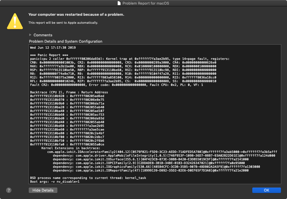

valeryimm Posted June 29, 2019 Share Posted June 29, 2019 Anybody can help with KP? I just did fresh install of Catalina b2. It boots in safe mode, but I get KP in normal mode. Can you look at KP Report and my new Clover folder? U used Rehabman's config.plist. My spec: Laptop HP Envy 15-as043cl CPU: Intel i7-6560U GPU: Intel Iris HD540, 4K ( 19260004 platform id in Mojave) panic(cpu 0 caller 0xffffff801907525a): Kernel trap at 0xffffff7f9b40c7eb, type 14=page fault, registers: CR0: 0x000000008001003b, CR2: 0x0000000000000008, CR3: 0x000000002de48000, CR4: 0x00000000003626e0 RAX: 0xffffff7f9b4838c8, RBX: 0x0000000000000000, RCX: 0x000000000000ffff, RDX: 0x0000000000000001 RSP: 0xffffff8208c9be40, RBP: 0xffffff8208c9be50, RSI: 0x0000000000000000, RDI: 0x0000000000000000 R8: 0x0000000000000001, R9: 0x0000000000000000, R10: 0x0000000000000000, R11: 0x0000000000000000 R12: 0x0000000000000000, R13: 0xffffff804dcc3eb0, R14: 0x0000000000000000, R15: 0x0000000000000000 RFL: 0x0000000000010246, RIP: 0xffffff7f9b40c7eb, CS: 0x0000000000000008, SS: 0x0000000000000010 Fault CR2: 0x0000000000000008, Error code: 0x0000000000000000, Fault CPU: 0x0, PL: 0, VF: 1 Backtrace (CPU 0), Frame : Return Address 0xffffff8208c9b8a0 : 0xffffff8018f4d46b mach_kernel : _handle_debugger_trap + 0x47b 0xffffff8208c9b8f0 : 0xffffff8019083225 mach_kernel : _kdp_i386_trap + 0x155 0xffffff8208c9b930 : 0xffffff8019074eab mach_kernel : _kernel_trap + 0x4fb 0xffffff8208c9b980 : 0xffffff8018ef3bb0 mach_kernel : _return_from_trap + 0xe0 0xffffff8208c9b9a0 : 0xffffff8018f4cb57 mach_kernel : _DebuggerTrapWithState + 0x17 0xffffff8208c9baa0 : 0xffffff8018f4cf36 mach_kernel : _panic_trap_to_debugger + 0x216 0xffffff8208c9baf0 : 0xffffff80196d21d9 mach_kernel : _panic + 0x61 0xffffff8208c9bb60 : 0xffffff801907525a mach_kernel : _sync_iss_to_iks + 0x2aa 0xffffff8208c9bce0 : 0xffffff8019074f5c mach_kernel : _kernel_trap + 0x5ac 0xffffff8208c9bd30 : 0xffffff8018ef3bb0 mach_kernel : _return_from_trap + 0xe0 0xffffff8208c9bd50 : 0xffffff7f9b40c7eb com.apple.iokit.IOAcceleratorFamily2 : __ZN24IOAccelResidentMemorySet4freeEv + 0x9 0xffffff8208c9be50 : 0xffffff7f9b445bb8 com.apple.iokit.IOAcceleratorFamily2 : __ZN22IOGraphicsAccelerator24freeEv + 0xb4 0xffffff8208c9be70 : 0xffffff801961e50d mach_kernel : __ZN9IOService15probeCandidatesEP12OSOrderedSet + 0xbed 0xffffff8208c9bef0 : 0xffffff801961d78e mach_kernel : __ZN9IOService14doServiceMatchEj + 0x2ce 0xffffff8208c9bf50 : 0xffffff801961fa5d mach_kernel : __ZN15_IOConfigThread4mainEPvi + 0x15d 0xffffff8208c9bfa0 : 0xffffff8018ef313e mach_kernel : _call_continuation + 0x2e Kernel Extensions in backtrace: com.apple.iokit.IOAcceleratorFamily2(438.1.9)[2B568783-1EA6-3C62-90F5-81BC794D8653]@0xffffff7f9b40b000->0xffffff7f9b4cdfff dependency: com.apple.driver.AppleMobileFileIntegrity(1.0.5)[D6E1FCDD-DE92-3645-8096-2A50D594335E]@0xffffff7f99a23000 dependency: com.apple.iokit.IOPCIFamily(2.9)[A9910C15-795F-33DB-9D91-807A41269356]@0xffffff7f99b76000 dependency: com.apple.iokit.IOSurface(269.2)[FB119609-4424-3540-9CC9-47FAA8B08810]@0xffffff7f9ace1000 dependency: com.apple.iokit.IOGraphicsFamily(557)[21B2E1AE-9952-3C62-B79A-F44C9D333EF4]@0xffffff7f9b3a3000 dependency: com.apple.iokit.IOReportFamily(47)[8A456F86-9DC7-3659-9690-DF50846852BA]@0xffffff7f99aaa000 BSD process name corresponding to current thread: kernel_task Boot args: dart=0 -cdfon -igfxnohdmi -v keepsyms=1 debug=0x100 Thanks CLOVER.zip KP.rtf Link to comment https://www.insanelymac.com/forum/topic/339035-pre-release-macos-catalina/page/33/#findComment-2679648 Share on other sites More sharing options...
chris1111 Posted June 29, 2019 Share Posted June 29, 2019 (edited) 31 minutes ago, Sherlocks said: like this Apple ROM Version. BIOS ID: EFI info is there this parts in realmac? Here 1 hour ago, ricoc90 said: I have the same issue on my ProBook but the issue has been there in High Sierra and Mojave too Issue is not there in Mojave and any other macOS Only in Catalina Edited June 29, 2019 by chris1111 2 Link to comment https://www.insanelymac.com/forum/topic/339035-pre-release-macos-catalina/page/33/#findComment-2679650 Share on other sites More sharing options...
Badruzeus Posted June 29, 2019 Share Posted June 29, 2019 (edited) 32 minutes ago, valeryimm said: Anybody can help with KP? I just did fresh install of Catalina b2. It boots in safe mode, but I get KP in normal mode. Kernel Extensions in backtrace: com.apple.iokit.IOAcceleratorFamily2(438.1.9)[2B568783-1EA6-3C62-90F5-81BC794D8653]@0xffffff7f9b40b000->0xffffff7f9b4cdfff Thanks Yeah, I got similar issue since Beta 2 but found no solution yet except replacing IOAcceleratorFamily2.kext from Beta 1. If you can not install it under Safe Mode, just place it to your Catalina root: Boot Single User, then: /sbin/mount -uw / cd /S*/L*/E* mv IOAcceleratorFamily2.kext IOAcceleratorFamily2.bak cp -rf /IOAcceleratorFaily2.kext /S*/L*/E* kextcache -system-prelinked-kernel reboot IOAcceleratorFamily2.kext.zip Edited June 29, 2019 by Badruzeus 2 Link to comment https://www.insanelymac.com/forum/topic/339035-pre-release-macos-catalina/page/33/#findComment-2679651 Share on other sites More sharing options...
valeryimm Posted June 29, 2019 Share Posted June 29, 2019 (edited) 2 hours ago, Badruzeus said: Yeah, I got similar issue since Beta 2 but found no solution yet except replacing IOAcceleratorFamily2.kext from Beta 1. If you can not install it under Safe Mode, just place it to your Catalina root: Boot Single User, then: /sbin/mount -uw / cd /S*/L*/E* mv IOAcceleratorFamily2.kext IOAcceleratorFamily2.bak cp -rf /IOAcceleratorFaily2.kext /S*/L*/E* kextcache -system-prelinked-kernel reboot IOAcceleratorFamily2.kext.zip Thank you, I also thought about replacing. Will try. Thank you, it helped. Edited June 29, 2019 by valeryimm 1 Link to comment https://www.insanelymac.com/forum/topic/339035-pre-release-macos-catalina/page/33/#findComment-2679657 Share on other sites More sharing options...
