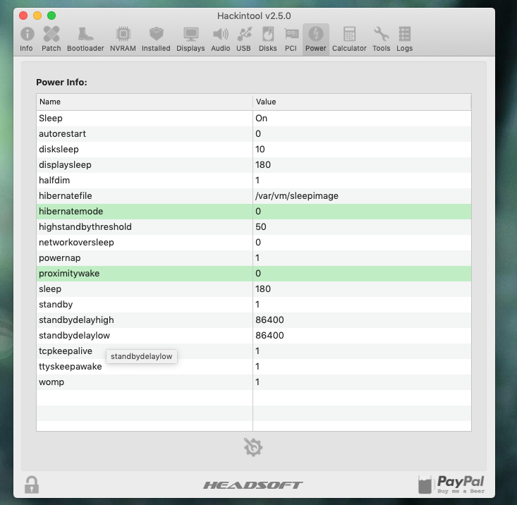

glasgood Posted May 15, 2019 Author Share Posted May 15, 2019 14 minutes ago, mfortuna said: But I don't have the "CORSAIR H100i V2 AIO CPU WATER COOLER" I'm just using the standard Intel cooler that came with my processor. I'll give it a shot anyways! UPDATE: Still not sleeping. Didn't tell you but to wake it up I can't use the power button because it doesn't do anything. Just by pressing any button of the keyboard and the screen turns on again Try EmuVariableUefi-64 and slide=0 boot args. 17 minutes ago, mfortuna said: But I don't have the "CORSAIR H100i V2 AIO CPU WATER COOLER" I'm just using the standard Intel cooler that came with my processor. I'll give it a shot anyways! UPDATE: Still not sleeping. Didn't tell you but to wake it up I can't use the power button because it doesn't do anything. Just by pressing any button of the keyboard and the screen turns on again Will have a look into this tomorrow, should be resolvable. Link to comment https://www.insanelymac.com/forum/topic/337837-glasgoods-macos-mojave-successguide-for-aorus-z390-pro/page/9/#findComment-2673760 Share on other sites More sharing options...
glasgood Posted May 15, 2019 Author Share Posted May 15, 2019 (edited) 35 minutes ago, mfortuna said: But I don't have the "CORSAIR H100i V2 AIO CPU WATER COOLER" I'm just using the standard Intel cooler that came with my processor. I'll give it a shot anyways! UPDATE: Still not sleeping. Didn't tell you but to wake it up I can't use the power button because it doesn't do anything. Just by pressing any button of the keyboard and the screen turns on again @mfortuna Test by changing BIOS setting below: • Chipset → Internal Graphics → Auto Can you run Hackintool and show me the output for Power Example from my Hackintosh below Edited May 15, 2019 by glasgood Link to comment https://www.insanelymac.com/forum/topic/337837-glasgoods-macos-mojave-successguide-for-aorus-z390-pro/page/9/#findComment-2673761 Share on other sites More sharing options...

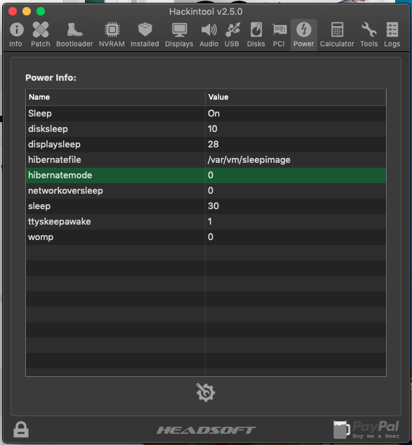

mfortuna Posted May 15, 2019 Share Posted May 15, 2019 (edited) 1 hour ago, glasgood said: @mfortuna Test by changing BIOS setting below: • Chipset → Internal Graphics → Auto Can you run Hackintool and show me the output for Power Example from my Hackintosh below I've left my computer for a while and it went to sleep by its own, everything correct...but if I go to the Apple menu to sleep manually it doesn't work . In a while I'll try what you say and post again! Thanks!! The "EmuVariableUefi-64" you mean the kext or a bootflag? slide=0 is already in your EFI Hackintool without changing anything yet: Edited May 15, 2019 by mfortuna Link to comment https://www.insanelymac.com/forum/topic/337837-glasgoods-macos-mojave-successguide-for-aorus-z390-pro/page/9/#findComment-2673770 Share on other sites More sharing options...

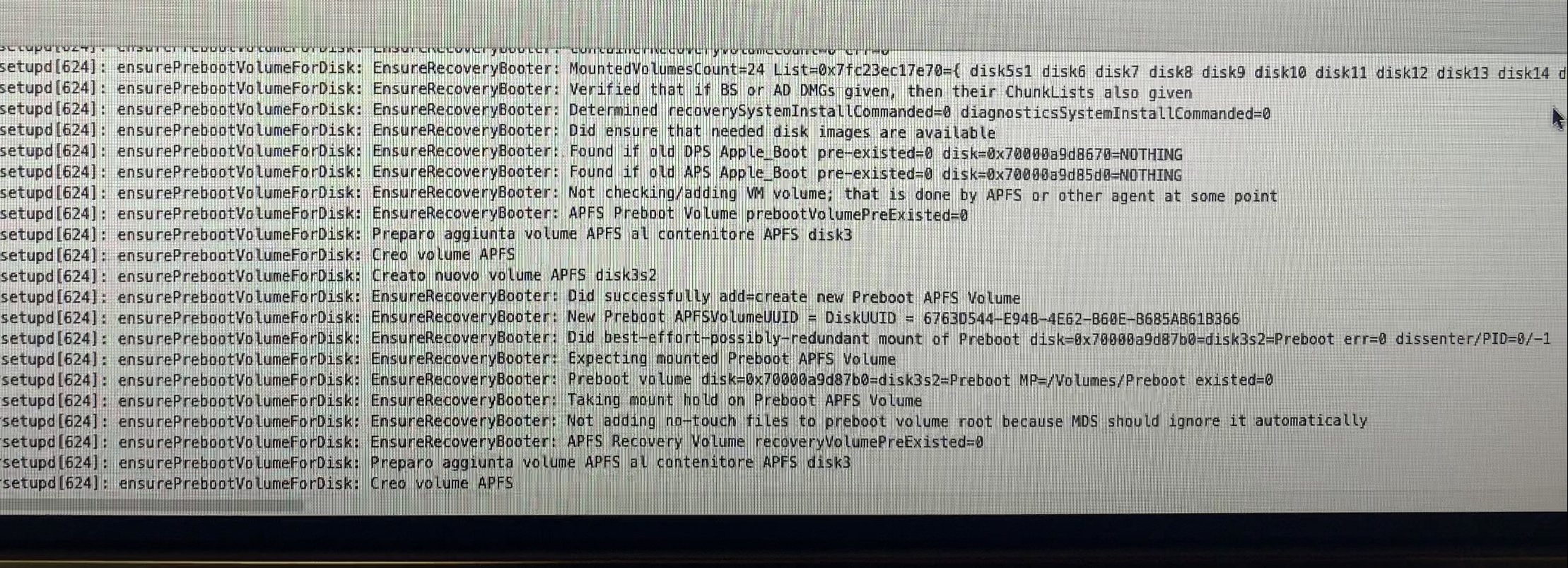

blackwalker Posted May 16, 2019 Share Posted May 16, 2019 Hi! Testing now with a new usb 2.0 cross fingher....! the mounted volumes high numbers make me think there is something else that is wrong... ho well, let’s see! Later Link to comment https://www.insanelymac.com/forum/topic/337837-glasgoods-macos-mojave-successguide-for-aorus-z390-pro/page/9/#findComment-2673815 Share on other sites More sharing options...

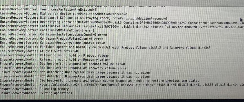

blackwalker Posted May 16, 2019 Share Posted May 16, 2019 (edited) Nothing.... no way! Say MountedVolumesCount = 24 many times during install.. then exit, dunno if this is the problem! Mid you see it create the APFS volume, then something go wrong, but I dunno what... i’m Lost now!! Edited May 16, 2019 by blackwalker Link to comment https://www.insanelymac.com/forum/topic/337837-glasgoods-macos-mojave-successguide-for-aorus-z390-pro/page/9/#findComment-2673821 Share on other sites More sharing options...

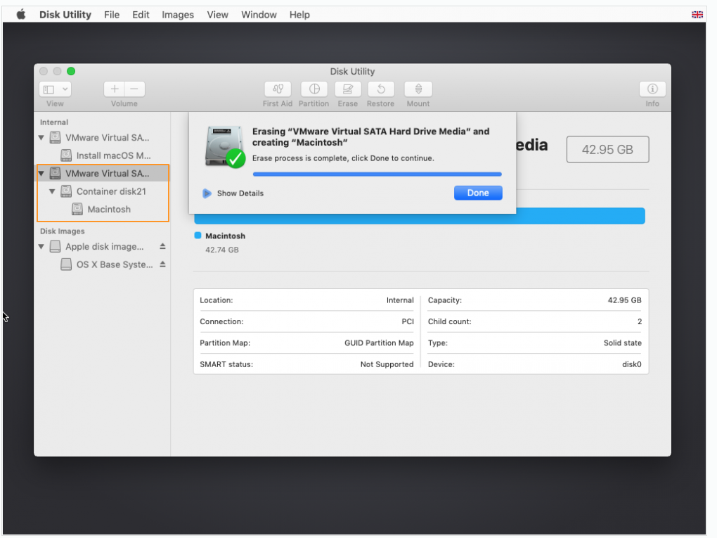

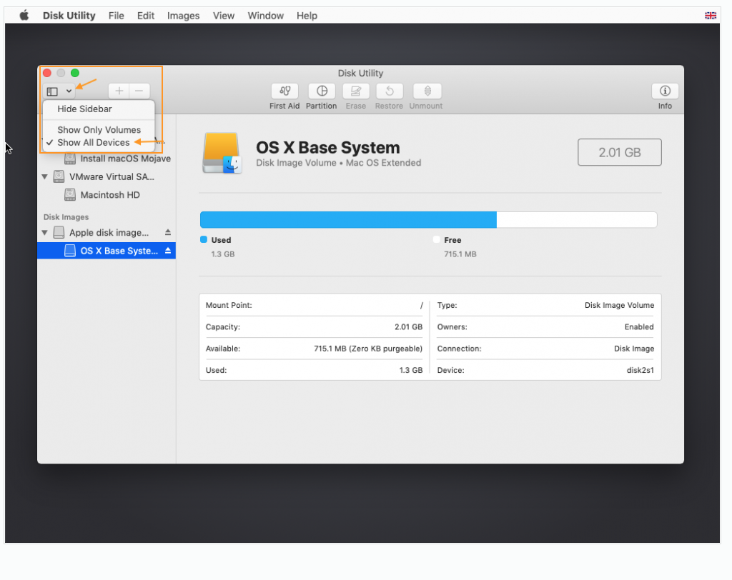

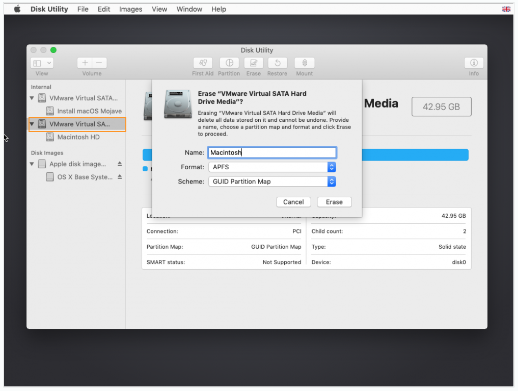

glasgood Posted May 16, 2019 Author Share Posted May 16, 2019 (edited) 50 minutes ago, blackwalker said: Nothing.... no way! Say MountedVolumesCount = 24 many times during install.. then exit, dunno if this is the problem! Mid you see it create the APFS volume, then something go wrong, but I dunno what... i’m Lost now!! @blackwalker I suspect that you do not have a problem with the installer, looks like you may have problem with the disk you are trying to install onto. Possibly the disk is not being reformatted properly. Try: 1 - Boot into Windows, and use "Windows Disk Managment" and reformat "ssd 500 gb samsung 860 evo drive" that you are attempting to install Mojave onto. 2 - Remove / disconnect " 2tb m2 970 samsung" and "2tb crucial " drives 3 - Connect "ssd 500 gb samsung 860 evo drive" to SATA port 0 4 - Boot from Mojave USB installer. 5 - Open Disk Utility Below you want to choose your "ssd 500 gb samsung 860 evo " If installation fails, then try another SSD / HDD drive. Edited May 16, 2019 by glasgood Link to comment https://www.insanelymac.com/forum/topic/337837-glasgoods-macos-mojave-successguide-for-aorus-z390-pro/page/9/#findComment-2673827 Share on other sites More sharing options...

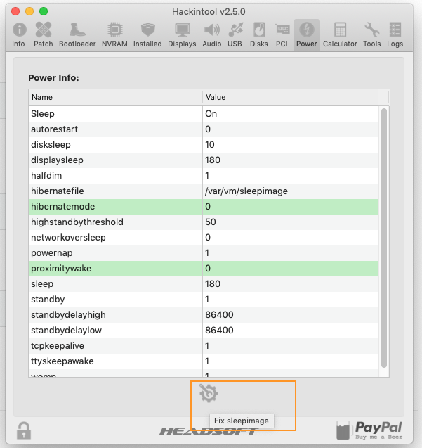

glasgood Posted May 16, 2019 Author Share Posted May 16, 2019 (edited) 13 hours ago, mfortuna said: @mfortuna First use Hackintool and attempt to fix sleep image: Shutdown and restart and then test sleep. If problem persists: Can you run the following command in terminal: Command to save sleepimage to RAM sudo pmset -a hibernatemode 0 Other alternatives: Command to save sleep image to Disk sudo pmset -a hibernatemode 1 Command to save sleep image to RAM and Disk sudo pmset -a hibernatemode 3 Edited May 16, 2019 by glasgood 1 Link to comment https://www.insanelymac.com/forum/topic/337837-glasgoods-macos-mojave-successguide-for-aorus-z390-pro/page/9/#findComment-2673828 Share on other sites More sharing options...
glasgood Posted May 16, 2019 Author Share Posted May 16, 2019 On 3/27/2019 at 4:34 PM, cla974 said: Hello everyone, I'm new to the forum and new to Mac OS. first of all congratulations for this comprehensive guide. I come to the point: I followed this guide step by step, but without the desired result. I can't even install mac os. everything crashes as soon as the white apple appears ...... I'm sure I created the bootable usb well with mojave v.10.14.4 (from mojave 10.14.2 on vmware) .... I kindly ask for your help hardware: gigabyte aorus z390 pro wifi intel core i7 8700k Sapphire Pulse Radeon RX 580 8gb 16gb corsair vengance lpx (2x8) SSD Samsung 970 Evo Plus M.2 500 GB (windows 10 pro) ssd samsung 840 pro 120gb (for mac os) I started also in verbose mode, I attach photos, if you need anything else, tell me. I repeat, I don't know mac os, please help me ..... maybe even with simple explanations ..... Thanks in advance Hi Try booting USB installer form other USB ports, try booting from from USB 2.0 port. Link to comment https://www.insanelymac.com/forum/topic/337837-glasgoods-macos-mojave-successguide-for-aorus-z390-pro/page/9/#findComment-2673829 Share on other sites More sharing options...
blackwalker Posted May 16, 2019 Share Posted May 16, 2019 1 hour ago, glasgood said: @blackwalker I suspect that you do not have a problem with the installer, looks like you may have problem with the disk you are trying to install onto. Possibly the disk is not being reformatted properly. Try: 1 - Boot into Windows, and use "Windows Disk Managment" and reformat "ssd 500 gb samsung 860 evo drive" that you are attempting to install Mojave onto. 2 - Remove / disconnect " 2tb m2 970 samsung" and "2tb crucial " drives 3 - Connect "ssd 500 gb samsung 860 evo drive" to SATA port 0 4 - Boot from Mojave USB installer. 5 - Open Disk Utility Below you want to choose your "ssd 500 gb samsung 860 evo " If installation fails, then try another SSD / HDD drive. Hi man I do exactly how you wrote yesterday, formatted like you show! Then tested with only 16gb memory and only ssd on sata 0, but get same error!! The only thing that is different is format the ssd with windows before! but the first time i used it was full working in windows... I think that maybe the disk have some problem.. I have another ssd, but I have to get it. i’ll try With it later Link to comment https://www.insanelymac.com/forum/topic/337837-glasgoods-macos-mojave-successguide-for-aorus-z390-pro/page/9/#findComment-2673831 Share on other sites More sharing options...
glasgood Posted May 16, 2019 Author Share Posted May 16, 2019 15 minutes ago, blackwalker said: Hi man I do exactly how you wrote yesterday, formatted like you show! Then tested with only 16gb memory and only ssd on sata 0, but get same error!! The only thing that is different is format the ssd with windows before! but the first time i used it was full working in windows... I think that maybe the disk have some problem.. I have another ssd, but I have to get it. i’ll try With it later Link to comment https://www.insanelymac.com/forum/topic/337837-glasgoods-macos-mojave-successguide-for-aorus-z390-pro/page/9/#findComment-2673834 Share on other sites More sharing options...

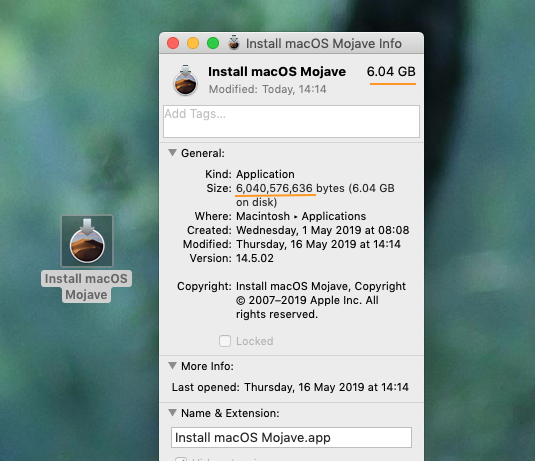

glasgood Posted May 16, 2019 Author Share Posted May 16, 2019 (edited) 17 minutes ago, blackwalker said: Same error..... i’m Out!! @blackwalker Looks like you have now ruled out hardware from causing installation to fail. You mention you created the installer using VM, did you download macOS Mojave from App Store ? My Hackintosh guide and EFI ( Clover version ) are confirmed working for macOS Mojave 10.14.4 and 10.14.5 ( Previous macOS Mojave versions such as 10.14.3 may cause problems with installation. I can not confirm the new, latest Clover version used in my PRE and POST install is working with older versions of Mojave and patches in config.plist ) Edited May 16, 2019 by glasgood Link to comment https://www.insanelymac.com/forum/topic/337837-glasgoods-macos-mojave-successguide-for-aorus-z390-pro/page/9/#findComment-2673852 Share on other sites More sharing options...
glasgood Posted May 16, 2019 Author Share Posted May 16, 2019 @blackwalker What size is your macOS Mojave Installer macOS Mojave 10.14.5 Link to comment https://www.insanelymac.com/forum/topic/337837-glasgoods-macos-mojave-successguide-for-aorus-z390-pro/page/9/#findComment-2673857 Share on other sites More sharing options...
