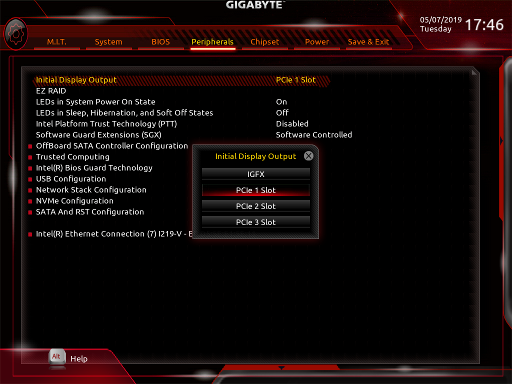

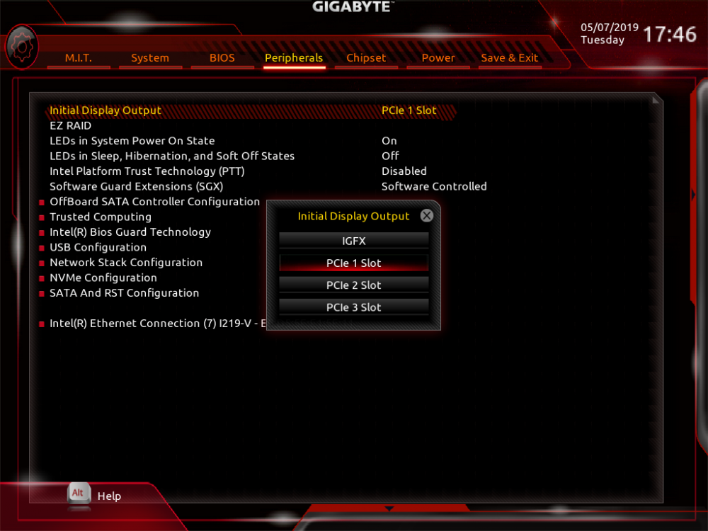

I try with new zip (copy and past and replace) screen plugged on RX 590 stay black after clover splashscreen.
I go to bios i change Initial Display Output  to IGFX.
a restart, with hdmi plugged on motherboard hackintosh boot after splashscreen clover, i put hdmi cable on RX590 screen work fine, i restart with hdmi plugged on rx590 i can't see clover splashscreen screen stay little bit black but hackintosh boot normally...  why with Initial Display Output on PCIe 1 Slot dont work ???
i change cable i use display port, now work on rx590 with Display Output on PCIe 1 Slot...  not possible to use HDMI on this mode ?
Hello @nelio33
I have not configured RX580 HDMI port for use, though HDMI on RX580/590 may work if you disable CSM in BIOS.

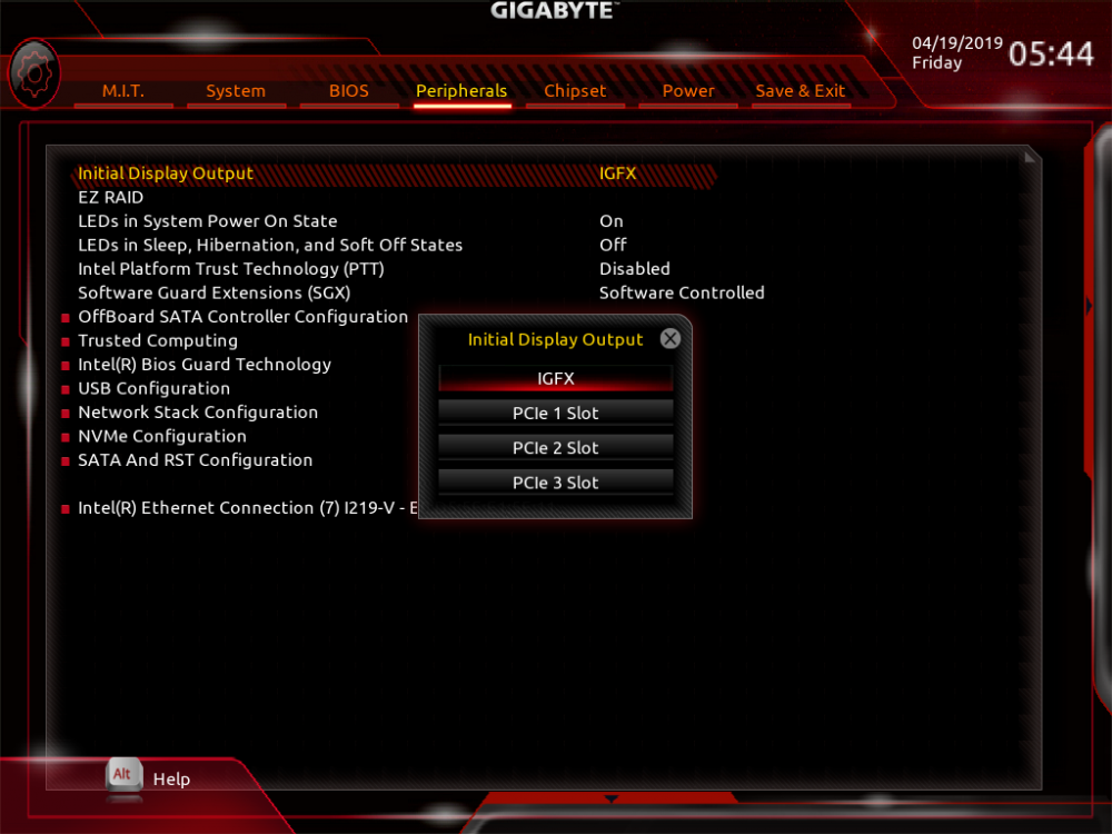

DisplayPort working when using my RX580/590,  HDMI on the Aorus Z390 motherboard is working. If using HDMI on Aorus Z390 motherboard you will need to change BIOS settings as per guide. :)

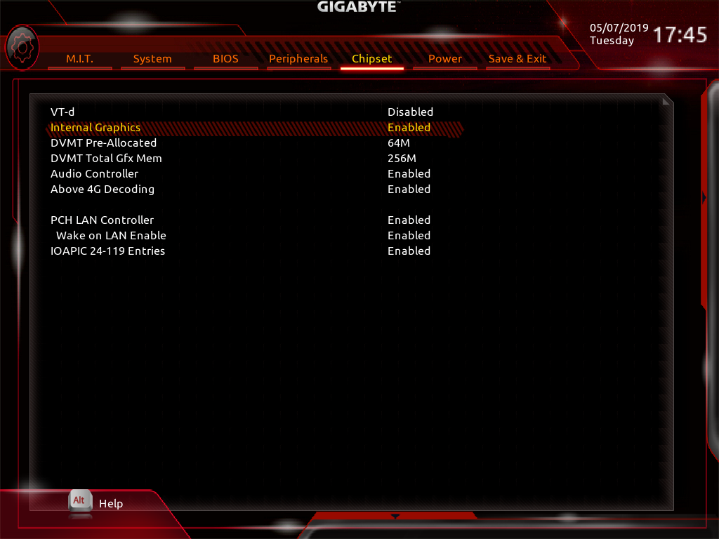

Ensure you have following BIOS setting:
If using DisplayPort on RX580 then use following BIOS setting:
BIOS setting for monitor connected to the Aorus Z390 Motherboard HDMI port:

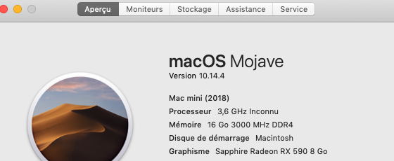

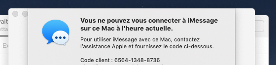

Hello Glasgood
i failed at step 8 imessage and facetime does not work for me. I redid the procedure several times.
when I type uuidgen in the terminal it changes sometimes
I have no iphone and no camera
I continue at step 9 and make some optional step, at PCI stand the processor is not recognized.
any idea ?
25 minutes ago, nelio33 said:
Hello Glasgood
any idea ?
@nelio33 Check that you have EMUVariableUefi-64.efi and OsxAptoFix2Drvfree2000.efi placed inside Clover / drivers64UEFI folder when trying to activate,  can you confirm if airdrop is working ?
send me your EFI folder. Your i9 9900K is not yet fully supported by macOS Mojave 10.14.4, possible support in 10.14.5. However you can fix unknown CPU see  ABOUT MY MAC in my other >>guide
I solve unknow cpu with your other guide, but directory is little different when using other lnguage i find file on fr folder

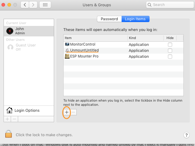

i have two ssd one mac other windows but when i boot on windows mac disk is unounted is ok ...but when i boot on mac  windows disk is auto mounted and named untiled by mac i eject it manually i dont find option to disable it.
I will stay on F5 like the master :)...
You can automatically unmount Untitled Windows Volume. Using Apple Script below:
tell application "Terminal"
    do shell script "d=\"/Volumes/Untitled\"; if [ -d \"$d\" ]; then diskutil eject $d; fi"
end tell
Compile and save as Application as UnmountUntitled
Then add UnmountUntitled Application to Login Items.
Then when you login to macOS the volume Untitled will automatically be unmounted.
Attached below is the created application :)
