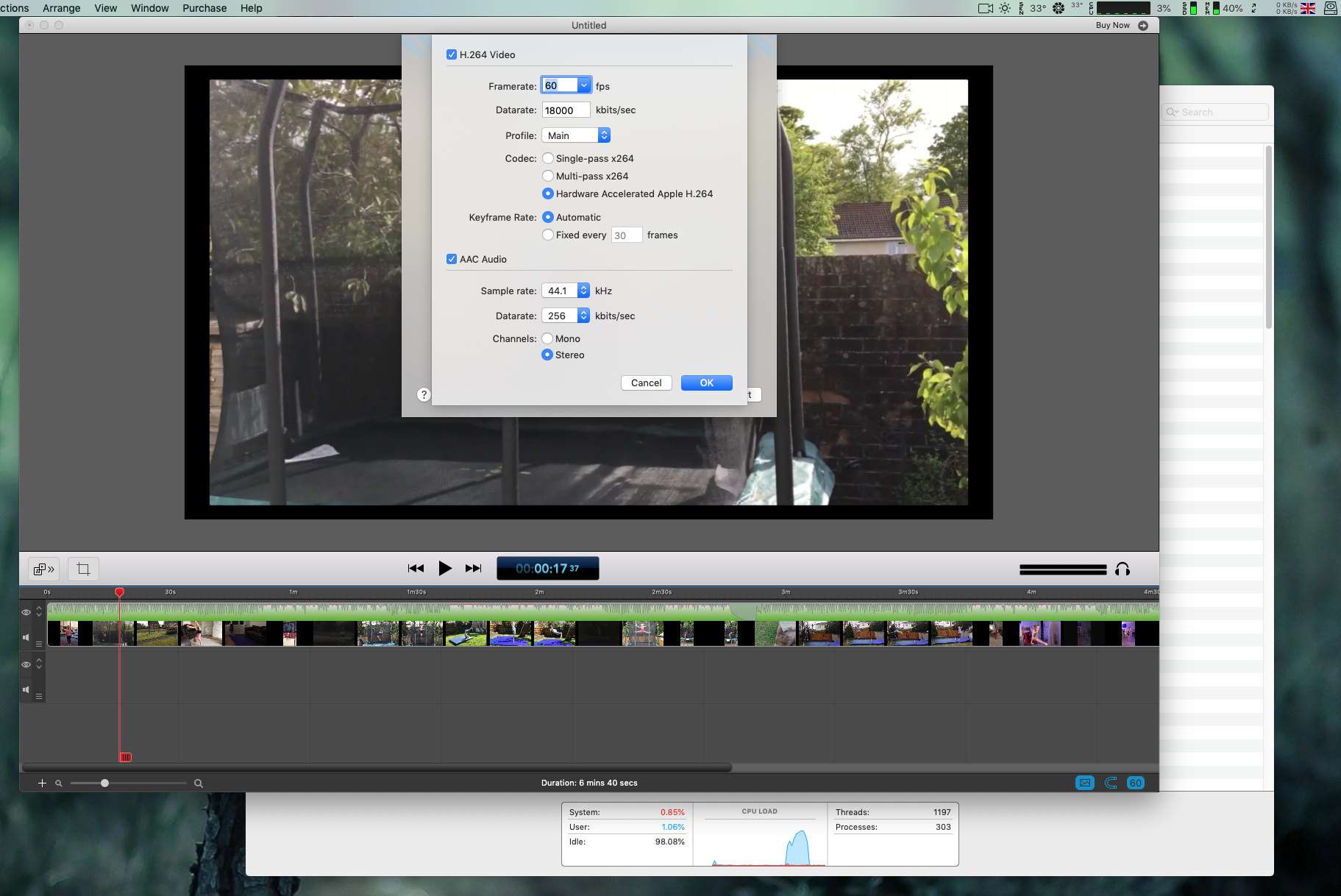

You should see both CPU and iGPU and dedicated GPU working. I can see the UHD turbo boost up to 1Ghz sometimes while rendering using FCPX.

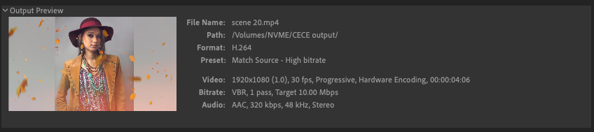

When using Adobe products, things are a bit different
Depending on what format you are using. I'm using a lot of H264 encoding videos, so I'd love to have hardware acceleration for those encoding task. This is the snapshot of my Adobe Media Encoder while it's running:
You can see the Hardware Encoding for H264 is running.

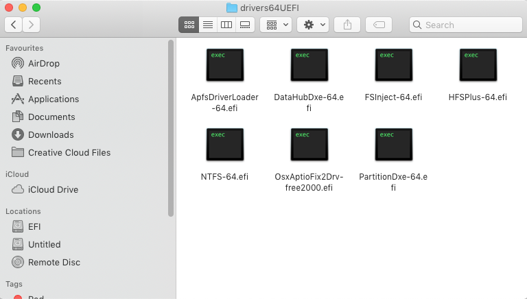

Successfully updated from macOS Mojave Version 10.14.4 to 10.14.
iMessages will need to be reactivated.

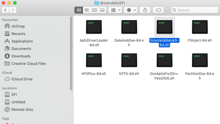

1) Mount EFI partition and place / copy and paste EmuVariableUefi-64.efi inside Clover/drivers64UEFI
Before
After
2) Restart Hackintosh

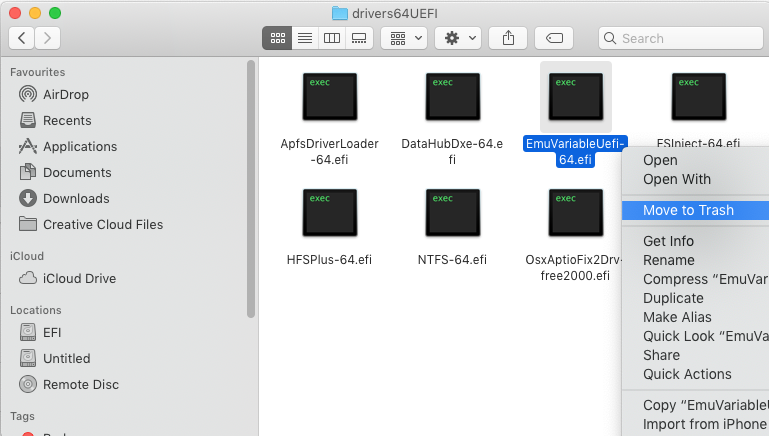

5) Delete EmuVariableUefi-64.efi  ( is only need to activate iMessages,  if you do not delete EmuVariableUefi-64.efi then you will have random memory allocation boot errors with Aorus Pro Z390 Hackintosh)
6) Done!

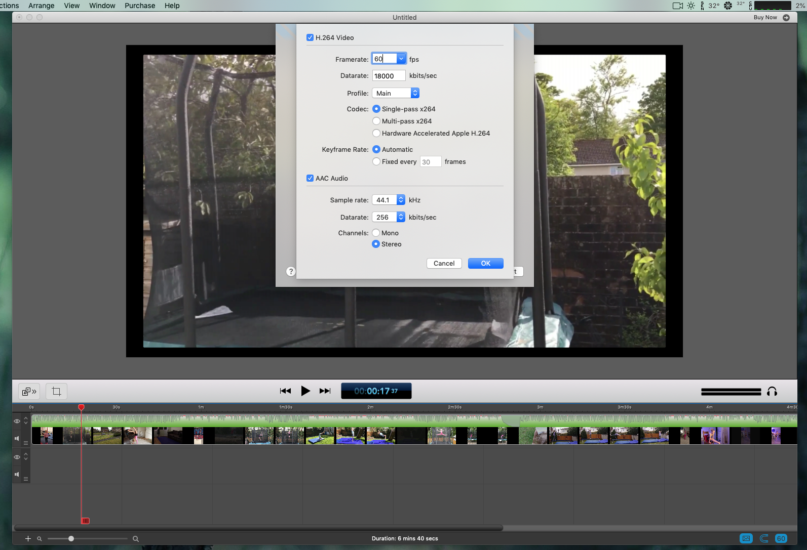

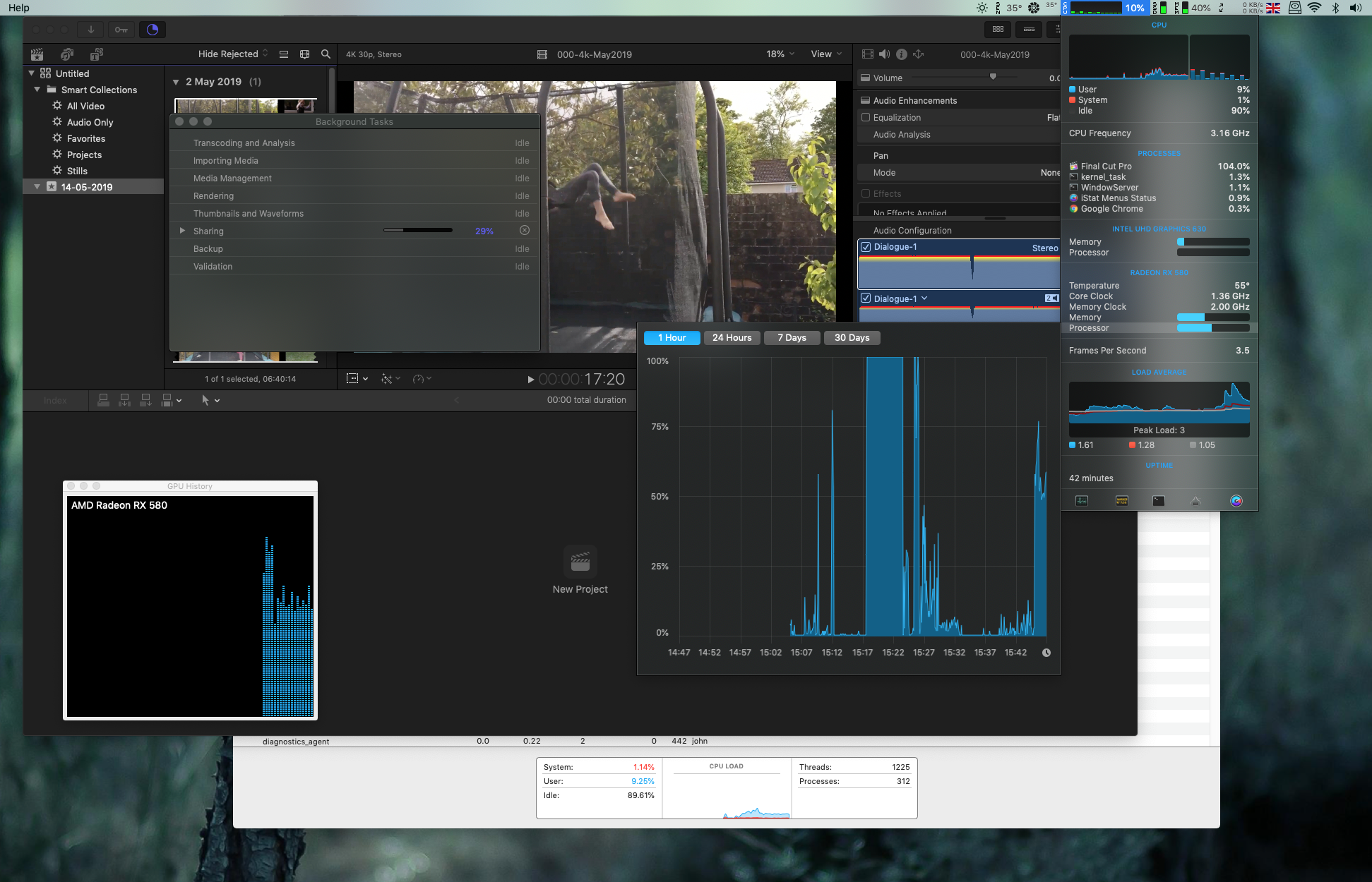

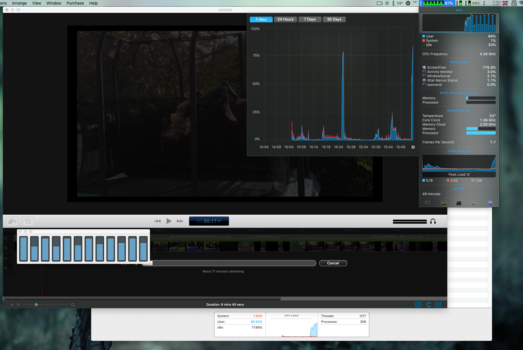

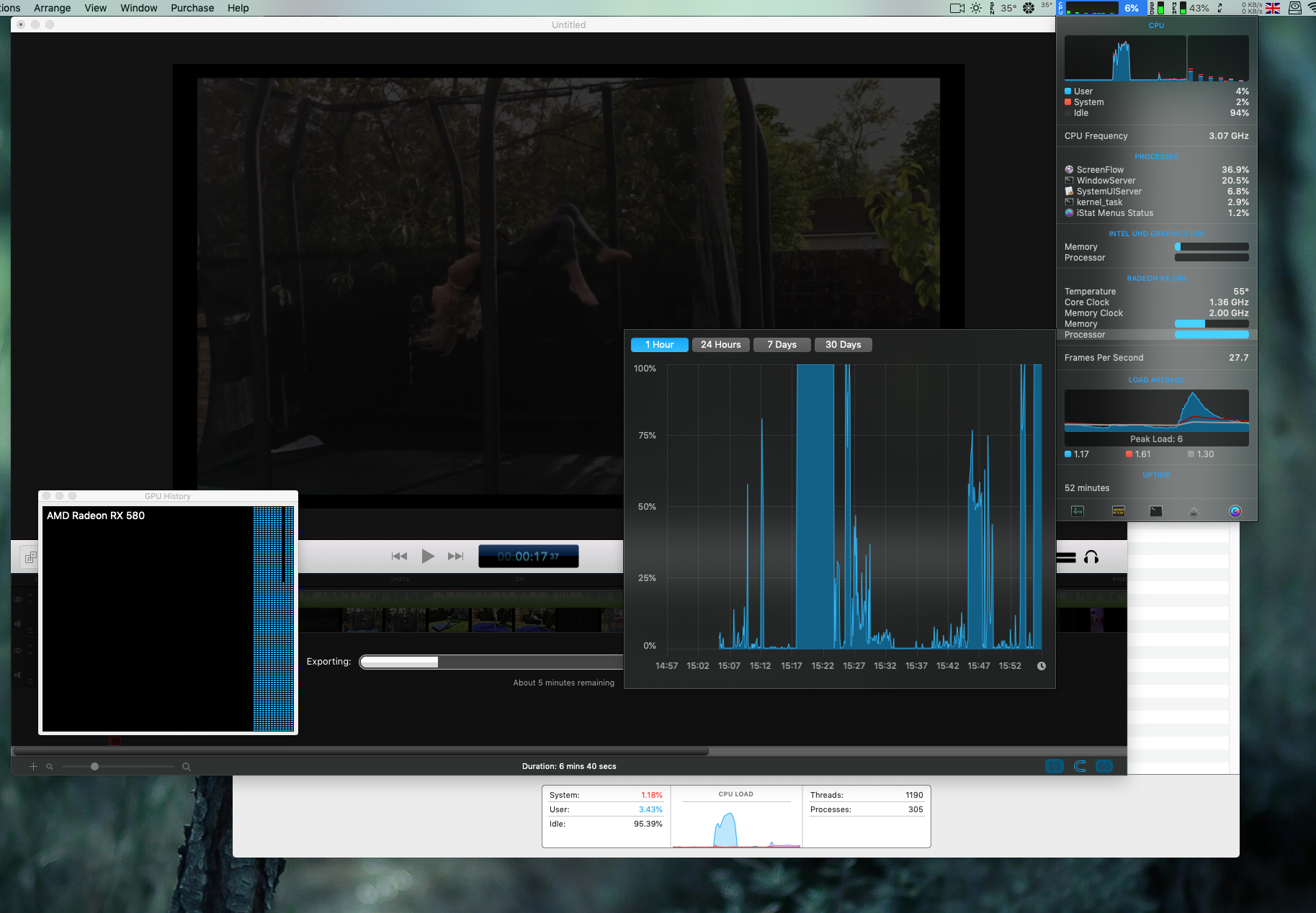

Looks like Final Cut Pro is fully working ( I'm not an expert audio/video producer) update  on this would be appreciated,  I have updated POST-INSTALL Aorus Pro Z390 EFI - RX580 now with SMBIOS imac 19,1. Also updated WhateverGreen.kext form 1.2.7 to  WhateverGreen.kext version 1.2.8
Final Cut Pro AMD RX 580
ScreenFlow Intel
ScreenFlow AMD RX 580
