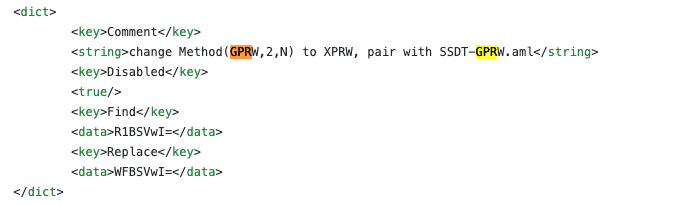

Hifi33 Posted April 17, 2019 Share Posted April 17, 2019 Followed the guide with very similar hardware, and it works just as I had hoped. I am having a sleep issue though unfortunately. (My firmware is v9 for the Z390 AORUS pro) I am wondering why the wake up occurs seconds after going to sleep. My suspicion is that it might be the USB connection of the h100i pro rgb that is cooling my 9700k keeping the computer awake. Perhaps I have my h100i USB wired to the wrong USB motherboard port or maybe the h100i aio be set to pwm in the bios instead of auto. I didn’t switch mine as stated in the guide as it wasn’t exactly the same model as in this build. Everything else works a treat though, thank you for the guide! Link to comment https://www.insanelymac.com/forum/topic/337837-glasgoods-macos-mojave-successguide-for-aorus-z390-pro/page/3/#findComment-2670503 Share on other sites More sharing options...

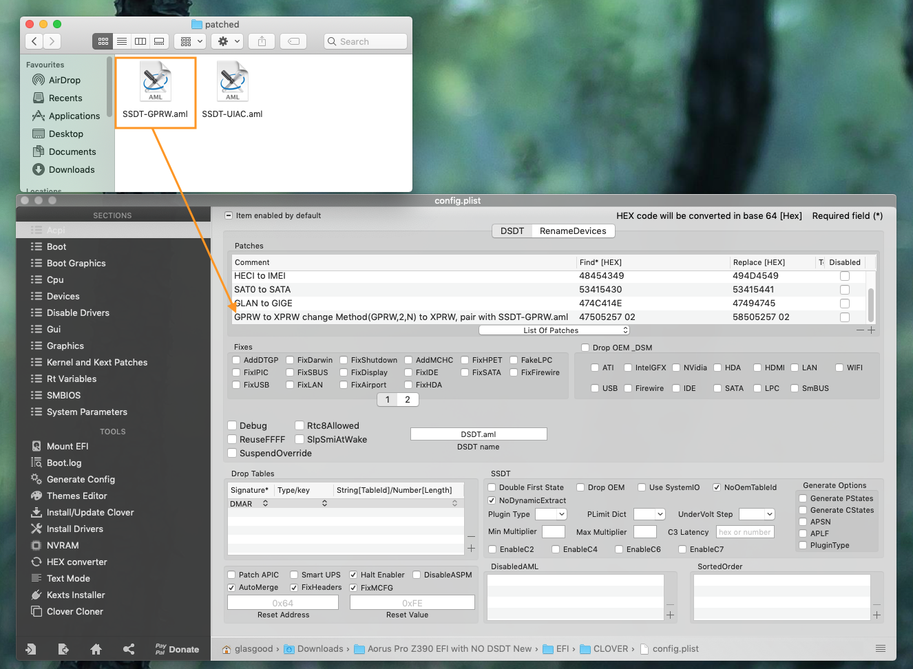

glasgood Posted April 17, 2019 Author Share Posted April 17, 2019 (edited) 3 hours ago, Hifi33 said: Followed the guide with very similar hardware, and it works just as I had hoped. I am having a sleep issue though unfortunately. (My firmware is v9 for the Z390 AORUS pro) I am wondering why the wake up occurs seconds after going to sleep. My suspicion is that it might be the USB connection of the h100i pro rgb that is cooling my 9700k keeping the computer awake. Perhaps I have my h100i USB wired to the wrong USB motherboard port or maybe the h100i aio be set to pwm in the bios instead of auto. I didn’t switch mine as stated in the guide as it wasn’t exactly the same model as in this build. Everything else works a treat though, thank you for the guide! Hi, sorted this yesterday by using Rehabman's SSDT-GPRW, find and replace hotpatch to avoid instant wake. Works by replacing _PRW method for all devices in ACPI. It is now implemented in the latest >> Aorus Pro Z390 EFI with NO DSDT New.zip . (resume from sleep by pressing the power button. ) Go with PWM in BIOS for h100i, and attach h100i USB header to F_USB1 (HS11) Rehabman's hot-patching fix below for instant wake, as I already mentioned it is already implemented in Aorus Pro Z390 EFI. Thanks Edited April 17, 2019 by glasgood 2 Link to comment https://www.insanelymac.com/forum/topic/337837-glasgoods-macos-mojave-successguide-for-aorus-z390-pro/page/3/#findComment-2670529 Share on other sites More sharing options...
Neek Posted April 18, 2019 Share Posted April 18, 2019 16 hours ago, glasgood said: Hi, sorted this yesterday by using Rehabman's SSDT-GPRW, find and replace hotpatch to avoid instant wake. Awesome! This fixed instant wake for me. I've been struggling with that for a while. Thank you for all your work on this guide. It's been very helpful in my Hackintosh learning. 1 Link to comment https://www.insanelymac.com/forum/topic/337837-glasgoods-macos-mojave-successguide-for-aorus-z390-pro/page/3/#findComment-2670587 Share on other sites More sharing options...
Hifi33 Posted April 18, 2019 Share Posted April 18, 2019 My issue has been fixed, sleep without an instant wake. Many thanks for the help resolving this to glasgood and MaLd0n. Originally, I was a bit concerned if everything would work out, selling my old cMP, buying parts, building my first pc, and installing the OS, but I jumped in with both feet and glad I did! My hat's off to you. Once my PCIe wifi/bluetooth adapter arrives this build will be complete. 1 Link to comment https://www.insanelymac.com/forum/topic/337837-glasgoods-macos-mojave-successguide-for-aorus-z390-pro/page/3/#findComment-2670627 Share on other sites More sharing options...
glasgood Posted April 18, 2019 Author Share Posted April 18, 2019 14 minutes ago, Hifi33 said: My issue has been fixed, sleep without an instant wake. Many thanks for the help resolving this to glasgood and MaLd0n. Originally, I was a bit concerned if everything would work out, selling my old cMP, buying parts, building my first pc, and installing the OS, but I jumped in with both feet and glad I did! My hat's off to you. Once my PCIe wifi/bluetooth adapter arrives this build will be complete. Just updated Aorus Z390 EFI no DSDT guide with Framebuffer patch. So working HDMI port and HDMI audio. 1 Link to comment https://www.insanelymac.com/forum/topic/337837-glasgoods-macos-mojave-successguide-for-aorus-z390-pro/page/3/#findComment-2670628 Share on other sites More sharing options...
ppohio Posted April 19, 2019 Share Posted April 19, 2019 Hey! I am using pretty much the same hardware, and my system is running well except for a few nagging issues (hanging on reboot, color static when bringing my main display back from sleep). I was looking over your config.plist and was hoping you could explain why you fill out all the information in the DEVICES->Arbitrary section. I haven't seen that before and was curious what it does/ if it is necessary. And if I have the same motherboard, can I populate the same values? Thanks for all the thorough work on the guide, these are so useful for not only getting systems up and running but actually understanding how things work underneath the hood. Link to comment https://www.insanelymac.com/forum/topic/337837-glasgoods-macos-mojave-successguide-for-aorus-z390-pro/page/3/#findComment-2670714 Share on other sites More sharing options...
glasgood Posted April 19, 2019 Author Share Posted April 19, 2019 (edited) 15 hours ago, ppohio said: I was looking over your config.plist and was hoping you could explain why you fill out all the information in the DEVICES->Arbitrary section. I haven't seen that before and was curious what it does/ if it is necessary. And if I have the same motherboard, can I populate the same values? If you have same motherboard you should be able to use most of the values, see updated guide for more information. OPTIONAL: System Information - PCI Best! Edited April 20, 2019 by glasgood Reply formatted and placed in guide. 1 Link to comment https://www.insanelymac.com/forum/topic/337837-glasgoods-macos-mojave-successguide-for-aorus-z390-pro/page/3/#findComment-2670719 Share on other sites More sharing options...

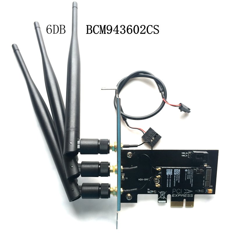

Hifi33 Posted April 21, 2019 Share Posted April 21, 2019 Final part arrived for my build. Received the Broadcom BCM94360CD wifi/bluetooth (4 antennae version) and installed the card on PCIEX1_3 and wired to the Front panel USB header F_USB2 on the Z390 Aorus Pro board, and so far, so good with bluetooth on this setup. Handoff, Airdrop, Personal Hotspot is all connecting. Very painless. Paired a genuine wireless keyboard easily. Adjusted the System Information - PCI and this card is displayed properly in system information. Sleep working. One little issue regarding Wifi where although the connection *I think* is pretty solid, (Wireless 802.11ac the Tx rate is around 468mbps, rssi: -61dBm noise: -78 dBm, mcs: 5 two rooms over.) the traffic slows to a crawl on my gigabit internet connection. While still showing full bars on the wifi icon. Not a huge deal as I will likely be on wired ethernet once I move my setup back into the office. Link to comment https://www.insanelymac.com/forum/topic/337837-glasgoods-macos-mojave-successguide-for-aorus-z390-pro/page/3/#findComment-2670866 Share on other sites More sharing options...
glasgood Posted April 21, 2019 Author Share Posted April 21, 2019 17 minutes ago, Hifi33 said: Final part arrived for my build. Received the Broadcom BCM94360CD wifi/bluetooth (4 antennae version) and installed the card on PCIEX1_3 and wired to the Front panel USB header F_USB2 on the Z390 Aorus Pro board, and so far, so good with bluetooth on this setup. Handoff, Airdrop, Personal Hotspot is all connecting. Very painless. Paired a genuine wireless keyboard easily. Adjusted the System Information - PCI and this card is displayed properly in system information. Sleep working. One little issue regarding Wifi where although the connection *I think* is pretty solid, (Wireless 802.11ac the Tx rate is around 468mbps, rssi: -61dBm noise: -78 dBm, mcs: 5 two rooms over.) the traffic slows to a crawl on my gigabit internet connection. While still showing full bars on the wifi icon. Not a huge deal as I will likely be on wired ethernet once I move my setup back into the office. Try temporary removing the network entries from System Information PCI and see if it persist, Good to know everything else is satisfactory! Will look into this soon. 1 Link to comment https://www.insanelymac.com/forum/topic/337837-glasgoods-macos-mojave-successguide-for-aorus-z390-pro/page/3/#findComment-2670870 Share on other sites More sharing options...

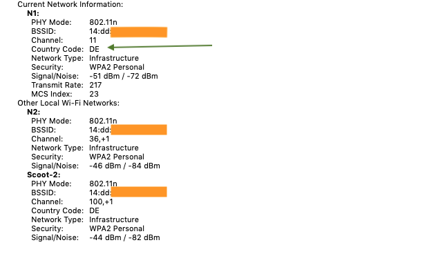

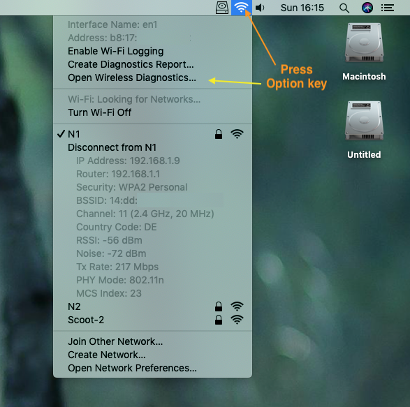

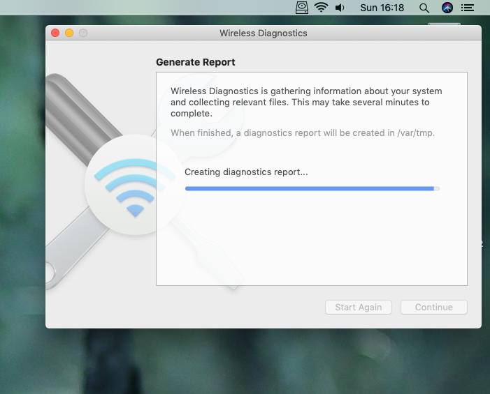

Hifi33 Posted April 21, 2019 Share Posted April 21, 2019 (edited) 2 hours ago, glasgood said: Try temporary removing the network entries from System Information PCI and see if it persist, Good to know everything else is satisfactory! Will look into this soon. Thanks, that works a lot better! My speedtest went from 3-5mbps up and down to 130mbps down/180mbps up on 5Ghz. No longer applicable, fixed itself..(*Just noticed in the sys info pane under Network : Wifi : interfaces, the country code shows X0. Not sure if that effects anything, but I think it should be CA for my locale.*) Edited April 21, 2019 by Hifi33 X0 changed back to CA when I logged back in, no issue there. Link to comment https://www.insanelymac.com/forum/topic/337837-glasgoods-macos-mojave-successguide-for-aorus-z390-pro/page/3/#findComment-2670885 Share on other sites More sharing options...
glasgood Posted April 21, 2019 Author Share Posted April 21, 2019 (edited) 1 hour ago, Hifi33 said: Thanks, that works a lot better! My speedtest went from 3-5mbps up and down to 130mbps down/180mbps up on 5Ghz. No longer applicable, fixed itself..(*Just noticed in the sys info pane under Network : Wifi : interfaces, the country code shows X0. Not sure if that effects anything, but I think it should be CA for my locale.*) I looked at my System Infomation Wifi and my Country Code is shown as DE, but this is supposedly normal and is assigned by Router ( AFAIK ) the DE ( Germany location ) is associated with EU regulation. I did run the Apple Wireless Diagnostics, holding option key down and clicking on WiFi signal. To view log's: open . /var/tmp/ No report for "Conflicting Country Codes" . Saul goodman Glad you are sorted, thanks for the update Edited April 21, 2019 by glasgood Link to comment https://www.insanelymac.com/forum/topic/337837-glasgoods-macos-mojave-successguide-for-aorus-z390-pro/page/3/#findComment-2670893 Share on other sites More sharing options...
glasgood Posted April 21, 2019 Author Share Posted April 21, 2019 4 hours ago, Hifi33 said: No longer applicable, fixed itself..(*Just noticed in the sys info pane under Network : Wifi : interfaces, the country code shows X0. Not sure if that effects anything, but I think it should be CA for my locale.*) Hi, I got two hard drives for my machine, one for testing. I noticed that Country Code was set US on the test drive, as far as I was aware it should be GB or DE. As far as I know, AirportBrcmFixup.kext for my Wi-Fi card defaults to US, so I found the way to change country code. I updated guide with instructions on this. OPTIONAL: Set Wi-Fi Country Code Link to comment https://www.insanelymac.com/forum/topic/337837-glasgoods-macos-mojave-successguide-for-aorus-z390-pro/page/3/#findComment-2670912 Share on other sites More sharing options...

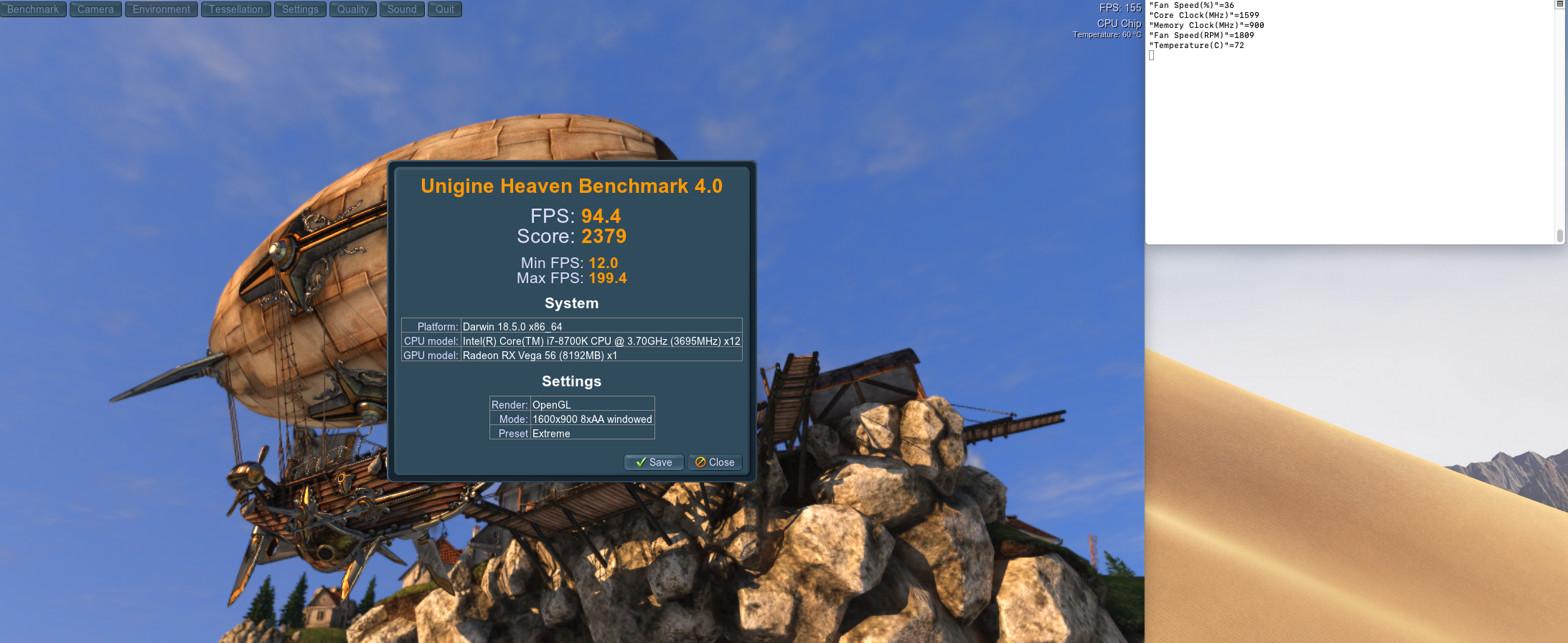

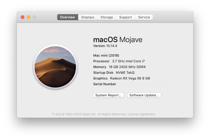

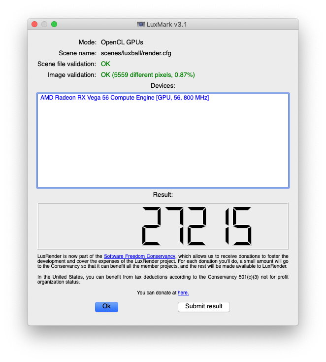

larabee Posted April 21, 2019 Share Posted April 21, 2019 Amazing guide. Thank you so much for this fool-proof guide. After getting a real Mac (iMac 2017) to use for a while, I finally want to get back to Hackintosh world and here it is. perfectly working Hackintosh with full hardware acceleration and everything works as it should. My Config: Gigabyte Z390 Gaming X Intel Core i7 8700K Sapphire Pulse Vega 56 NVMe SSDs I've used the VGTab to adjust the fan curve and voltage of the Vega 56 (the kext is attached in this post) then use clover to include the soft power table to the config.plist. My Max voltage is set at 1050mv (under voting by 150mv from default) Ran Unigine for 4 hours and the max temperature is at my target 73C. The fan is barely audible at under 2000 rpm. I have a bit of coil whine but I handled it by placing some cork board between me and my case. VegaTab_56.kext.zip 1 Link to comment https://www.insanelymac.com/forum/topic/337837-glasgoods-macos-mojave-successguide-for-aorus-z390-pro/page/3/#findComment-2670913 Share on other sites More sharing options...
glasgood Posted April 21, 2019 Author Share Posted April 21, 2019 17 minutes ago, larabee said: Amazing guide. Thank you so much for this fool-proof guide. After getting a real Mac (iMac 2017) to use for a while, I finally want to get back to Hackintosh world and here it is. perfectly working Hackintosh with full hardware acceleration and everything works as it should. My Config: Gigabyte Z390 Gaming X Intel Core i7 8700K Sapphire Pulse Vega 56 NVMe SSDs I've used the VGTab to adjust the fan curve and voltage of the Vega 56 (the kext is attached in this post) then use clover to include the soft power table to the config.plist. My Max voltage is set at 1050mv (under voting by 150mv from default) Ran Unigine for 4 hours and the max temperature is at my target 73C. The fan is barely audible at under 2000 rpm. I have a bit of coil whine but I handled it by placing some cork board between me and my case. VegaTab_56.kext.zip Nice Hack, very good benchmarks! did you use my EFI for your Gigabyte Z390 Gaming X ? Link to comment https://www.insanelymac.com/forum/topic/337837-glasgoods-macos-mojave-successguide-for-aorus-z390-pro/page/3/#findComment-2670915 Share on other sites More sharing options...

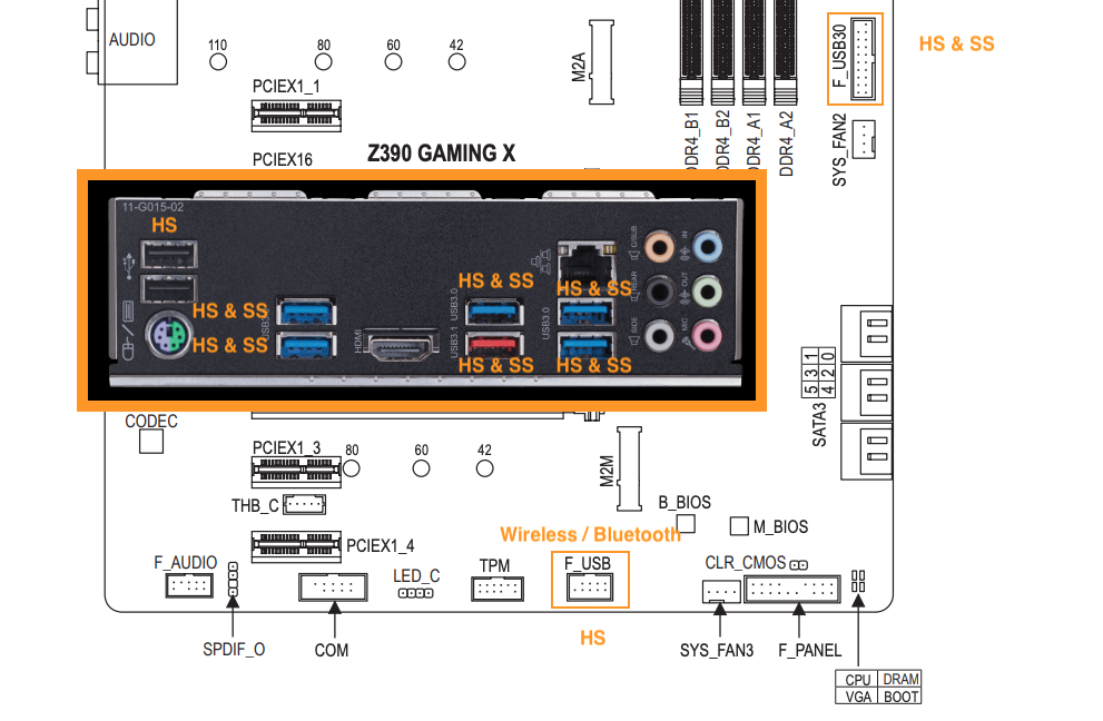

larabee Posted April 21, 2019 Share Posted April 21, 2019 1 hour ago, glasgood said: Nice Hack, very good benchmarks! did you use my EFI for your Gigabyte Z390 Gaming X ? I used your pre-installation EFI as both my Pre and Post installation. I don't need to do anything with SSDT for my USB to work because my board is within the USB limit of Mac OS. Besides, the USB patch from config.plist already unlocked the USB 3 ports. Everything went as smoothly as it should on a real Mac. I'm still tweaking the voltage of my Vega 56 to make it runs a bit cooler. Link to comment https://www.insanelymac.com/forum/topic/337837-glasgoods-macos-mojave-successguide-for-aorus-z390-pro/page/3/#findComment-2670919 Share on other sites More sharing options...
glasgood Posted April 22, 2019 Author Share Posted April 22, 2019 9 hours ago, larabee said: I used your pre-installation EFI as both my Pre and Post installation. I don't need to do anything with SSDT for my USB to work because my board is within the USB limit of Mac OS. Besides, the USB patch from config.plist already unlocked the USB 3 ports. Everything went as smoothly as it should on a real Mac. I'm still tweaking the voltage of my Vega 56 to make it runs a bit cooler. Was just looking at your board. Do you have a WiFi card with Bluetooth connected to F_USB header, also is F_USB30 attached to CASE, those USB ports on CASE could exceed the limit. If in doubt, try a port discovery, see guide below: Thanks for letting me know that EFI pre-installation worked on your machine. Link to comment https://www.insanelymac.com/forum/topic/337837-glasgoods-macos-mojave-successguide-for-aorus-z390-pro/page/3/#findComment-2670940 Share on other sites More sharing options...

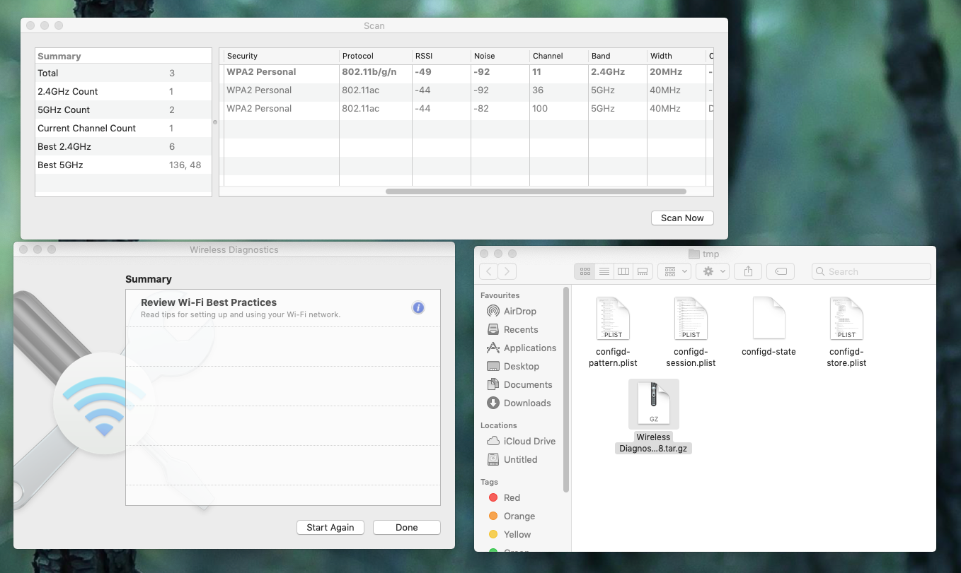

Hifi33 Posted April 22, 2019 Share Posted April 22, 2019 (edited) 15 hours ago, glasgood said: Hi, I got two hard drives for my machine, one for testing. I noticed that Country Code was set US on the test drive, as far as I was aware it should be GB or DE. As far as I know, AirportBrcmFixup.kext for my Wi-Fi card defaults to US, so I found the way to change country code. I updated guide with instructions on this. OPTIONAL: Set Wi-Fi Country Code Resolved the issue, finally. Regarding the speed problem with the BCM94360CD, this is where some of my inexperience shows up, after trying varying ways to get my 5GHz band working as it should, stopping the high pings and complete slowing down of my connection to a crawl, etc. I reseated the card, rebooted my router, still no avail, then I realized I had overlooked placing the AirportBrcmFixup.kext into my Other folder on my EFI partition. I guess I thought this card just worked out of the box so it didn't occur to me. Once the kext was installed, and I rebooted my speed went way up where it should be normally. And more importantly stayed there. Now to change the country code. Edited April 22, 2019 by Hifi33 1 Link to comment https://www.insanelymac.com/forum/topic/337837-glasgoods-macos-mojave-successguide-for-aorus-z390-pro/page/3/#findComment-2670945 Share on other sites More sharing options...

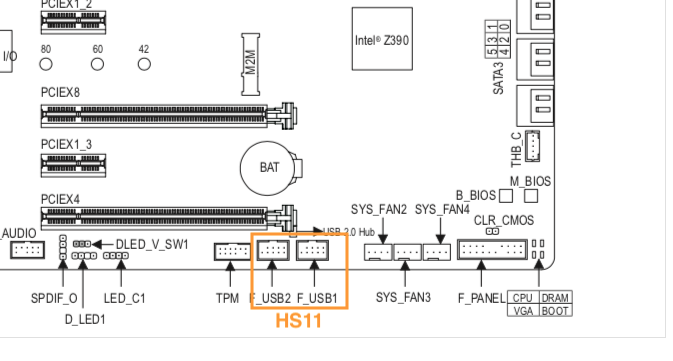

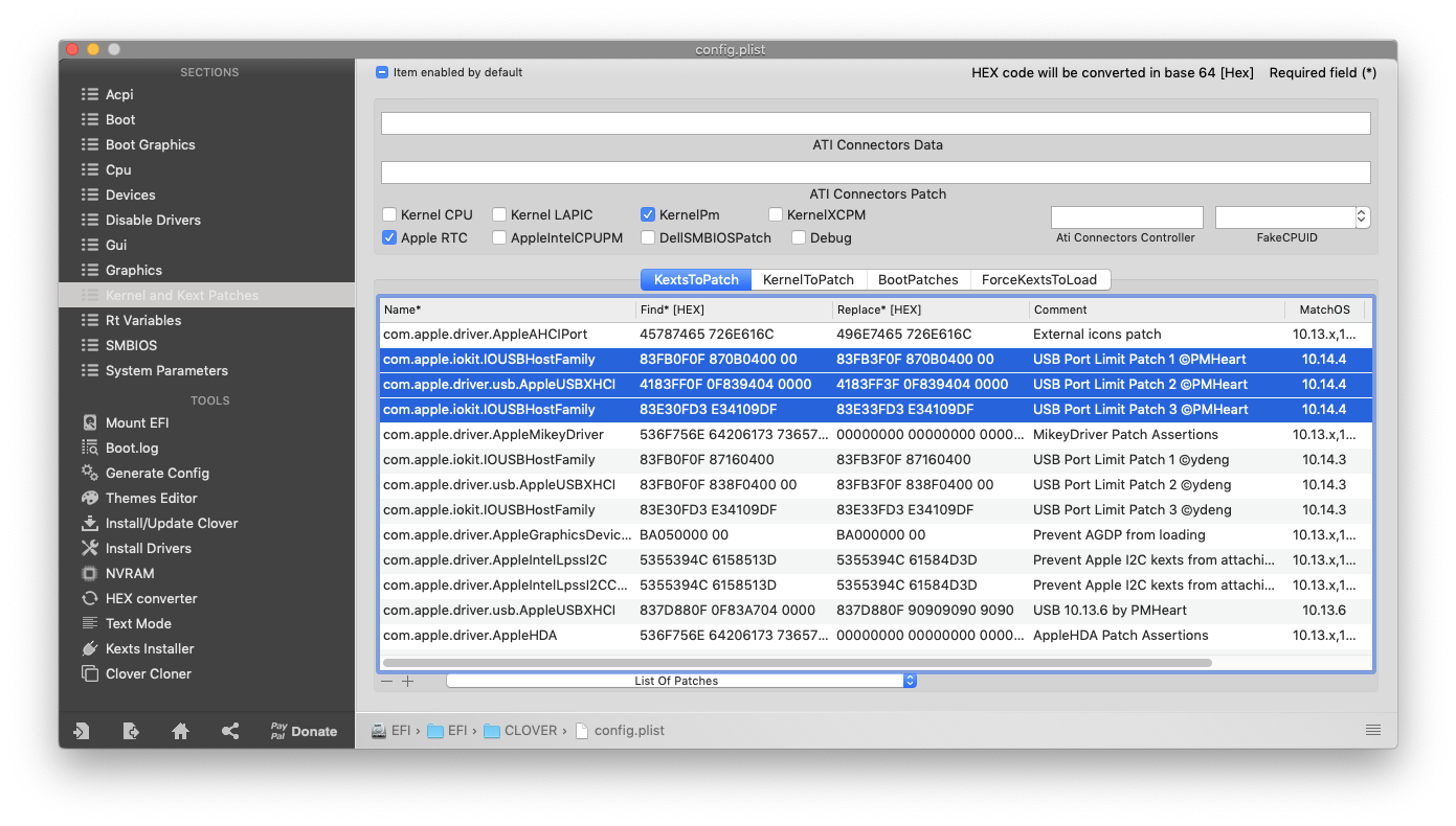

larabee Posted April 22, 2019 Share Posted April 22, 2019 16 hours ago, glasgood said: Was just looking at your board. Do you have a WiFi card with Bluetooth connected to F_USB header, also is F_USB30 attached to CASE, those USB ports on CASE could exceed the limit. If in doubt, try a port discovery, see guide below: Thanks for letting me know that EFI pre-installation worked on your machine. I don't use any of those connectors and stay within the USB limit. I tried hooking up my case USB ports and my Monitor USB ports into the USB 3 headers on my board and confirm they are all working just fine (I did not measure the bandwidth of them anyway) I think it's because I have the USB patches applied? I will install a thunderbolt add-on card from Gigabyte soon. What Wifi card do you recommend for airdrop? Link to comment https://www.insanelymac.com/forum/topic/337837-glasgoods-macos-mojave-successguide-for-aorus-z390-pro/page/3/#findComment-2671014 Share on other sites More sharing options...
glasgood Posted April 23, 2019 Author Share Posted April 23, 2019 7 hours ago, larabee said: I don't use any of those connectors and stay within the USB limit. I tried hooking up my case USB ports and my Monitor USB ports into the USB 3 headers on my board and confirm they are all working just fine (I did not measure the bandwidth of them anyway) I think it's because I have the USB patches applied? I will install a thunderbolt add-on card from Gigabyte soon. What Wifi card do you recommend for airdrop? Sometime when macOS is updated it can beak the ports limit patch, and RehabMan mentioned " The port limit patch should not be used as a permanent solution. There is now clear evidence that using it causes other data beyond what is evidently a fixed size array to be clobbered. The result is strange behavior by the USB drivers when the port limit is exceeded." Pointer >> USB ports limit etc.. RECOMMENDED WIFI CARD → ABWB 802.11AC WI-FI With Bluetooth 4.0 PCI-Express (PCI-E) BCM943602CS Link to comment https://www.insanelymac.com/forum/topic/337837-glasgoods-macos-mojave-successguide-for-aorus-z390-pro/page/3/#findComment-2671033 Share on other sites More sharing options...
larabee Posted April 23, 2019 Share Posted April 23, 2019 (edited) 14 hours ago, glasgood said: Sometime when macOS is updated it can beak the ports limit patch, and RehabMan mentioned " The port limit patch should not be used as a permanent solution. There is now clear evidence that using it causes other data beyond what is evidently a fixed size array to be clobbered. The result is strange behavior by the USB drivers when the port limit is exceeded." Pointer >> USB ports limit etc.. RECOMMENDED WIFI CARD → ABWB 802.11AC WI-FI With Bluetooth 4.0 PCI-Express (PCI-E) BCM943602CS Thank you so much, I will get my SSDT at a later point because I'm on mission critical using that hackintosh (it's stable enough.) I've had other builds that eject USB randomly when the max ports are reached. I've just ordered one of the BCM943602CS card for cheap like $20 including the PCIExpress X1 adapter. UPDATED: I've removed some ports in my SSDT. Here is my Board Layout with USB ports mapped The included SSDT completely disabled 5+6 ports. SSDT-UIAC.aml Edited April 23, 2019 by larabee add SSDT 1 Link to comment https://www.insanelymac.com/forum/topic/337837-glasgoods-macos-mojave-successguide-for-aorus-z390-pro/page/3/#findComment-2671131 Share on other sites More sharing options...
