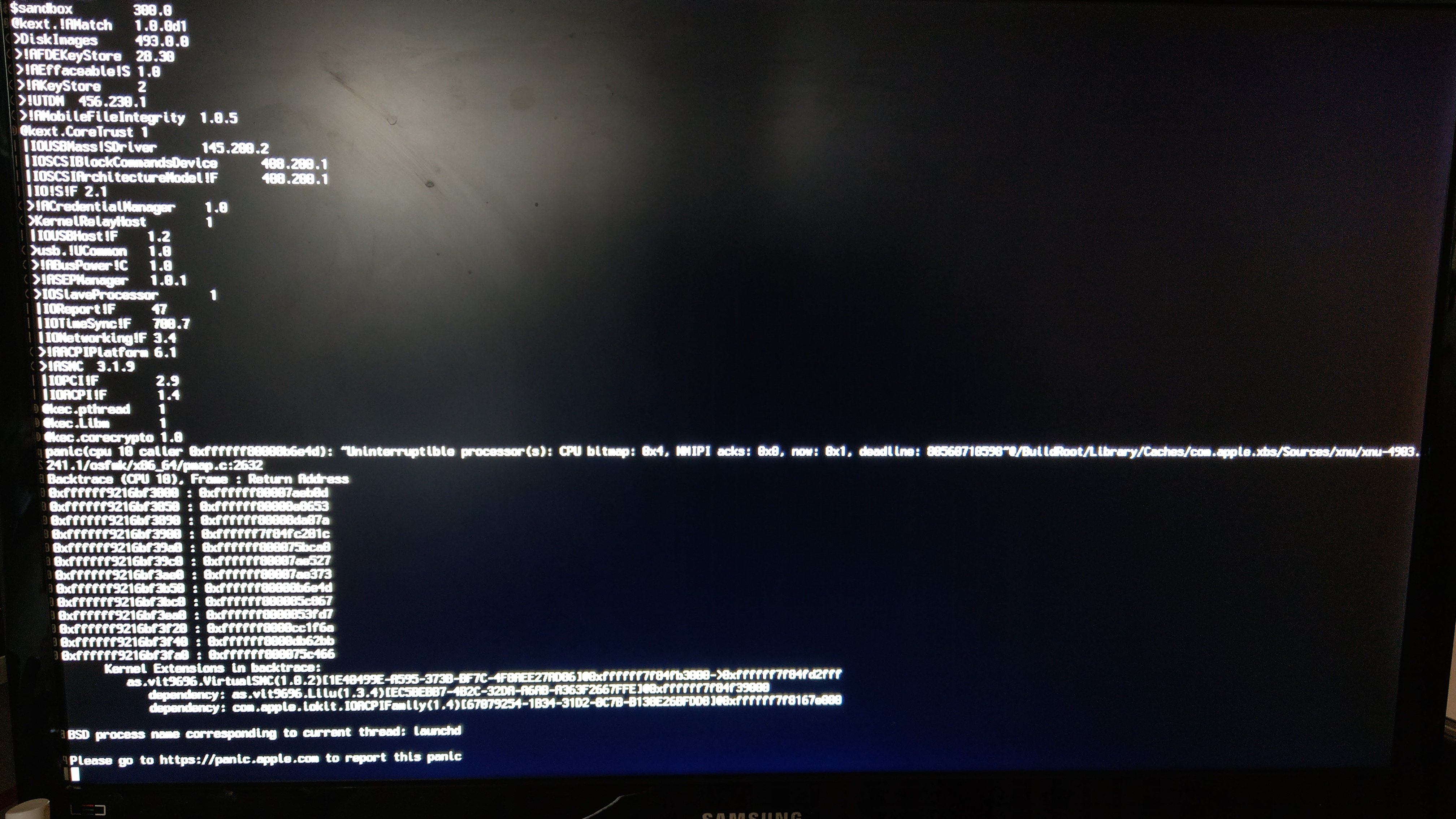

Hello everyone, I'm new to the forum and new to Mac OS. first of all congratulations for this comprehensive guide. I come to the point: I followed this guide step by step, but without the desired result. I can't even install mac os. everything crashes as soon as the white apple appears ...... I'm sure I created the bootable usb well with mojave v.10.14.4 (from mojave 10.14.2 on vmware) .... I kindly ask for your help
hardware:
gigabyte aorus z390 pro wifi
intel core i7 8700k
Sapphire Pulse Radeon RX 580 8gb
16gb corsair vengance lpx (2x8)
SSD Samsung 970 Evo Plus M.2 500 GB (windows 10 pro)
ssd samsung 840 pro 120gb (for mac os)
I started also in verbose mode, I attach photos, if you need anything else, tell me. I repeat, I don't know mac os, please help me ..... maybe even with simple explanations .....
Thanks in advance
Hi,
Lots of ACPI errors,  check BIOS settings correct and BIOS version is F5. Remove DSDT from CLOVER /  ACPI / PATCHED.  Also temporarily disconnect your 970 Evo Plus and ensure that you have corsair memory installed in slots DDR4_A1 and DDR4_B1 . Then start boot from Mojave USB installer, ensure that installer is connected to the USB 2 ports.  When you have successfully installed macOS Mojave then reconnect your 970 Evo Plus.
There seems to be some issues with Samsung 970 Evo Plus causing kernel panics when used with a hackintosh computer.

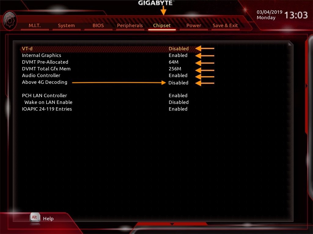

Hi,
I have configured and tested a Pre-install EFI folder for macOS Mojave 10.14.4  >>PRE - INSTALL - Aorus Z390 Pro EFI .zip .  Ensure  BIOS Chipset --> Above 4G Decoding is Disabled. I discovered that 4G Decoding Enabled can cause problems during installation if you don't have DSDT.   You should now be able to install macOS Mojave 10.14.4 without any problems. Once you have installed macOS Mojave 10.14.4, then use the (Aorus Z390 Pro EFI - NO DSDT) EFI folder and copy it to your system drive EFI partition.

Just updating guide with a pre install EFI folder. I noticed that when BIOS Above 4G Decoding is Enabled it causes bad problem with last 2 mins of Mojave install and other problems with shutdown and kernel panics.  But with 4G Decoding Disabled then everything is good.
But when using DSDT with BIOS Above 4G Decoding Enabled there is no problem, everything good.

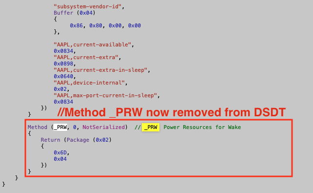

Cameron, if you are using BIOS version F5. Change BIOS settings to match guide. Then replace patched folder in ACPI in Cover with patched.zip . I tested this and sleep and sound is playing upon wake.
I made edit below to DSDT.

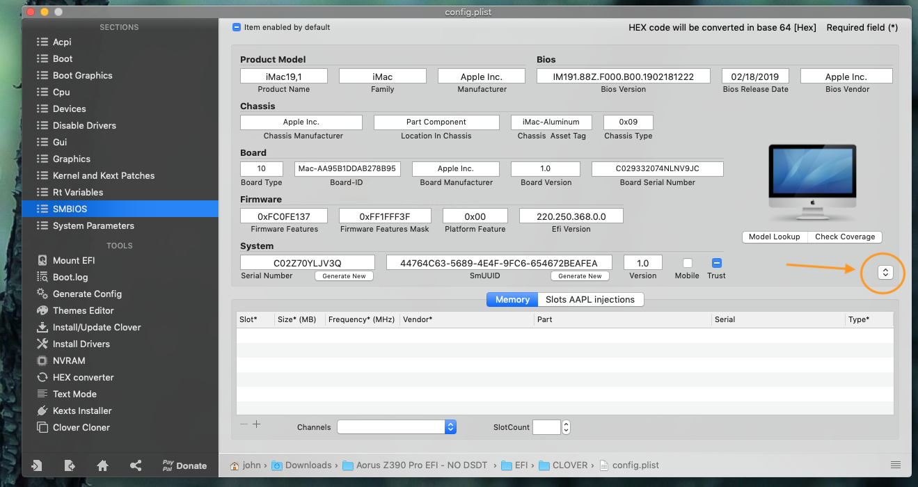

I had a look through your Clover folder from the Send me Camerons-iMac.zip you sent. Noticed you had extra ( unneeded ) 11 x SSDT in your ACPI folder, you only need DSDT, SSDT-UIAC, and SSDT-USBX. Also you had some boot args missing, I replaced AptioMemoryFix with OSXAptioFix2Drv-free2000 . Attached below, is my Clover folder. Replace your existing Clover folder with that. And you should be sorted.
CLOVER.zip
Edited by glasgood

Thank you,
My clover did not have all the SSDT's in it for some reason that RunMe.app put them there.
You're clover fixed the audio issues but not the webcam.
I forgot to edit my RT Variables and SMBios in your config, now I don't have iMessage or FaceTime. Guess the waiting game starts for my Authentication Token to reset :(

The only solution I have come up with is to download a power manger app that runs the following script after wake
The audio, on awake from sleep stared working after the last remaining  _PWR method was removed from original DSDT.

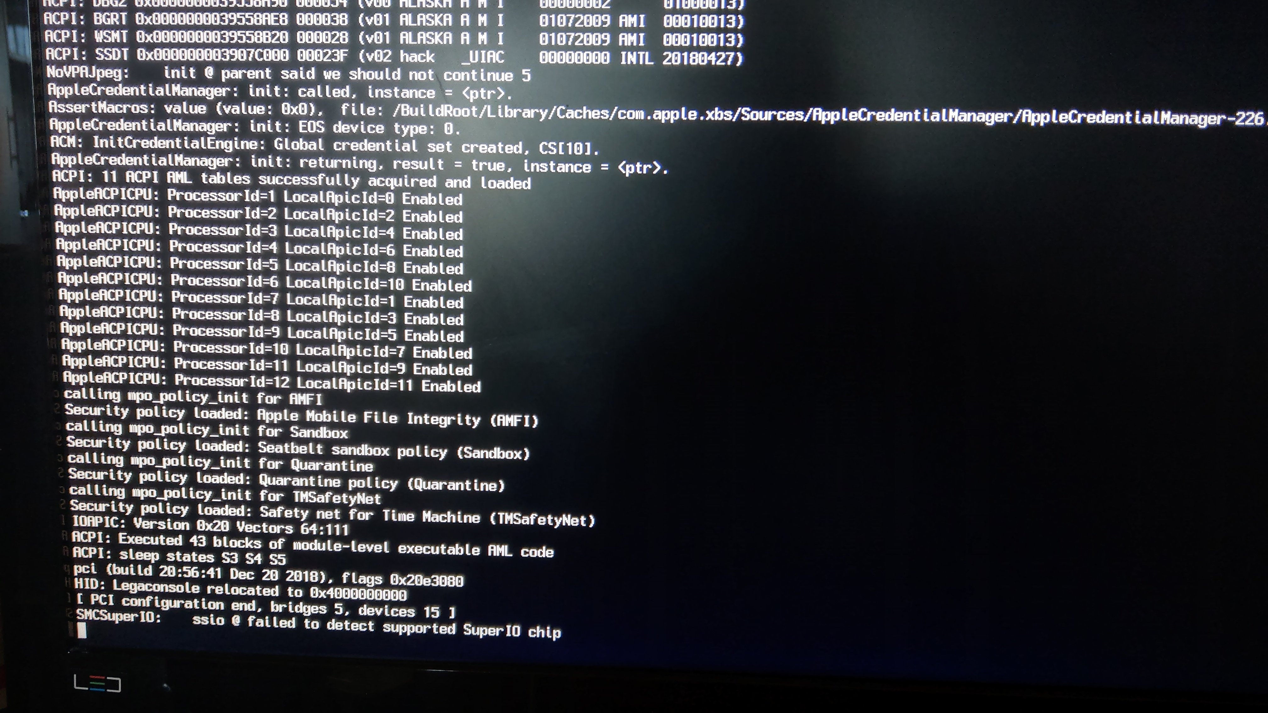

hi everyone, today I tried to finish the guide, and I have another problem ....... I installed clover and replaced the efi folder as in the guide, and the pc hangs during shutdown ..... I attach photo. with the usb boot no problem ...... where am I wrong?
