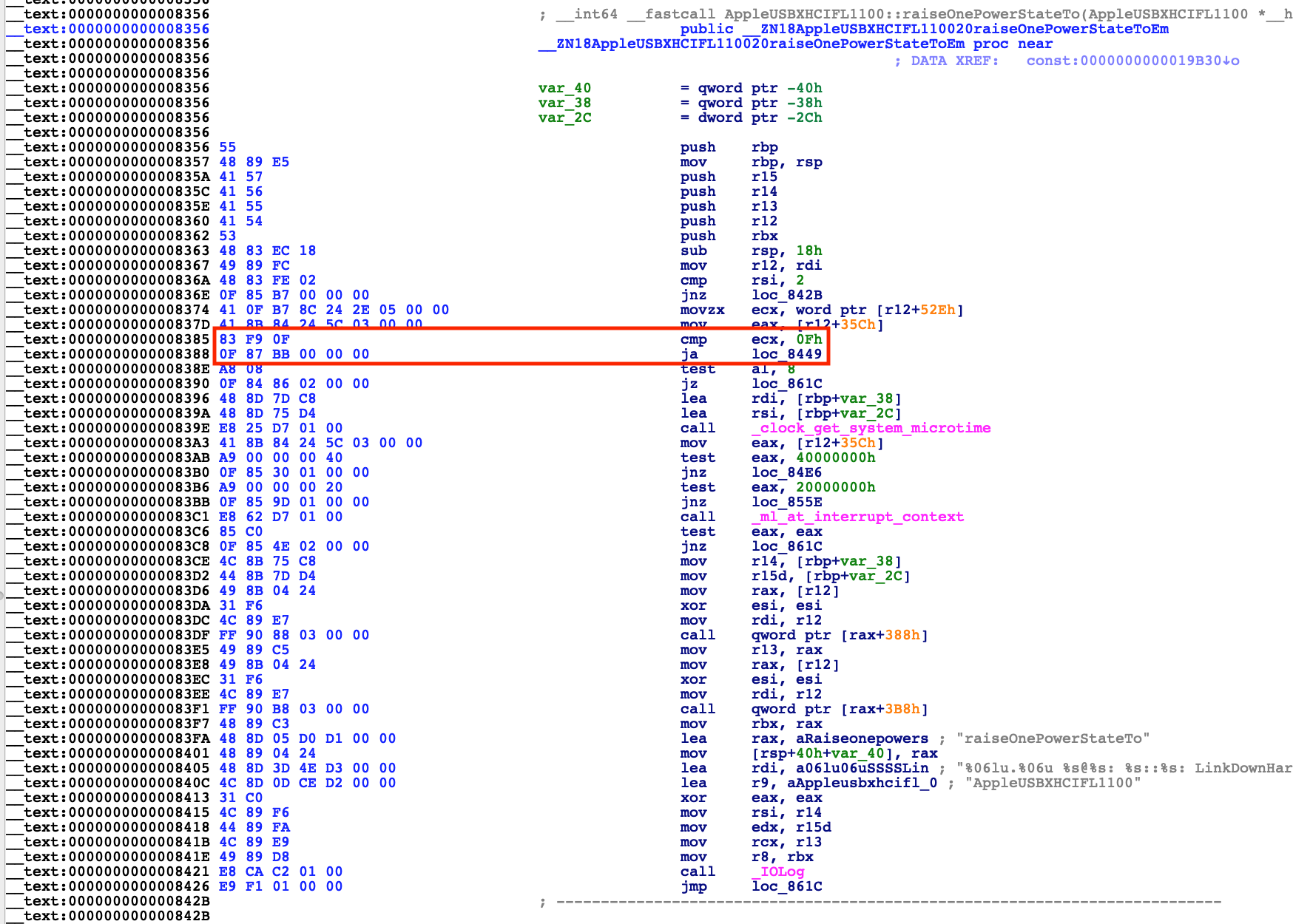

Donw35 Posted October 31, 2018 Share Posted October 31, 2018 First patch: Find: 83fb0f0f 838f0400 00 Replace: 83fb0f90 90909090 90 Name: com.apple.driver.usb.AppleUSBXHCI MatchOS: 10.14.x Second patch: Find: 4183fd0f 753a Replace: 4183fd0f 9090 Name: com.apple.driver.usb.AppleUSBXHCI MatchOS: 10.14.x I put both patches in using Clover Configurator, still have USB 3.0 but had that before too Link to comment https://www.insanelymac.com/forum/topic/336241-macos-mojave-10141-is-out/page/2/#findComment-2644160 Share on other sites More sharing options...
headkaze Posted October 31, 2018 Share Posted October 31, 2018 Just now, Donw35 said: First patch: Find: 83fb0f0f 838f0400 00 Replace: 83fb0f90 90909090 90 Name: com.apple.driver.usb.AppleUSBXHCI MatchOS: 10.14.x Second patch: Find: 4183fd0f 753a Replace: 4183fd0f 9090 Name: com.apple.driver.usb.AppleUSBXHCI MatchOS: 10.14.x I put both patches in using Clover Configurator, still have USB 3.0 but had that before too I had a feeling the second patch wasn't going to work but thanks for giving it a try. RehabMan is suggesting we abandon the idea of a port limit patch altogether and just configure USB ports in batches. ie. We use USBInjectAll.kext to enable HSxx ports in one pass then SSxx ports in second pass etc. It does add a level of complication that we otherwise didn't have with a port limit patch though. Link to comment https://www.insanelymac.com/forum/topic/336241-macos-mojave-10141-is-out/page/2/#findComment-2644161 Share on other sites More sharing options...

headkaze Posted October 31, 2018 Share Posted October 31, 2018 (edited) Okay one last try for me. RehabMan suggests the check could be in AppleUSBXHCIPCI. So I found the only obvious cmp that might be it. Patch 1: Find: 83fb0f0f 838f0400 00 Replace: 83fb0f90 90909090 90 Name: com.apple.driver.usb.AppleUSBXHCI MatchOS: 10.14.x Patch 2: Find: 83f90f0f 87bb0000 00 Replace: 83f90f90 90909090 90 Name: com.apple.driver.usb.AppleUSBXHCIPCI MatchOS: 10.14.x Edited October 31, 2018 by headkaze 2 Link to comment https://www.insanelymac.com/forum/topic/336241-macos-mojave-10141-is-out/page/2/#findComment-2644166 Share on other sites More sharing options...

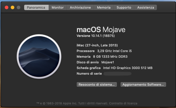

marvelloard Posted October 31, 2018 Share Posted October 31, 2018 Funny side-note, i5 8400 now gets recognised by "About this Mac" :-) 2 Link to comment https://www.insanelymac.com/forum/topic/336241-macos-mojave-10141-is-out/page/2/#findComment-2644175 Share on other sites More sharing options...

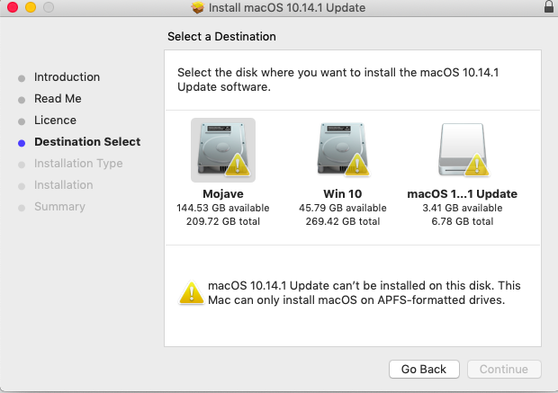

Crabhunter Posted October 31, 2018 Share Posted October 31, 2018 I'm getting this error. I have Mojave 10.14.0 installed on a legacy bios and an mbr harddrive using crazybird's patch. Any ideas? Mike Link to comment https://www.insanelymac.com/forum/topic/336241-macos-mojave-10141-is-out/page/2/#findComment-2644195 Share on other sites More sharing options...
SavageAUS Posted October 31, 2018 Share Posted October 31, 2018 (edited) Updated to 10.14.1 the did a fresh install and all is well on my desktop. Edited October 31, 2018 by SavageAUS Link to comment https://www.insanelymac.com/forum/topic/336241-macos-mojave-10141-is-out/page/2/#findComment-2644200 Share on other sites More sharing options...

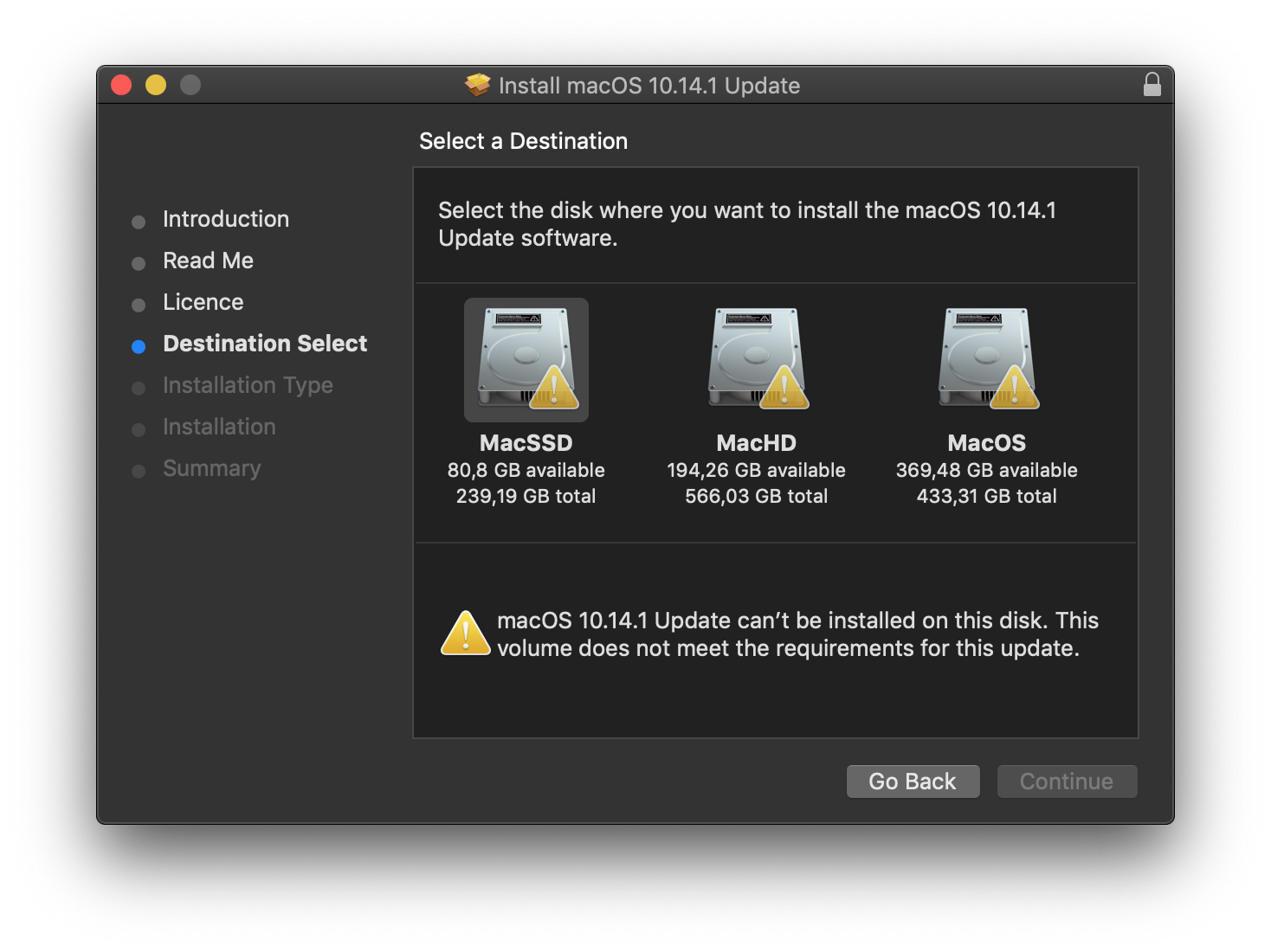

crazybirdy Posted October 31, 2018 Share Posted October 31, 2018 (edited) 3 hours ago, Crabhunter said: I'm getting this error. I have Mojave 10.14.0 installed on a legacy bios and an mbr harddrive using crazybird's patch. Any ideas? Mike HFS+ can't get update install, need to use Q9-script. It could be the SIP issue, set Clover SIP as HowTo add to /EFI/CLOVER/config.plist as below. <key>RtVariables</key> <dict> <key>BooterConfig</key> <string>0x28</string> <key>CsrActiveConfig</key> <string>0x67</string> </dict> Q9-Update-installScript/installScript_1014 works fine here on MBR HFS 10.14.0.18A391. Edited October 31, 2018 by crazybirdy Link to comment https://www.insanelymac.com/forum/topic/336241-macos-mojave-10141-is-out/page/2/#findComment-2644230 Share on other sites More sharing options...

CreativelyChris Posted October 31, 2018 Share Posted October 31, 2018 (edited) 6 hours ago, crazybirdy said: HFS+ can't get update install, need to use Q9-script. I used the script and now OS X won't boot. Keeps getting stuck at "apfs_module_stop: 1371: unload" Was working fine with 10.14 It's an HP Z800 with HFS+ SSD boot drive. Edited October 31, 2018 by CreativelyChris Link to comment https://www.insanelymac.com/forum/topic/336241-macos-mojave-10141-is-out/page/2/#findComment-2644265 Share on other sites More sharing options...

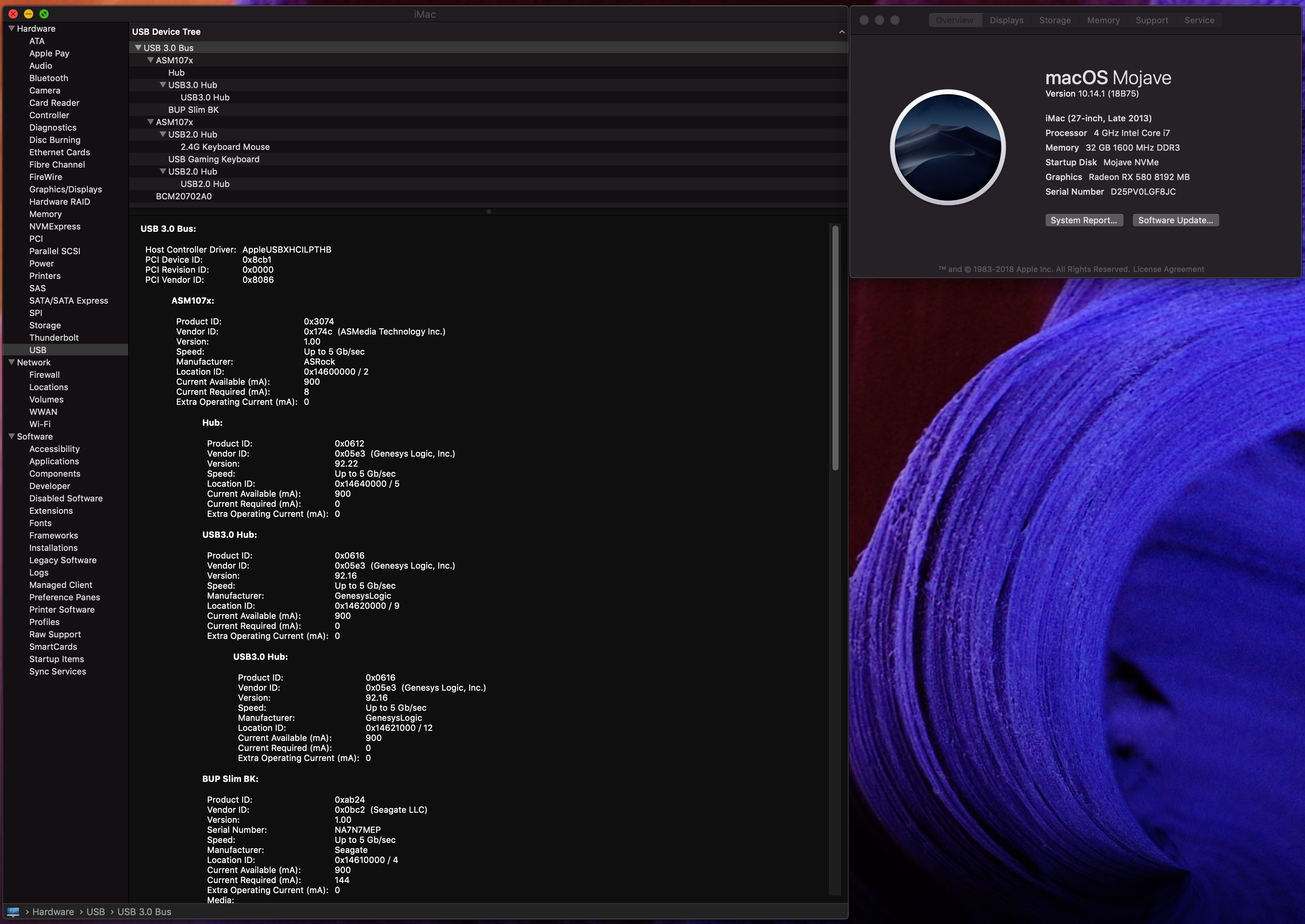

tikizondo94 Posted October 31, 2018 Share Posted October 31, 2018 Got USB 3.0 Working. Booted back into my Mojave 10.14 "pre-update" drive. Used latest FbPatcher v1.5.7 to create a USBPort.kext. Follow the instructions. I have 2.0 and 3.0 working again. Link to comment https://www.insanelymac.com/forum/topic/336241-macos-mojave-10141-is-out/page/2/#findComment-2644298 Share on other sites More sharing options...
crazybirdy Posted October 31, 2018 Share Posted October 31, 2018 2 hours ago, CreativelyChris said: I used the script and now OS X won't boot. Keeps getting stuck at "apfs_module_stop: 1371: unload" Was working fine with 10.14 It's an HP Z800 with HFS+ SSD boot drive. Try to boot -s to single user mode, and sudo command again. Link to comment https://www.insanelymac.com/forum/topic/336241-macos-mojave-10141-is-out/page/2/#findComment-2644303 Share on other sites More sharing options...
