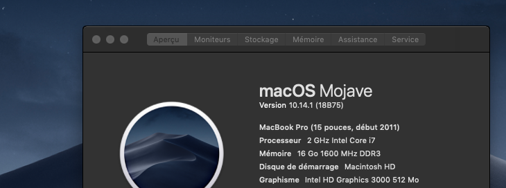

@ROBASEFR Posted October 30, 2018 Share Posted October 30, 2018 (edited) Having Mojave 10.14 installed with macOS Mojave Patcher Tool on my MACBook Pro 8,1. no Auto Apple update for the moment and mac OSX 10.14.1 update.pkg doesn't accept install ( seems normal probably system checks ....) Have to wait for update of the patcher tool update: "Patch Updater" updated to v.1.10 now Auto Apple updated to 10.14.1 No problems ! Edited October 30, 2018 by @ROBASEFR update fixed ! Link to comment Share on other sites More sharing options...

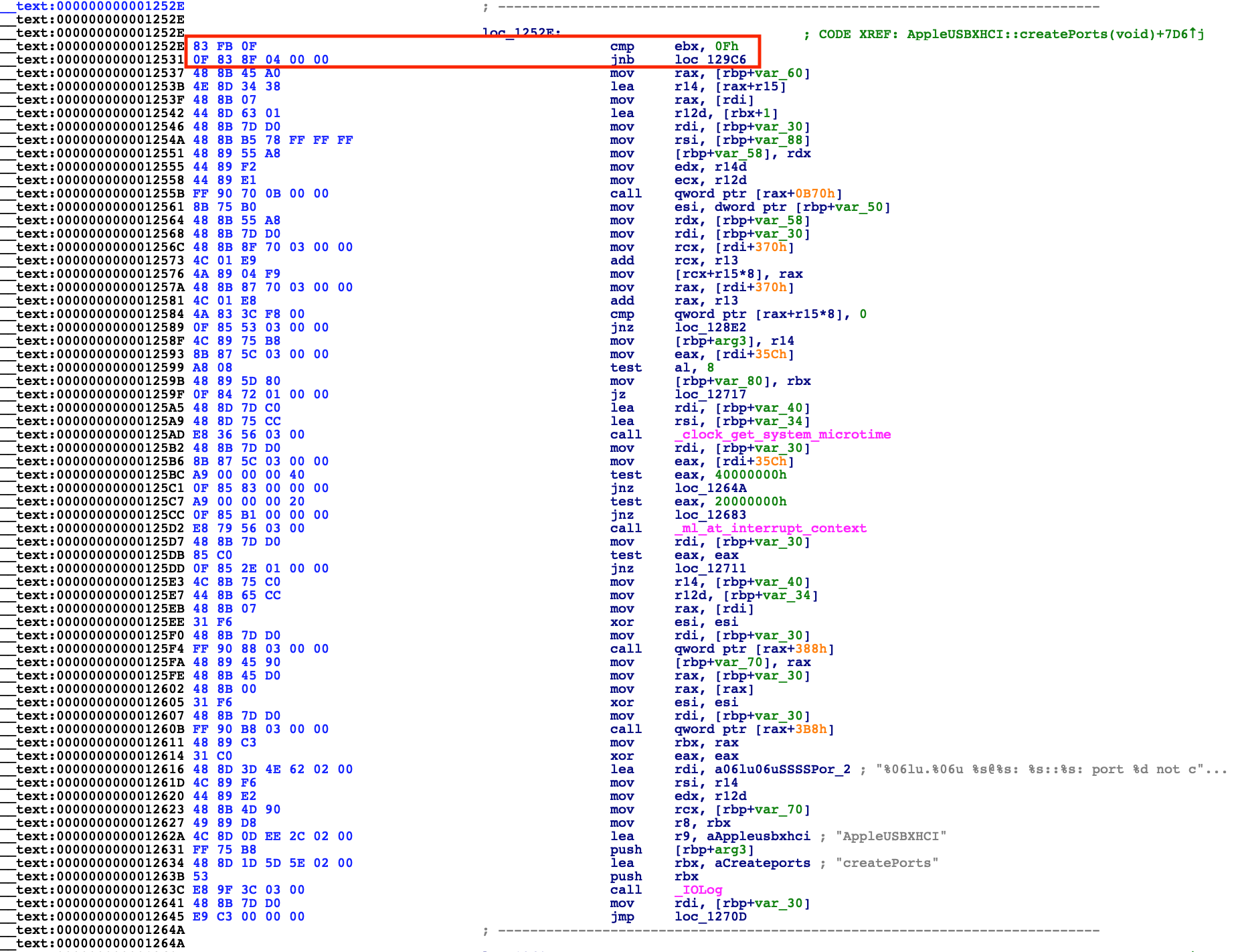

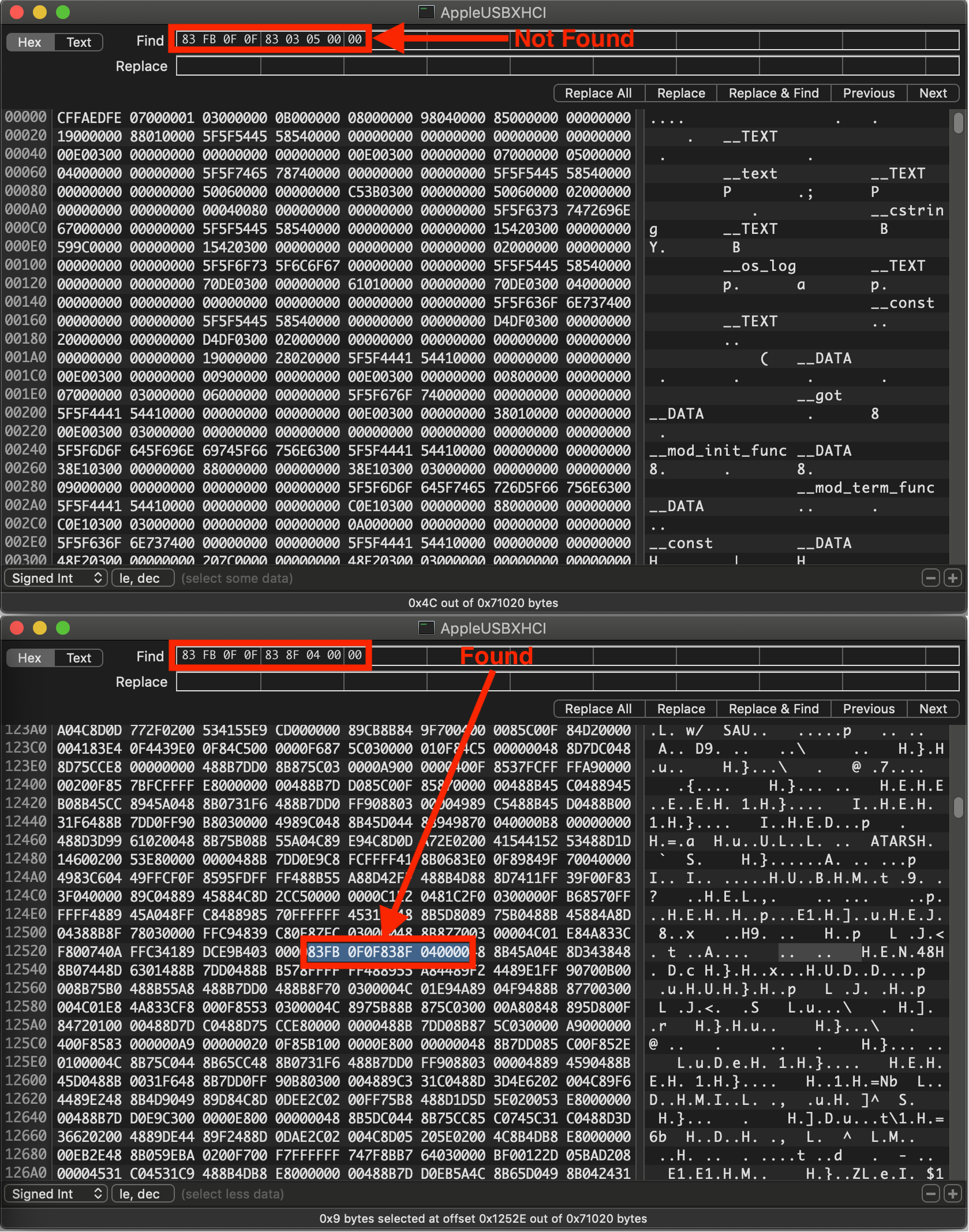

tikizondo94 Posted October 30, 2018 Share Posted October 30, 2018 Just now, SavageAUS said: Downloading on laptop now. USB port limit patch the same or ? Sent from my iPhone using Tapatalk Im using the current 10.14 Find - 83FB0F0F 83030500 00 Replace - 83FB0F90 90909090 90 and its not working with my setup. Worked normal up to 10.14.1. Only USB 2.0 Link to comment Share on other sites More sharing options...
headkaze Posted October 31, 2018 Share Posted October 31, 2018 (edited) 3 hours ago, tikizondo94 said: Im using the current 10.14 Find - 83FB0F0F 83030500 00 Replace - 83FB0F90 90909090 90 and its not working with my setup. Worked normal up to 10.14.1. Only USB 2.0 It doesn't appear to be correct. Can you try the following and let us know if it works? Find: 83fb0f0f 838f0400 00 Replace: 83fb0f90 90909090 90 Name: com.apple.driver.usb.AppleUSBXHCI MatchOS: 10.14.x In future if you want to check if the patch works go to /System/Library/Extensions/IOUSBHostFamily.kext/Contents/PlugIns/AppleUSBXHCI.kext/Contents/MacOS and open AppleUSBXHCI in a hex editor like HexFiend. Do a hex search for the byte sequence. If it's not found then the patch will not work. Edited October 31, 2018 by headkaze 3 Link to comment Share on other sites More sharing options...

Donw35 Posted October 31, 2018 Share Posted October 31, 2018 1 hour ago, headkaze said: Find: 83fb0f0f 838f0400 00 Replace: 83fb0f90 90909090 90 Name: com.apple.driver.usb.AppleUSBXHCI MatchOS: 10.14.x first I have seen those numbers, how did you come to find these ? Link to comment Share on other sites More sharing options...
headkaze Posted October 31, 2018 Share Posted October 31, 2018 2 minutes ago, Donw35 said: first I have seen those numbers, how did you come to find these ? I just searched for "83FB0F0F 83030500 00" in the binary removing a byte at a time until it was found. Then I just replaced the changed bytes with the new ones. 1 Link to comment Share on other sites More sharing options...

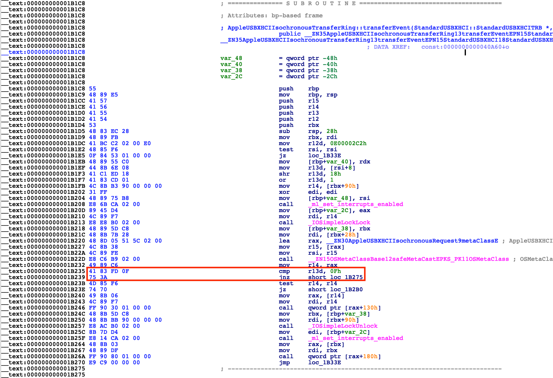

headkaze Posted October 31, 2018 Share Posted October 31, 2018 (edited) I did find a possibility for the second patch. First Patch: Find: 83fb0f0f 838f0400 00 Replace: 83fb0f90 90909090 90 Name: com.apple.driver.usb.AppleUSBXHCI MatchOS: 10.14.x Second patch: Find: 4183fd0f 753a Replace: 4183fd0f 9090 Name: com.apple.driver.usb.AppleUSBXHCI MatchOS: 10.14.x Edited October 31, 2018 by headkaze 1 Link to comment Share on other sites More sharing options...
