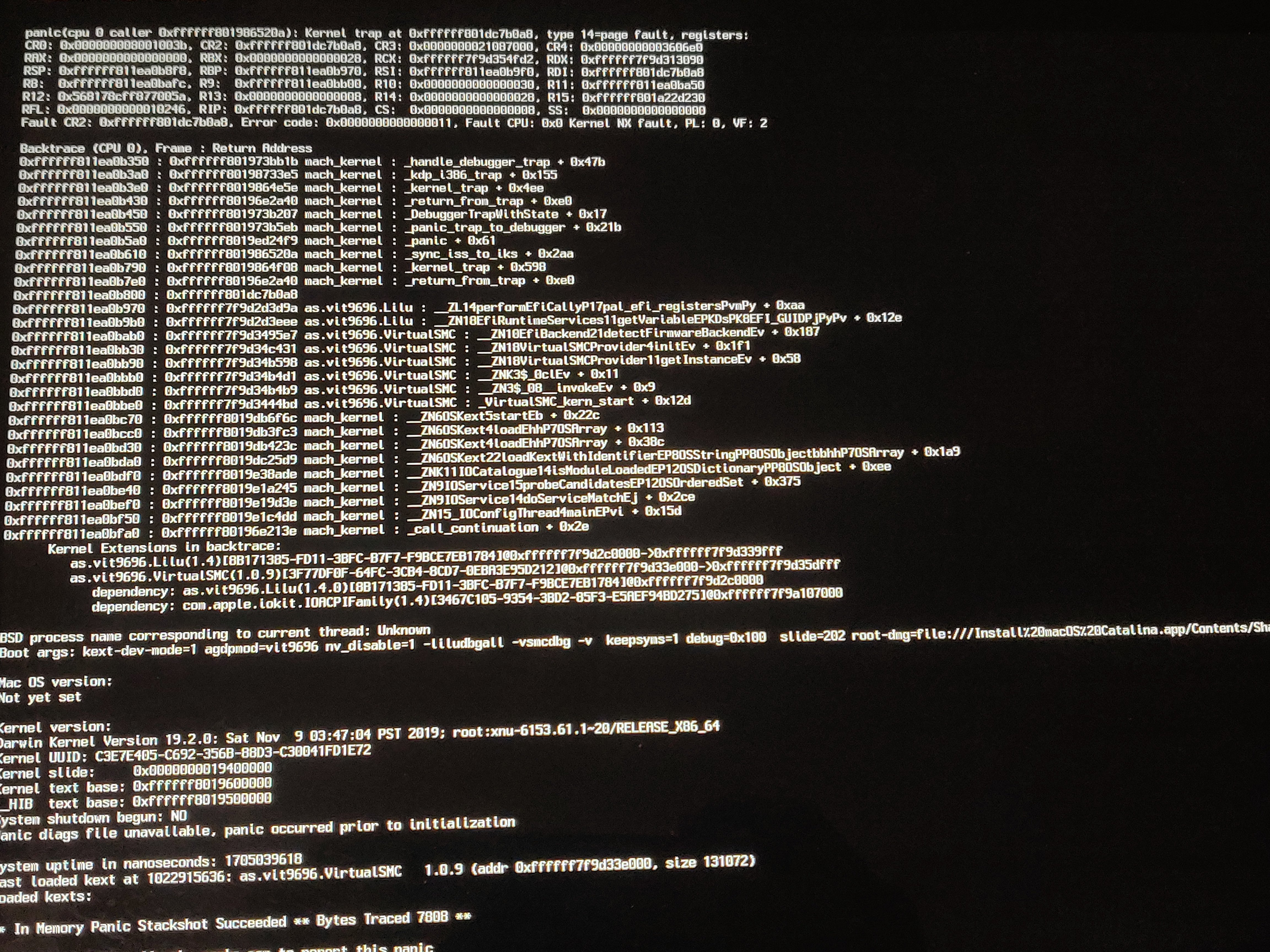

Zhen-zen Posted January 7, 2020 Share Posted January 7, 2020 (edited) 16 hours ago, holyfield said: Yes, you are correct! Unfortunately I got the same issue on my old laptop (5200U) running latest Clover + Lilu + VSMC. (I didn't migrate to newer OC since I'm unable to find equivalent parameter combination to AptioMemoryFix.efi that can boot the system even with manual slide calc.) The same configuration can boot Mojave 10.14.6 successfully but got exactly the same KP when booting a Catalina 10.15.2 Installer. Backtrace about VirtualSMC both reached _VirtualSMC_kern_start and stopped there. So I suppose here VirtualSMC is not involved by other kexts but itself while loading. Edited January 7, 2020 by gongzhen Link to comment https://www.insanelymac.com/forum/topic/335292-virtualsmc-%E2%80%94-smc-emulator/page/22/#findComment-2703337 Share on other sites More sharing options...

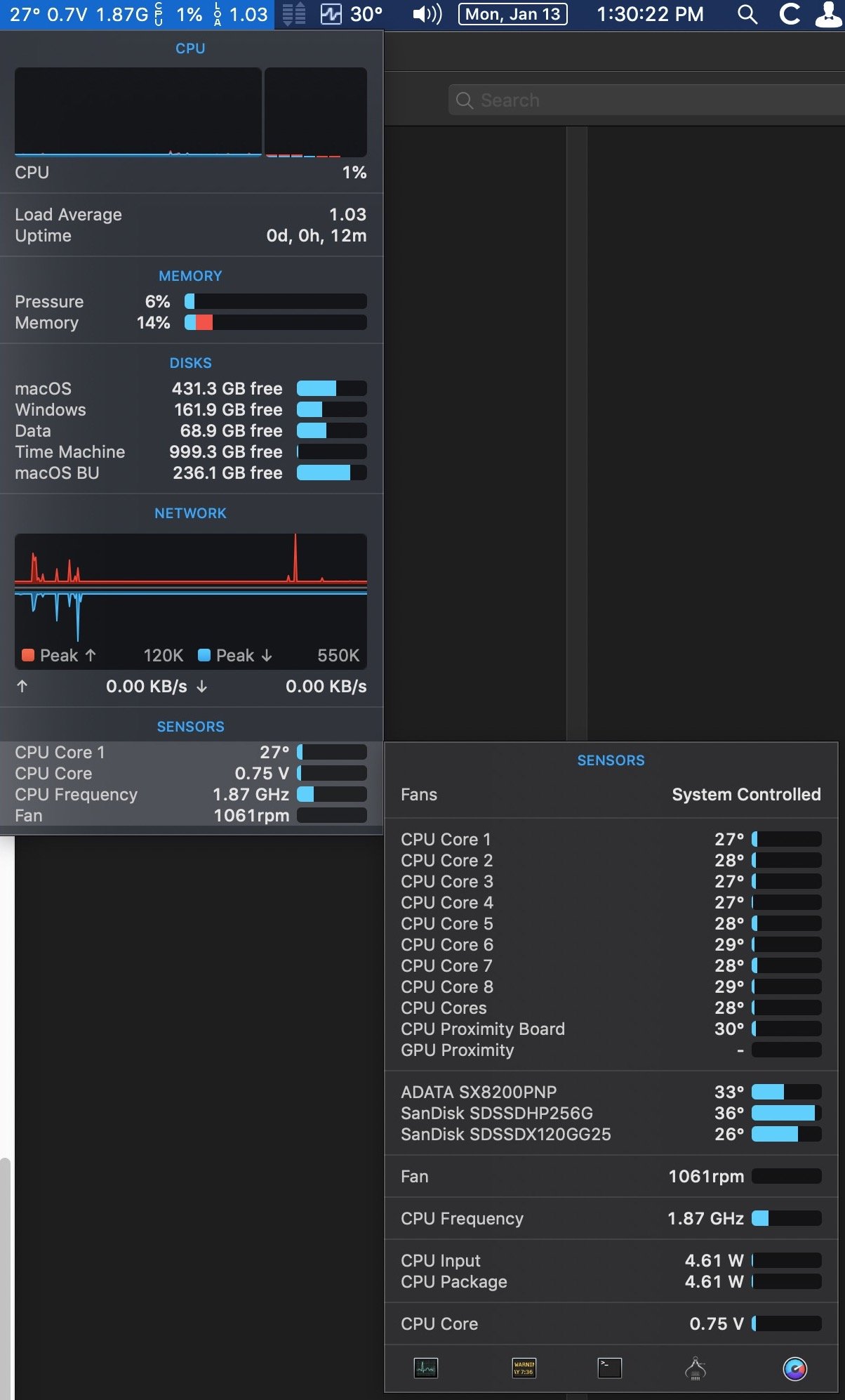

Mike Ranger Posted January 9, 2020 Share Posted January 9, 2020 Hello Vector Sigma New using the latest VirtualSMC, I get most temps I need from HWMonitorSMC2. However, I would like to continue using Istat, but there nothing is shown. My preferred temp app is still Istat. The main reason is the HWMonitorSMC2 is missing some key information like: - Battery of Keyboard and Mouse (!) - Network Traffic Is there a way that these values can be translated so other Mac Software can work with the Sensor readings as well? Thanks, Mike Link to comment https://www.insanelymac.com/forum/topic/335292-virtualsmc-%E2%80%94-smc-emulator/page/22/#findComment-2703592 Share on other sites More sharing options...

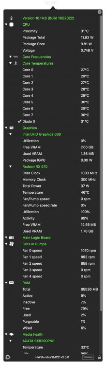

pkdesign Posted January 13, 2020 Share Posted January 13, 2020 I am a bit confused about versions 1.0.9 and 1.1.0. With 1.0.9 I was able to get most of the sensors to read on my system. With 1.1.0 I see none. I assume that I now have to include the SMC*.kexts in order to see them? I put SMCProcessor.kext and SMCSuperIO.kext in the Kext>Other folder (I don’t believe I need SMCBatteryManager.kext or SMCLightSensor.kext) and now I see most of the sensor readouts. What I don’t see are Core Frequencies or anything in the Main Logic board sections (although I do see frequencies in iStat). I'm guessing this is a HWMonitor issue? Link to comment https://www.insanelymac.com/forum/topic/335292-virtualsmc-%E2%80%94-smc-emulator/page/22/#findComment-2704074 Share on other sites More sharing options...
Andrey1970 Posted January 13, 2020 Share Posted January 13, 2020 (edited) 4 hours ago, pkdesign said: I am a bit confused about versions 1.0.9 and 1.1.0. With 1.0.9 I was able to get most of the sensors to read on my system. With 1.1.0 I see none. I assume that I now have to include the SMC*.kexts in order to see them? I put SMCProcessor.kext and SMCSuperIO.kext in the Kext>Other folder (I don’t believe I need SMCBatteryManager.kext or SMCLightSensor.kext) and now I see most of the sensor readouts. What I don’t see are Core Frequencies or anything in the Main Logic board sections (although I do see frequencies in iStat). I'm guessing this is a HWMonitor issue? Enable Intel Power Gadget in Preferences and restart app. Edited January 13, 2020 by Andrey1970 Link to comment https://www.insanelymac.com/forum/topic/335292-virtualsmc-%E2%80%94-smc-emulator/page/22/#findComment-2704153 Share on other sites More sharing options...

pkdesign Posted January 14, 2020 Share Posted January 14, 2020 18 hours ago, Andrey1970 said: Enable Intel Power Gadget in Preferences and restart app. When I enable Intel Power Gadget it causes HWMonitor to crash on startup. See crash report attached. Then I have to completely uninstall in order to get it to work again. HWMonitorSMC2_2020-01-13-200445_iMac.crash Link to comment https://www.insanelymac.com/forum/topic/335292-virtualsmc-%E2%80%94-smc-emulator/page/22/#findComment-2704265 Share on other sites More sharing options...
Andrey1970 Posted January 14, 2020 Share Posted January 14, 2020 1 hour ago, pkdesign said: When I enable Intel Power Gadget it causes HWMonitor to crash on startup. See crash report attached. Then I have to completely uninstall in order to get it to work again. HWMonitorSMC2_2020-01-13-200445_iMac.crash СС @vector sigma 1 Link to comment https://www.insanelymac.com/forum/topic/335292-virtualsmc-%E2%80%94-smc-emulator/page/22/#findComment-2704275 Share on other sites More sharing options...
vector sigma Posted January 14, 2020 Share Posted January 14, 2020 7 minutes ago, Andrey1970 said: СС @vector sigma Thanks, this is the selector that crash: GetThresholds ..from IntelPowerGadget.framework... 1 hour ago, pkdesign said: When I enable Intel Power Gadget it causes HWMonitor to crash on startup. See crash report attached. Then I have to completely uninstall in order to get it to work again. HWMonitorSMC2_2020-01-13-200445_iMac.crash Please create a file or directory in to your Desktop: touch ~/Desktop/HWIgnoreIPG restart HWMonitorSMC2.app. Should not crash anymore. If that is true, please , delete the HWIgnoreIPG file, and rebuild your prelinked kernel: sudo touch /System/Library/Extensions && sudo kextcache -u / reboot. See if the problem persist. Link to comment https://www.insanelymac.com/forum/topic/335292-virtualsmc-%E2%80%94-smc-emulator/page/22/#findComment-2704278 Share on other sites More sharing options...

pkdesign Posted January 14, 2020 Share Posted January 14, 2020 (edited) On 1/14/2020 at 2:42 PM, vector sigma said: Thanks, this is the selector that crash: GetThresholds ..from IntelPowerGadget.framework... Please create a file or directory in to your Desktop: touch ~/Desktop/HWIgnoreIPG restart HWMonitorSMC2.app. Should not crash anymore. If that is true, please , delete the HWIgnoreIPG file, and rebuild your prelinked kernel: sudo touch /System/Library/Extensions && sudo kextcache -u / reboot. See if the problem persist. When I create the file on the desktop and restart HWMonitor it fine. If I delete the file on the desktop it crashes. HWMonitorSMC2_2020-01-14-171321_iMac.crash UPDATE: I figured it out. I had to update Intel Power Gadget to 3.7. It now works. Edited January 17, 2020 by pkdesign FIX Link to comment https://www.insanelymac.com/forum/topic/335292-virtualsmc-%E2%80%94-smc-emulator/page/22/#findComment-2704306 Share on other sites More sharing options...
