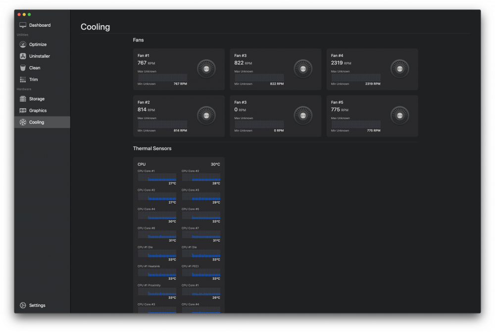

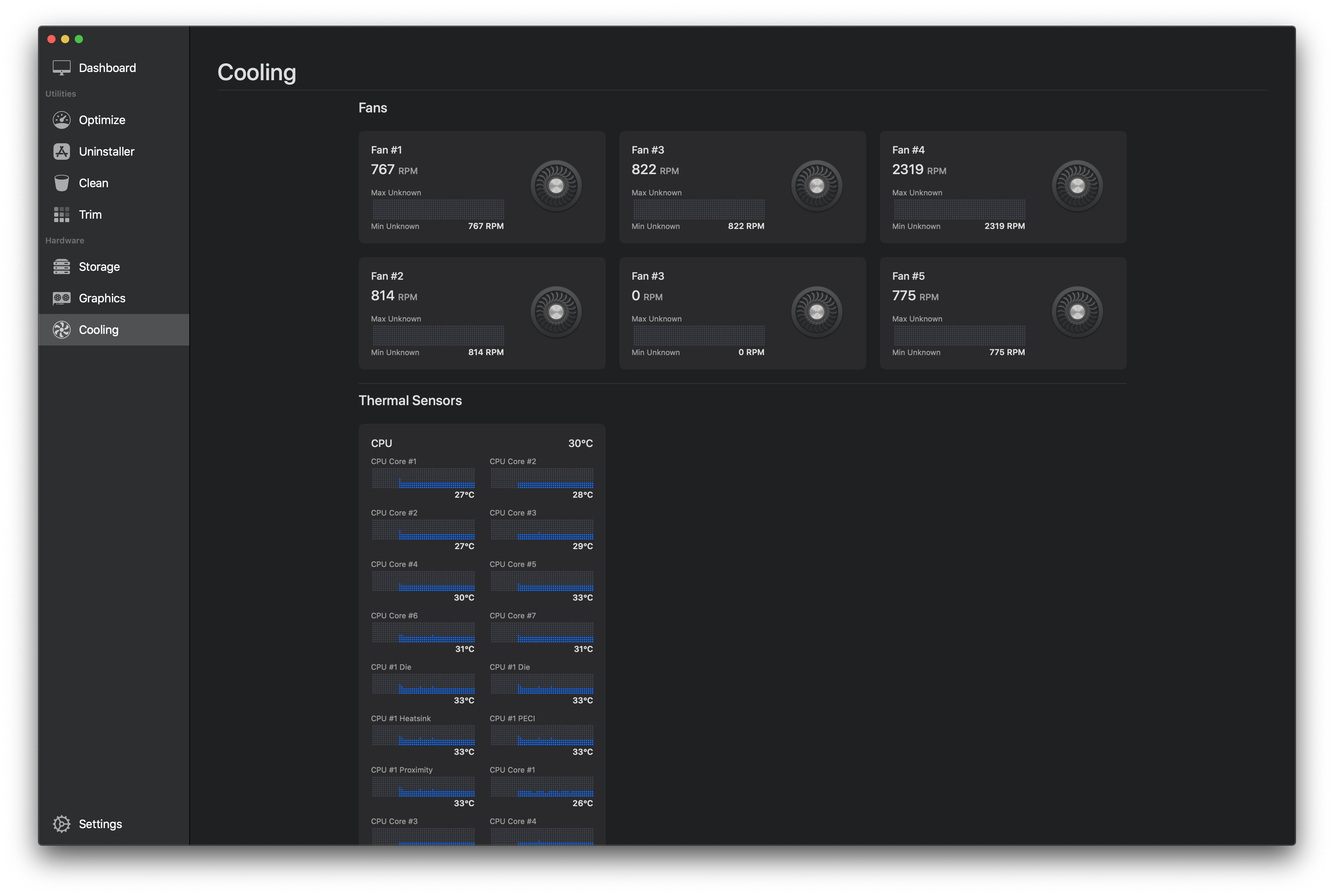

telepati Posted January 21, 2020 Share Posted January 21, 2020 VirtualSMC plugins working with Sensei.app 1 Link to comment https://www.insanelymac.com/forum/topic/335292-virtualsmc-%E2%80%94-smc-emulator/page/24/#findComment-2705161 Share on other sites More sharing options...

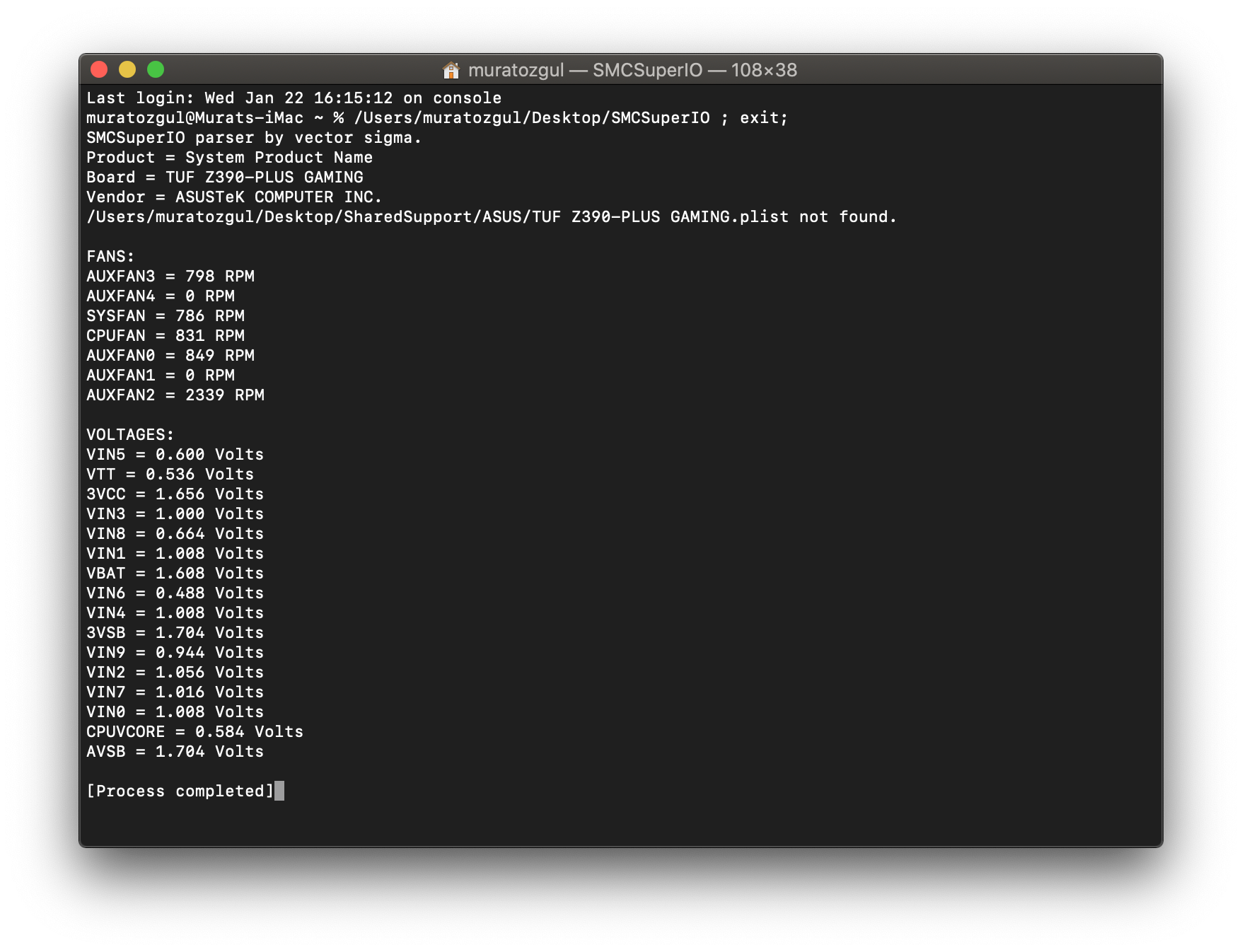

vector sigma Posted January 21, 2020 Share Posted January 21, 2020 (edited) [REMOVED] with Intel Power gadget v3.7+ support (adviced) and SMCSuperIO.kext support with autodetection Configurations must be made in: HWMonitorSMC2.app/Contents/SharedSupport/LPC/ Please, share your configurations, once made, at https://github.com/CloverHackyColor/HWMonitorSMC2, code wll be online tomorrow.. now I go to sleep Edited February 2, 2020 by vector sigma Beta app removed 2 Link to comment https://www.insanelymac.com/forum/topic/335292-virtualsmc-%E2%80%94-smc-emulator/page/24/#findComment-2705206 Share on other sites More sharing options...

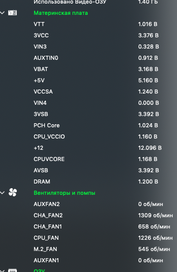

telepati Posted January 22, 2020 Share Posted January 22, 2020 @vector sigma is these volts are OK? Link to comment https://www.insanelymac.com/forum/topic/335292-virtualsmc-%E2%80%94-smc-emulator/page/24/#findComment-2705279 Share on other sites More sharing options...
vector sigma Posted January 24, 2020 Share Posted January 24, 2020 @rramon, @telepati, your sensors needs to be configured. If you have Windows, you can sync data with the help of this software: https://www.hwinfo.com/ ... and you will found so easy translating the output as sensors are (looks ) in the same exact order. Once you made yours, please share. Link to comment https://www.insanelymac.com/forum/topic/335292-virtualsmc-%E2%80%94-smc-emulator/page/24/#findComment-2705553 Share on other sites More sharing options...

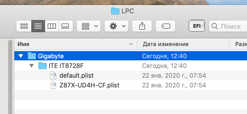

Andrey1970 Posted January 25, 2020 Share Posted January 25, 2020 @vector sigma I suggest not to use folders of vendors, and to use folders of SuperIO chips. If mobo.plist is absent, to apply default.plist for this SuperIO chip. For SuperIO chip determination: log show --predicate "processID == 0" --debug --last boot | grep SuperIO Look at attachment. LPC.zip 1 Link to comment https://www.insanelymac.com/forum/topic/335292-virtualsmc-%E2%80%94-smc-emulator/page/24/#findComment-2705653 Share on other sites More sharing options...
Andrey1970 Posted January 25, 2020 Share Posted January 25, 2020 I here thought, it is better to use the vendor too. Link to comment https://www.insanelymac.com/forum/topic/335292-virtualsmc-%E2%80%94-smc-emulator/page/24/#findComment-2705658 Share on other sites More sharing options...
vector sigma Posted January 25, 2020 Share Posted January 25, 2020 (edited) 2 hours ago, Andrey1970 said: @vector sigma I suggest not to use folders of vendors, and to use folders of SuperIO chips. If mobo.plist is absent, to apply default.plist for this SuperIO chip. For SuperIO chip determination: log show --predicate "processID == 0" --debug --last boot | grep SuperIO Look at attachment. LPC.zip 2 hours ago, Andrey1970 said: I here thought, it is better to use the vendor too. Hi, I agree with you, but: 1) at least the chip name should be posted in the same path of the "Sensors" dictionary as I cannot use "log show --predicate .." in a program. 2) It is also true that a default configuration will bring to no where as well, as a motherboard always have the same chip and a working solution there will be for a matching file. Edited January 25, 2020 by vector sigma Link to comment https://www.insanelymac.com/forum/topic/335292-virtualsmc-%E2%80%94-smc-emulator/page/24/#findComment-2705672 Share on other sites More sharing options...

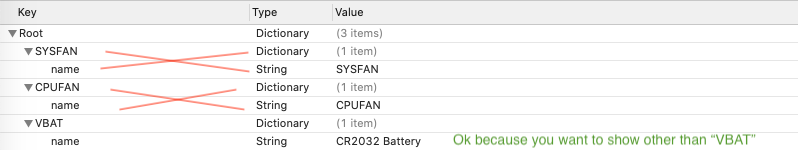

vector sigma Posted January 25, 2020 Share Posted January 25, 2020 (edited) 13 hours ago, Nuacho said: ASUS ROG STRIX Z370-F GAMING lpc.plist.zip Thanks. Anyway this lpc.plist.zip should be better? I.e. for example, there is no need to add the "name" if the key is already the same: Then I skipped VIN3 and VIN4 as both looks unused: Also sould be nice for the auto detection, to know what Clover say about your motherboard model name. If it is exactly 'ROG STRIX Z370-F GAMING', than the file should be named 'ROG STRIX Z370-F GAMING.plist' and so all the users with your motherboards will have your configuration loaded. P.S. Looks like the auto detection will work soon with OC as well. Edited January 25, 2020 by vector sigma 1 Link to comment https://www.insanelymac.com/forum/topic/335292-virtualsmc-%E2%80%94-smc-emulator/page/24/#findComment-2705677 Share on other sites More sharing options...

Andrey1970 Posted January 25, 2020 Share Posted January 25, 2020 52 minutes ago, vector sigma said: It is also true that a default configuration will bring to no where as well, as a motherboard always have the same chip and a working solution there will be for a matching file. If there is no the configuration file for the motherboard, use default.plist for same vendor and same IO chip - it with big probability will yield the correct result. Link to comment https://www.insanelymac.com/forum/topic/335292-virtualsmc-%E2%80%94-smc-emulator/page/24/#findComment-2705682 Share on other sites More sharing options...
vector sigma Posted January 25, 2020 Share Posted January 25, 2020 6 minutes ago, Andrey1970 said: If there is no the configuration file for the motherboard, use default.plist for same vendor and same IO chip - it with big probability will yield the correct result. I have some doubts (may be something will be reported correctly), but ok. Link to comment https://www.insanelymac.com/forum/topic/335292-virtualsmc-%E2%80%94-smc-emulator/page/24/#findComment-2705684 Share on other sites More sharing options...
Andrey1970 Posted January 25, 2020 Share Posted January 25, 2020 9 minutes ago, vector sigma said: I have some doubts (may be something will be reported correctly), but ok. I saw different Gigabyte mobo with the IT8728F chip, worked with an identical configuration IT8728F chip. I won't tell that everything will always match, but it would simplify life to some users who won't be able to make the configuration file. Link to comment https://www.insanelymac.com/forum/topic/335292-virtualsmc-%E2%80%94-smc-emulator/page/24/#findComment-2705689 Share on other sites More sharing options...
