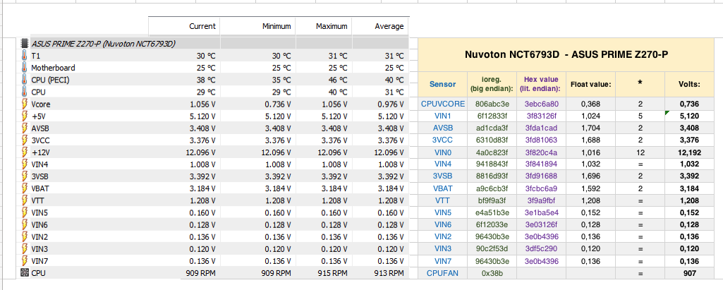

ctich Posted January 20, 2020 Share Posted January 20, 2020 7 hours ago, vector sigma said: Thanks guys! Voltages needs a formula to be applied based on motherboards (on its capacitors/resistors), I'll create a method to let users to apply a custom configuration.. Hi, this might be useful(?): Sensor readings taken in HWinfo64 https://www.hwinfo.com/ Sensor datasheet -> https://www.dropbox.com/sh/w57yqrzk8dmeng2/AABs51V5NbfZGKi2sAN1Ekk_a?dl=0 1 Link to comment https://www.insanelymac.com/forum/topic/335292-virtualsmc-%E2%80%94-smc-emulator/page/23/#findComment-2704987 Share on other sites More sharing options...

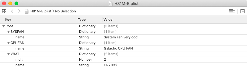

vector sigma Posted January 20, 2020 Share Posted January 20, 2020 (edited) On 1/20/2020 at 7:42 AM, ctich said: Hi, this might be useful(?): Oh yeah! ..... try there will be a folder inside HWMonitorSMC2.app/Contents/SharedSupport/, where sub folders and files will exists: ASUS/ H81M-E.plist PRIME Z270-P.plist ASROCK/ ... ... etc. ..but in the meantime this folder will be in your Desktop: SharedSupport.zip run this new one: [REMOVED] and you will see something like that: SMCSuperIO parser by vector sigma. Product = All Series Board = H81M-E Vendor = ASUS /Users/vectorsigma/Desktop/SharedSupport/ASUS/H81M-E.plist not found. now you have to create your configuration, i.e. SharedSupport/ASUS/H81M-E.plist (or what ever the program say to you). Take a look at ../ASUS/H81M-E.plist, it is easy: name to override the sensor name, if you want, for both fans and voltages. multi to moltiplicate the voltage if wrong. ... this for all the sensors shown. Soon in HWMonitorSMC2.app . let me know EDIT for Open Core see here Edited February 2, 2020 by vector sigma beta program removed 2 Link to comment https://www.insanelymac.com/forum/topic/335292-virtualsmc-%E2%80%94-smc-emulator/page/23/#findComment-2705045 Share on other sites More sharing options...

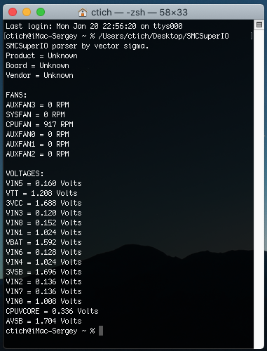

ctich Posted January 20, 2020 Share Posted January 20, 2020 @vector sigma ctich@iMac-Sergey ~ % /Users/ctich/Desktop/SMCSuperIO SMCSuperIO parser by vector sigma. Product = Unknown Board = Unknown Vendor = Unknown FANS: AUXFAN3 = 0 RPM SYSFAN = 0 RPM CPUFAN = 914 RPM AUXFAN0 = 0 RPM AUXFAN1 = 0 RPM AUXFAN2 = 0 RPM VOLTAGES: VIN5 = 0.160 Volts VTT = 1.208 Volts 3VCC = 1.688 Volts VIN3 = 0.120 Volts VIN8 = 0.152 Volts VIN1 = 1.024 Volts VBAT = 1.592 Volts VIN6 = 0.128 Volts VIN4 = 1.024 Volts 3VSB = 1.696 Volts VIN2 = 0.136 Volts VIN7 = 0.136 Volts VIN0 = 1.008 Volts CPUVCORE = 0.344 Volts AVSB = 1.704 Volts ctich@iMac-Sergey ~ % z270-p.zip Link to comment https://www.insanelymac.com/forum/topic/335292-virtualsmc-%E2%80%94-smc-emulator/page/23/#findComment-2705050 Share on other sites More sharing options...
vector sigma Posted January 20, 2020 Share Posted January 20, 2020 (edited) Guys, you don't have OEM informations under IODeviceTree:/efi/platform as Clover does. So try this: [REMOVED] and create ~/Desktop/SharedSupport/lpc.plist try again Edited February 2, 2020 by vector sigma beta program removed Link to comment https://www.insanelymac.com/forum/topic/335292-virtualsmc-%E2%80%94-smc-emulator/page/23/#findComment-2705052 Share on other sites More sharing options...

ctich Posted January 20, 2020 Share Posted January 20, 2020 2 minutes ago, vector sigma said: @ctich my mistake, use this ctich@iMac-Sergey ~ % /Users/ctich/Desktop/SMCSuperIO SMCSuperIO parser by vector sigma. Product = Unknown Board = Unknown Vendor = Unknown Loading configuration from ../SharedSupport/lpc.plist. FANS: AUXFAN3 = 0 RPM SYSFAN = 0 RPM CPUFAN = 906 RPM AUXFAN0 = 0 RPM AUXFAN1 = 0 RPM AUXFAN2 = 0 RPM VOLTAGES: VIN5 = 0.160 Volts VTT = 1.208 Volts 3VCC = 3.376 Volts VIN3 = 0.120 Volts VIN8 = 0.152 Volts VIN1 = 5.120 Volts VBAT = 3.184 Volts VIN6 = 0.128 Volts VIN4 = 1.024 Volts 3VSB = 3.392 Volts VIN2 = 0.136 Volts VIN7 = 0.136 Volts VIN0 = 12.096 Volts CPUVCORE = 0.704 Volts AVSB = 3.408 Volts ctich@iMac-Sergey ~ % 1 Link to comment https://www.insanelymac.com/forum/topic/335292-virtualsmc-%E2%80%94-smc-emulator/page/23/#findComment-2705061 Share on other sites More sharing options...

vector sigma Posted January 20, 2020 Share Posted January 20, 2020 @ctich you can rename each entry if you want! 1 minute ago, jinbingmao said: Still the same be sure ~/Desktop/SharedSupport/lpc.plist exists 1 Link to comment https://www.insanelymac.com/forum/topic/335292-virtualsmc-%E2%80%94-smc-emulator/page/23/#findComment-2705063 Share on other sites More sharing options...
ctich Posted January 20, 2020 Share Posted January 20, 2020 3 minutes ago, vector sigma said: @ctich you can rename each entry if you want! yes it works, thanks. 1 Link to comment https://www.insanelymac.com/forum/topic/335292-virtualsmc-%E2%80%94-smc-emulator/page/23/#findComment-2705066 Share on other sites More sharing options...
