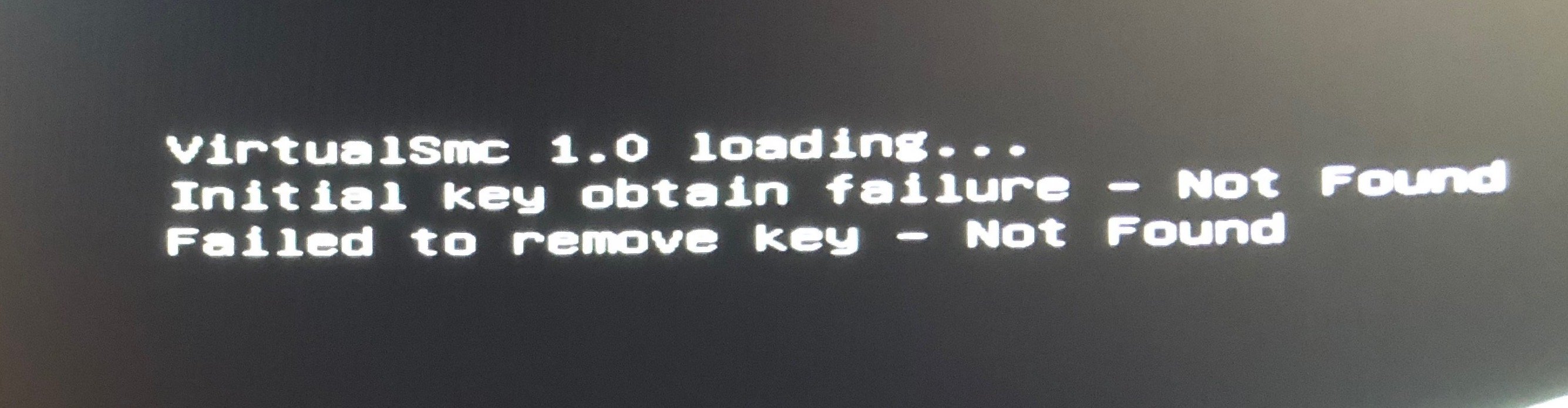

Modmike Posted April 5, 2019 Share Posted April 5, 2019 (edited) I built VirtualSMC and I am getting this error after post: Does anyone know what causes this? Edited April 5, 2019 by Modmike Link to comment https://www.insanelymac.com/forum/topic/335292-virtualsmc-%E2%80%94-smc-emulator/page/17/#findComment-2669239 Share on other sites More sharing options...
Andrey1970 Posted April 5, 2019 Share Posted April 5, 2019 (edited) There it is written that everything is good. This message debug version. Edited April 5, 2019 by Andrey1970 Link to comment https://www.insanelymac.com/forum/topic/335292-virtualsmc-%E2%80%94-smc-emulator/page/17/#findComment-2669250 Share on other sites More sharing options...
Modmike Posted April 6, 2019 Share Posted April 6, 2019 41 minutes ago, Andrey1970 said: There it is written that everything is good. This message debug version. If I understand properly I am getting this because I used debug version? I was wondering about that when I used it. Link to comment https://www.insanelymac.com/forum/topic/335292-virtualsmc-%E2%80%94-smc-emulator/page/17/#findComment-2669252 Share on other sites More sharing options...

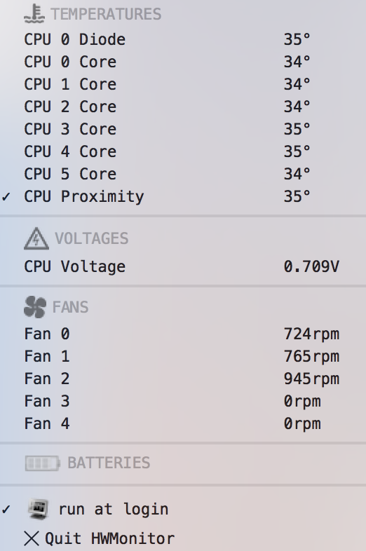

Tony Arnold Posted April 6, 2019 Share Posted April 6, 2019 On 4/4/2019 at 11:00 AM, Modmike said: No idea what that is. You have an X299, no idea what sensor chip they use. Hopefully, @vit9696 will know. On the ASUS Prime X299 Deluxe I have, it appears to be a NCT6796D. I'd like to get all of the fans showing up if I can - would I do this by adding additional support to VirtualSMC for them, or is this an SSDT-fixable issue (the iMacPro1,1 SMBIOS I'm using appears to only recognise F1Ac and F2Ac for Fan 0 and Fan 1 RPMs. Link to comment https://www.insanelymac.com/forum/topic/335292-virtualsmc-%E2%80%94-smc-emulator/page/17/#findComment-2669253 Share on other sites More sharing options...
Modmike Posted April 7, 2019 Share Posted April 7, 2019 (edited) On 4/5/2019 at 8:03 PM, Tony Arnold said: On the ASUS Prime X299 Deluxe I have, it appears to be a NCT6796D. I'd like to get all of the fans showing up if I can - would I do this by adding additional support to VirtualSMC for them, or is this an SSDT-fixable issue (the iMacPro1,1 SMBIOS I'm using appears to only recognise F1Ac and F2Ac for Fan 0 and Fan 1 RPMs. That chip is already supported. I’m not sure why, but not every HWMonitor or iStat shows all the fans. Try HWMonitorSMC2 to see if you see more. Edited April 7, 2019 by Modmike Link to comment https://www.insanelymac.com/forum/topic/335292-virtualsmc-%E2%80%94-smc-emulator/page/17/#findComment-2669338 Share on other sites More sharing options...

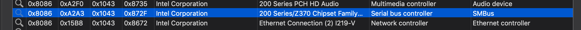

hackattak Posted April 7, 2019 Share Posted April 7, 2019 Trying to figure this out.. Any way to get my Z370N-WiFi VRM and PCH temps to be seen in MacOS? I am getting only as shown in image.. Thx to all/any Link to comment https://www.insanelymac.com/forum/topic/335292-virtualsmc-%E2%80%94-smc-emulator/page/17/#findComment-2669341 Share on other sites More sharing options...

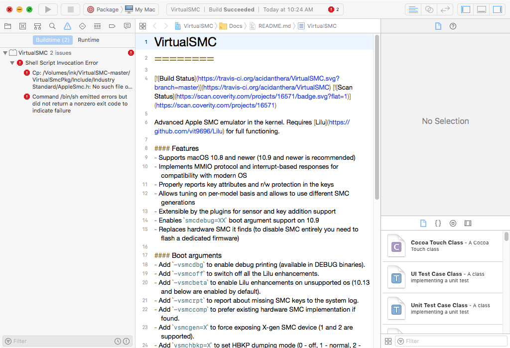

hardcorehenry Posted April 7, 2019 Share Posted April 7, 2019 Always receiving this message when building VSMC. Should I ignore it or can do something about it. Apart from it build end up success and everything works, but message is somewhat annoying Link to comment https://www.insanelymac.com/forum/topic/335292-virtualsmc-%E2%80%94-smc-emulator/page/17/#findComment-2669361 Share on other sites More sharing options...

Tony Arnold Posted April 7, 2019 Share Posted April 7, 2019 26 minutes ago, Modmike said: What motherboard do you have? I have the ASUS Prime X299 Deluxe, and I can only see Fan0 and Fan1, despite having fans attached to Fan2 and Fan3 - how can I work out the info needed to figure out which chipset is not supported on my board? Link to comment https://www.insanelymac.com/forum/topic/335292-virtualsmc-%E2%80%94-smc-emulator/page/17/#findComment-2669419 Share on other sites More sharing options...
